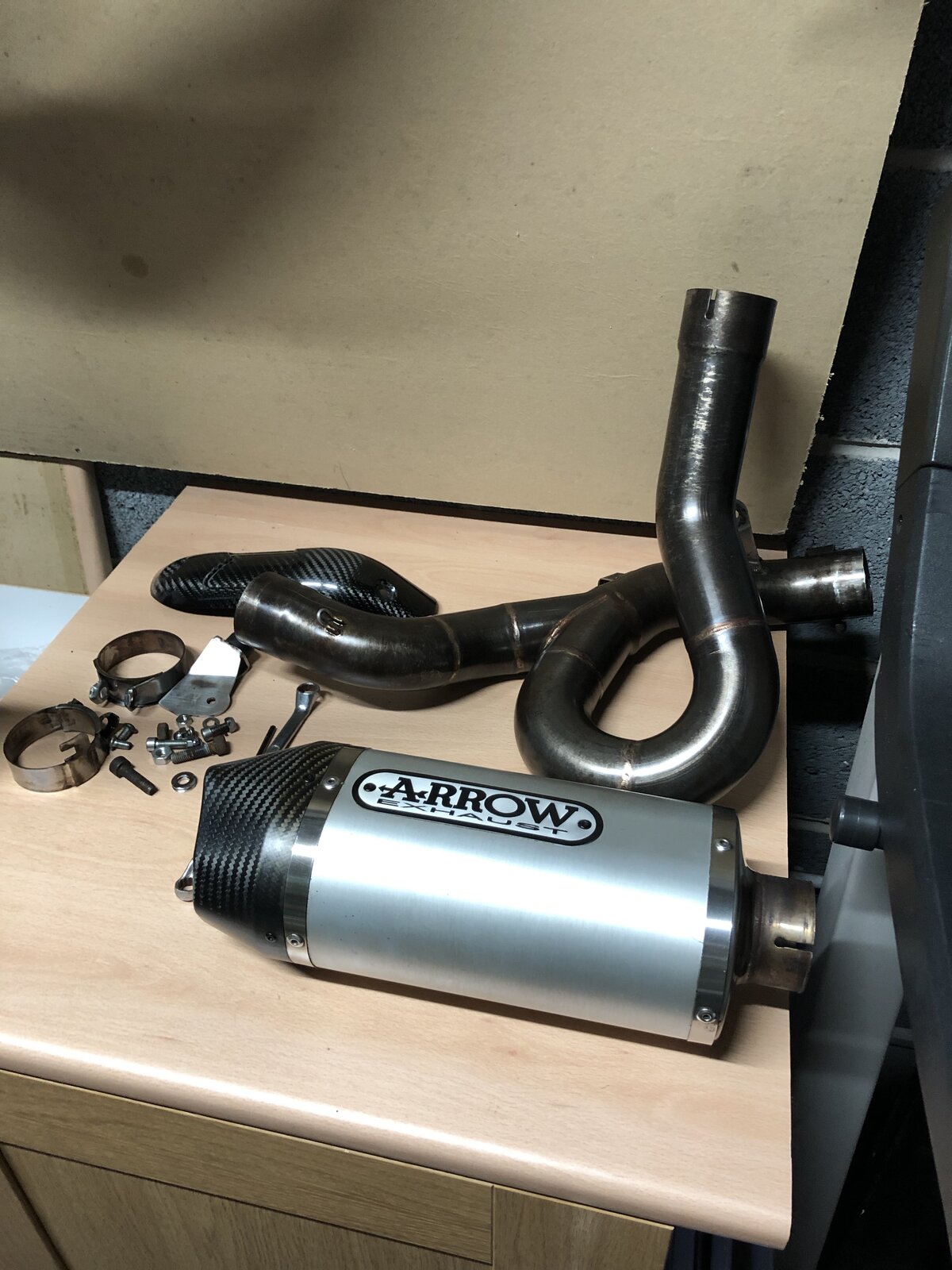

  1. I've got the last of the 1200s models, always considered a different exhaust, how much grief was this to fit?
  2. Although the throttle spacer seems expensive for a small bit of plastic, when you look at the benefit it gives it then becomes a cheap modification. If you don't mind me asking, how much was the Desmo service? Mine will be due in a couple of thousand miles.

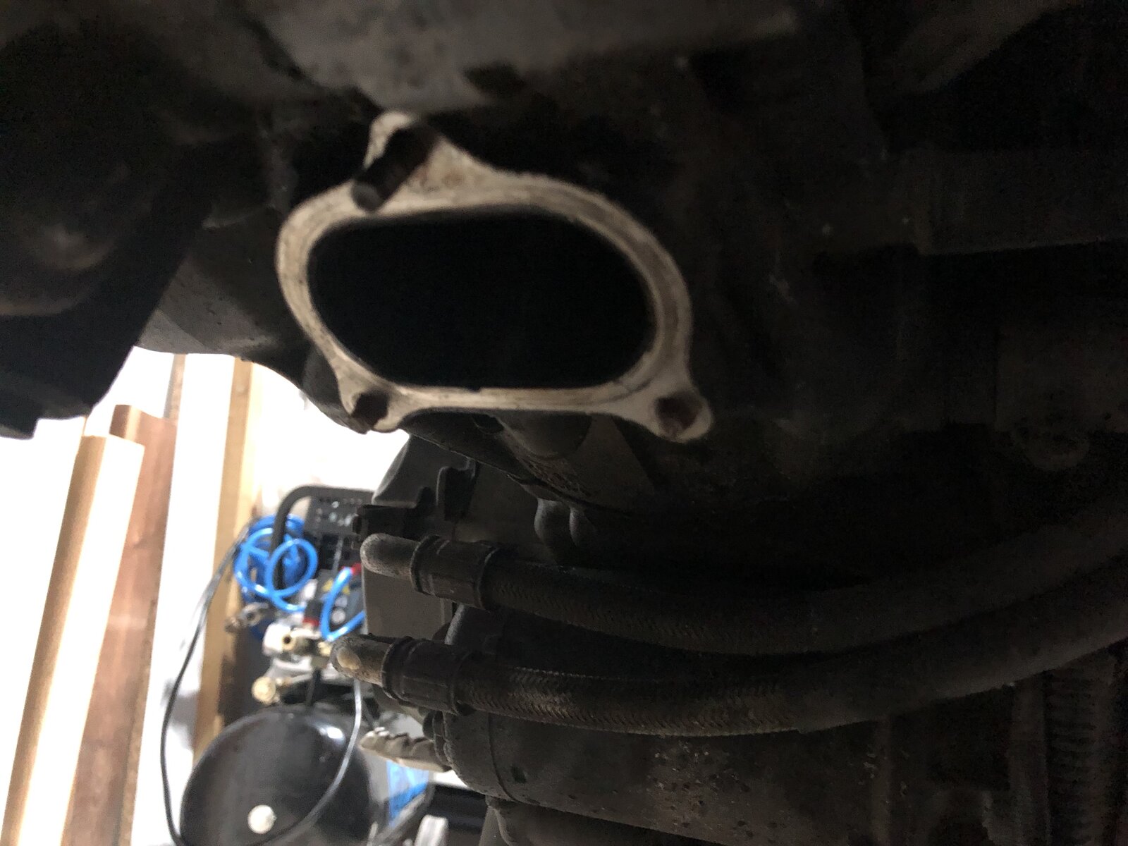

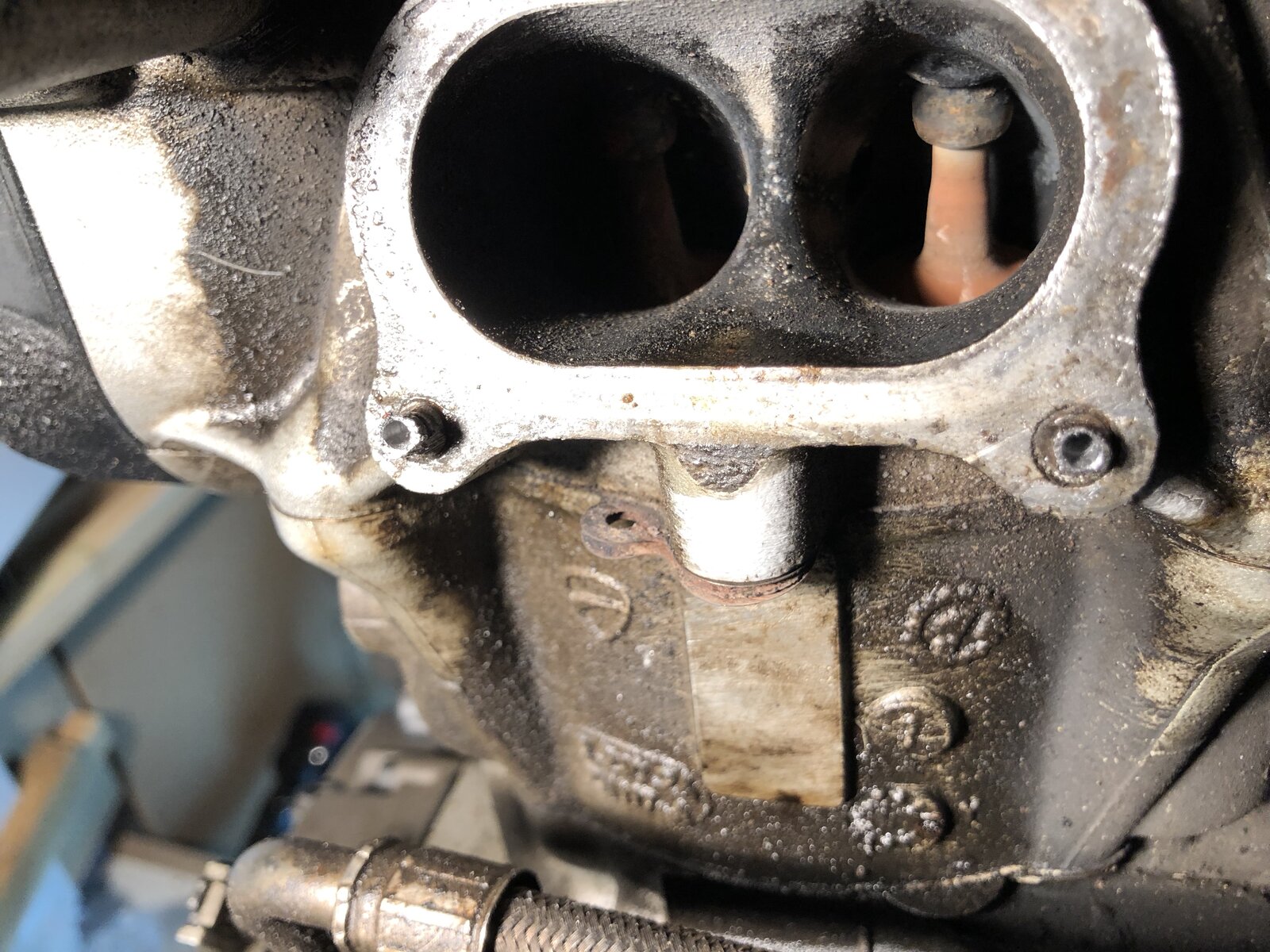

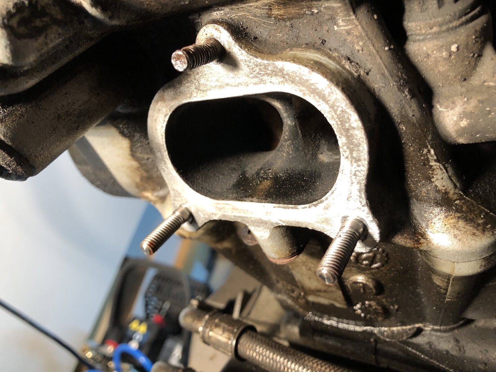

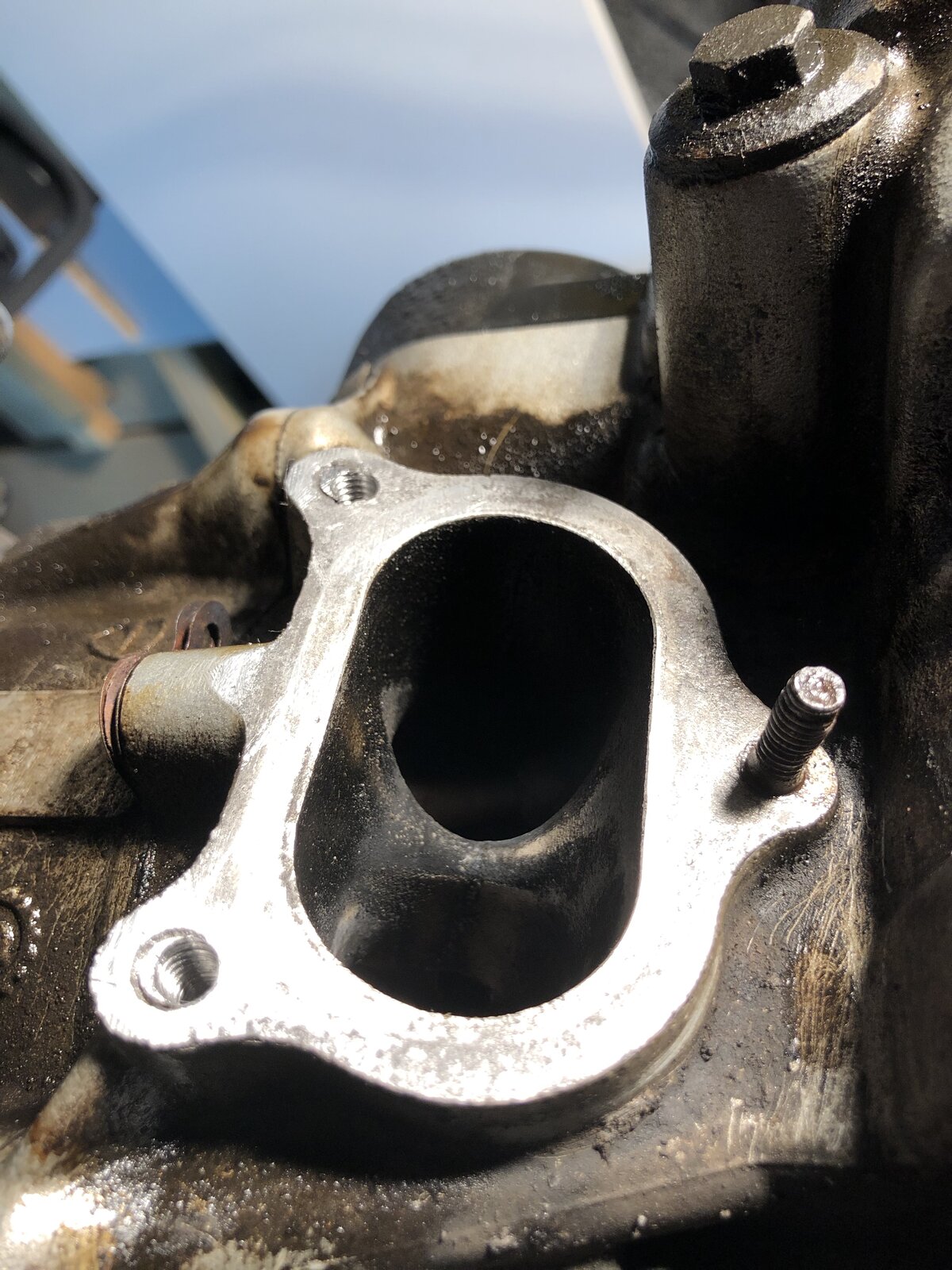

  3. Hi Mike,
    It should have been easy except I broke 2 exhaust studs on the front cylinder head. Couldn't budge the tiny studs so ended up sawing them off + drilling & tapping. I then bought some HD studs & fitted them. The pipe went on really easily. I've left the exhaust flappy valve in there but tucked the wires etc under the seat, so you don't know they are there, just incase I revert to the orig pipes. I suspect heat & a bit more patience could have got the nut off that stud, but hindsight is wonderful. Here's a few thumbnails to tell the story.
