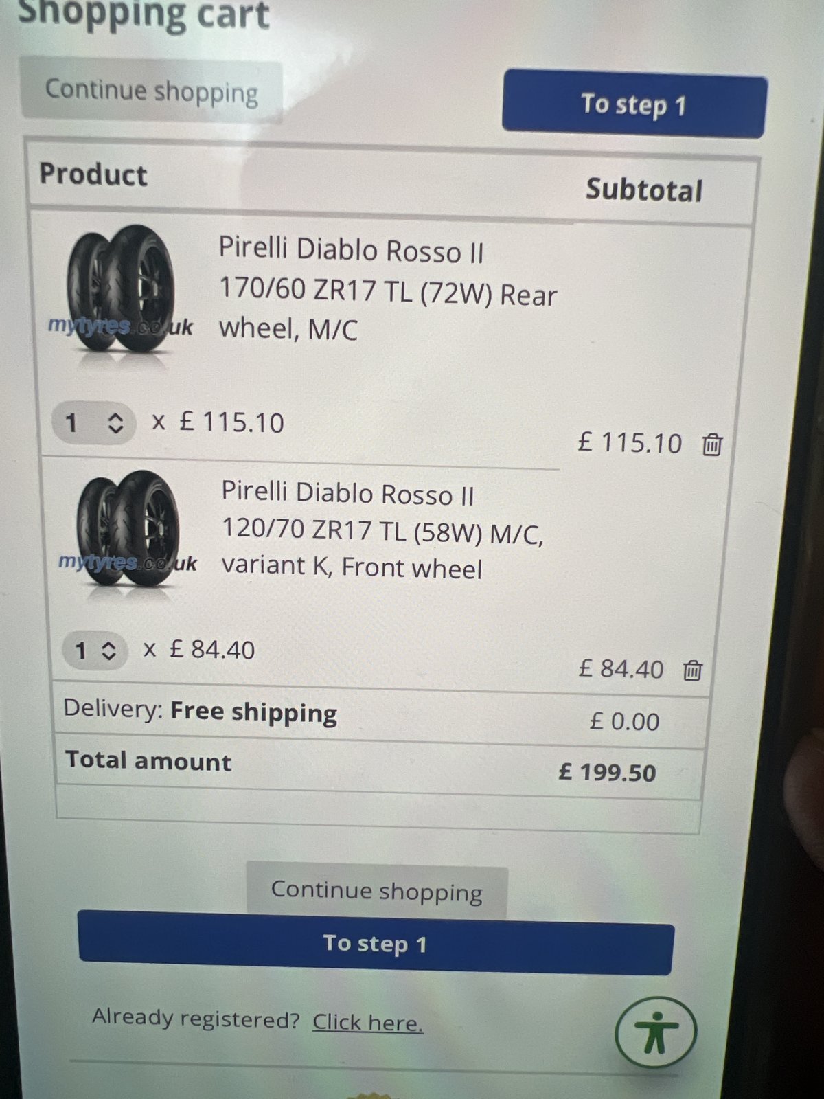

  18. Now about to order a pair of tyres.
    As Doggy mentioned m7rr (had them on my 848) not available in rear size but can get m9rr anyone found any issues with these on 900ss carby.
