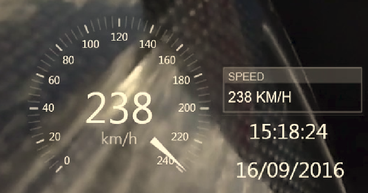

    And I can just reach 120mph in real speed/gps.
    Thats about 193km/h
    But thats actually the max speed with panniers.
    Naked, I could go a bit faster, but traffic wouldn't allow it since it took the bike too long to climb so I suspect it wouldn't make that much more speed without the bags.

  7. Looks quite clear to me that the OP has a DVT restricted to 100 HP... In my enduro I need to keep an eye when overtaking in 4th gear not to get close to 200kph, and that happens in no time. No surprises, that's what I expect from a 160 HP bike.
    Never tried top speed, but for the way it pushes around 200, I would be surprised not to hit easily 240+ in the speedo...
    So struggling to get to 200 means no ponies there or something very wrong going on...
