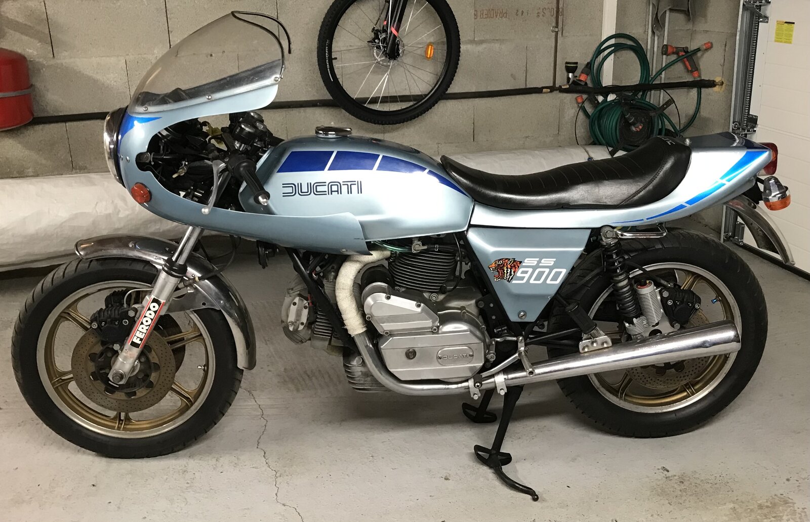

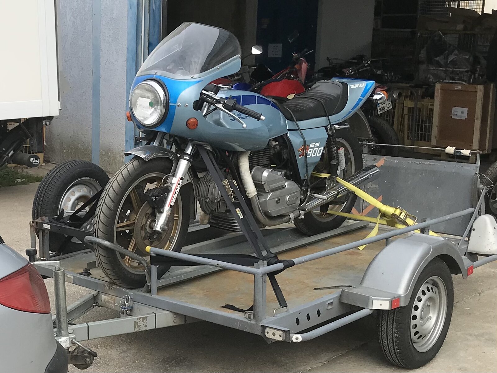

    As mentioned in another thread, I recently became the new owner of a very rare 1980 Darmah 900 Supersport Desmo (SSD). Why rare? Well, because Ducati failed to understand the late 70’s market and somehow imagined there was a “missing piece” between the Darmah 900 SD (Sport Desmo) and the 900 Supersport. That did not work and only over a thousand were produced and sold in 1979-1980 (with a few assembled in the following years with left over parts).

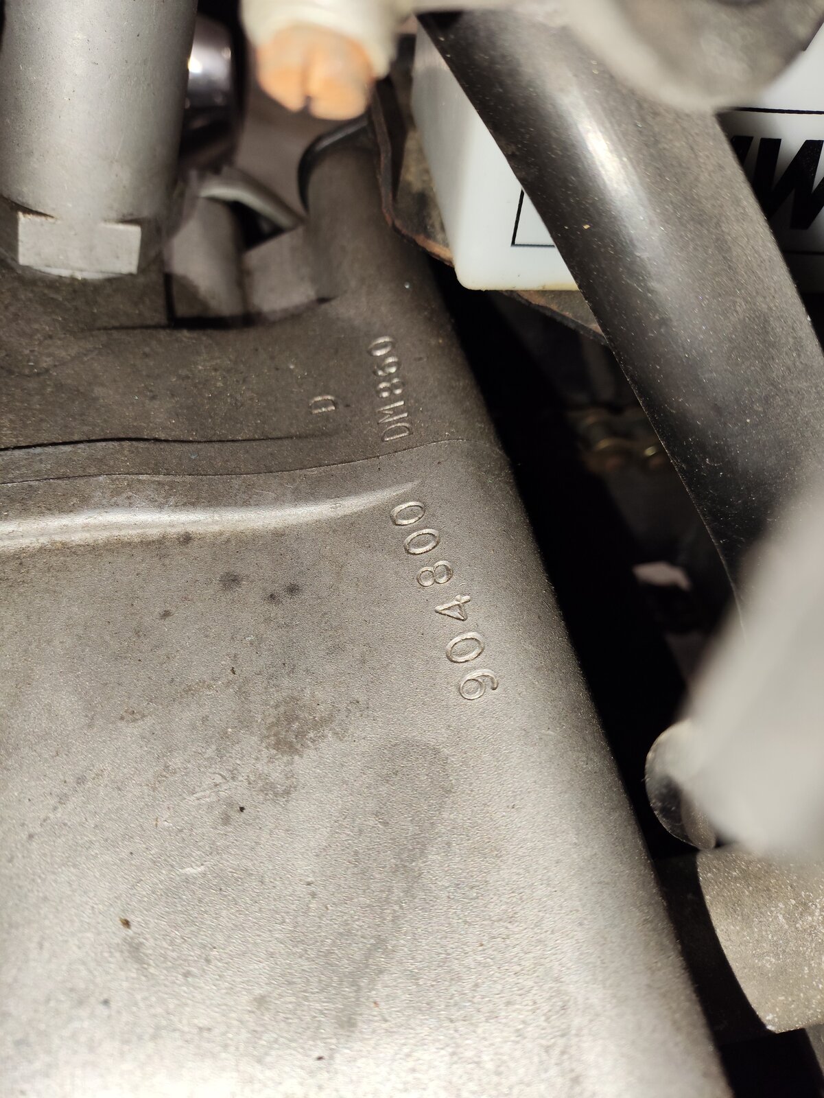

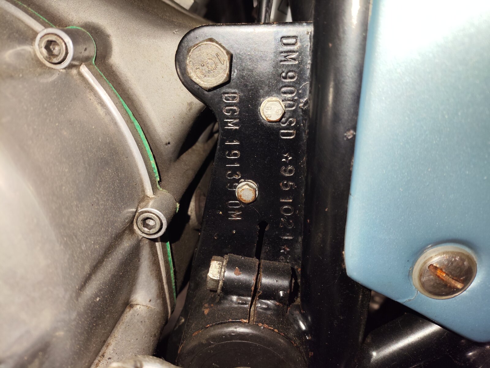

    So allow me to introduce frame number DM900SD*951021* with engine #DM860 904800. It’s a late production and has all the “goodies”:
    900SS engine (cams, heads, etc), Conti exhaust (a performance option back in the day), but still the Dellorto PHF 32 carbs (not the 40 of the 900SS), which should make it a bunch easier to live with, lowered footrests. These bikes all came in this light blue metallic livery with darker blue stickers. I love the way it looks because it is so Mad Max like. Remember “The Goose” and “Toecutter” (except those bikes were Kawa Z1000, but who cares…)?

  2. The darmah SS is an oddity, the engine and frame number dont tell you much except its a Darmah engine and frame. The SSD's were simply SD's pulled off the SD production line and converted to SSD so consecutive numbers might be an SD and an SSD. The difference from memory was the front mudguard, fairing, fairing bracket and the footrests. The later SD had the SSD fairing bracket on the frame anyway and the bracket for the footrests
    I seem to remember the SSD side panel had a cut out for the rear master cylinder
    Your bike probably originated from Australia or at least 904800 did so its probable that 904801 did as well but not for certain. Aus was by far the biggest market for Bevels in fact i think they sold more bevels to Aus that the rest of the world put together.

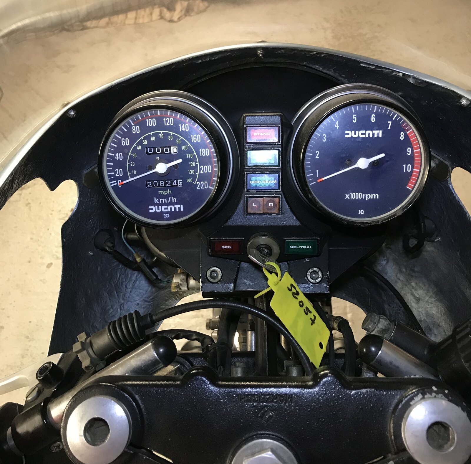

  4. It is pretty well preserved indeed. The odometer is showing 20.800km today. The Japanese “MOT” registered 20.500km in June 2004 and 20.700km in April 2011. That’s 300km in 20 years… So I guess it’s been stored pretty well as I see very little corrosion. Only dust and old grease. She’s sporting brand new 2001 Michelin Macadam tires (hard as wood)… A06975FE-FC8E-43AF-8DD6-257E9E992745.jpeg

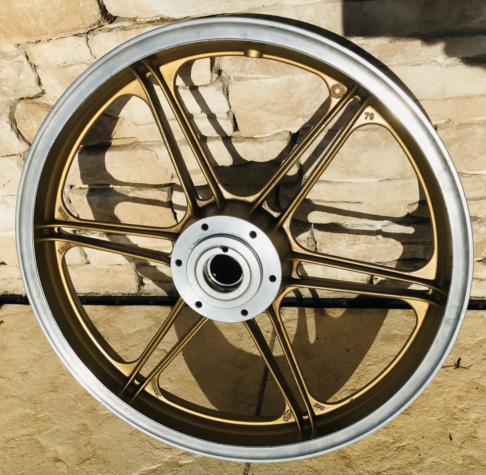

  10. Look at these! :D

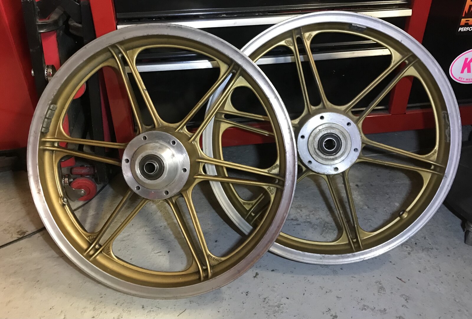

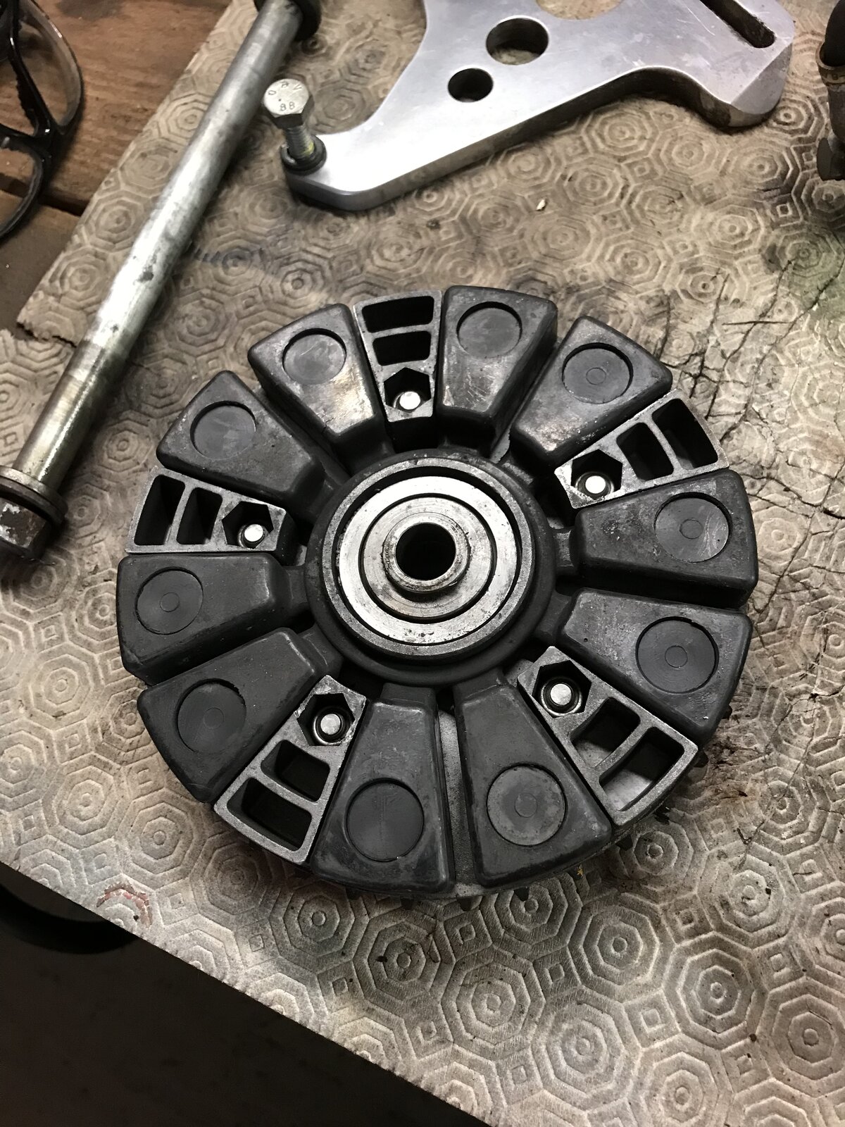

    I like those FPS wheels, really. The first cast aluminum wheels ever used on a Ducati, according to my readings. They are nice enough to deserve only a good clean up, new bearings and new tires. 246FE072-CD95-4520-A2E7-D3D11EFD5B51.jpeg

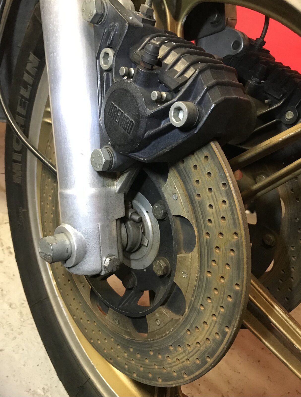

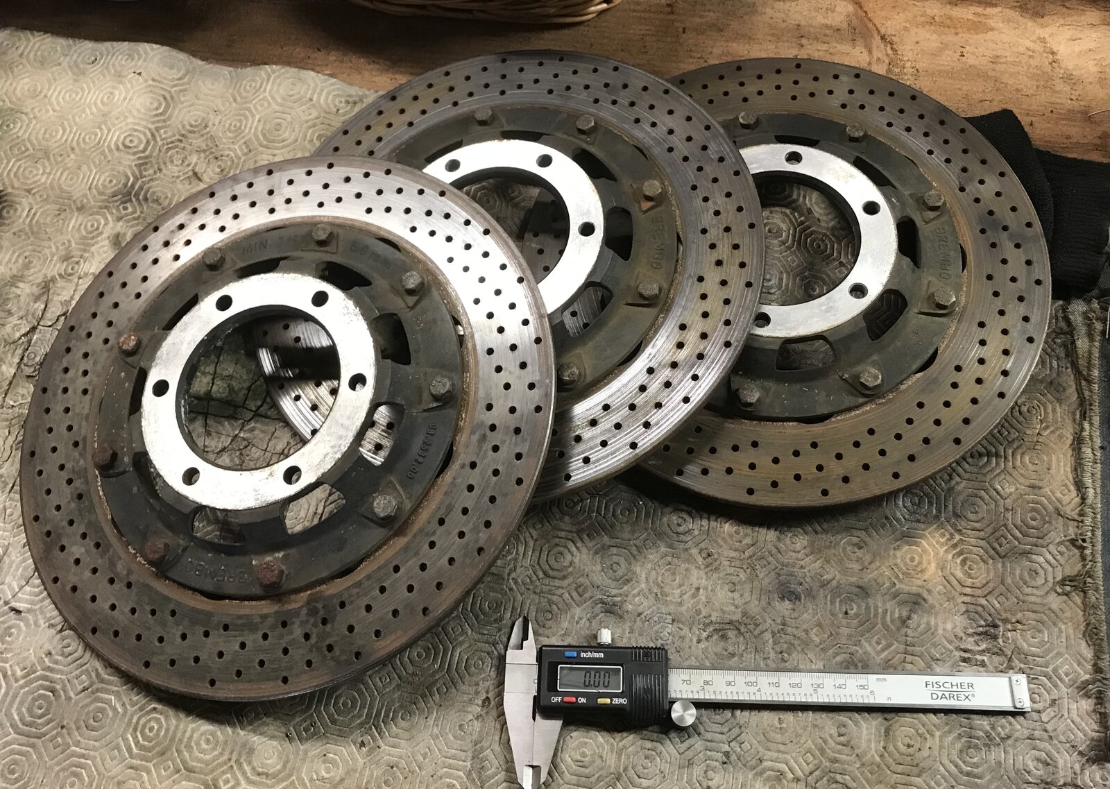

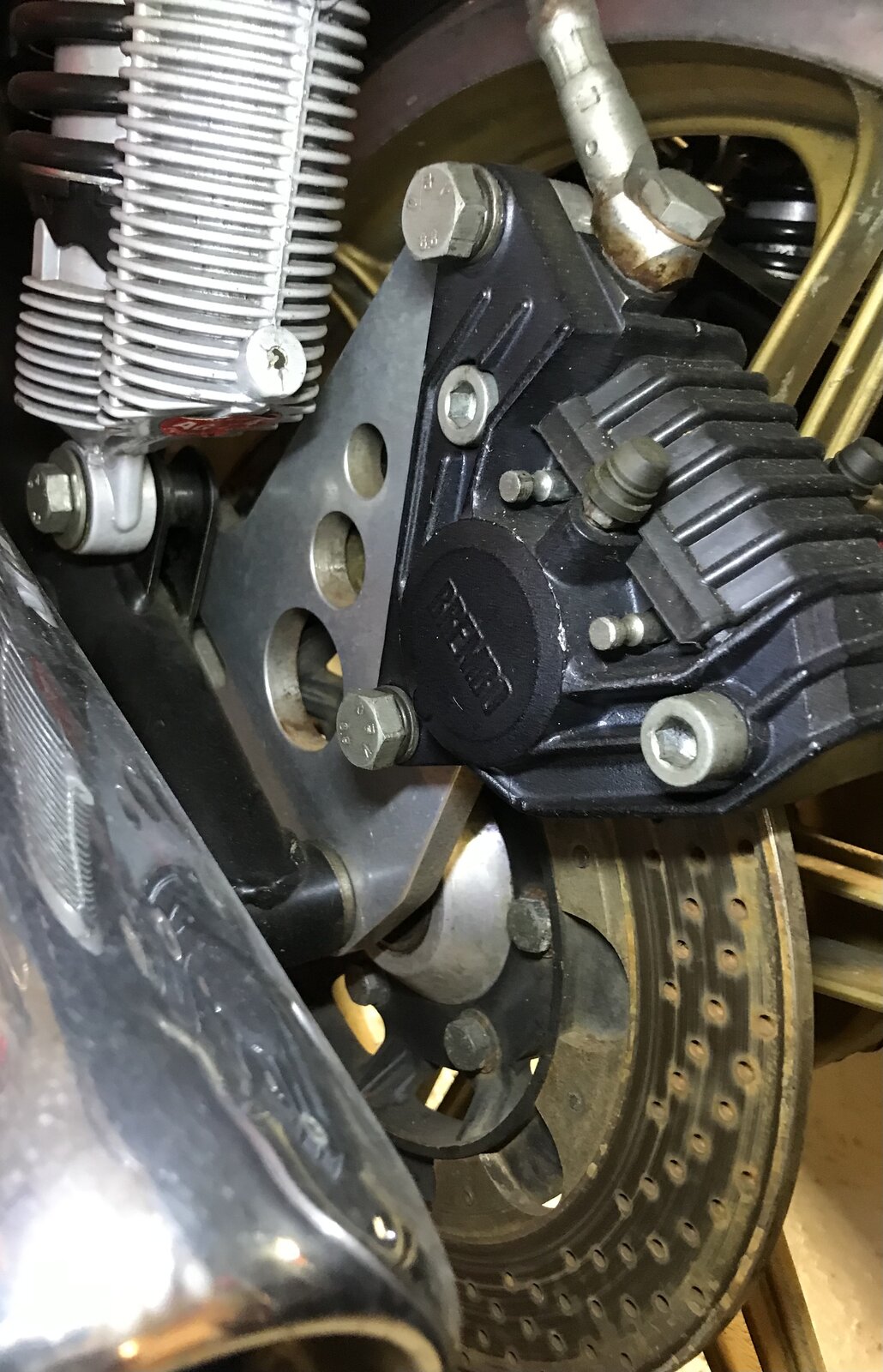

    There are 3 identical Brembo 280mm discs on this bike. Same for front and rear. Min thickness of 5.8mm is advertised on them and I measured 6.5mm, so we’re good. They will need a good clean though… 0A39763E-B276-4B2D-8B57-52ABDFFB2300.jpeg

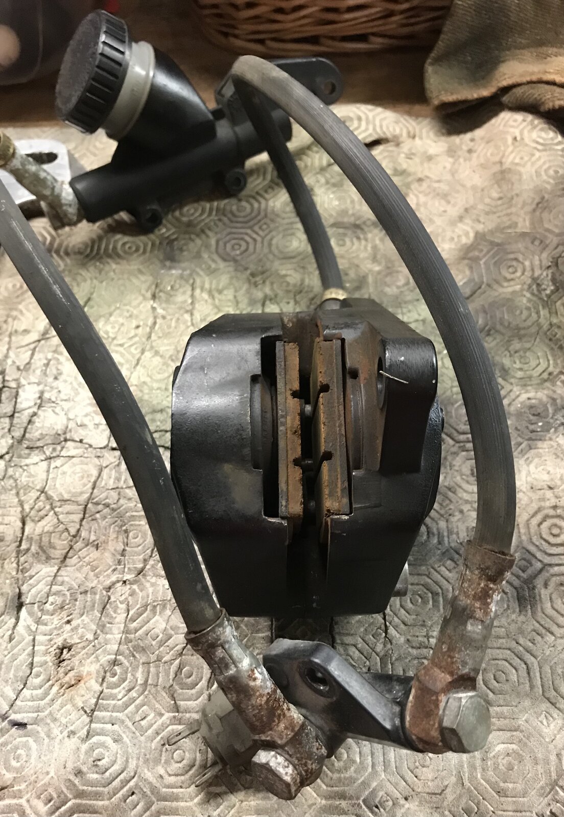

    Generally speaking, the brakes will need serious attention. As the rear caliper was almost seized, I had to use a rubber mallet to slide it off the disk... First time I ever had to do this. So I will rebuild the calipers with new aluminum pistons, fresh gaskets, rebuild the master cylinders and put new braided brake hoses (covered with black rubber). All this is on order. D9438C01-A985-43EC-9510-560BC6EC5367.jpeg 7813B6BE-33CC-43E7-BB90-236CE861D915.jpeg 6CC3A7ED-65C2-43DA-9F21-5FF33D0012C0.jpeg 445C0F3D-D0F9-4ECB-9961-CBE1BC512AD5.jpeg F0BF4B43-0AF9-46D0-B001-0079ED703F45.jpeg

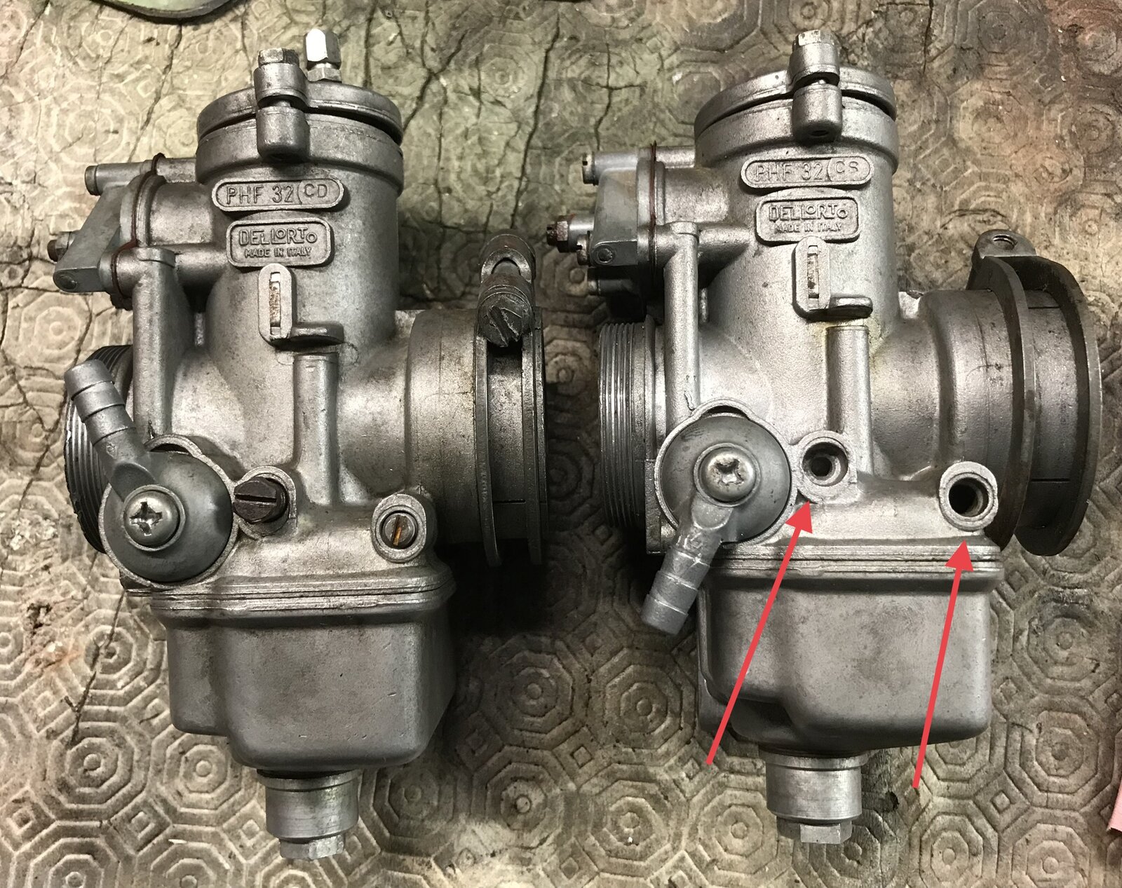

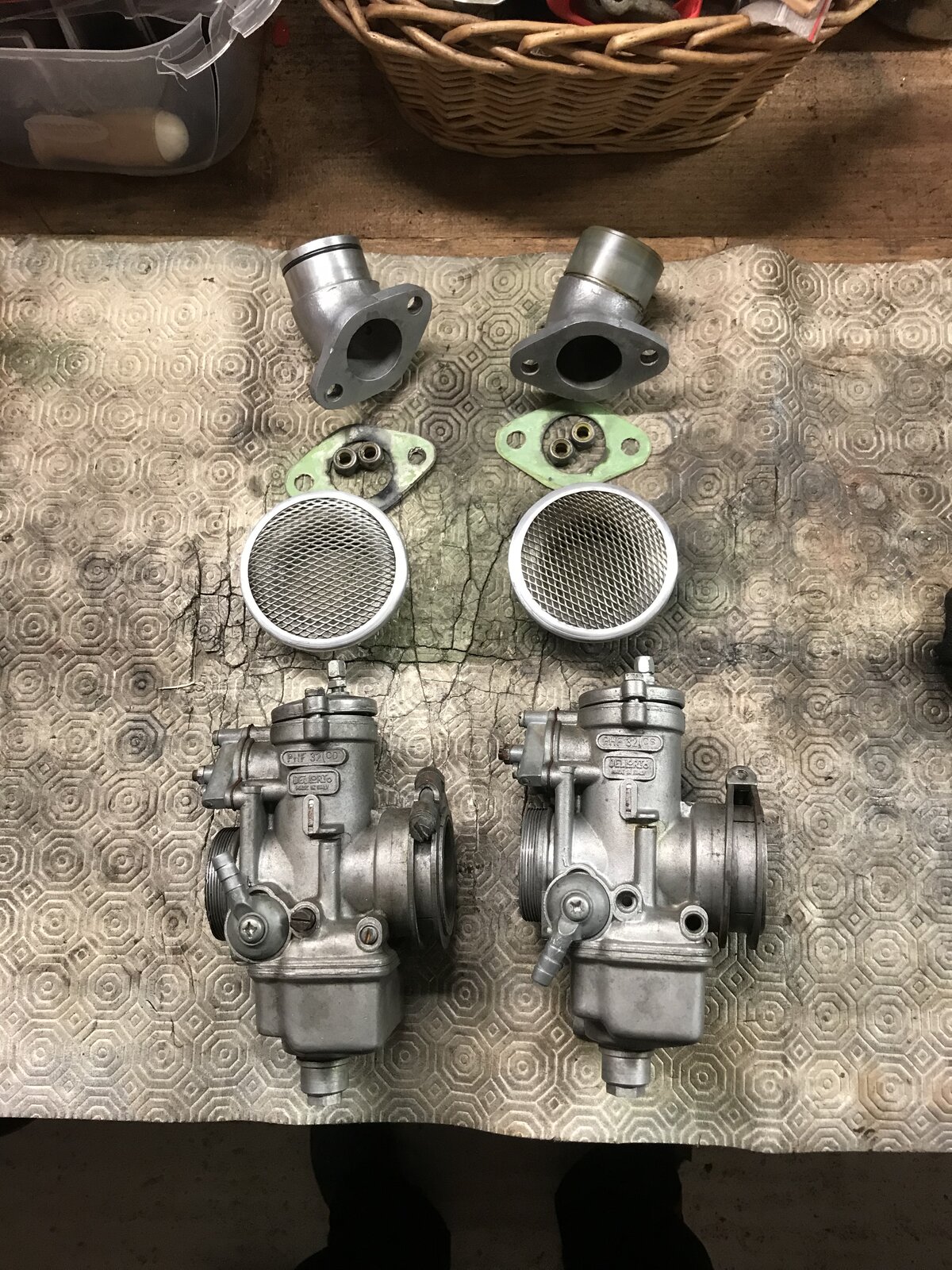

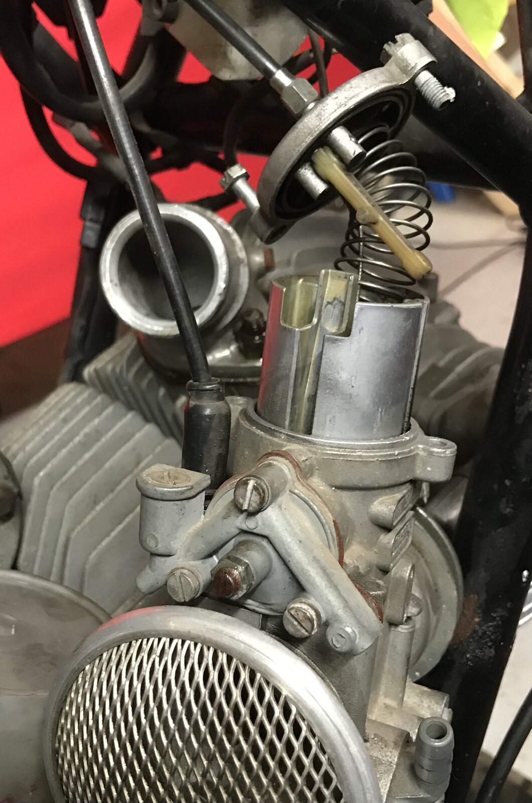

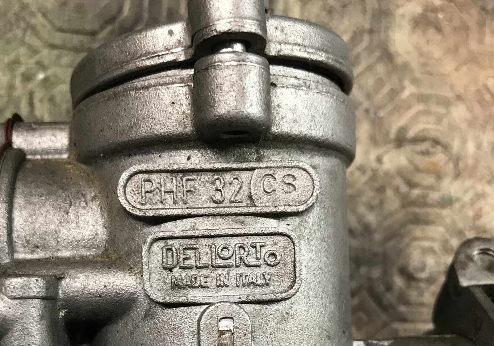

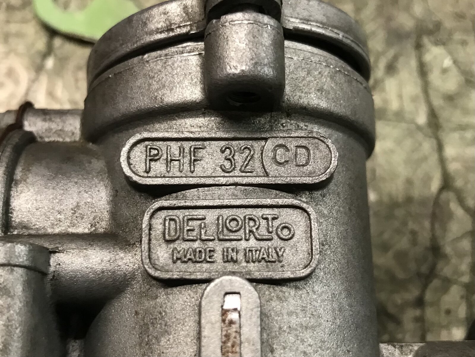

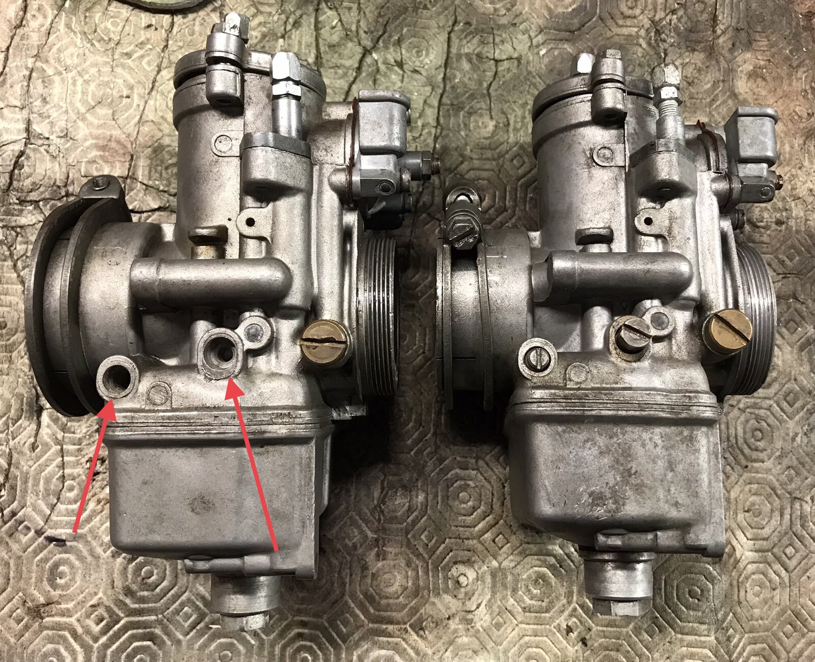

  11. Regarding carburation, as mentioned above, it has two Dellorto PHF 32 CS/CD (for left and right). D722373A-04D9-4FDD-86AA-23E8748321A5.jpeg CFD6CA80-445F-480A-956B-AE31FF299182.jpeg 54944EF6-287A-4E00-A33F-FF17FFB3304D.jpeg 15F51F10-2207-434D-BD92-3F5C824A9475.jpeg C991A089-5D35-4033-8726-E038F79D4DE7.jpeg 56F496F1-F2E3-43C8-B264-CDE42ACA10FC.jpeg
    These look pretty cool, really and will need a good ultrasonic bath and new gaskets. E23BDA24-39DC-4E6E-8E27-472C4F8A31CF.jpeg

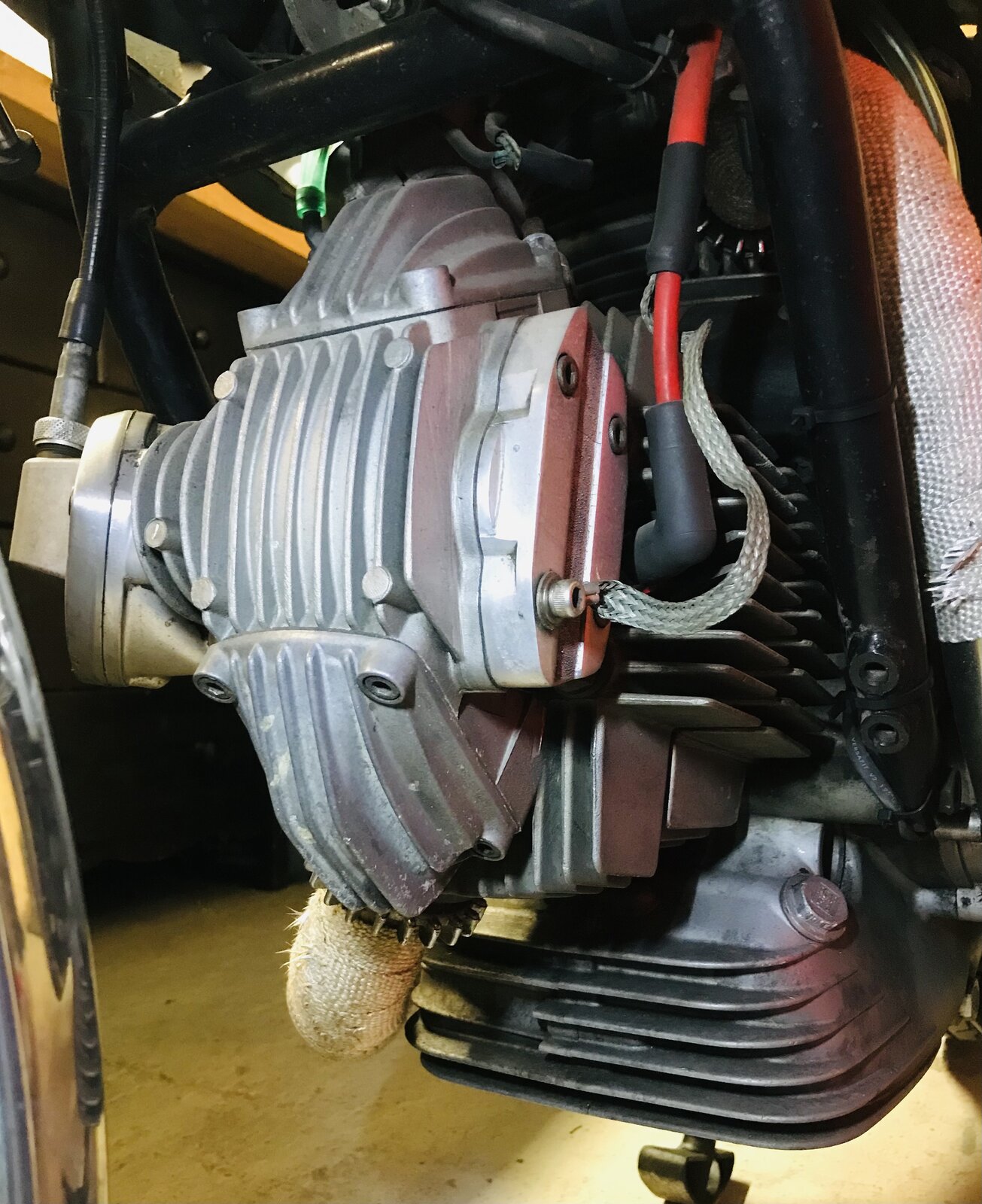

    I see the LHS Conti has an unfortunate dent in it and not too sure how easy that would be to knock or pull out. Original Contis can be worth a bob or two, ~ £2K, so definitely something you would want to keep.
    Looking good though & I for one will enjoy this topic.
  14. Yeah, the LHS Conti has a ding… But I think it will just stay like this. In fact, my overall idea is to keep it with its « patina », and simply make it a well preserved unrestored exemple.

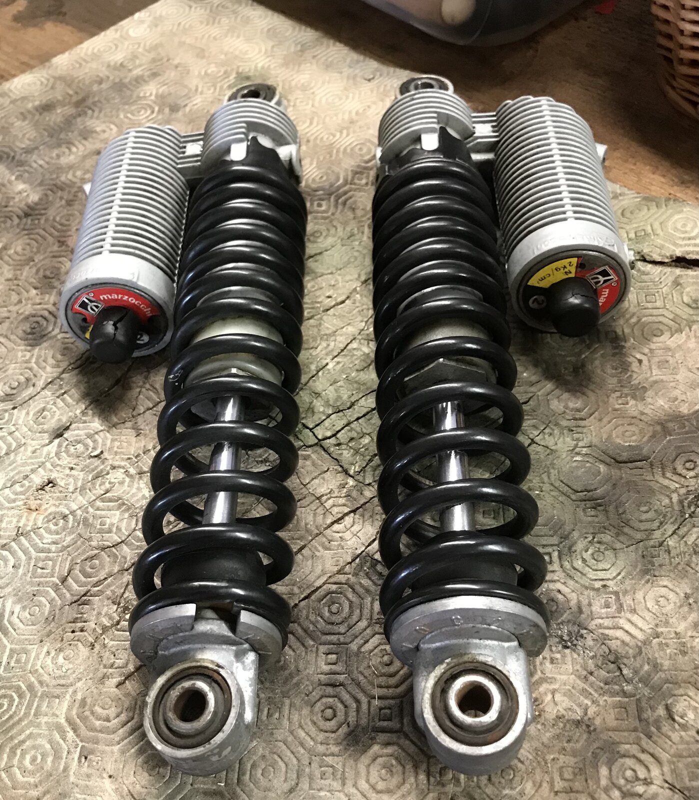

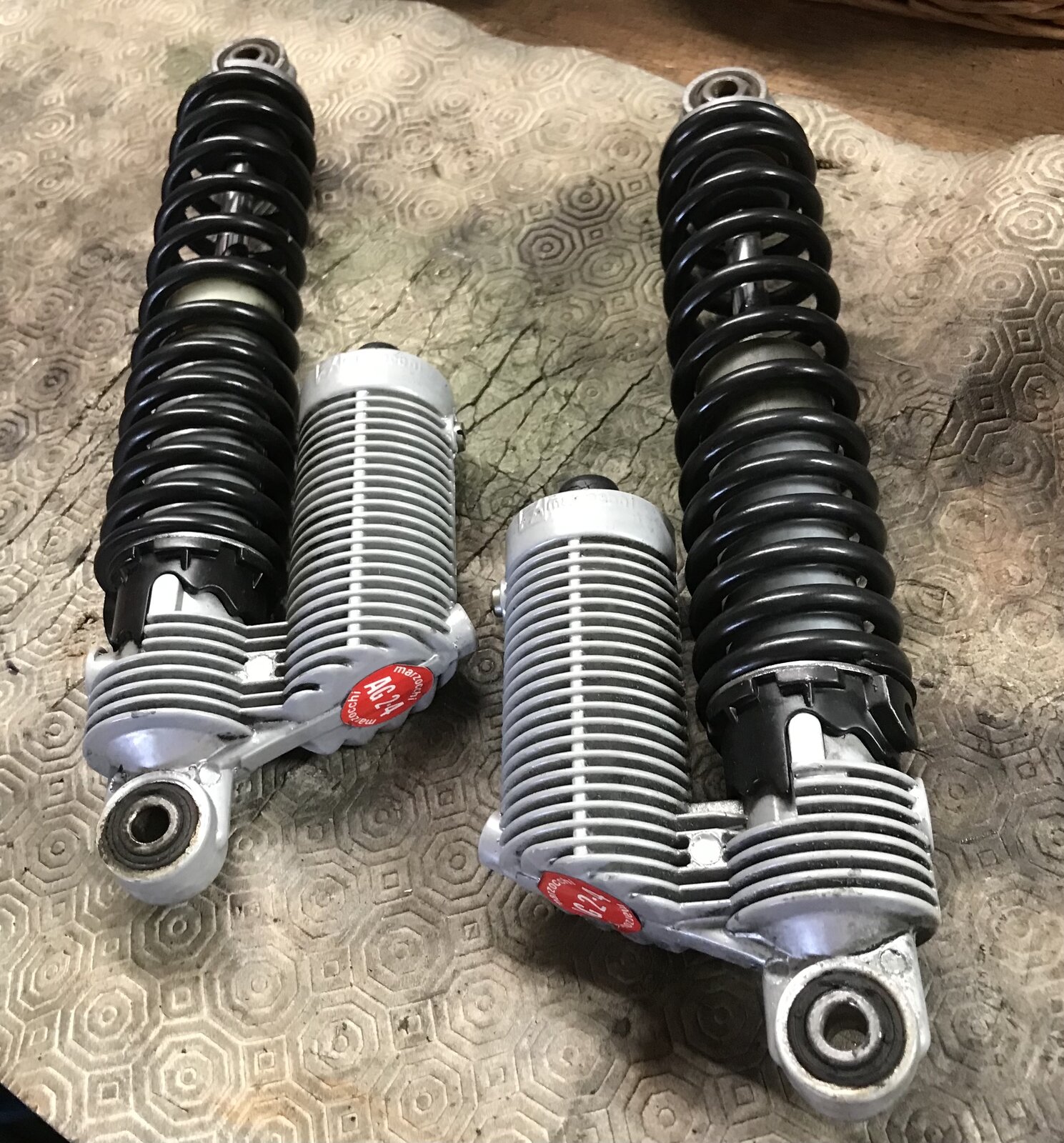

    Original Marzocchi AG 2-4 shocks and Marzocchi forks (the early ones had Ceriani forks). These have all gone to get professionally refurbed. 697E0A34-32BA-49EC-82D4-2A01F9005656.jpeg 799AC451-1E34-4438-B5B8-DAE798B67F91.jpeg

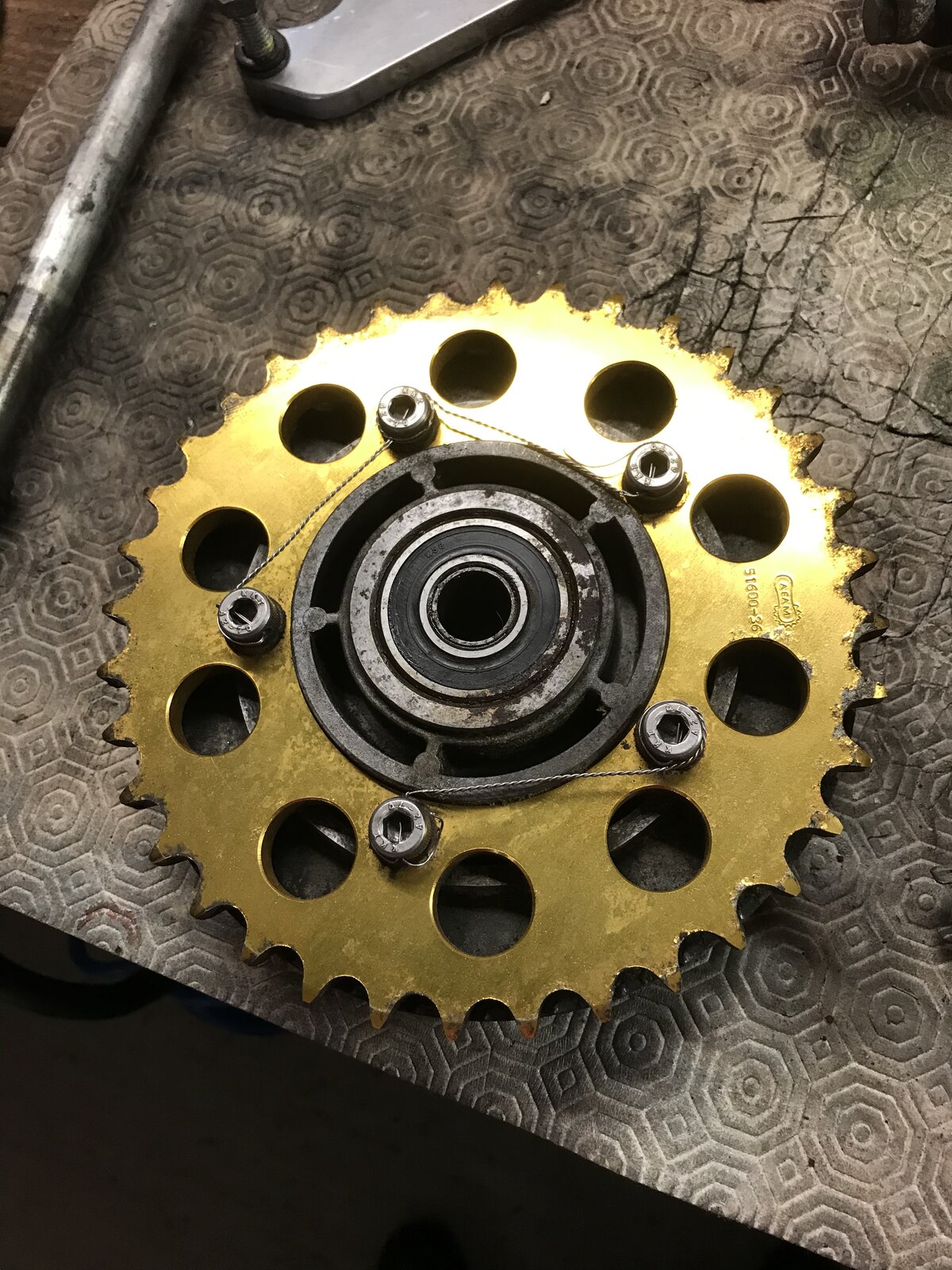

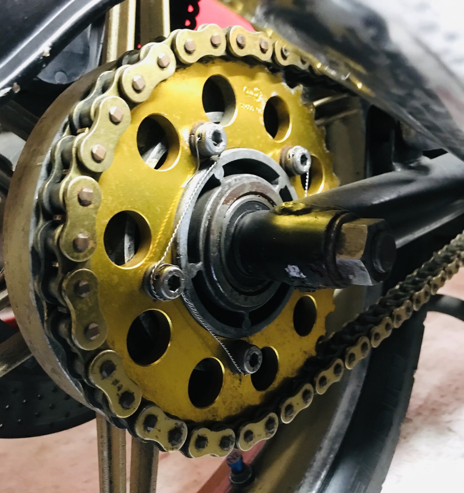

    Found almost new chain and sprockets. The rear sprocket is all wired up. Racing! :D
    0ADF390D-0AE7-4B85-84E6-41F340B1A820.jpeg 0DB65C7F-50CA-46CF-819F-585592AE9DAD.jpeg A78F9C37-1C8B-4622-BDAE-278EE329FCD5.jpeg

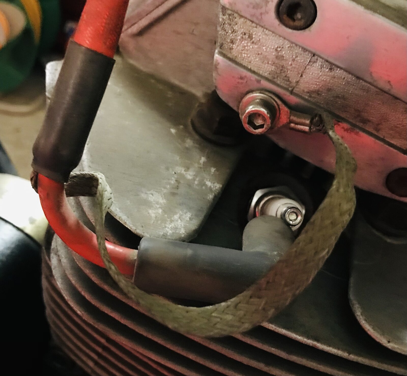

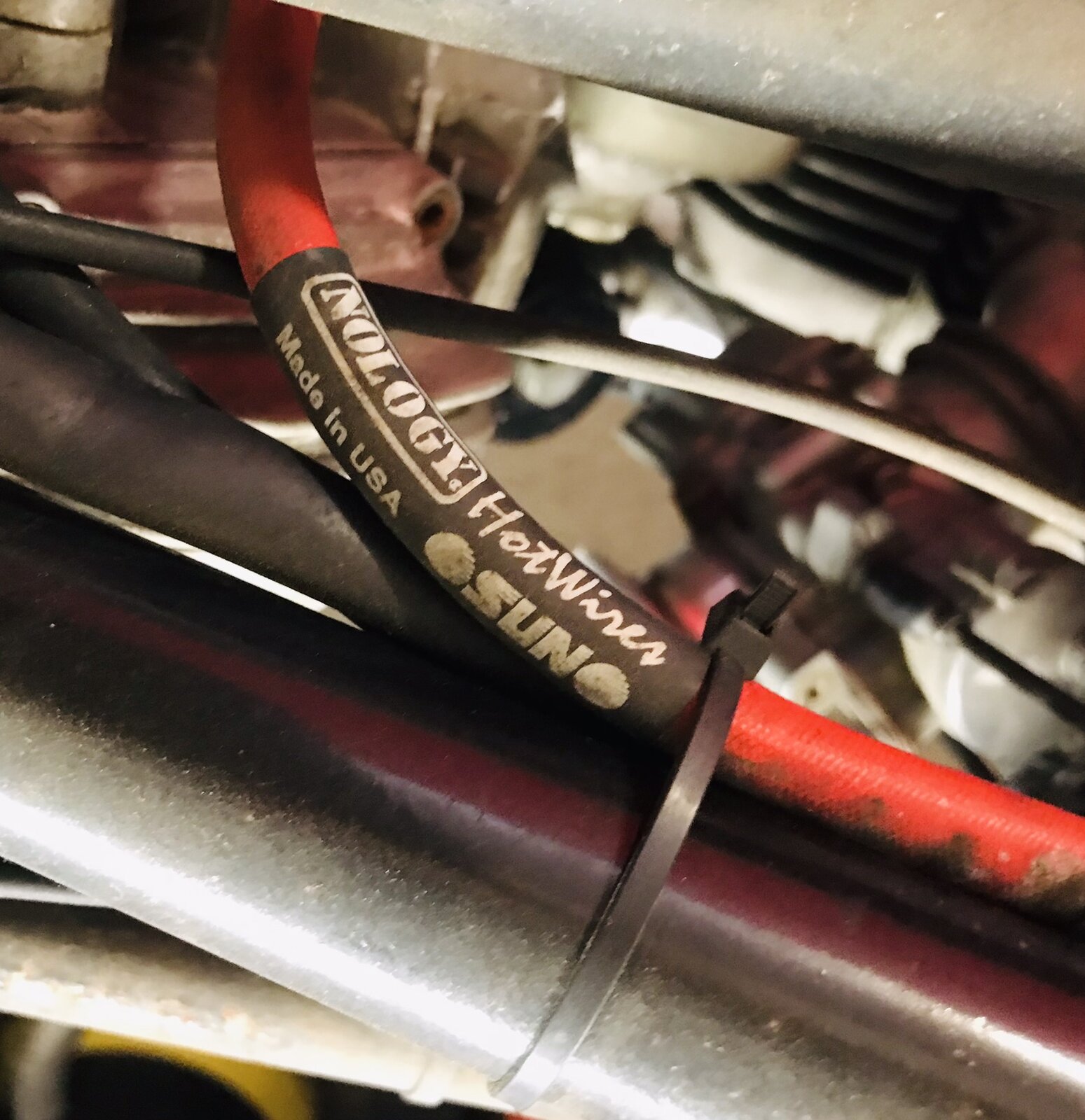

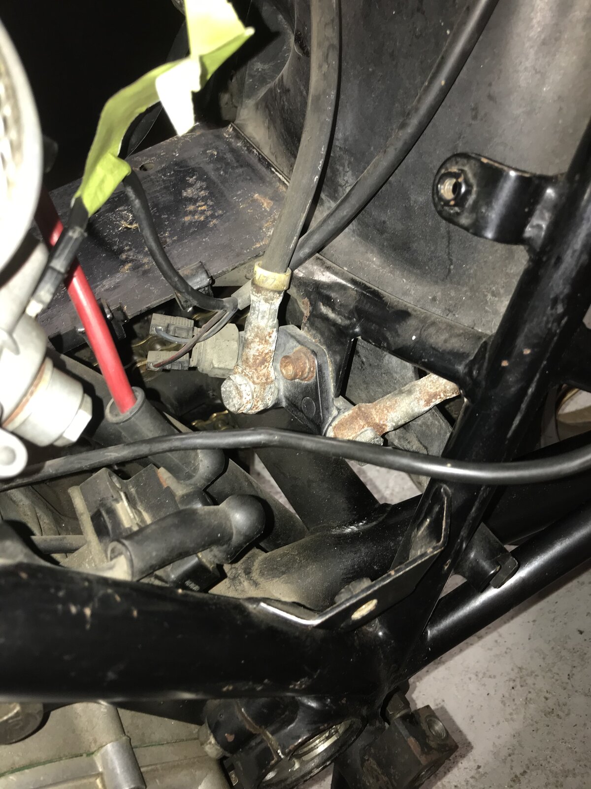

    And Nology « Hot Wires »! :cool: 46F4027C-47EE-4DA7-B45B-327D78D12274.jpeg F7F02E76-0BAC-4256-AF1F-AF377AFFC2CF.jpeg

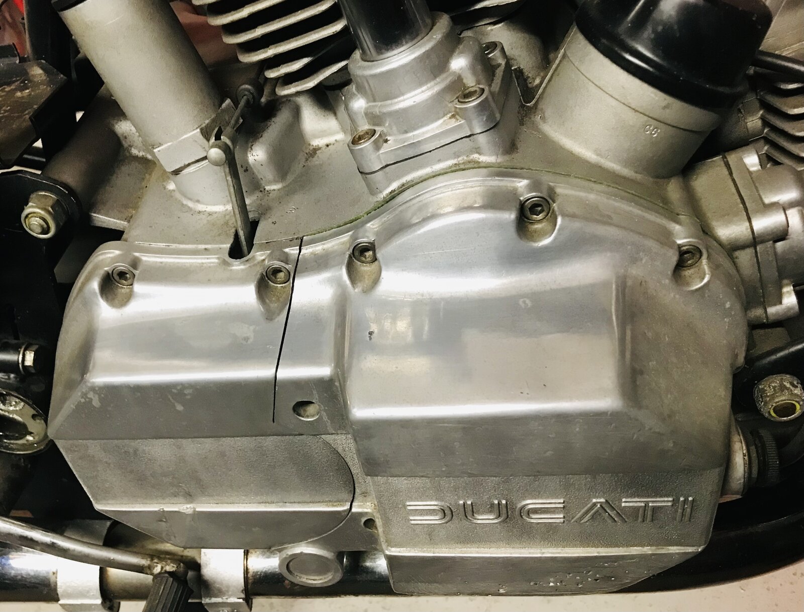

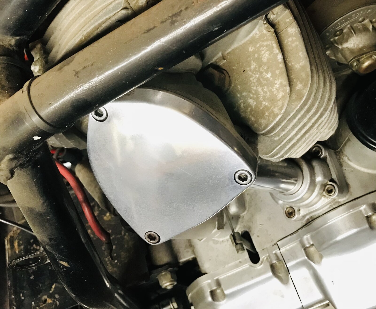

  17. The motor looks in a really good external shape, no oil leaks, and never opened. Unmollested. And as soon as you start rubbing 0000 steel wool, it shines like a mirror. I am going to love this!!! :D 56CF590A-19BC-4B3E-8CC7-CEDEBBB23045.jpeg E62B1B4F-85C8-4F64-A43B-75B77ECE581F.jpeg 19C225CC-9317-4D44-B54E-045F74BBB5A5.jpeg 7BFA3ECE-9716-4E5A-87FA-875EF7477B07.jpeg

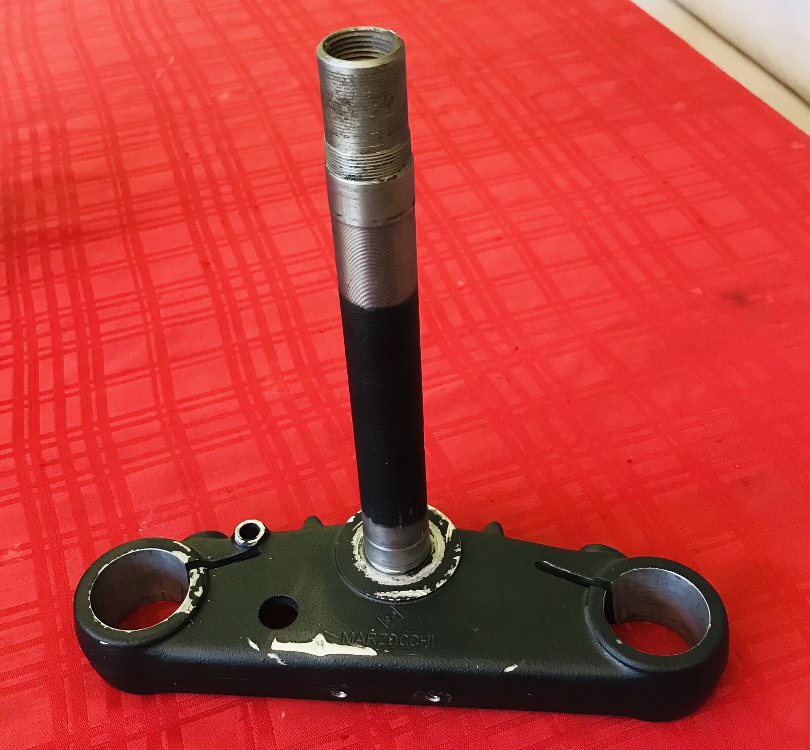

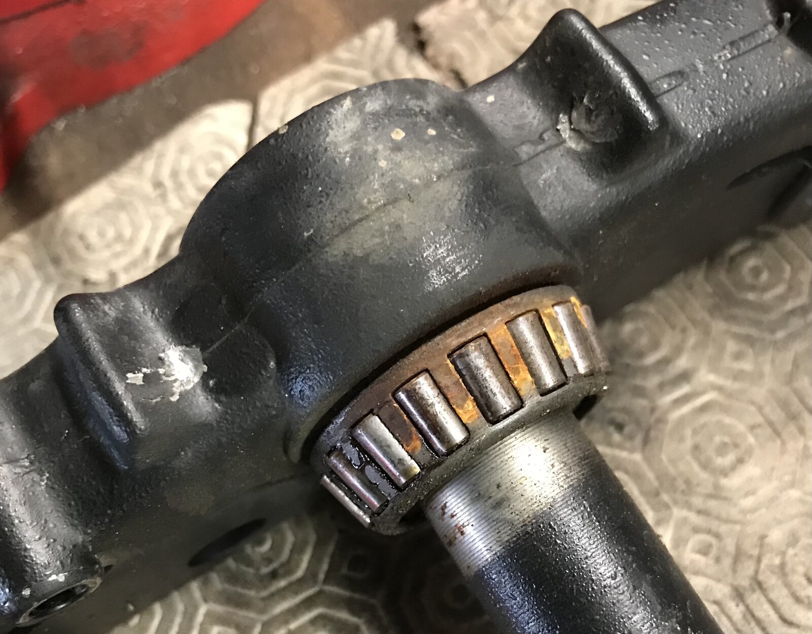

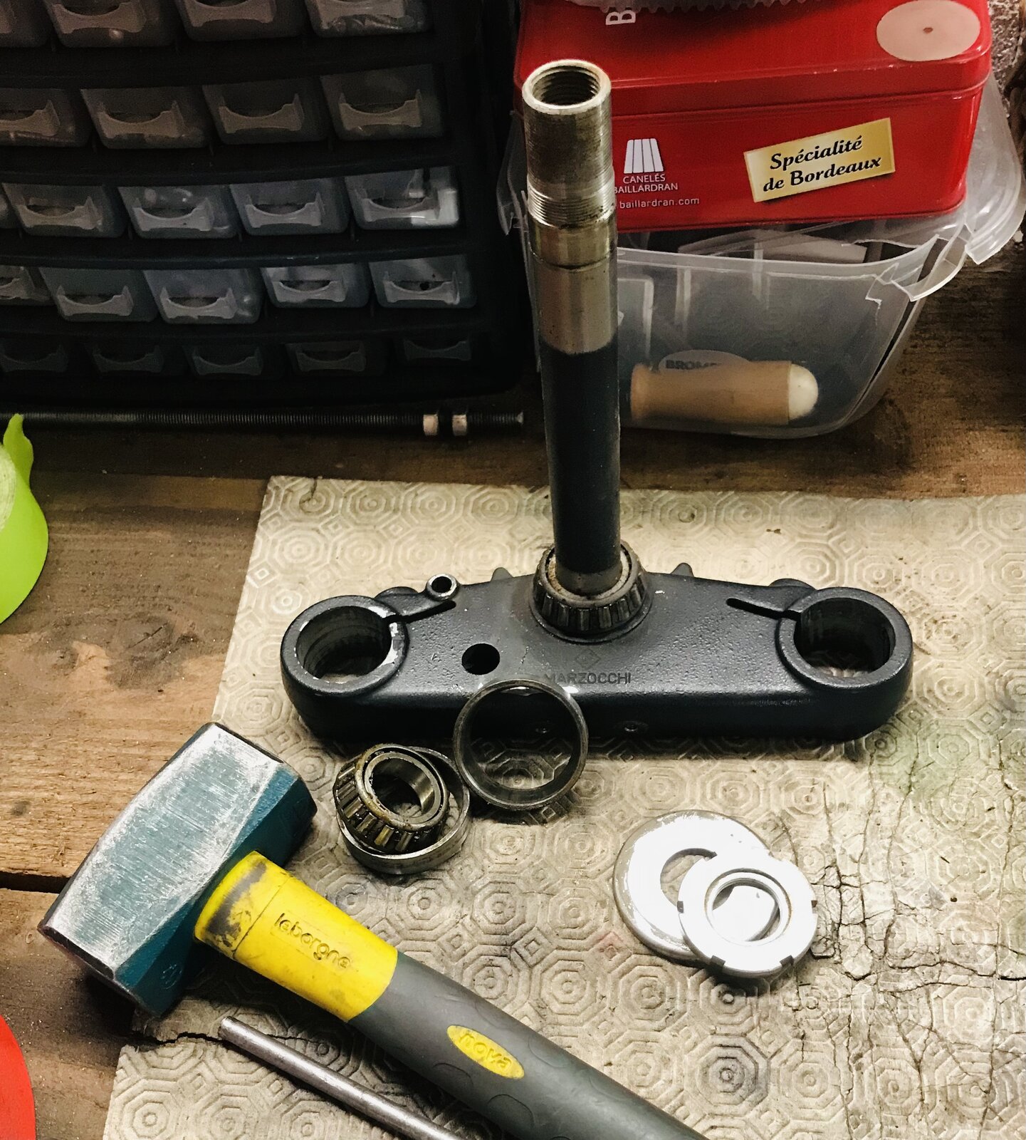

  18. Steering is already being taken care of, new bearings are on their way, along with the wheels and rear sprocket ones (4+2). 1437244E-8F70-4E02-885E-E59636C03954.jpeg
