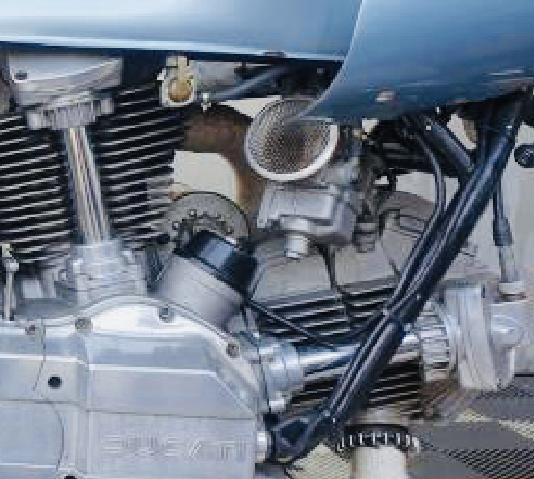

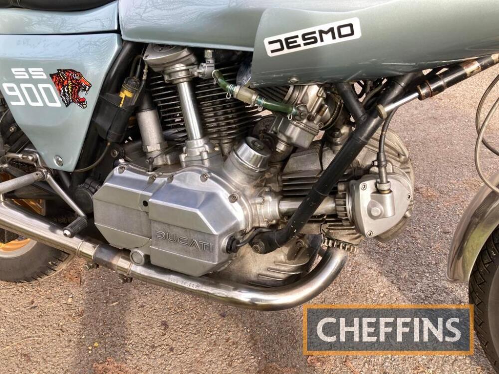

  1. Luckily for me I did it half way through the resto with the engine not yet in the frame so I helped my self to a slice of humble pie and put it right.
    If I recall correctly it's dead easy to swap it round by taking the heads off complete with bevel gears/shaft and undo the two screws holding the casting.
  2. @Pete1950
    What do you mean by « getting your leg pulled »?
    Here’s what it looks like. I don’t find anything out of order, personally. At least visually, I don’t find anything « shocking »… 57E2F360-08B5-4B78-B8C2-E396A4586488.jpeg
  3. Maybe Giuseppe had a little bit too much vino at lunchtime and its been that way round since it was built.
    I did exactly the same with mine, and after stamping my feet took it apart and fitted it the other way. Was the rear head as well.
  4. vive le difference:upyeah:
    • Useful Useful x 2
    Right…
    What popular bevel wisdom am I missing here, that makes the set-up shown by @DucatiScud look better than what’s on my bike?
    Is it some kind of « bevel étiquette » that I should be aware of, lest I get banned from the Bevel community for heresy?
    :D
  6. I would leave it and see how many people notice.
  7. Like a kind of « bevel snob » detector? :D
    More seriously, if there are no mechanical consequences whatsoever, I seriously doubt this was all planned by Fabio Taglioni to look one way or another.
    I am obviously eager to stand corrected in this, should I be completely wrong. After all, I am just another bevel noob…
  8. It's just that his picture shows two different parts - fins aligned with the airflow. Yours are both the same, so the vertical cylinder one looks wrong...
  9. On Facebook there is a group called "Your rear bevel tube retainer is the wrong way round". It consists of pictures of the (many) examples of bevel twin Ducati engines assembled in this way. You may be added ...
  10. There ya go! Now I am regretting not being on FB… :D
    From everything I read and what I understood, the parts are good. It’s just the vertical cylinder one that should be rotated 180 to expose the other face.

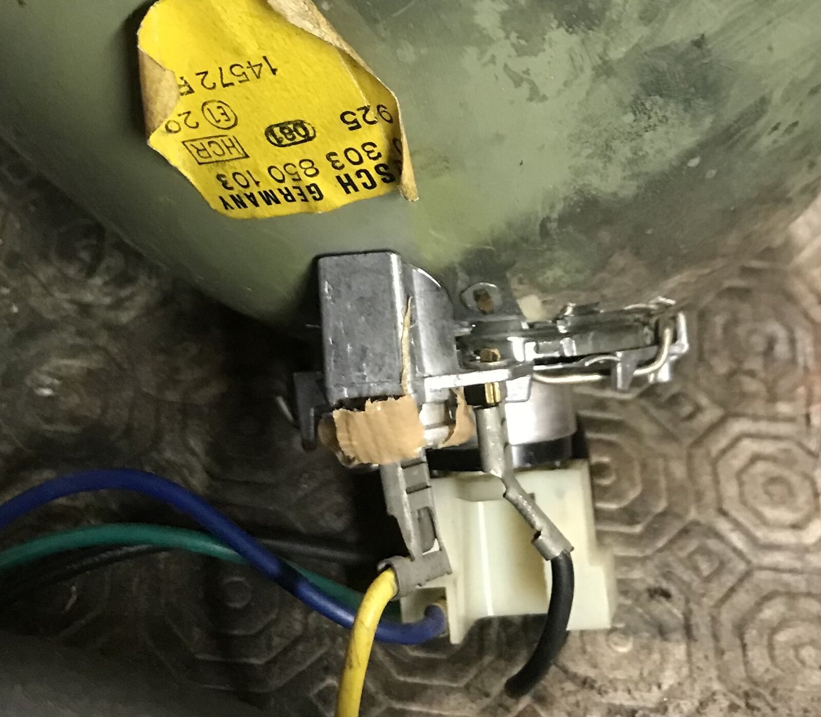

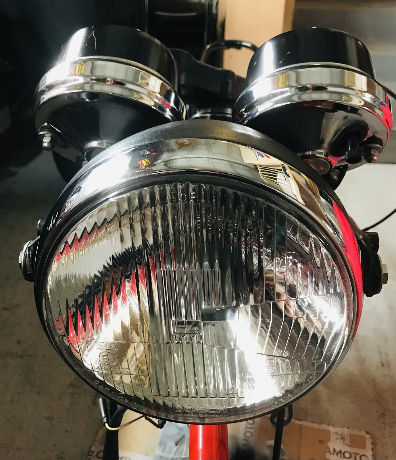

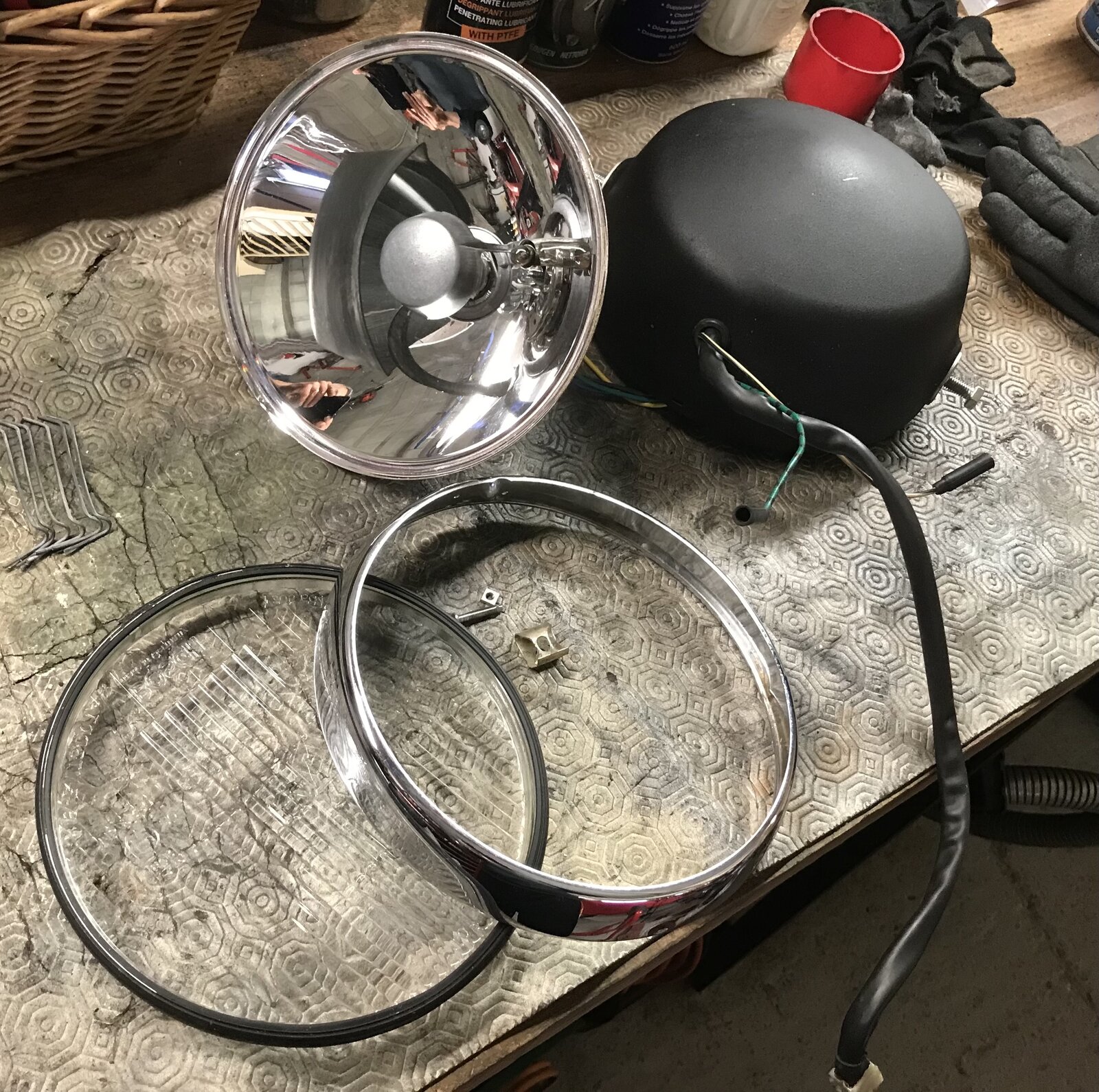

  19. Today, vintage Bosch front light clean up/refurb. Not much to do really, as everything is in beautiful shape. 3BA66895-DE9B-4B3F-BCF1-2C51954115D3.jpeg EBC2D696-F17B-4926-A891-305A95755AA8.jpeg ACCF0BE2-56C3-43DD-BB63-1BF614EEF95C.jpeg
