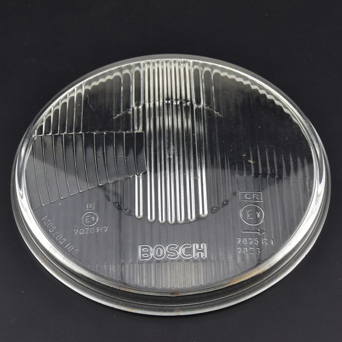

  1. If the lens has an arrow pointing to the left (kerb) then the lens is for a rhd motorcycle, if there is no arrow, then the lens is for a Lhd motorcycle.
    Not sure what the protocol is on recent bikes where the headlight lens is ‘universal’, possibly a double ended arrow.
    Much easier to get a lhd replacement than a rhd one, old BMW boxer suppliers are a good source.
    If you ride with your lights on, either by choice or rule of law, worth considering a LED headlamp bulb which draw around 30w, gives your old alternator and possibly switch gear an easier ride. Make sure you get one that gives some form of beam pattern, the cheaper ones deliver no pattern at all.

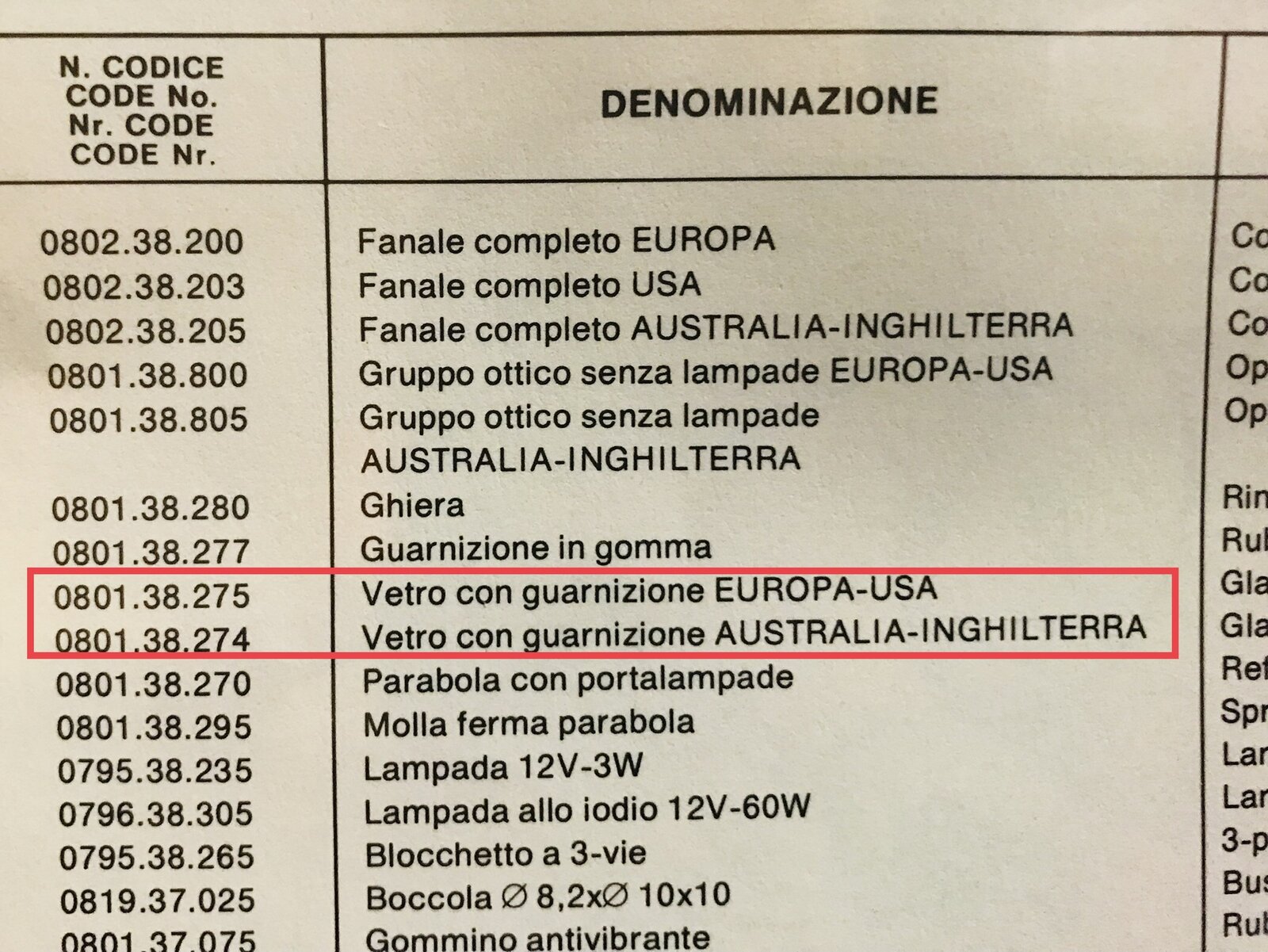

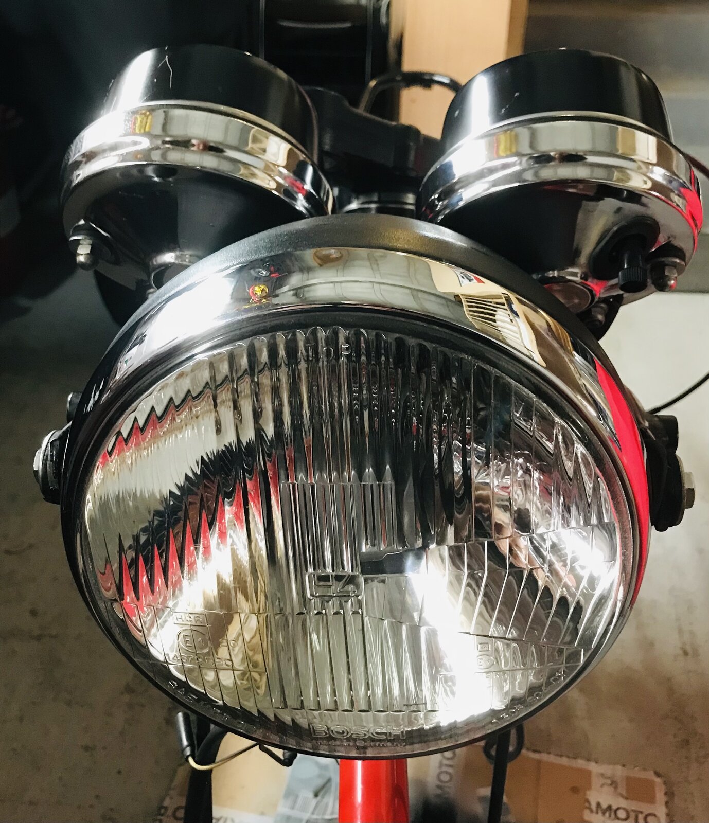

  2. This is exactly the lens I have. Looked it up with ref. 1.305.604.017 found on it.
    https://www.ebay.com/itm/372795890309
    The SSD parts catalog shows two different references for lhd and rhd, as it should. 047E4630-3219-4661-9A43-C4AB76104921.jpeg
    Still have to figure which one I have, but the bike coming from Japan (and probably from Australia or NZ before that), it should be lhd…
    Anyways, I no longer ride at night. Rule of law in France is for bikes to ride with lights on even during day time. I use high beam by choice. Bikes seem to be invisible to people in cars. So it’s become a matter of safety for me…
  3. Japan is a RHD country Guillaume! As are Aus and NZ.
  4. The lens on your lamp is a RHD one. If you look at the facet in the lens adjacent to the 4 in H4, that is for a RHD vehicle. If that almost triangular facet was adjacent to the H in H4, it would be LHD.
  5. I believe I have a lamp in my garage from a 93/4 monster you are welcome to?
  6. Thanks a lot for your kind offer, but I have no desire to replace the OEM lamp. :upyeah:
  7. I think the lens you have listed is a right hand dip for a lhd vehicle, as it doesn’t have an arrow on the glass which would point to the kerb (left hand dip) as fitted to a rhd vehicle, per the example below, arrow under the E mark.
    As such the one you have looks correct for France.
    Even if it’s the original lens, doesn’t mean the bike was not delivered to a rhd country, as in those days if they didn’t have the correct headlight for the country, I think they just fitted whatever was in the parts bin…..
  8. In Japan, England, Australia, NZ, etc. all vehicles drive on the left side of the road, don’t they? I assumed this is what you guys called LHD… A bit confused about the naming now. I guess LHD refers to the side on which the wheel is found inside a car then? Which doesn’t apply to a motorcycle…right? :D
    As @Mr Bimble mentionned just above, I do not have the little left pointing arrow on my lens. And the whole « drawing/facet/dip » inside the glass is symmetrically opposed to the picture he posted. So…
    I guess I’ll figure it out when I switch the light on for the first time, and see on which side the beam goes higher. which is the curb side (for a better view of road signs et all…).
    #208 Guillaume69, Feb 16, 2025
  9. No. It refers to the side of the car that the steering wheel is on and can be a little confusing! As to the headlamp, it's not the arrow per se, it is the way that the lens is designed.Look at the picture immediately above of yours, then look at the one posted above it by Mr Bimble. Mr B's is for EU / USA / LHD countries, yours is a UK / Aus / NZ / Japan et al RHD countries. Focus on the triangular almost section of the lens - that's the bit which decides how the dip or cutoff works. I think you're going to have to get a correct lens for the headlamp, if only to fit it just for the Controle Technique as the RHD one will fail on the beam pattern when tested.
  10. I am pretty sure the pic posted by @Mr Bimble is actually for Australia/England/NZ/Japan RHD countries, as he explains (little arrow pointing left etc.)
    Just to confirm, I went and checked my 851 lense. That bike never left the EU (Austria > Germany > France). And the little « triangular » shape is on the left. I believe it’s role is to lower the beam of light on that side (to prevent blinding opposite traffic drivers). It’s just like on my Darmah’s lense. So there is no more doubt for me now. It’s a EU/LHD lense. ;):upyeah:

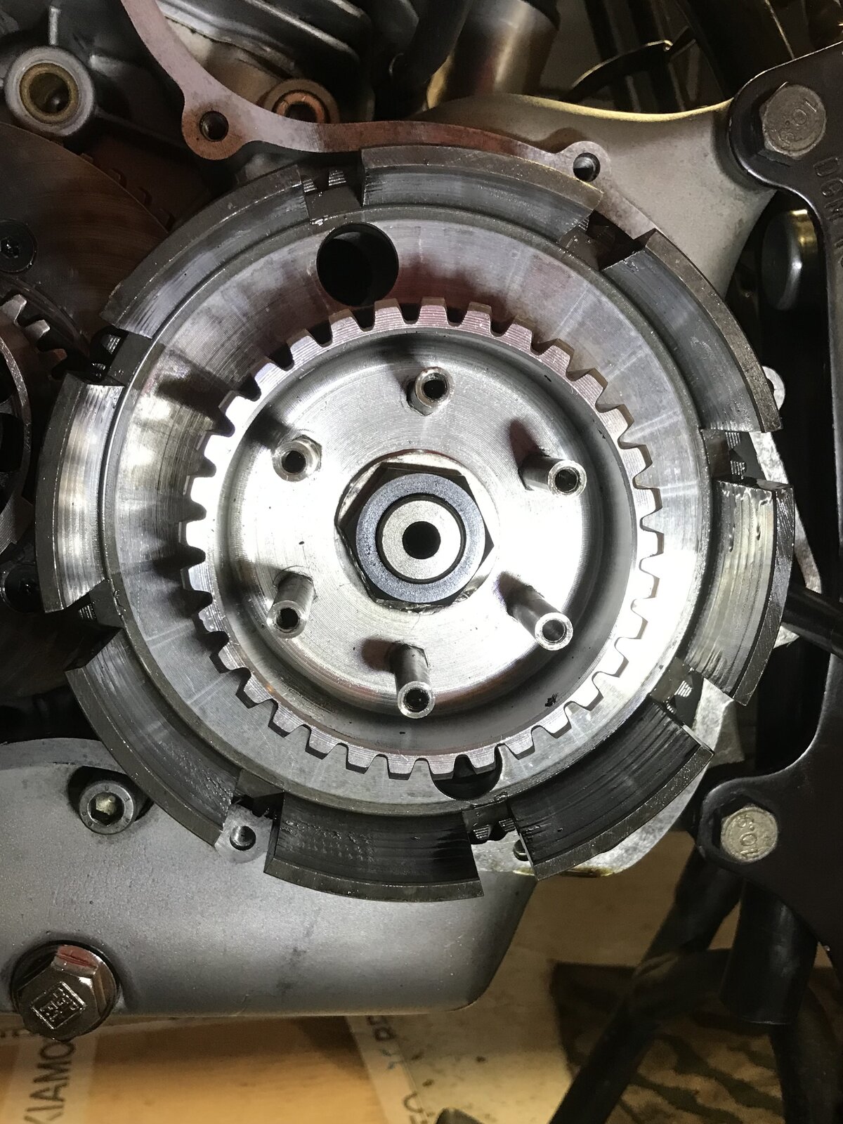

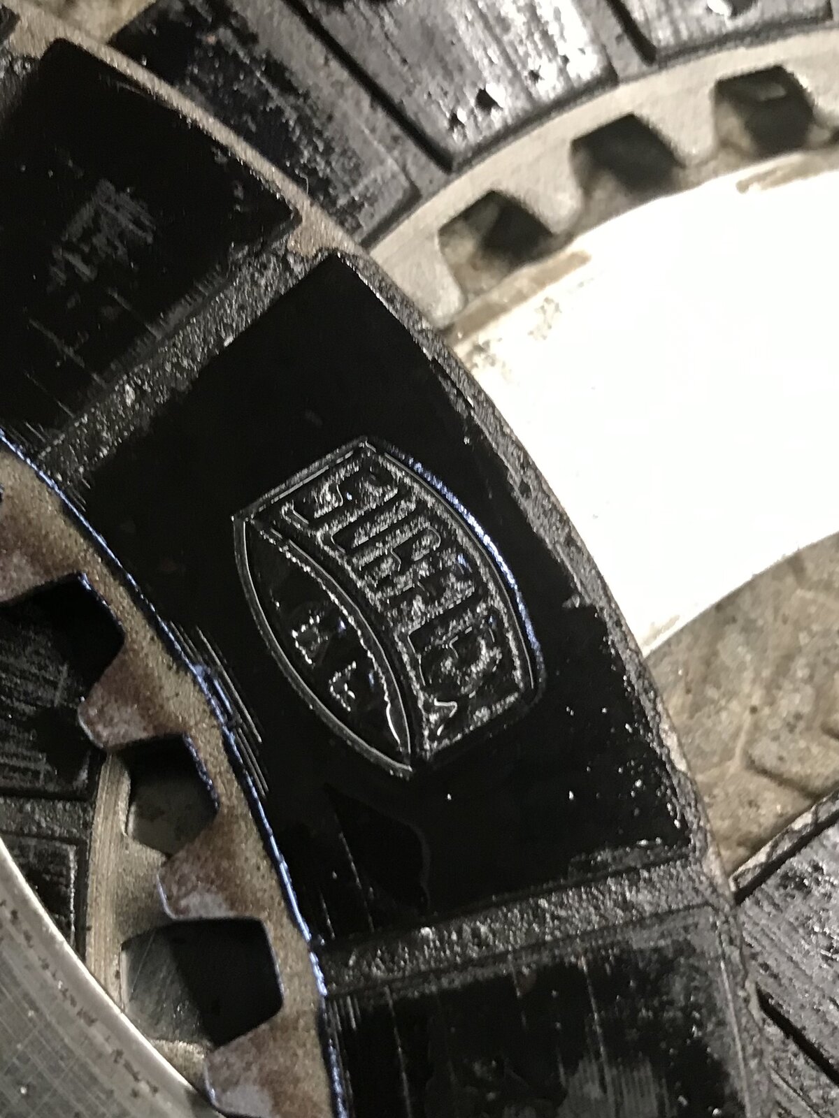

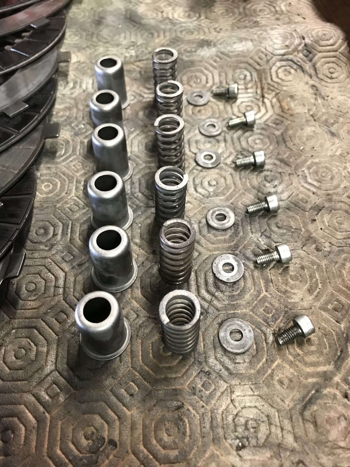

  15. Well… while you were pondering whether you would google this lense nonsense or not, I went and looked into the clutch.
    Very happy with what I found in there. Everything looks as new. Friction discs are « Surflex » branded, clutch pack is 40mm thick and springs look healthy at a 29.5-29.9 mesured height.
    9B932A14-A551-48AA-898E-3AA57799365D.jpeg 0E7A2AFD-613D-406D-A641-E3171C900672.jpeg A19D0F52-2FD3-4C21-9C16-DA01E9A997F1.jpeg 3D28C909-396C-40EF-92DA-2A69A53B3452.jpeg

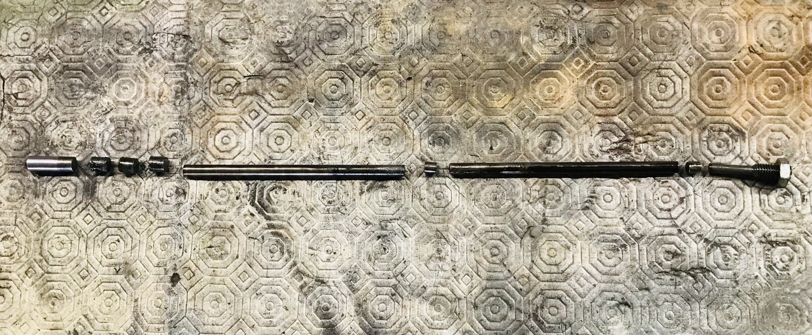

    I fiddled with the troncated push rod, cleaned and greased up. I was anticipating more drama with this one, but it went pretty well after reading this: https://forum.bevelheaven.com/viewtopic.php?f=50&t=92
    And also realizing that if everything goes out pushed left to right when removing it, the small diameter bits need to go back through the left (clutch) side and the bigger diameter ones through the right (sprocket) side. Very simple.
    With this done, sprocket is back on. Looking good ! :cool: 30A572A2-3CB3-49F3-8AF3-9534951321BC.jpeg
  16. The first time you take the bike for a full throttle blast, you will find out whether the clutch slips or not. Hope not, but if it slips it's pretty quick to slip in a new clutch plate stack.

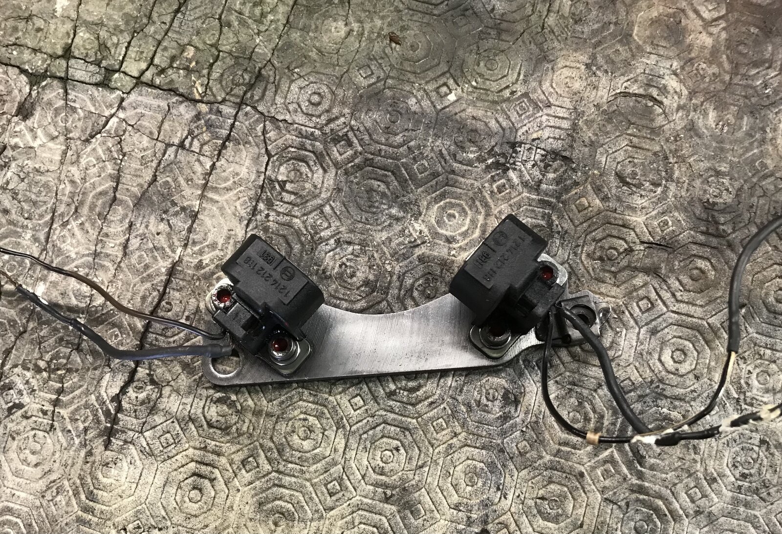

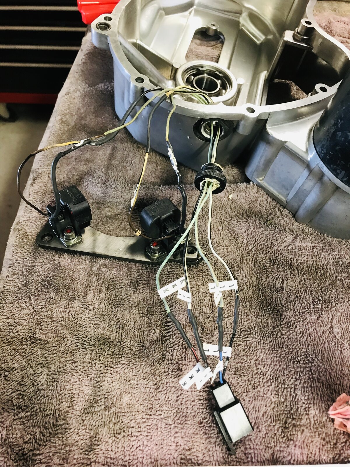

    And the new challenge is pick-ups wiring!

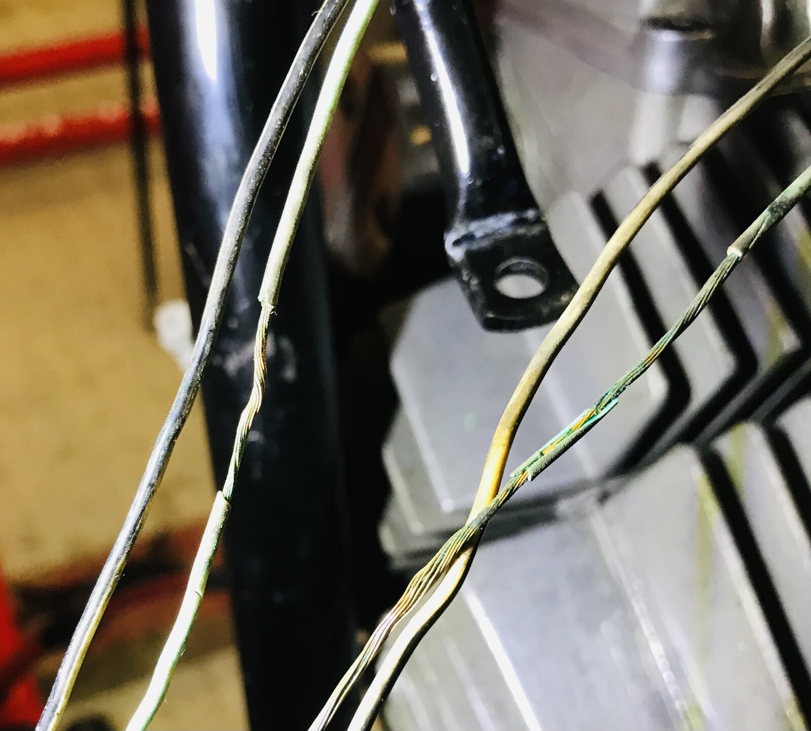

    Investigations started. Below clean heat shrink protection, the wires have already been tampered with in two locations: just by the sensors, but also a bit further up where a 4 pin connector has been added. Probably a first attempt to solve ignition cutoffs due to electrical shorts. Without much surprise, OEM wires insulation is toast… 415F5047-7A30-4030-A42D-6BCDB243DC65.jpeg
    The good thing about owning the pickup set-up tool is being able to remove the pickups plate without a sense of Doom… It’ll be much easier to work on the wires now. 6FA6C89C-AE77-4851-BCBD-162003A37696.jpeg

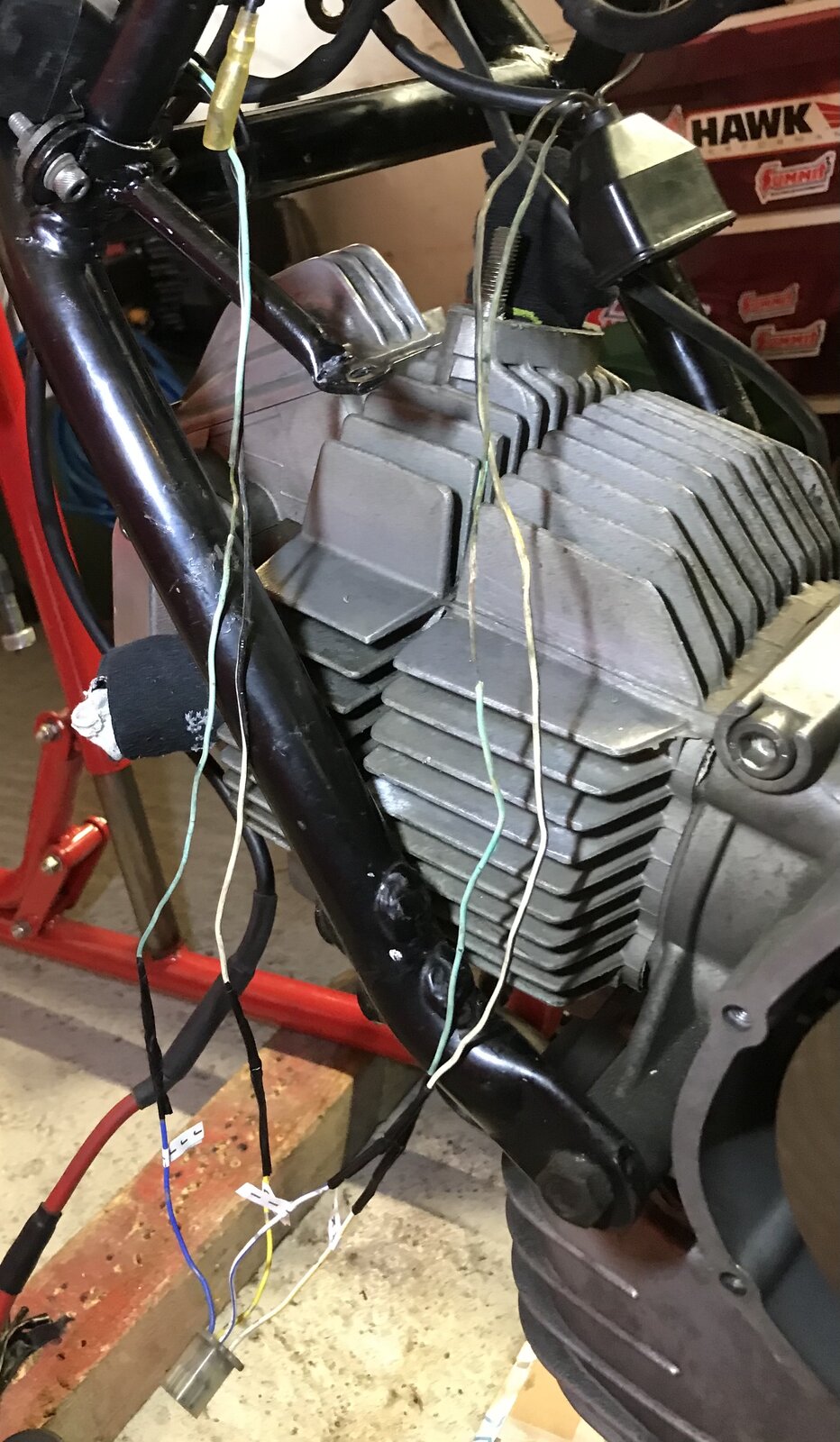

    The not so good news is that the wiring loom on the bike’s side is toast too. First the new connector addition but most importantly, the insulation on the way up to the Bosch ignitors is partially gone. These wires will need replacing too, using the exact same method as for the pickups wires. 421B5251-EBBD-493E-86D3-A1431D20F792.jpeg ECD9D720-1801-4B1B-8FD1-2745B3590A85.jpeg
    I wonder if the Bosch infamous reputation on bevels could not be entirely linked to these ill-aging wires.
    Like ill-tuned Weber carbs on 900SS from 1989-1990.
    Or under-wired starter circuits on the 916 bike family (aka sprag-clutch busters).
    « Ducati » does rhyme with « electricity », but for worse rather than better…
