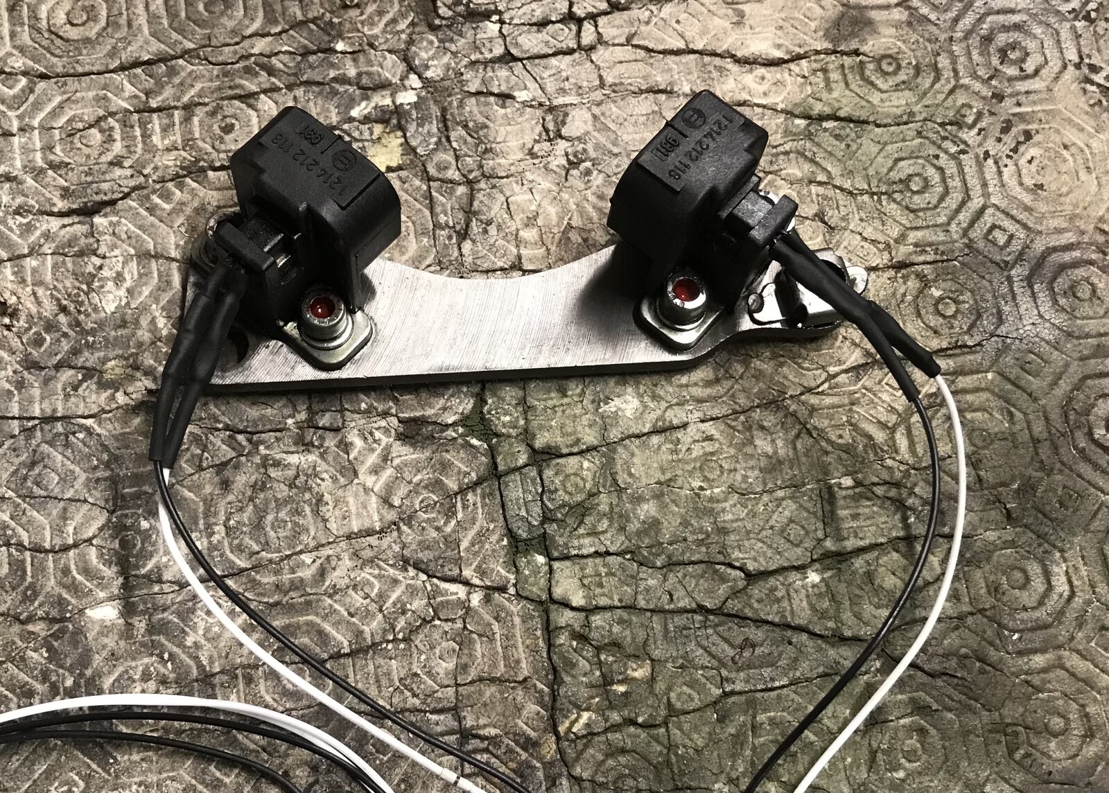

  3. Make sure you get the wire polarity the right way round
  4. Yeah, I have been very cautious about this. I have marqued each wire (old/new) individually on both sides, sketched the whole thing on paper, checked 8 times before launching myself into this…

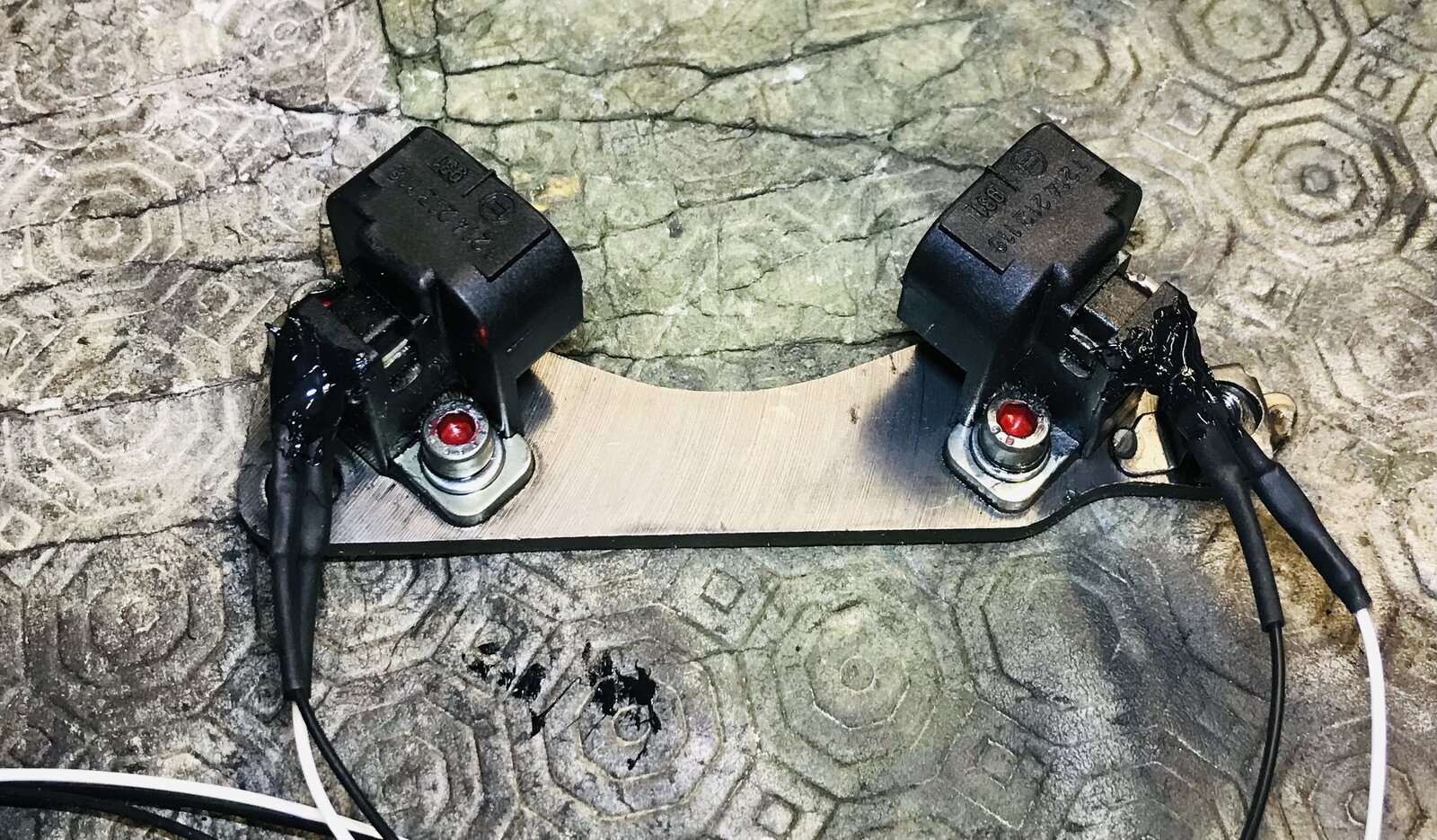

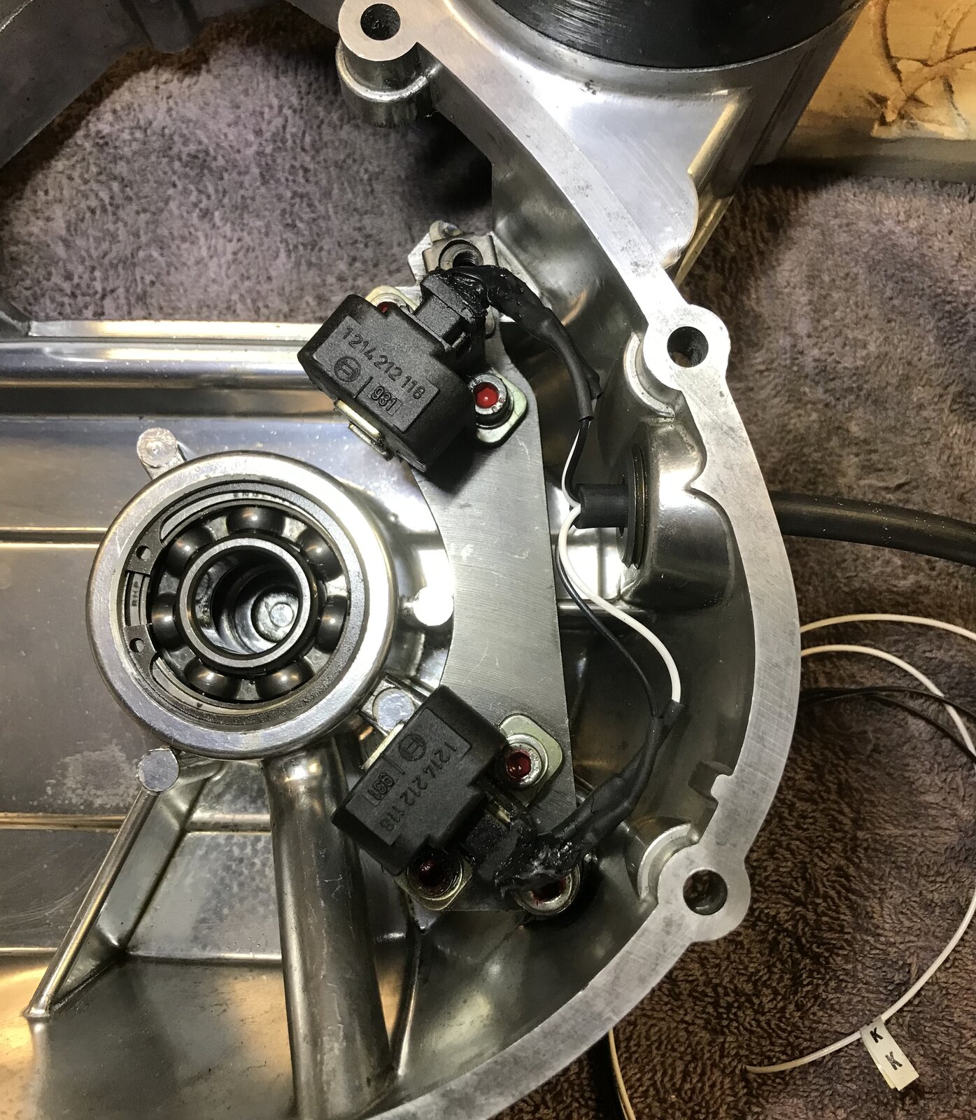

    Here’s the cover side done. RTV curing now.
    4913F8F1-90CE-468A-8736-2B59F9C485BC.jpeg 8DD3BB00-2D0A-419E-B582-B8881AA1AB39.jpeg

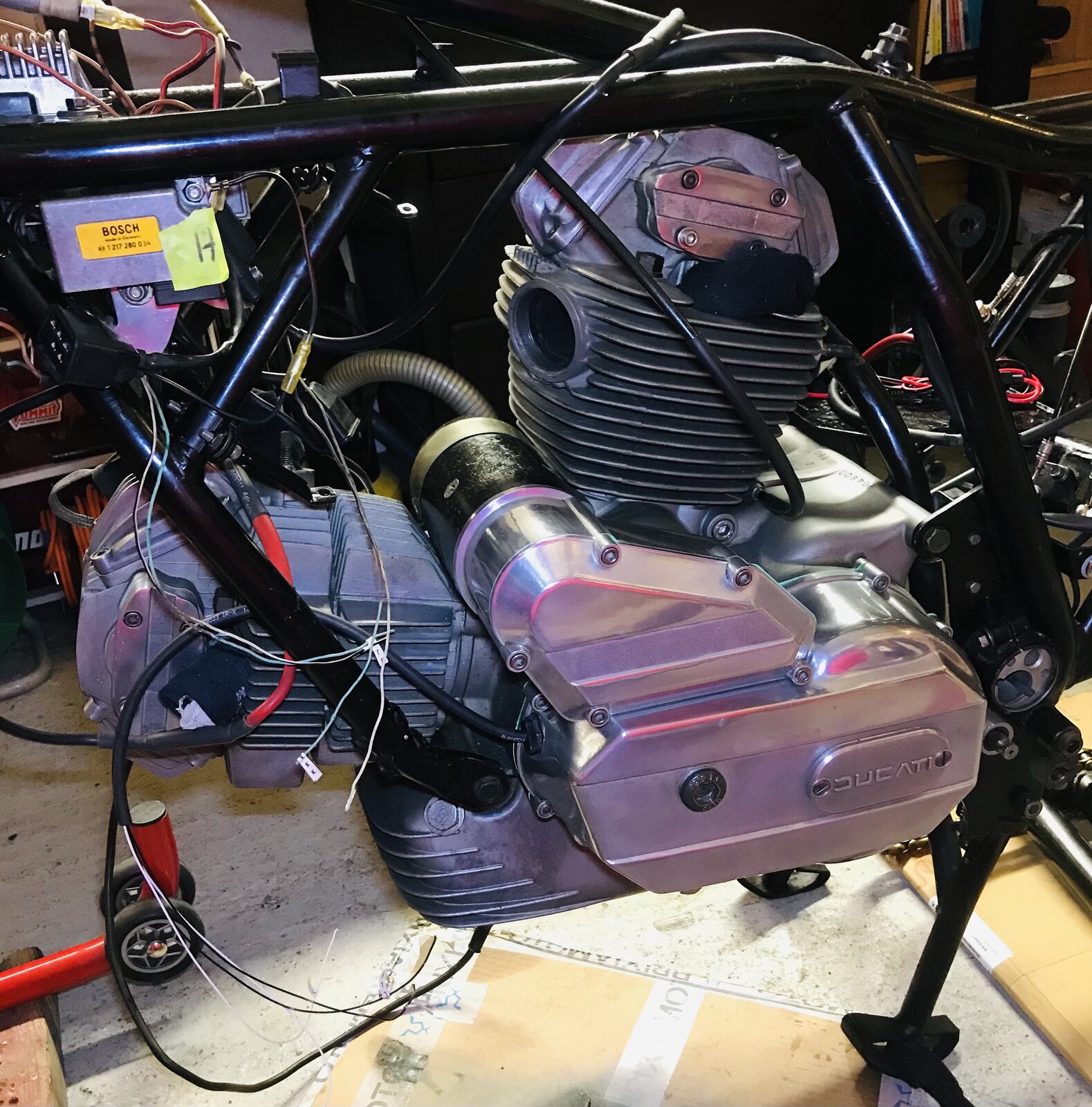

  5. We’re almost there. Setting up the pickups and the cover goes back on. At last! 9943A9F6-1841-432B-BC6B-ADF7C8DE7AE7.jpeg

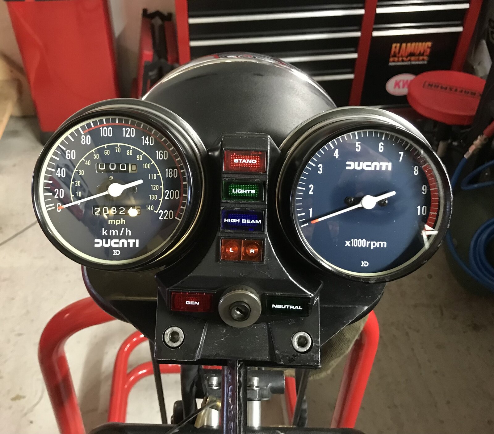

    In the meantime, I received these beauties… :cool: 7D573748-E49E-44CE-B181-324E5F8F34D7.jpeg

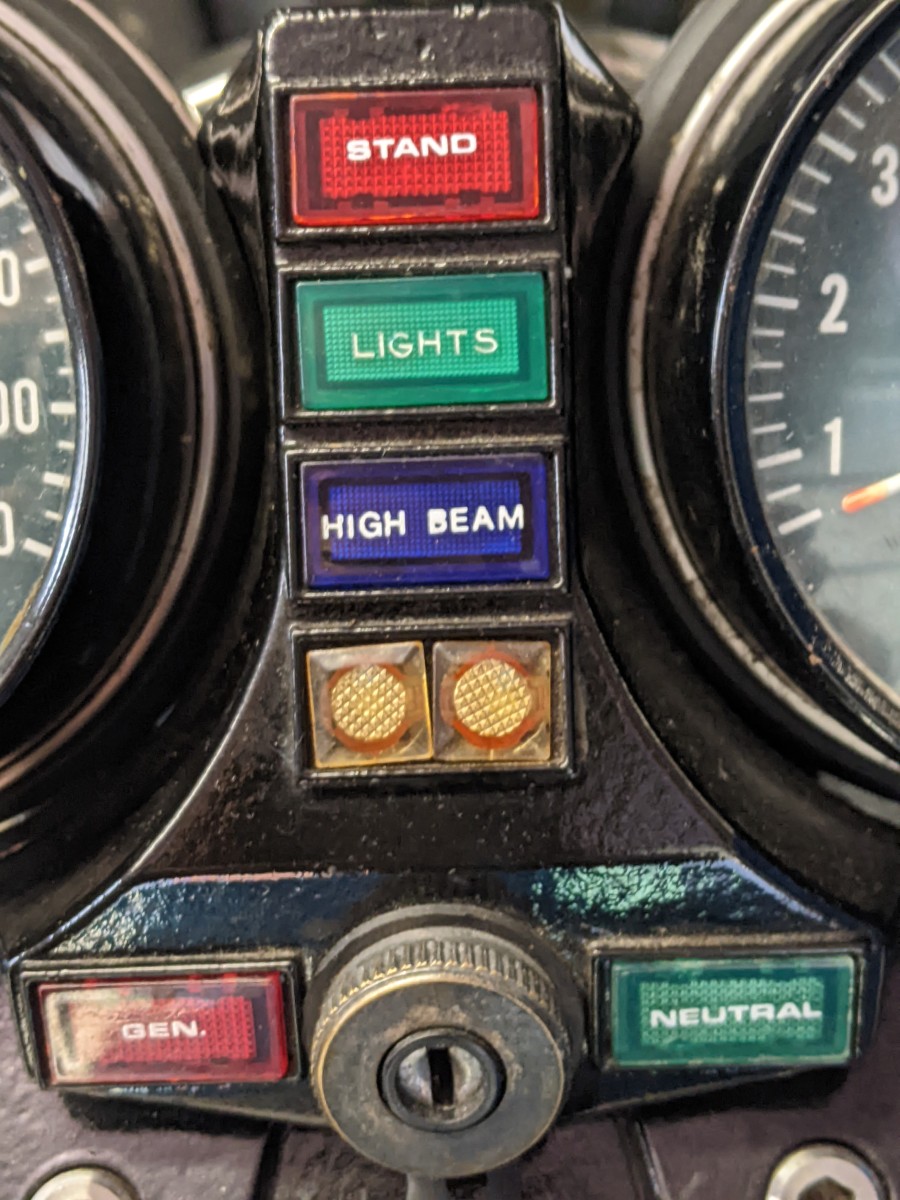

  6. I wonder if the L & R will sit square unlike the OEM ones.... :grinning:
  7. I’ll let you know. What I can tell you is these feckers are a tight fit into the casing…
  8. Yeah, from what I can remember there is a little 'ramp' type effort in the plastic with a gap at the top that provides the push & locking mechanism.
    The wires inside the casting are themselves a real tight fight and some time spent forming them into the gaps is beneficial.
  9. Here! @Andy Bee
    What do you think? Square enough?
  10. 9F48D479-1240-418E-8EA7-6B5C74B4A502.jpeg Black magic. Voodoo even… :D

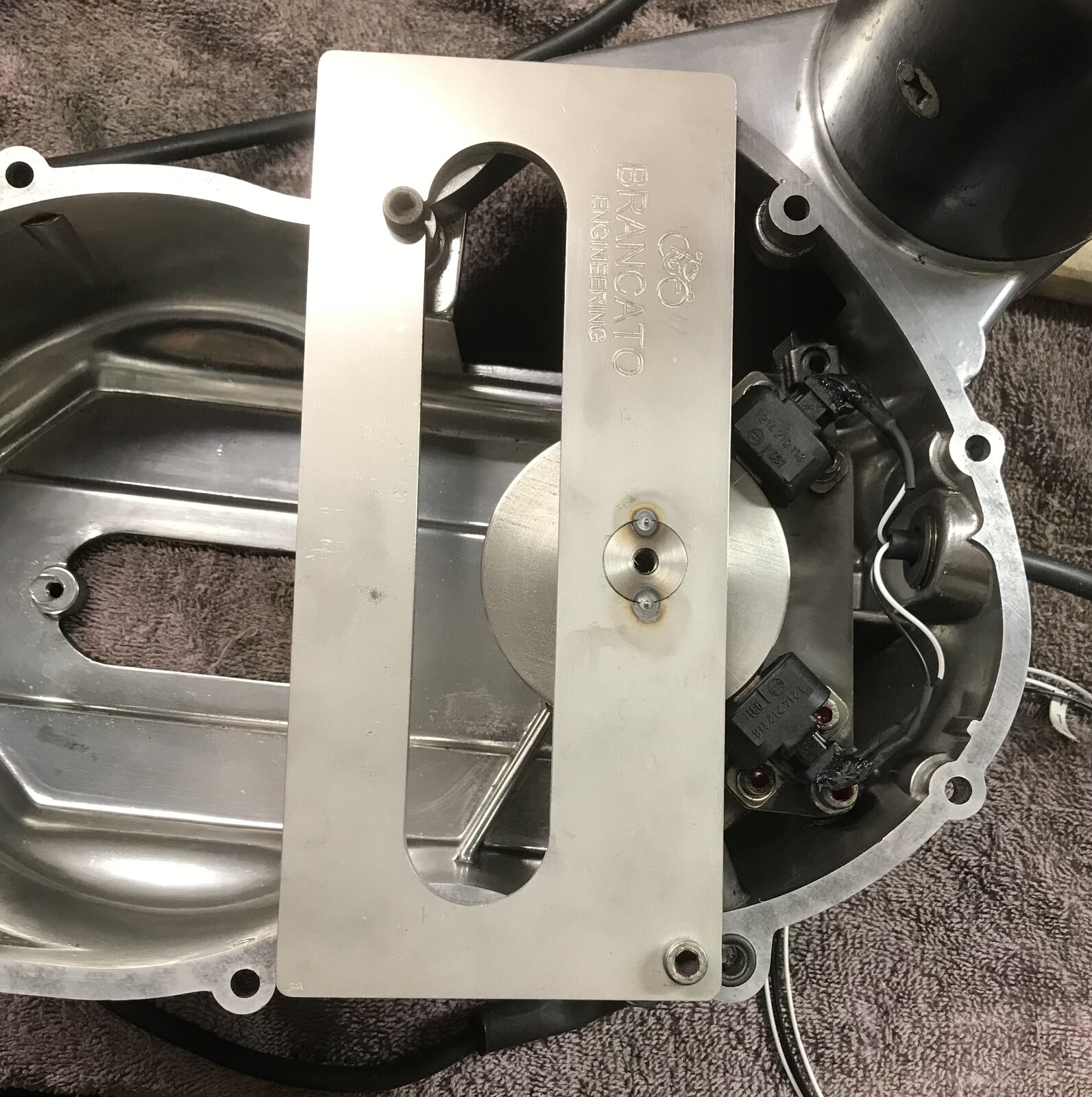

  11. So Brancato Engineering says 0.05-0.10.
    The Darmah WS manual says 0.04-0.05.
    I am tempted to go for 0.05mm. What do you, Bosh ignition Gurus, recommend ?
  12. Looks good to me :grinning: btw what did you use on the headlight shell to get that shine?
  13. I'm no guru on the Bosch ignition but I suspect Tony Brancato is....
  14. WD40… ;)
  15. So, where between 0.05 and 0.10 then? Right in the middle I guess?
  16. I'm gonna assume it's the same as any clearance range so anywhere between the max & min would be acceptable?
  17. Ho hum... :D
  18. I settled for a nice 0.07mm. That’ll be good enough.
