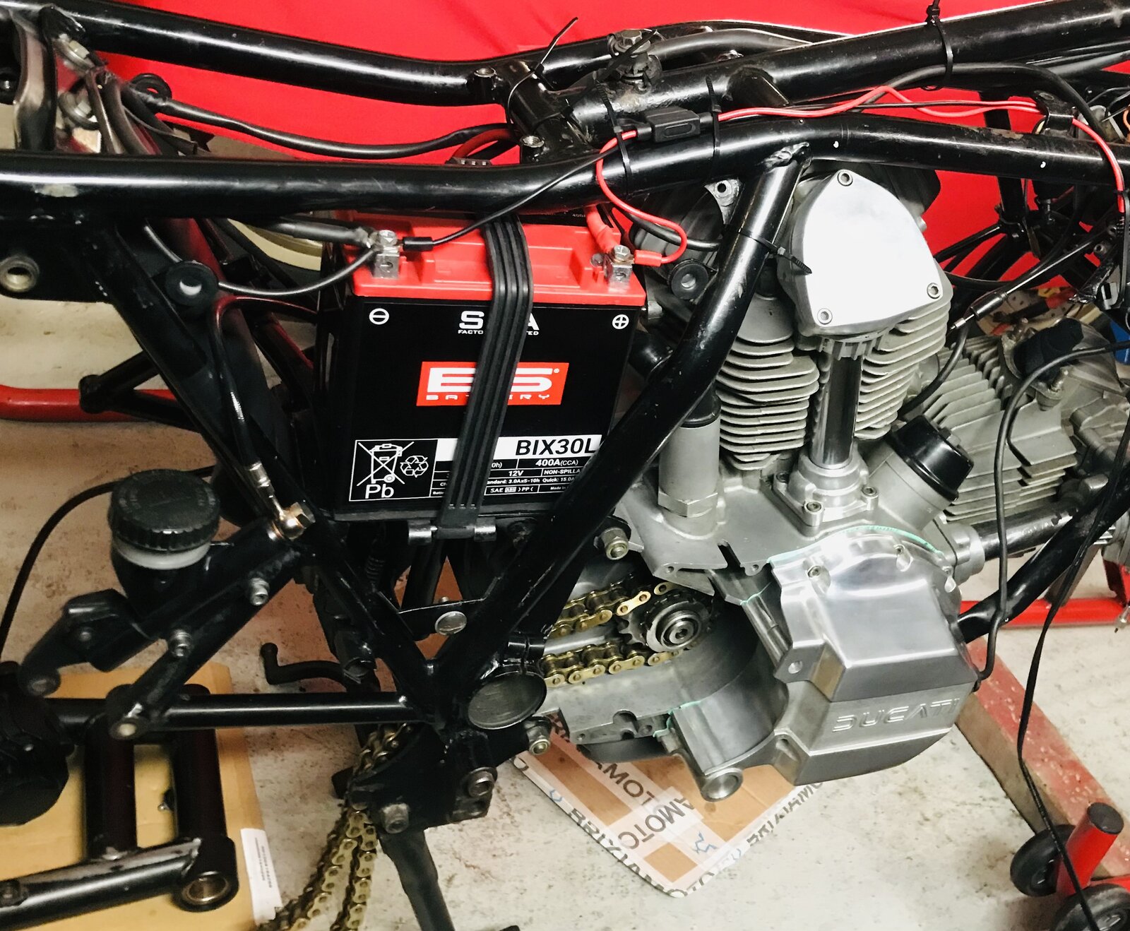

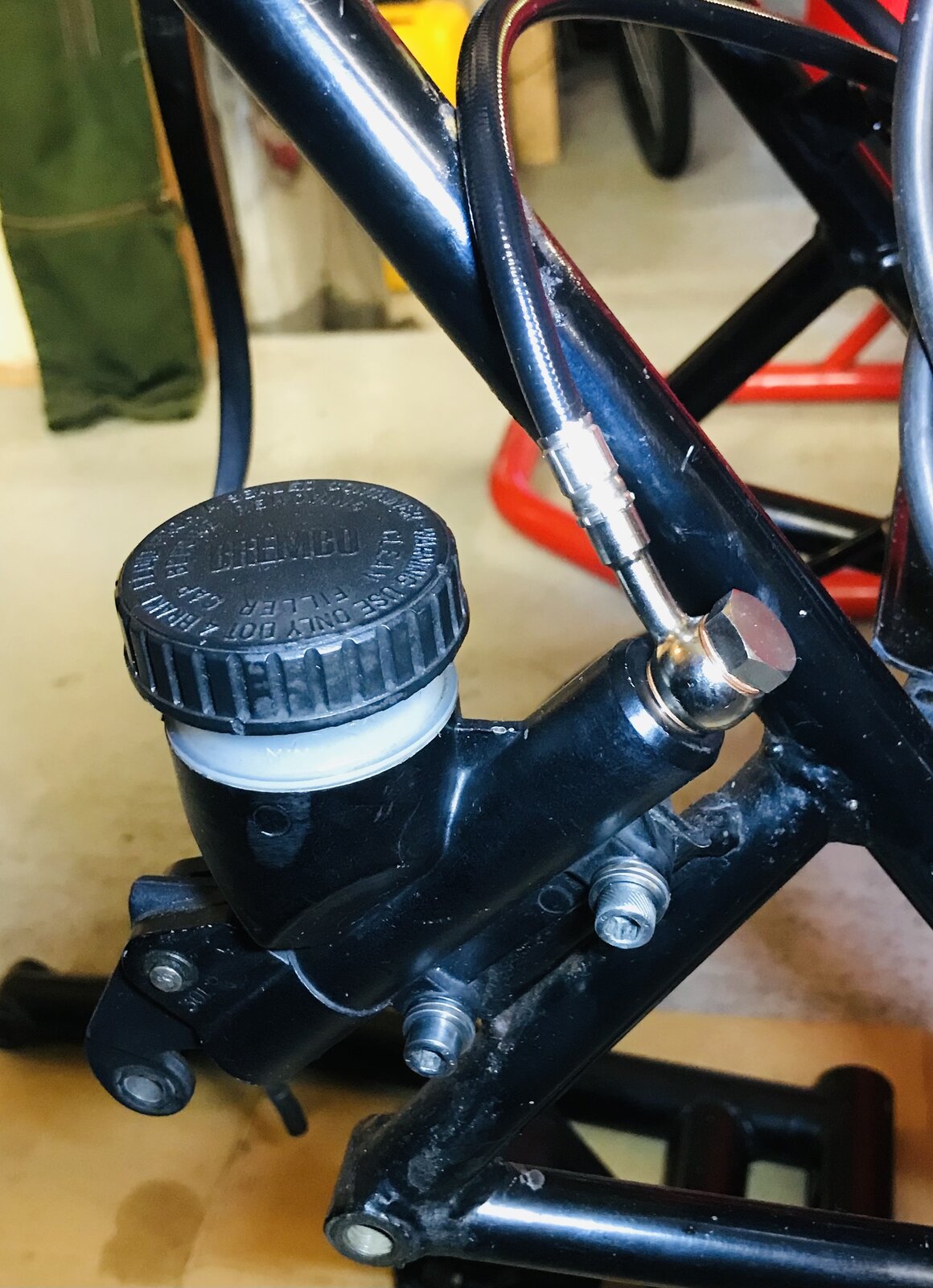

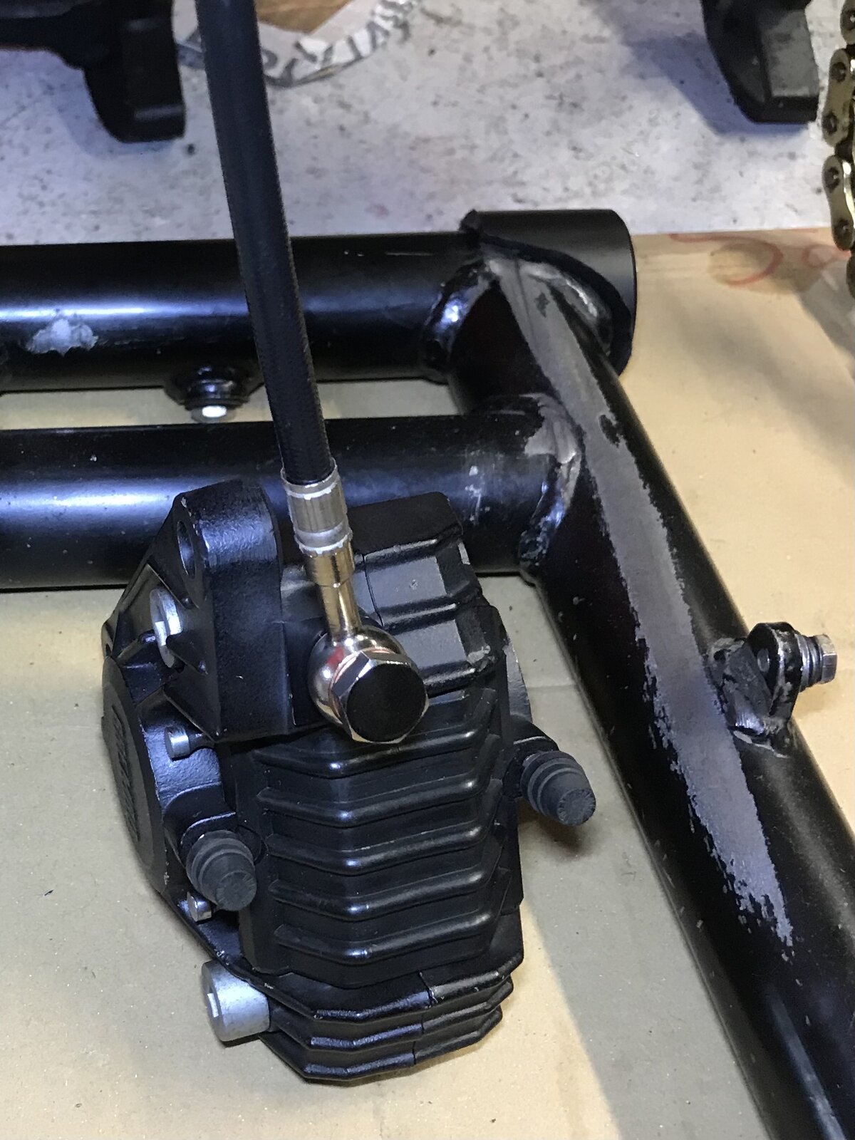

  1. I have started to get shiny things back on that SSD. Rear brake, with brand new Galfer braided hoses. DDE991D8-B10C-49A2-8DBB-7D8EA9C637E1.jpeg A99A6E1C-A800-4BE3-8CA0-4685CFDA2E74.jpeg

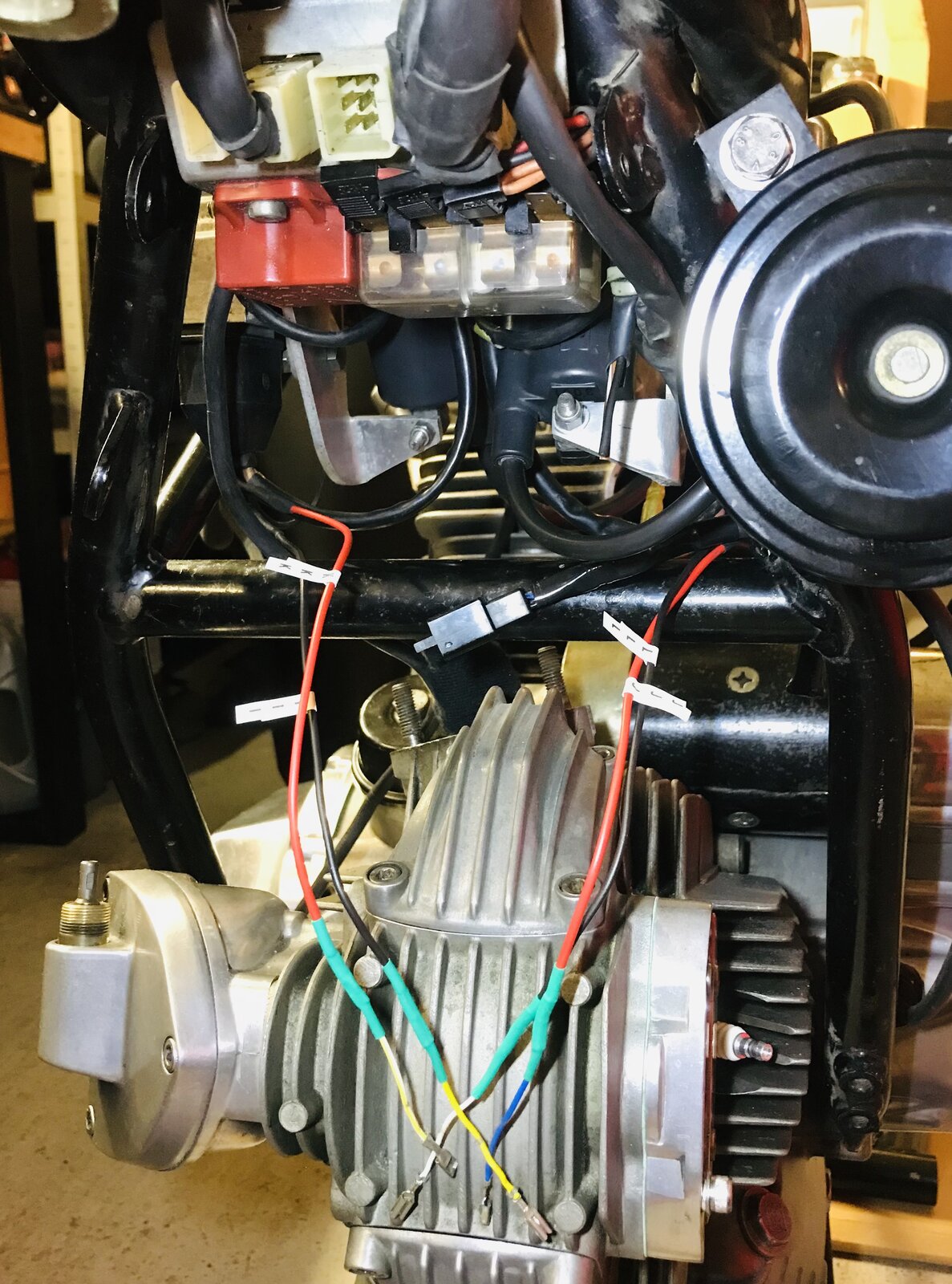

    And I am almost done with the refurb of the pickups wiring. I decided to preserve the original 4-way connector that I chose to locate up front, away from the vertical exhaust header. Just waiting for some heat proof cable protection to wrap this up. 4A57970C-DF0E-46BA-A9CB-849E25769CEF.jpeg
    And the battery is waiting, ready for the soon coming series of electrical tests.

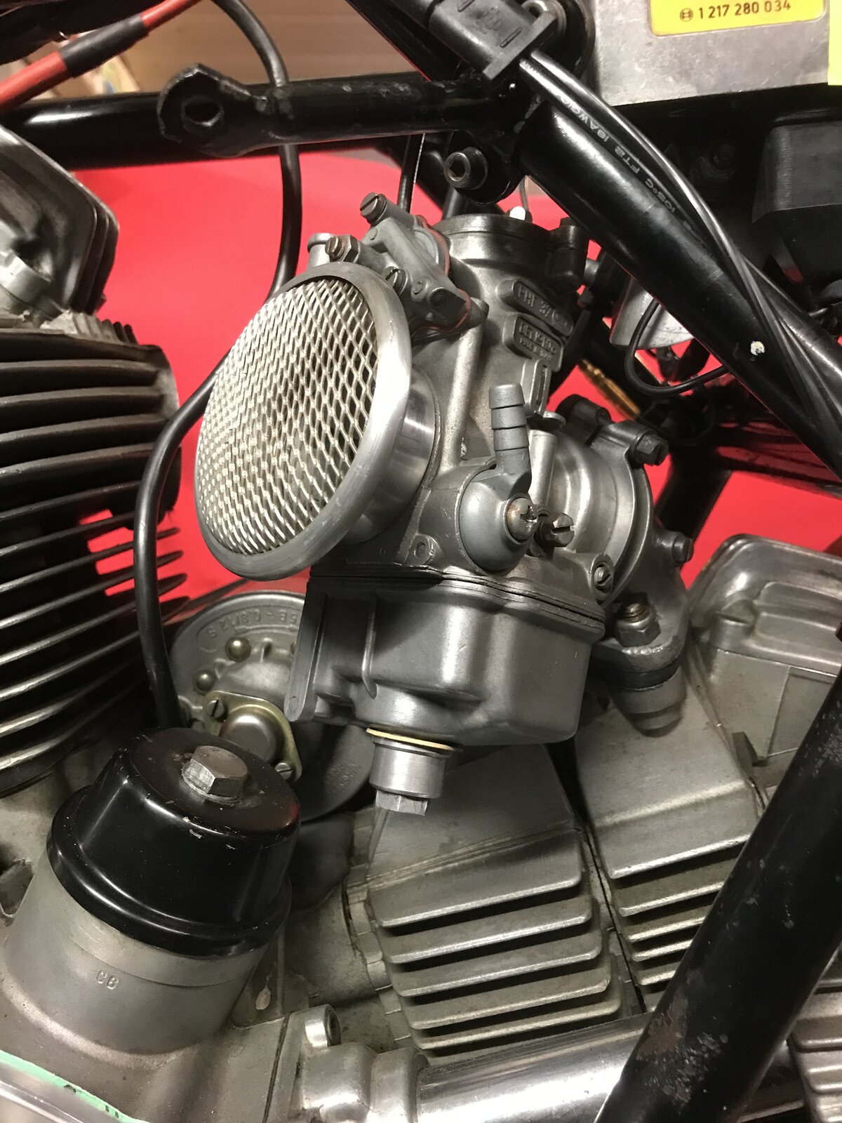

  3. Cleaned and refurbed carbs are back on, with nice new intake gaskets.
    6AB94103-C0E7-4055-A928-356E5C6AE6DA.jpeg 31306D05-5DA9-4BA0-8B4D-AC897AE600D7.jpeg

  6. Those rubber inlet manifold spacers always split sooner or later. Keep a spare pair ready for when they do.
    • Useful Useful x 2

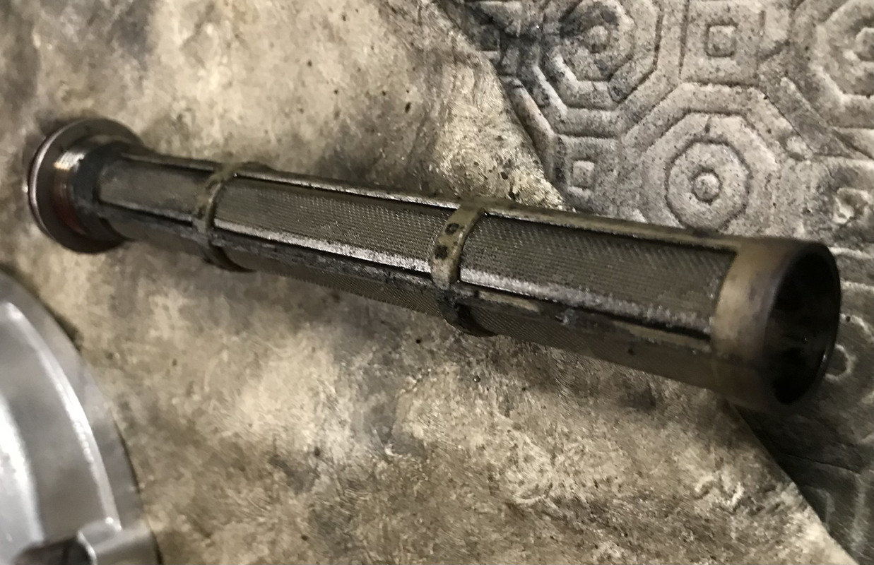

  7. Not sure if you have done it already, or are planning to do it, but clean out the sump filter before you bolt in the rear cylinder header pipe....
  8. They do but it can be compounded by bolting them up too tight in the first place.
  9. Andy,
    What sump filter are you referring to?
    #249 Guillaume69, Feb 26, 2025

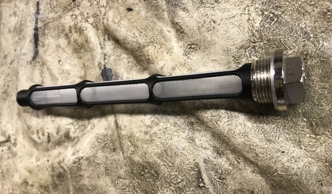

  10. There's a (21 mm) nut underneath the LHS engine cover. This is a long gauze filter that sits in the sump and is (internally) connected to the oil pump on the other side of the engine.
    You can get aluminium ones, rather than the OEM plastic, which are a lot more sturdy.
  11. Oh I see, yeah, this guy: DD040CA7-9613-400D-A001-54F9D4C15EC7.jpeg
    It’s been replaced by this guy, a while ago. :upyeah:;)
  12. This is a really nice part right there. It was out of stock when I purchased my new one, but I will see if I can get one now as I have an order in progress with Mdina Italia.
    Thanks for the tip @Andy Bee . :upyeah::)

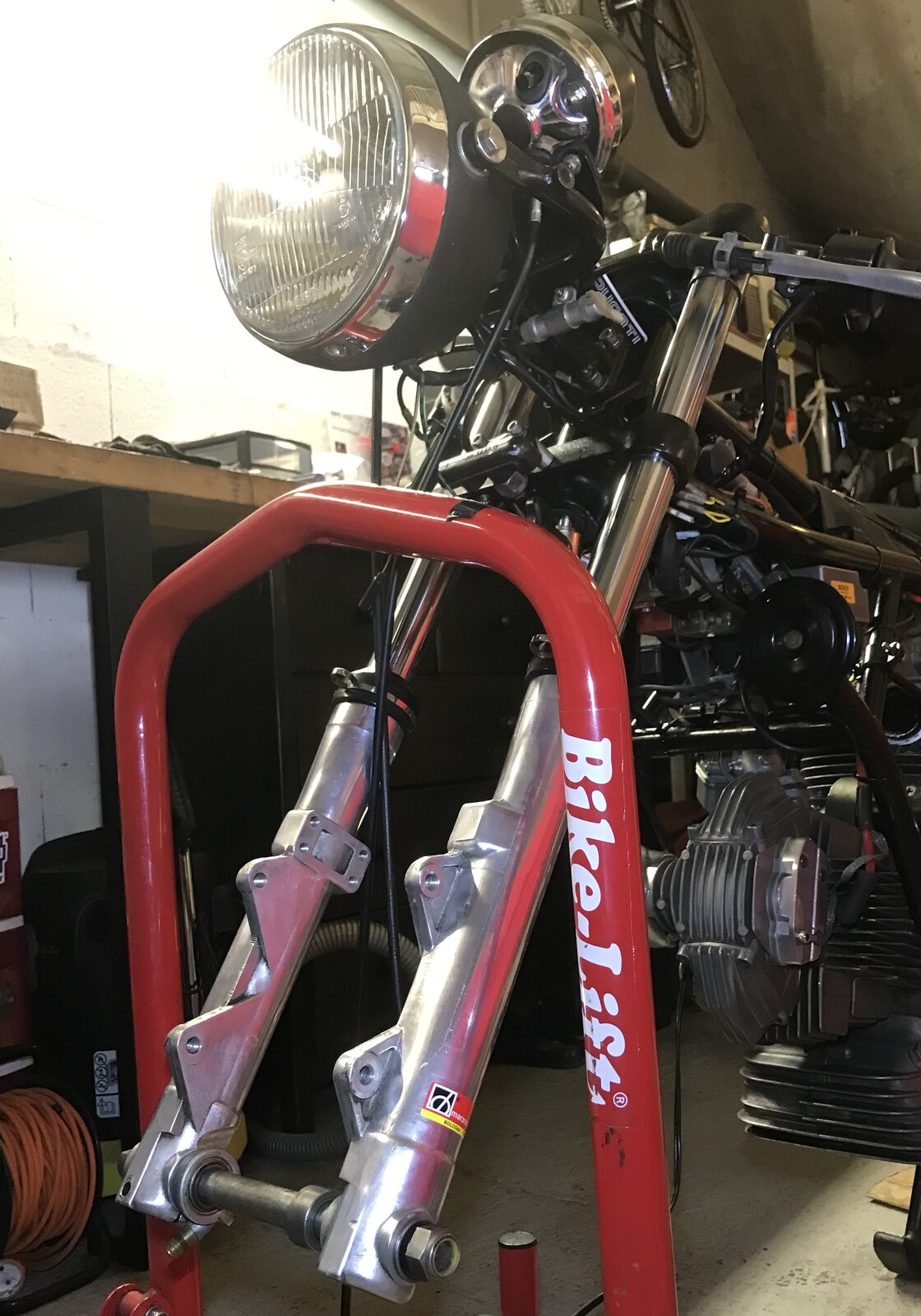

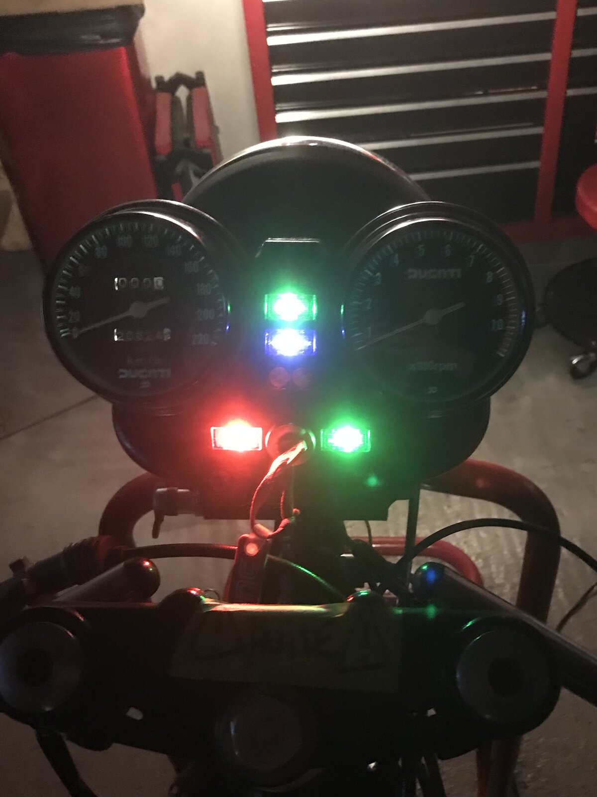

  13. Let there be light! :D FF398609-7A4C-44C2-9BD8-13D98830D8AA.jpeg
    And sound, with the horn and the starter that nicely revs the engine. Super happy to see her alive!
  14. There something to be said for a simple dash...
  15. With this the electricity done, and having received freshly refurbed forks, I will be able to wrap the front up.
    Next: brakes! :cool:

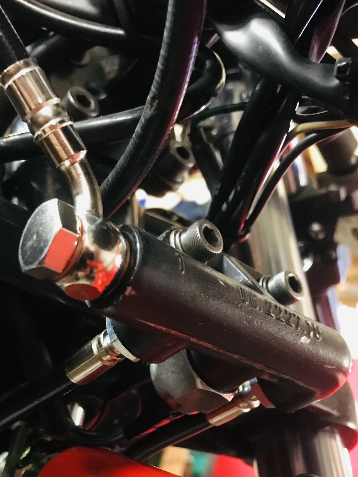

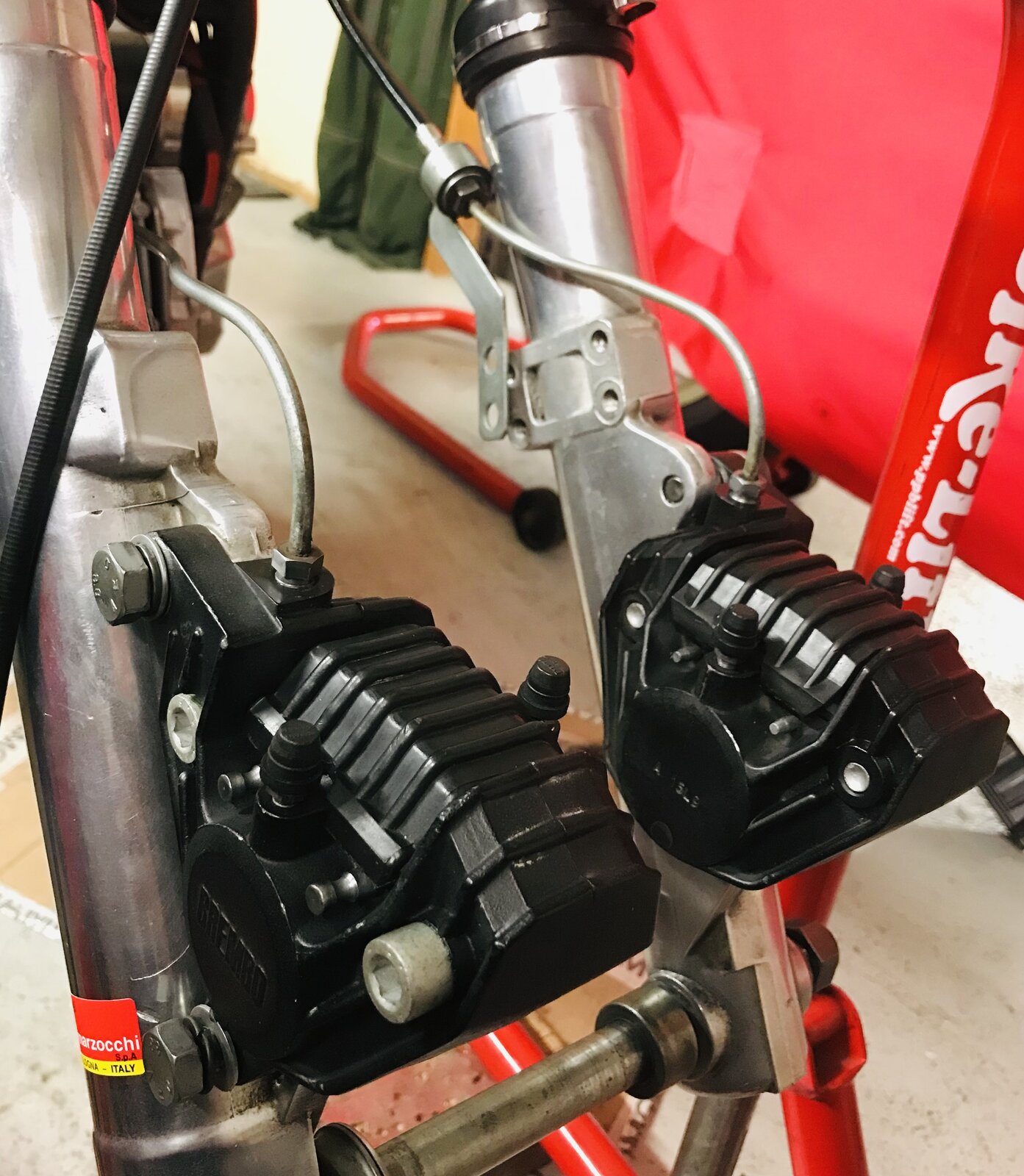

  17. Front brakes done. Looks and fitting is super nice.
    95200AC2-291A-4B16-8B17-051B4D2226EC.jpeg AA7F7965-5F6D-46E1-B2D8-055FE72C91B7.jpeg D0A0F766-9D33-4FFB-9E08-B9AB4BBAA4B7.jpeg
