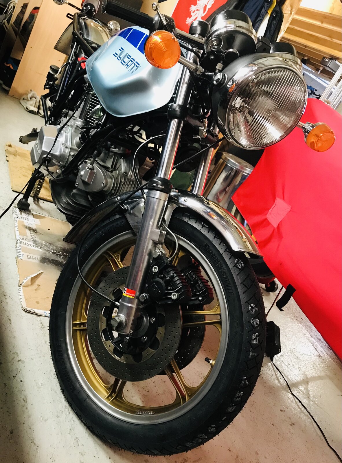

  8. Getting closer to D-Day… :cool:
    DE9A75B3-202F-4AE0-B44F-179C4AA6CABA.jpeg FD361E41-D506-494D-86A8-3A1E8143F2C7.jpeg 8295F23F-3787-495C-A744-9F9605C1E0F5.jpeg

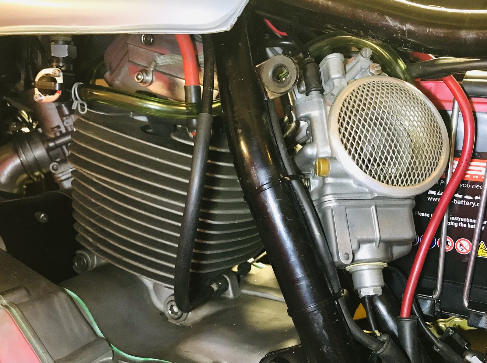

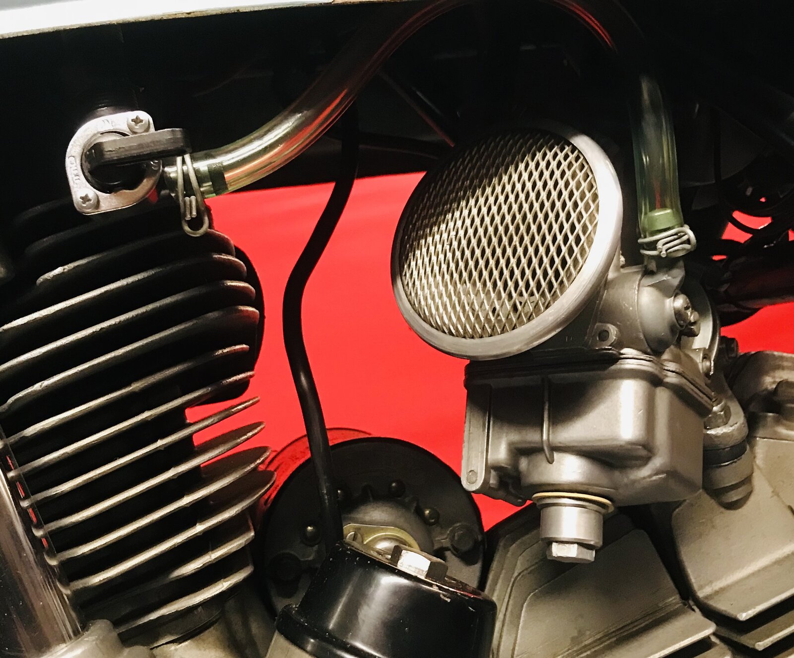

    I am now trying to get smart on PHF32 tune up. I am trying to wrap my mind around synchro using cable/throttle stops adjusting.
    Also, as I plan to ride this bike on long haul trip as well, I ordered a pair of K&N cone filters. That’ll keep the dust out of the carbs, even though I do not fancy the HD look very much…
  9. Before now I have checked the slides lift and fall at the same time without the engine running purely by listening to them dropping on the stop screws. So set the stop screws the same, adjust the dual action cable to get them moving the same whilst leaving enough free turns in the carb top adjusters to be able to do the final cable syncing after you've faffed around with the mixture/throttle screws.
    Feel free to completely disregard the above because I'm not entirely sure how those dual action cables are adjusted...
    I am wondering if, at the very least, the mixture screws will need changing after fitment of the K&Ns. And possibly the needle position/main/idle jet.

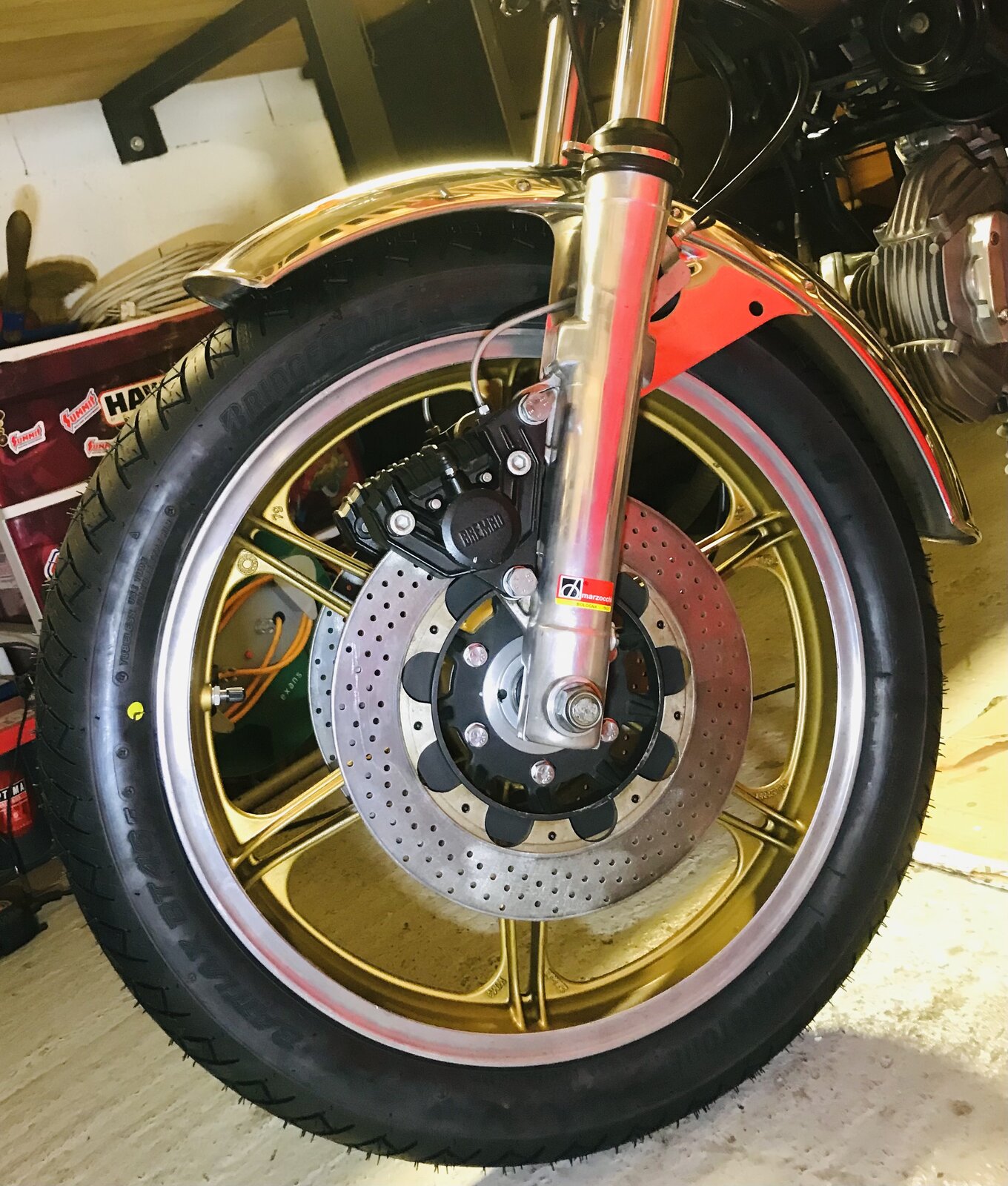

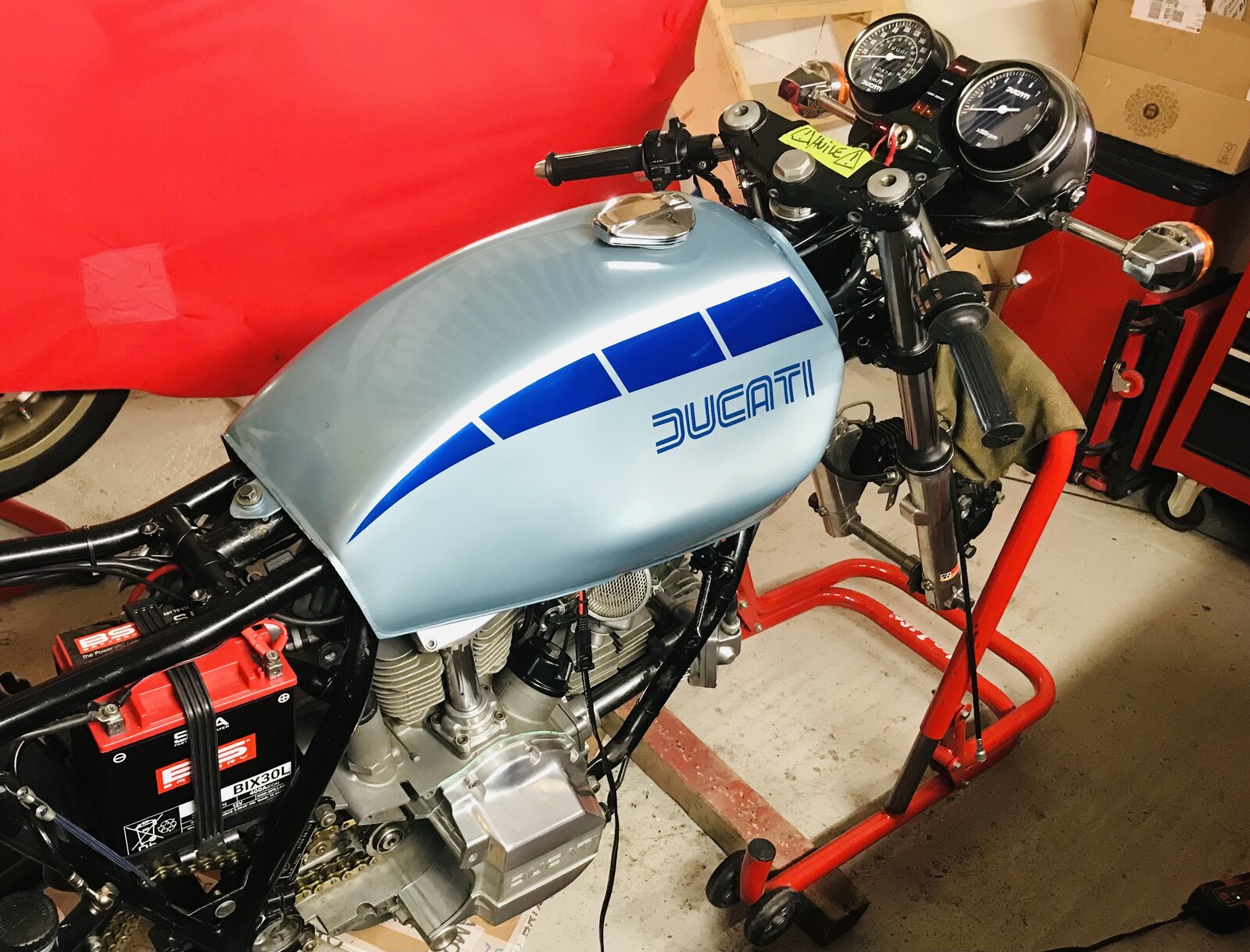

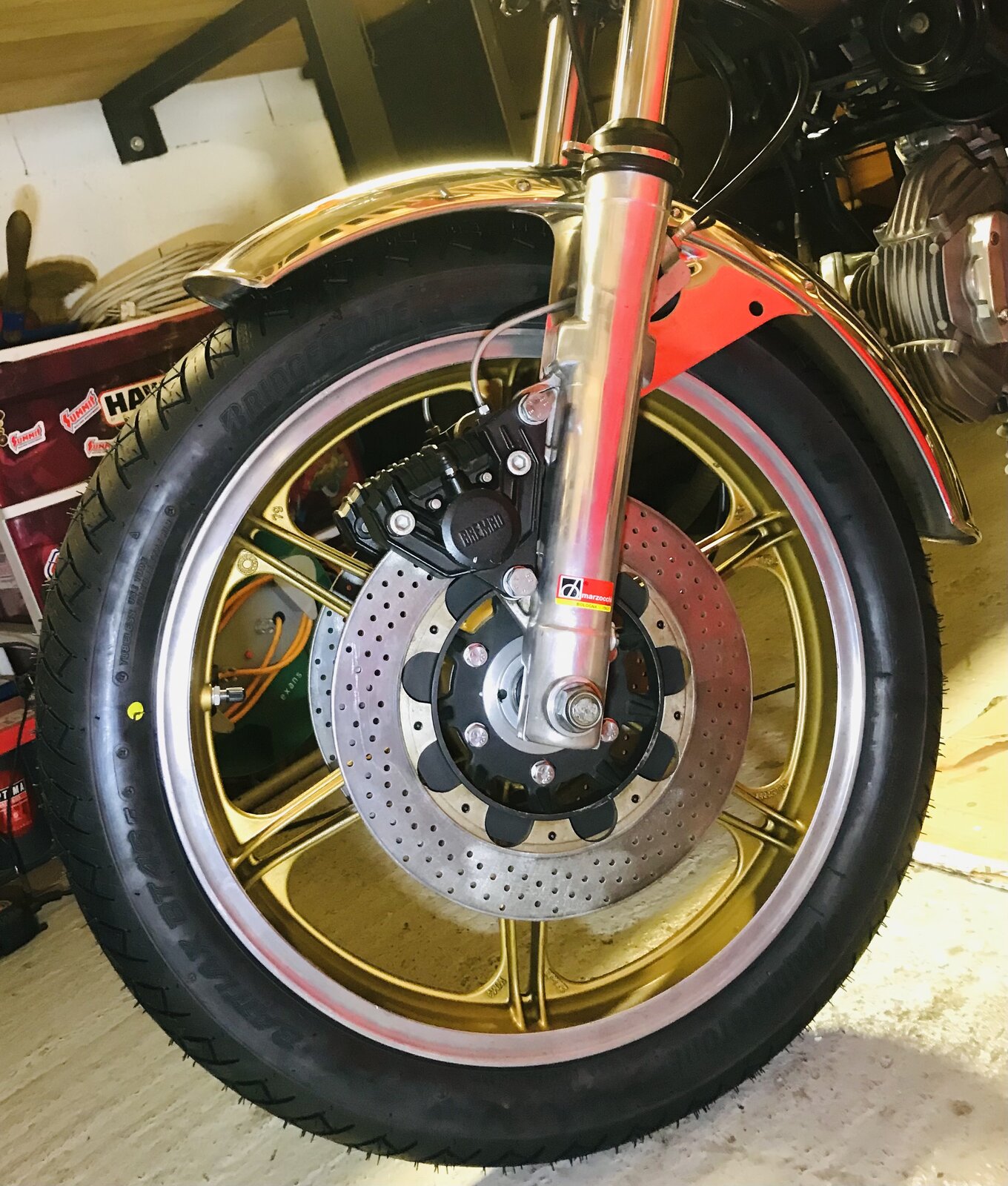

  12. Everything is beautiful on this bike… and big, sturdy, heavy. :cool: I absolutely love it!
    5CD1C55E-4F2F-4E75-921A-A0C99964ACC0.jpeg A4D2E603-2A8B-4E4B-BF63-9CC81B8D33ED.jpeg
