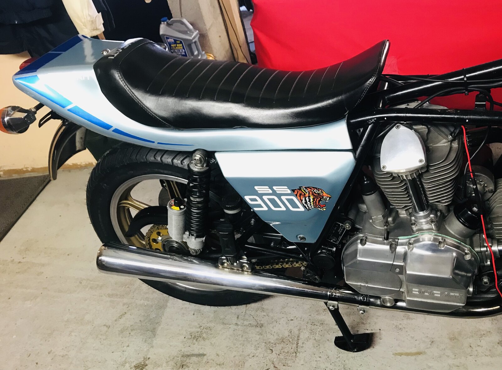

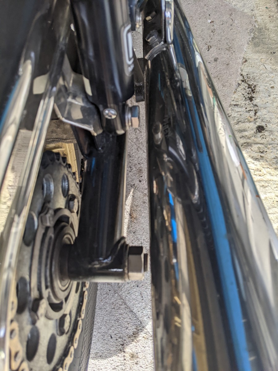

  3. Some mock up of the rear today, making sure there are no interferences with the wire loom and brake hoses routing. Looking nice with ole Darmah’s head back on the frame. :cool:
    36E49C6E-5BD3-42BF-8AFE-7A65EF5375A6.jpeg 19C9ACA0-31D3-4A7E-ADAE-1E96F97EE112.jpeg

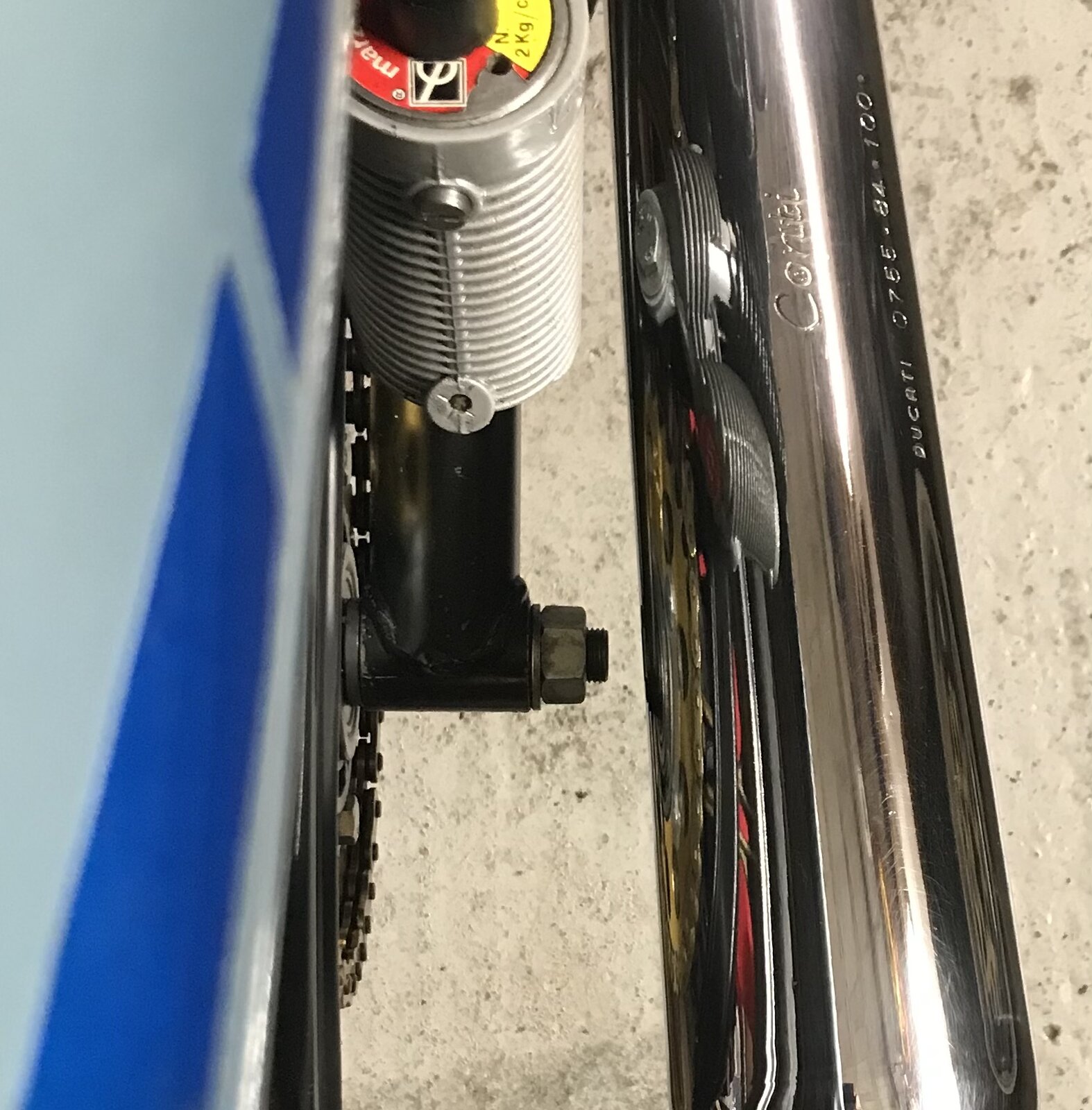

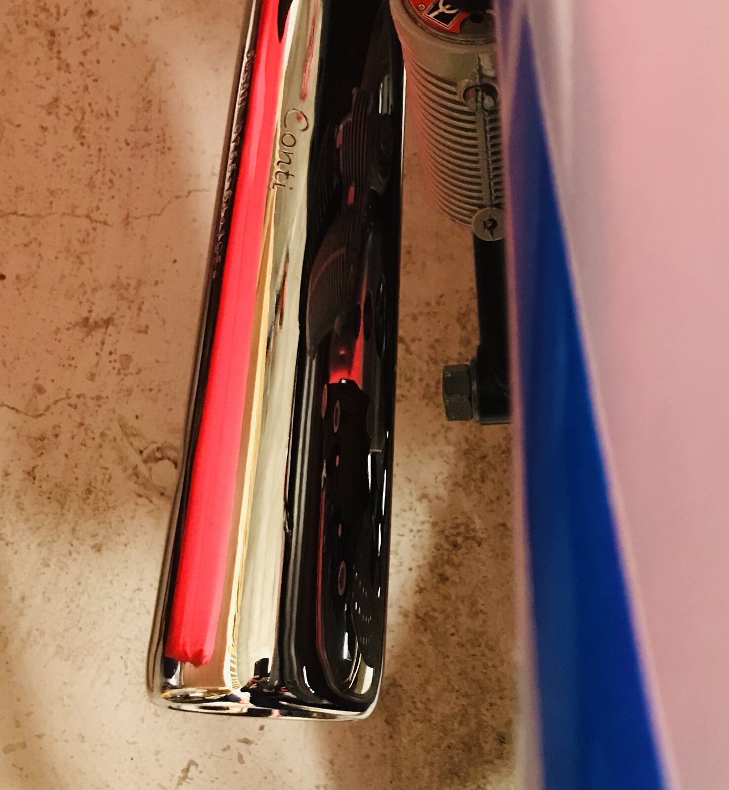

  4. It's also good to check there would be no interference between the rear axle & shock mounts and the exhaust mufflers (on both sides) when the swingarm is moving. As can be seen they do run pretty close.
  5. @Andy Bee
    I had plenty of time to check this when I was working on the swing arm, chain, sprocket, shocks,etc. :upyeah:;)
    D939527A-1AAF-4FF4-B83D-20AF73B66139.jpeg 87ED2EE2-A2AC-4D11-A293-91E80EBD2B39.jpeg
  6. Lovely... when I bought mine in the early 80s (yes, I've had it that long) the previous owner had fitted a complete Conti replica Keihan system and this obviously runs much closer. We're talking millimetres when the shocks compress.

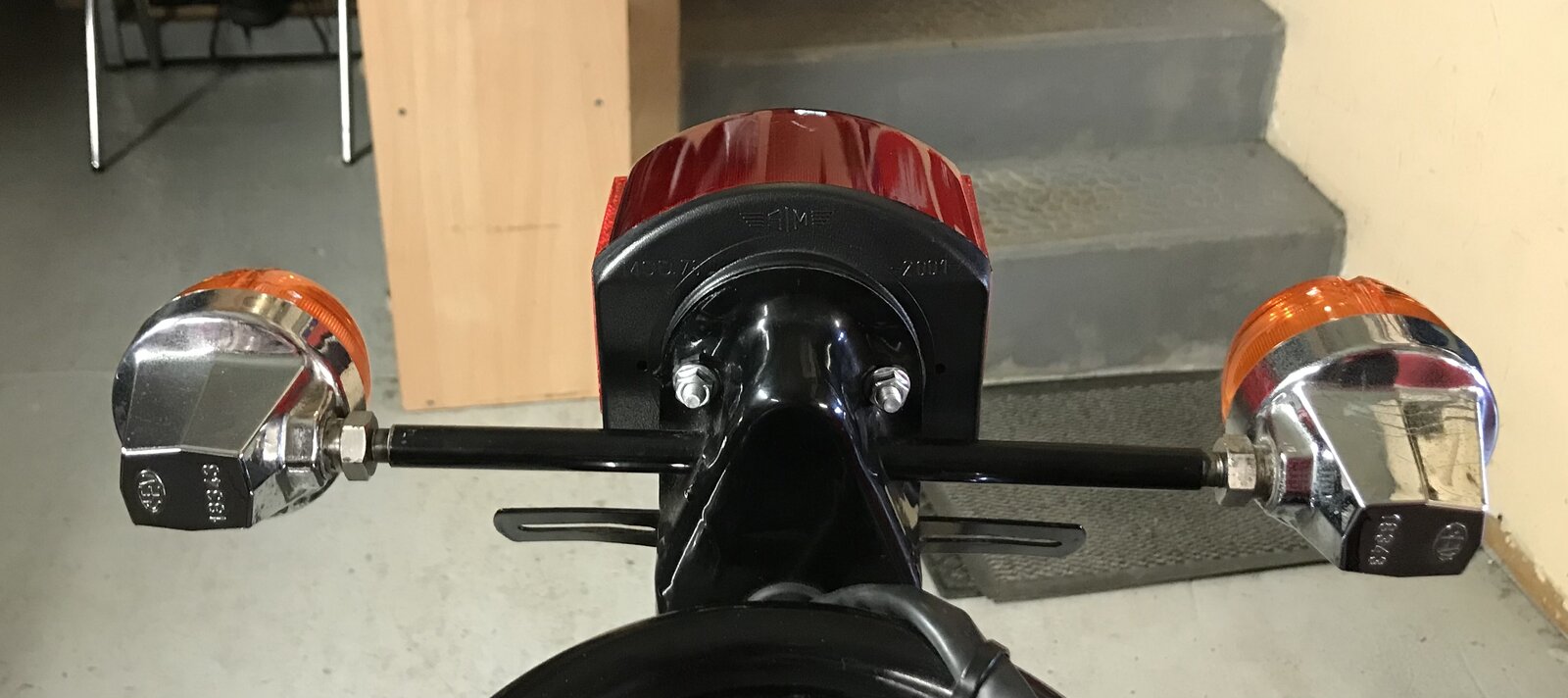

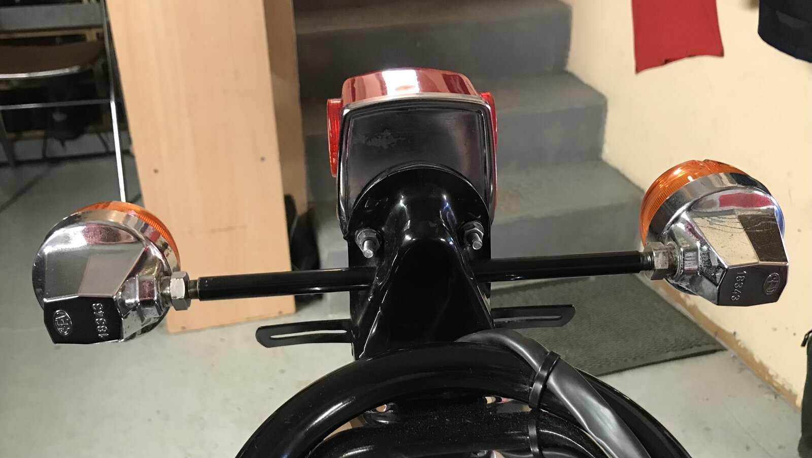

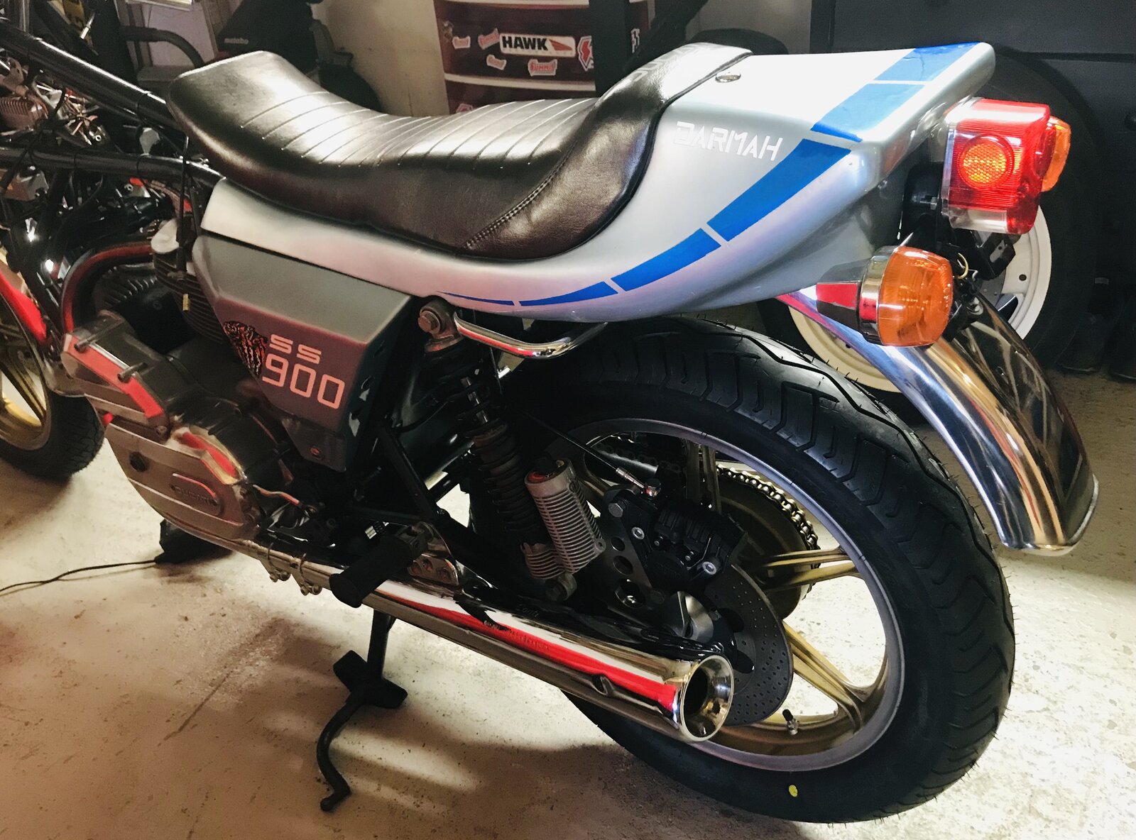

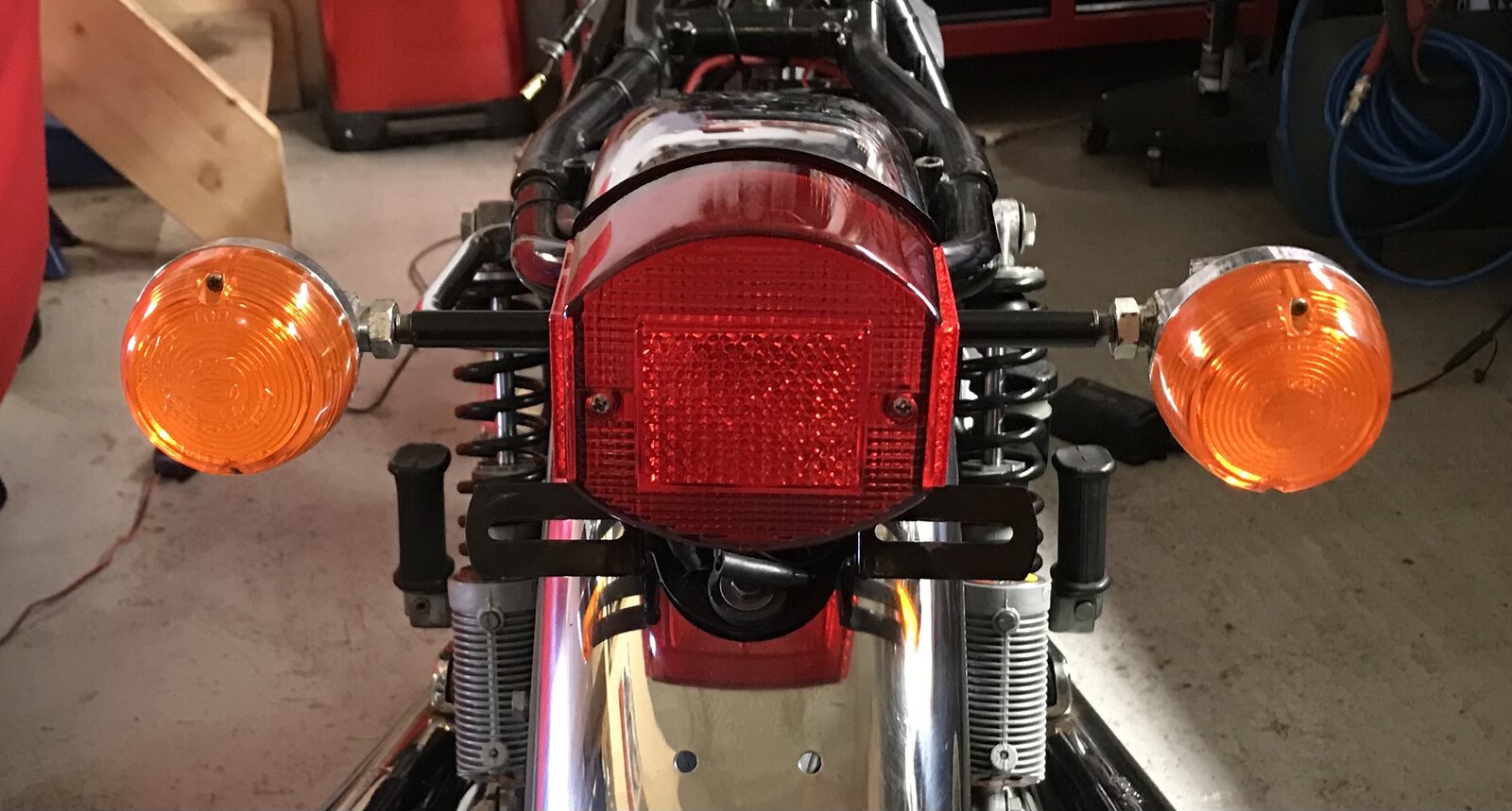

    I finally got around to replace the “off” looking tail light. This is how it looked like when I got the bike: 21E7673B-8DA2-4824-BD82-C47EAF60BE77.jpeg 1857E0D9-94E1-40CE-96AC-C8F5403F064D.jpeg

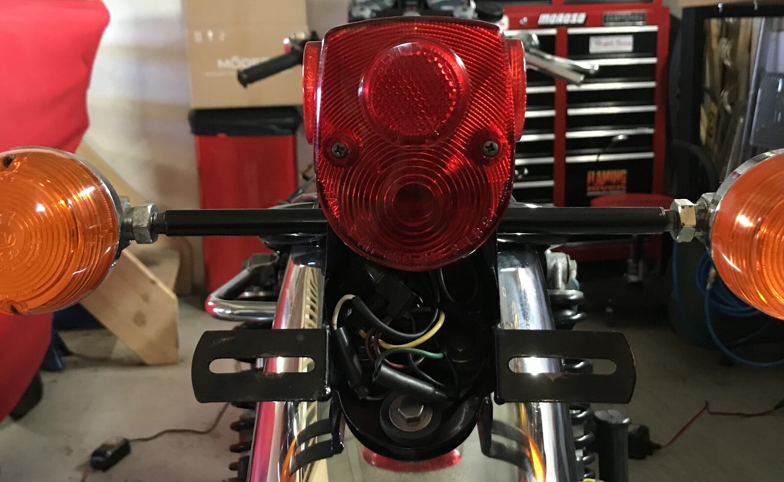

    I ordered a correct reproduction from Gowie and it looks much better, in my opinion, save, maybe, the satin black rear finish. Chrome versions are all out of stock at this time, whether you ask Gowie, SteinDinse or others. Anyways, you don’t see it with the tail on…
    6D4B6619-118D-4D0A-8924-CB9DA151043B.jpeg 75906A6A-573F-405D-B94D-EB937A63E2DB.jpeg

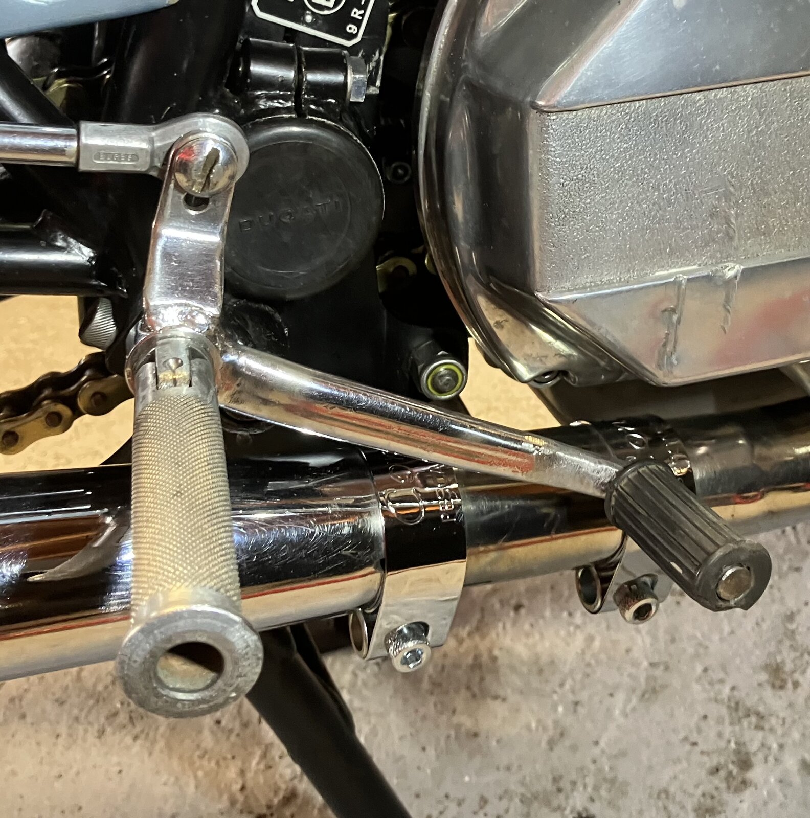

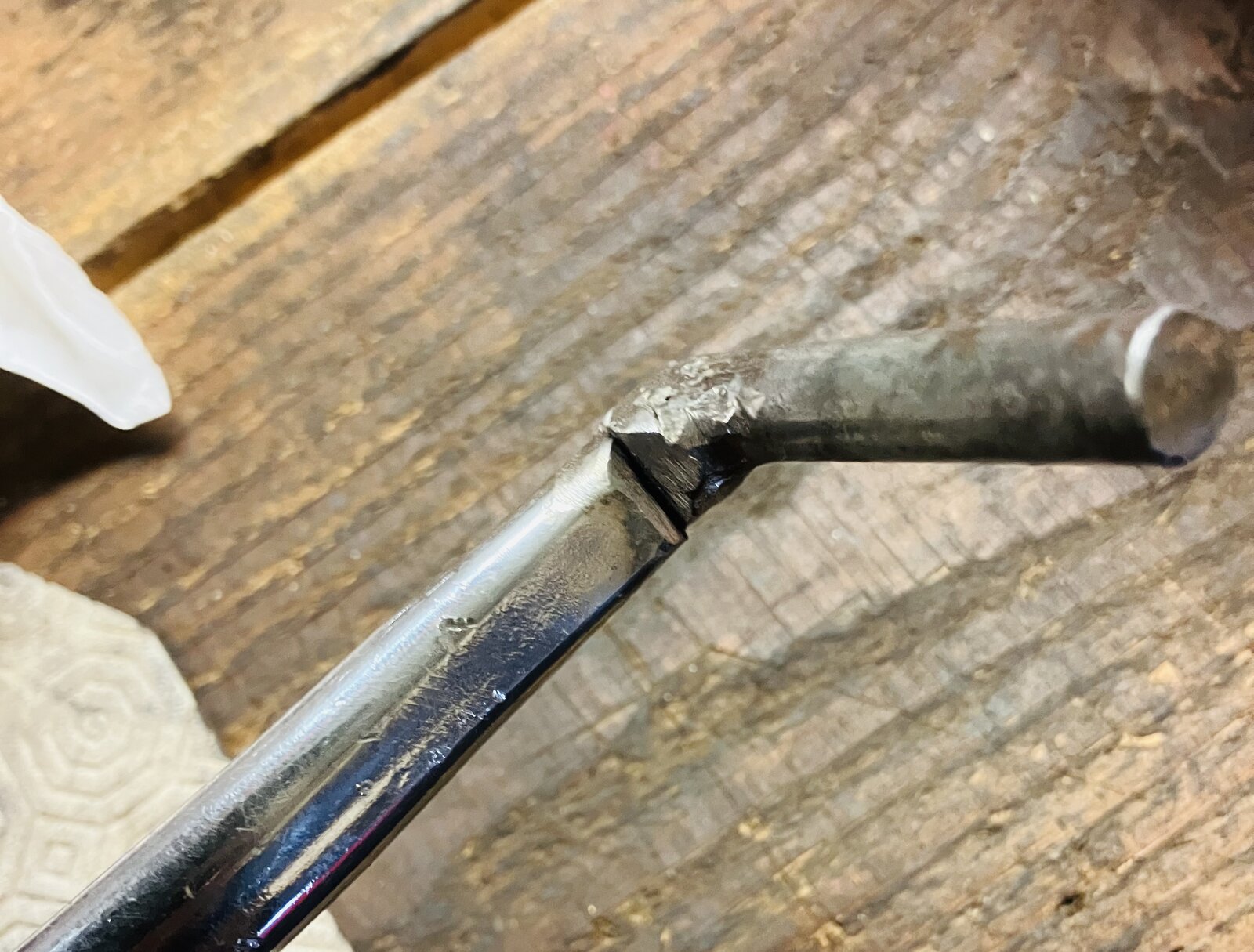

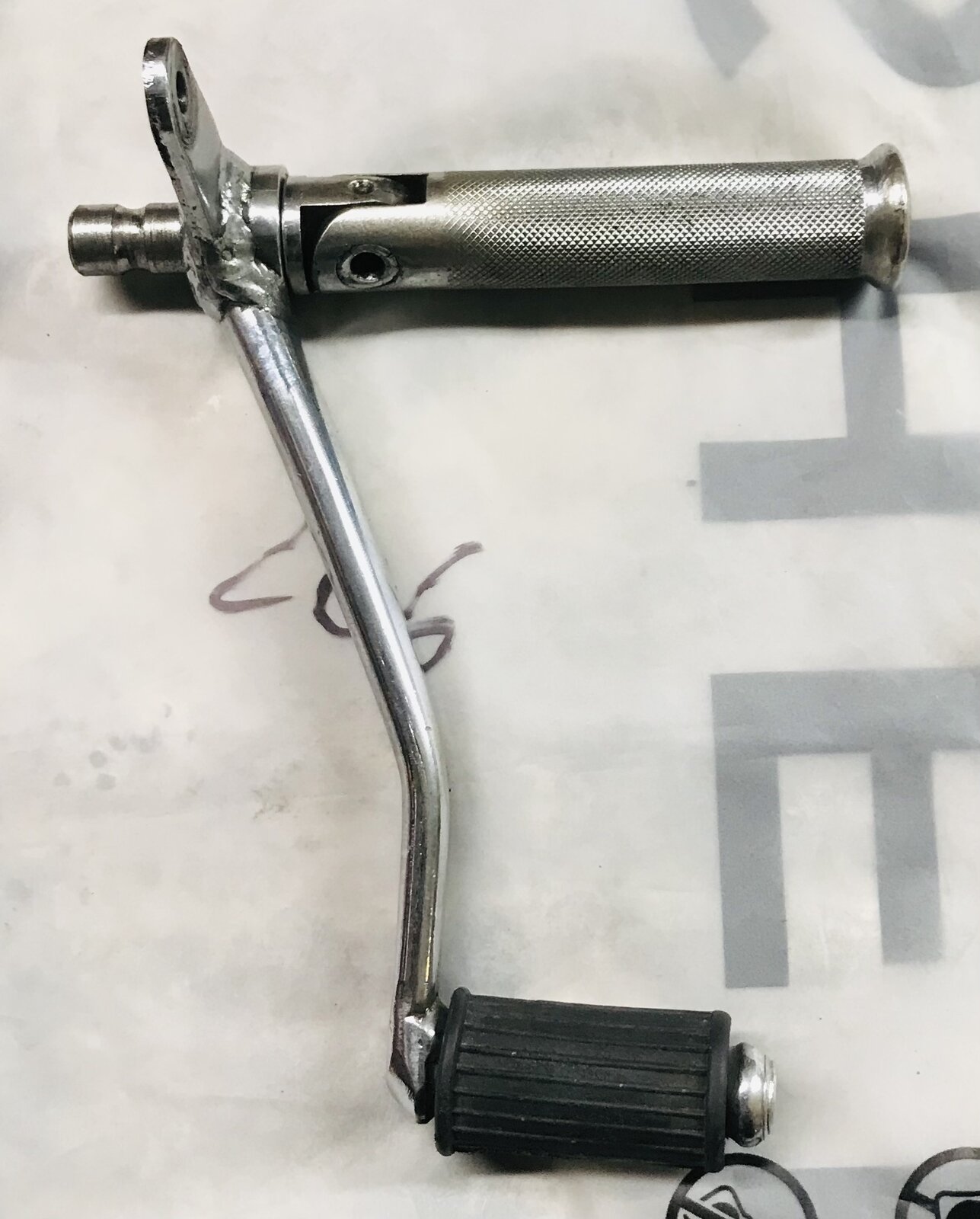

  8. I also started looking at the rear brake and gear selector pedals and associated rods.

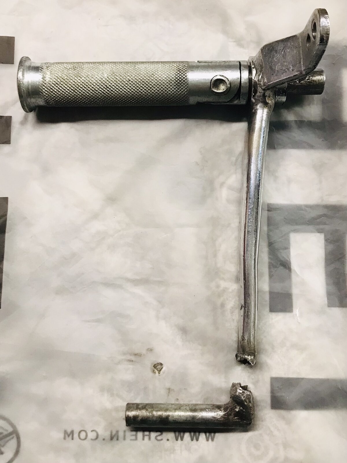

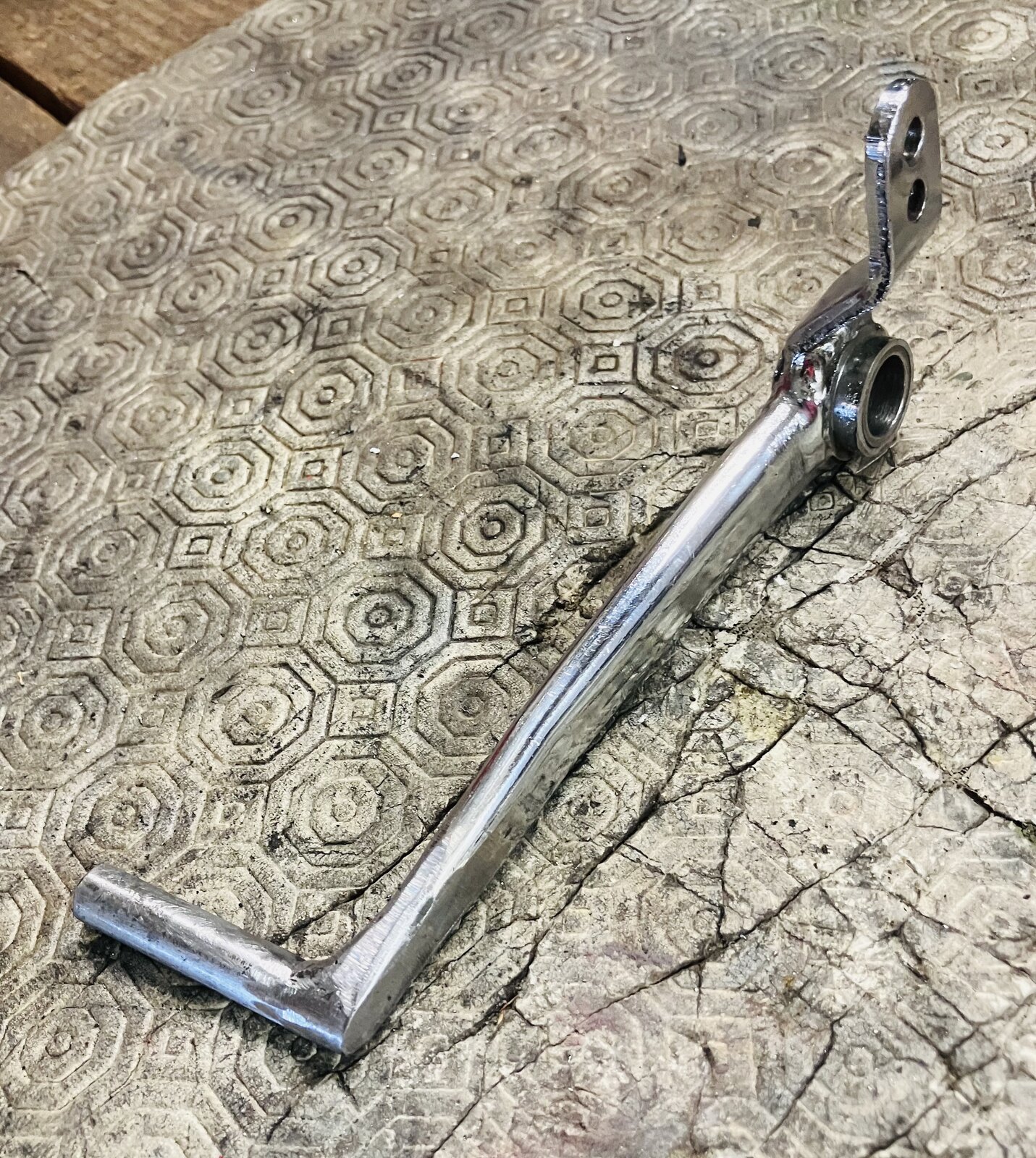

    First, as the bike must have fallen on its right side at some point, the rear brake pedal was broken and quite poorly rewelded. Testing it for the sake of it, it broke in two. That will have to be properly addressed.
    Second, there is too much play between the two pedals and the foot pegs axis. The main holes have gone oval. These are the late production lowered controls and as such pretty hard to come by. So in an effort to properly refurb them, I dropped them to my beloved machinist to get them bored and re-sleeved. With less play, things should feel more “accurate” when switching gears of using the rear brake.
    More to follow!
    C485043C-5F51-4E8F-9817-5603E353EF39.jpeg 44EDE44D-69BD-4A7C-AAD3-8447DB023AB9.jpeg
  9. Yeah... the last thing you want is any slop in the linkage(s). On one of these no one has ever said the gear change is like knife through butter.... ho hum :)

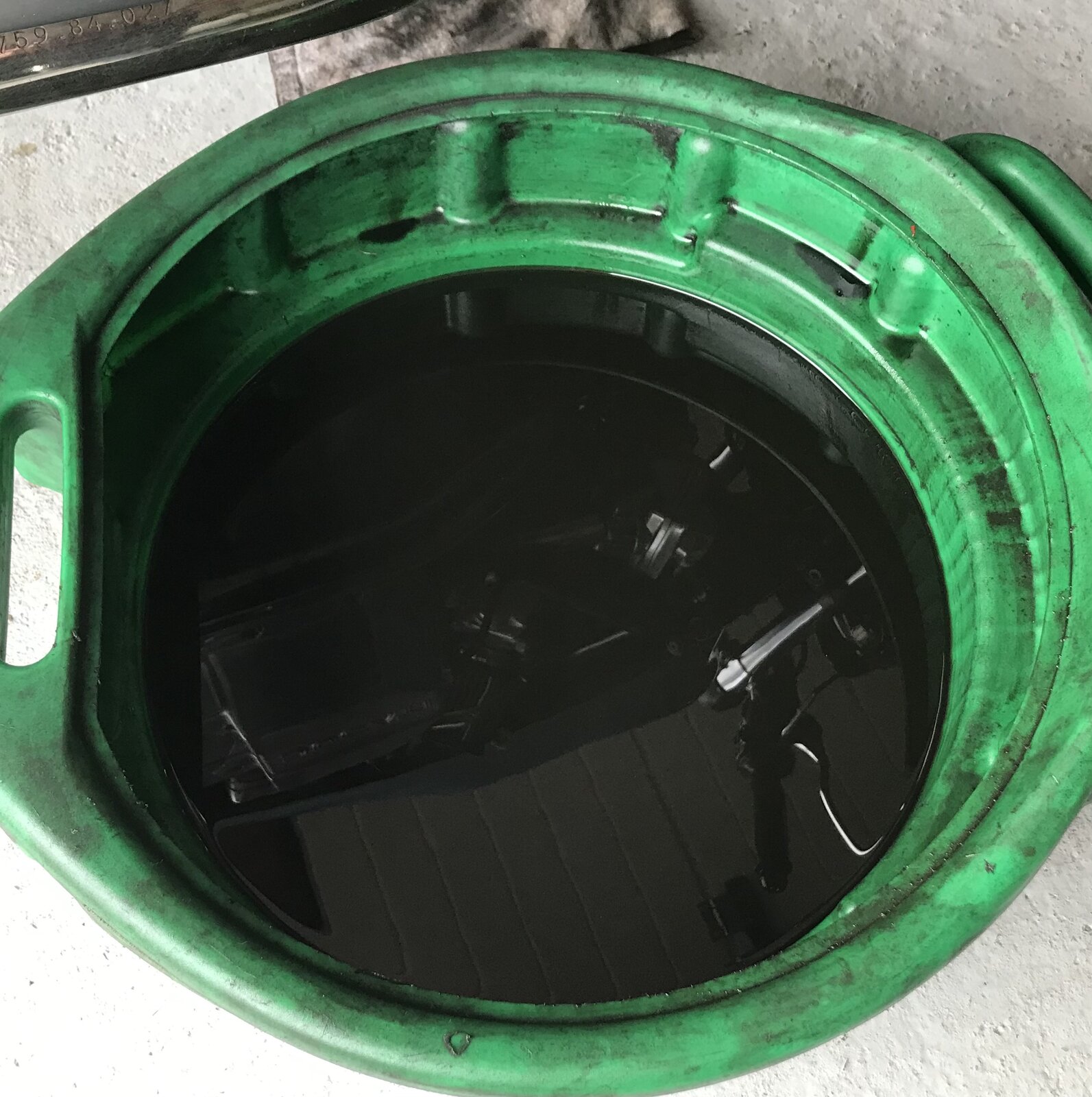

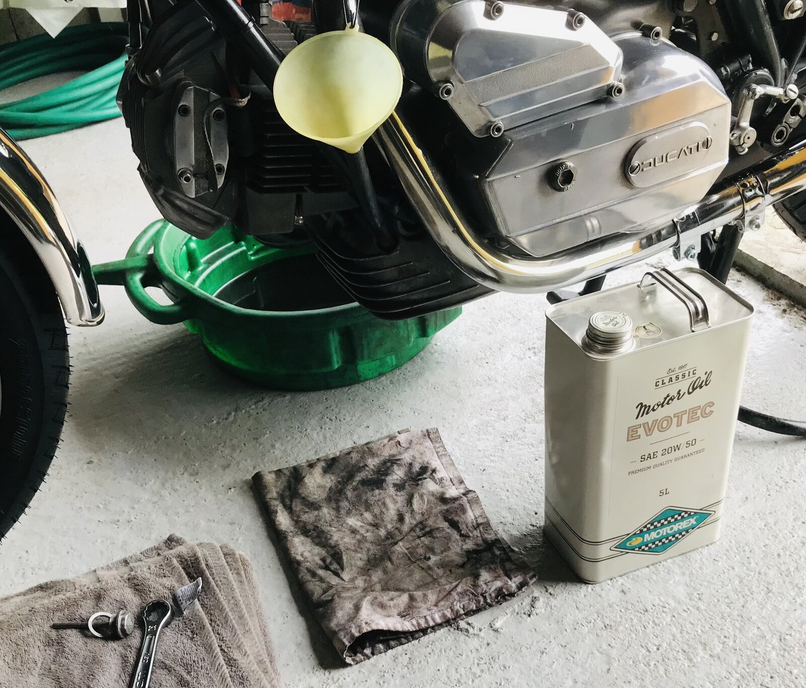

  15. Carbs are synched and tuned. The engine revs up and down very swiftly, and the idle is now set at 1200rpm.
    https://youtube.com/shorts/qsoaIYAkXmk?si=RyyLhKLyUE1VlNUQ
    I first restarted this motor with cheap oil, as I wanted to rinse it. After a total of 45 minutes running, for static carbs tuning, I flushed it and replaced it with a nice high zinc 20w50 classic oil. The color tells me it was a good idea. I replaced the oil filter as well.
    DC365820-18D5-4348-8B5B-CD42896E4CED.jpeg 27F90CDC-5B1D-4A50-A260-788D8E1DB07C.jpeg
    Good for 3000km now, if I understood correctly how these engines work.

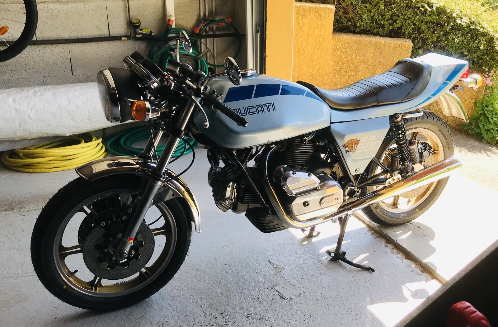

  16. We’re almost ready for the CT (French MOT). :cool:
    She looks like a blue Darmah SD at this stage. BF974BF4-DB7E-44B9-B2C7-7D9603208BF0.jpeg
  17. In the UK 'historic vehicles' 40+ years old are MOT exempt, so in France do you have to continue MOT'ing it?
    And btw watch it's stability when on the centre stand because it looks like the rear wheel is touching the ground.
  18. And that would be because the ground is two inches higher outside. ;)
    Yeah, the MOT over here for motorcycles is only a year old. We resisted the « European » pressure against it since 2014, but our government failed to make an official case against it and finally gave in. Bloody wimps. We’ll have their heads on a pike before this is over…
    All collector vehicles (cars and bikes over 30 years old and eligible due to « collectibility ») need to be MOT’ed every 5 years, over here…

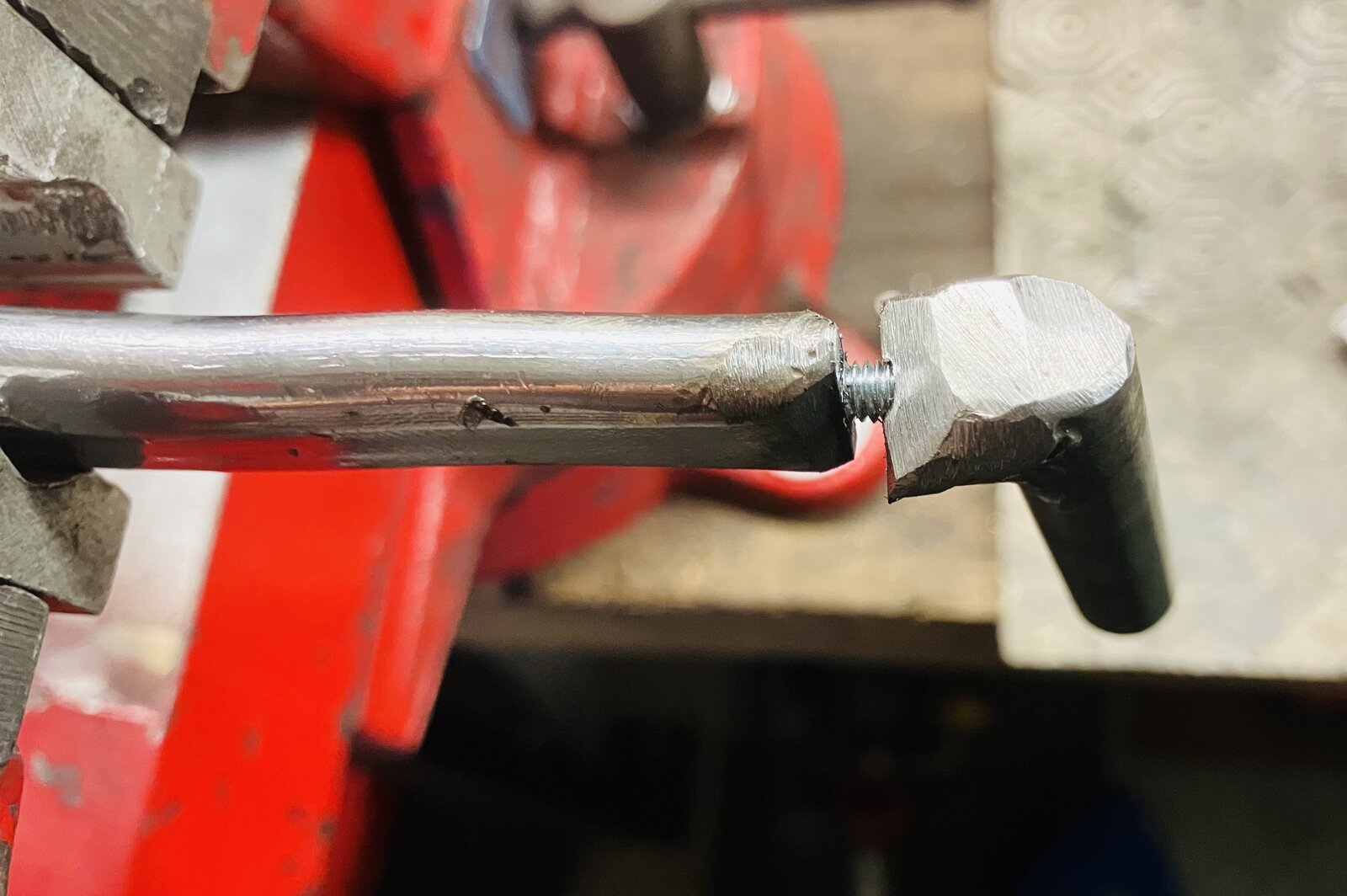

  19. Well, this is it! :cool:
    Got that brake lever repaired. I first cleaned the old welds and then used a 4mm threaded piece of steel and drilled/treaded inside the two bits. IMG_9955.jpeg IMG_9956.jpeg
    Then had it professionally welded and finally finished it with my bench grinder. The repair is not visible any more unless you get your nose on it, and, most importantly, that’s not going anywhere. I’ll if I can get it rechromed in the future.
