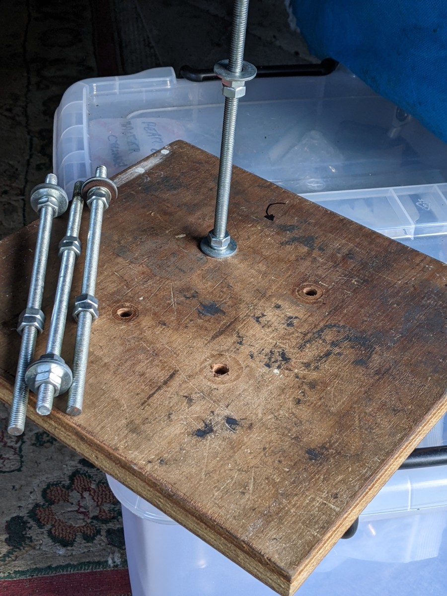

    And here's my highly technical piece of equipment for supporting the cylinder head when off the bike. Note the arrow to remind me which way the bevel turns.

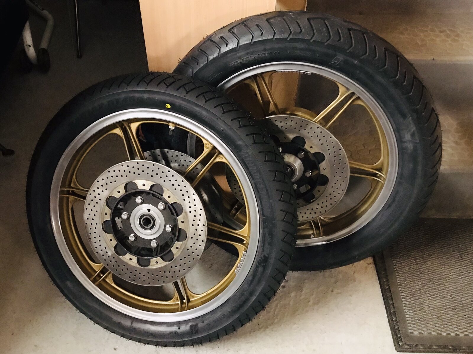

  3. Fresh rubber smell down in the garage! I am not used to these tire sizes. It looks really antique to me… I find this very cool, to be honest. 92799835-8265-485B-A41E-D326C3C58194.jpeg

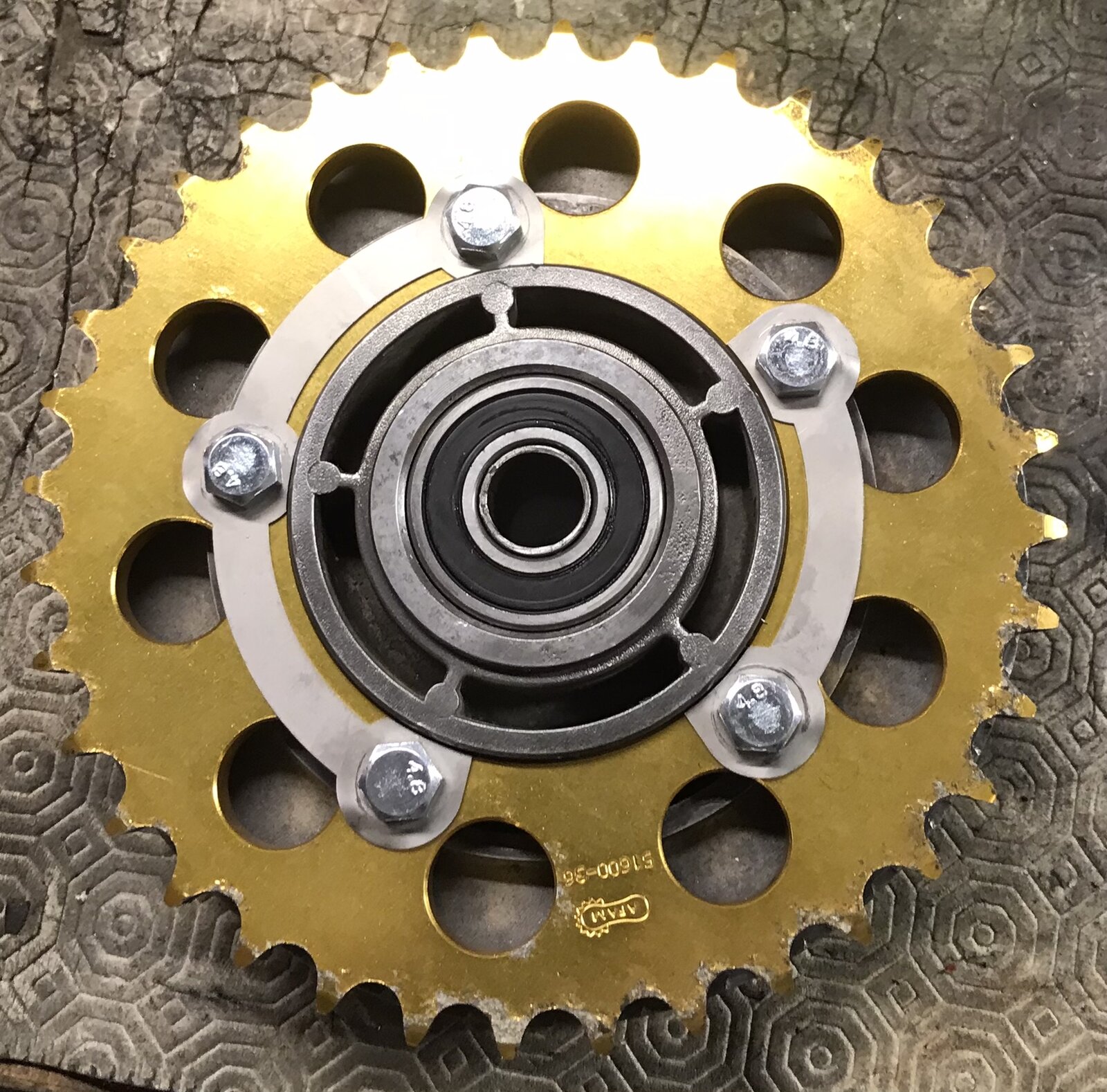

    I also corrected the rear sprocket assembly to a more OEM looking set-up. B029EFF2-3B5F-45B7-96D7-B10AECD11C05.jpeg
  4. What tyres have you gone with & what sort of pressures?
  5. @Andy Bee
    Those are Bridgestone BT46 (100/90r18 and 120/90r18). Right now they are at 2.5 bars.
  6. I'd be interested to know what sort of pressures you settle on after a few test rides. For me, with ContiClassic Attacks, it didn't feel comfortable until the rear was reduced to 2.2 & the front to 1.8 :astonished:
  7. I got some advice to increase the front to 2.8 if need be, as these tires sometimes generate some sort of « drifting » in the front.
    Not sure about the word. Nothing like tire skidding, more like inaccurate trajectories.
  8. A vague front end.
  9. That’s it, thank you Sir! :upyeah::D

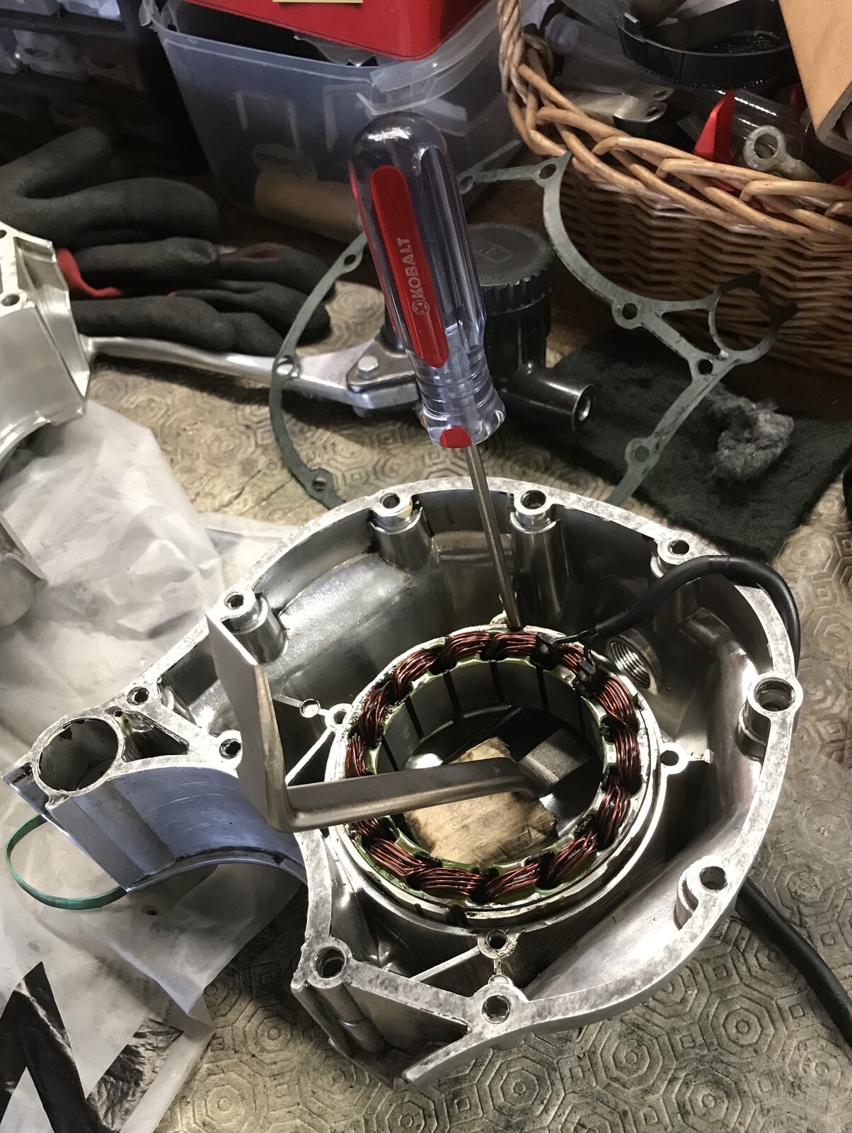

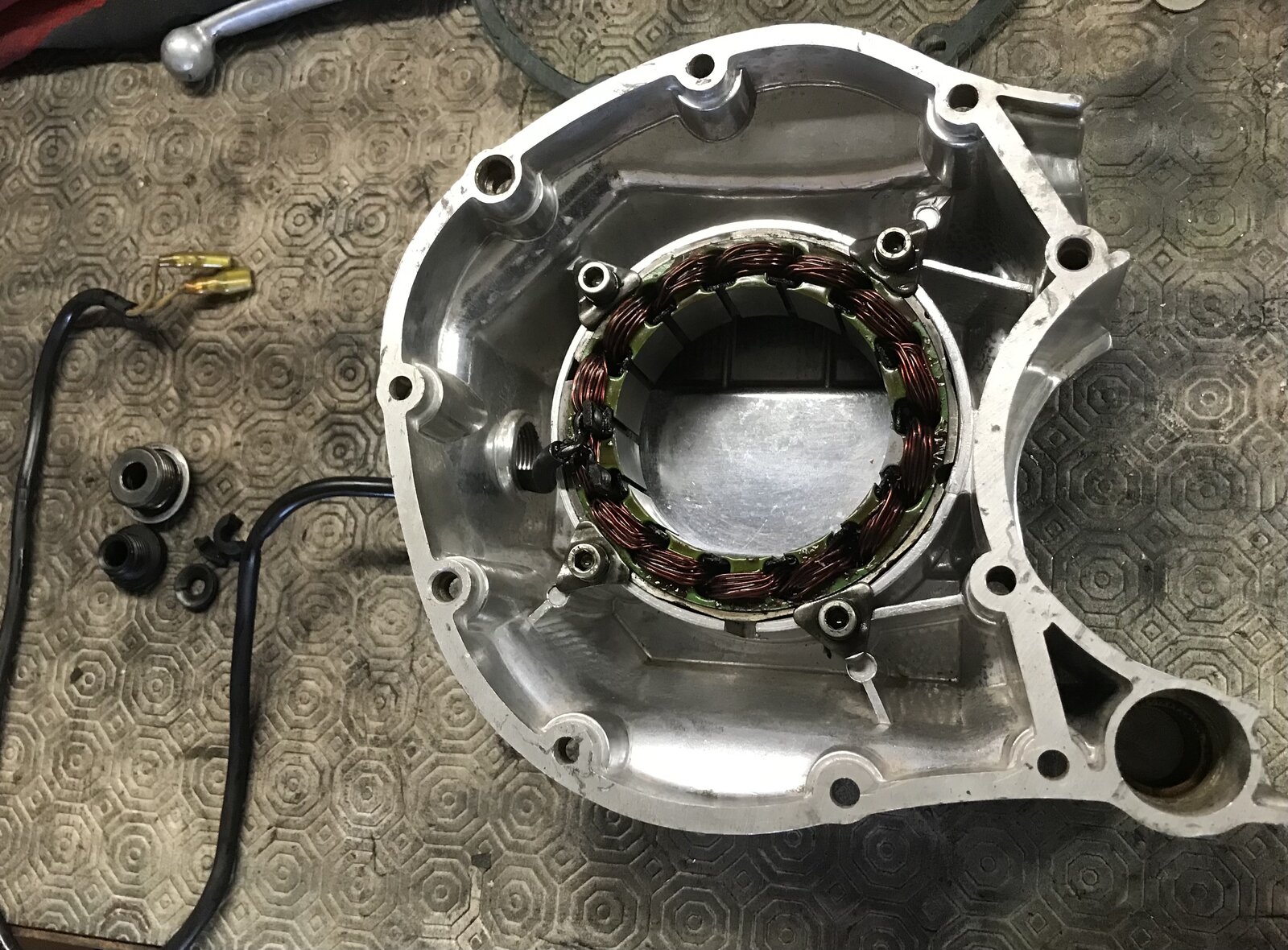

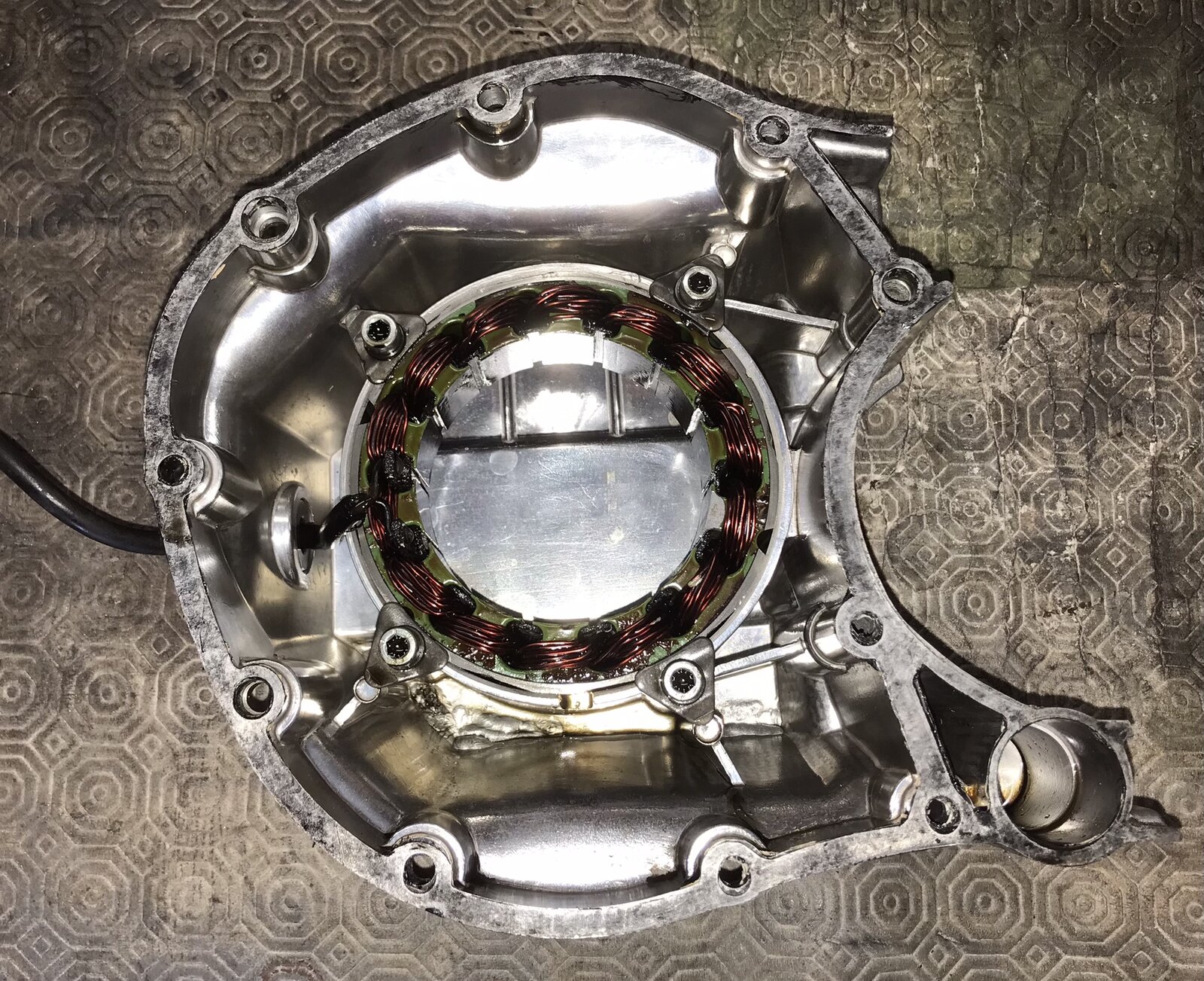

  14. I am facing a new challenge here…
    Is there a known trick to remove the stator from the cover, once the 4 screws and retainers are off? :neutral:
    It won’t budge a millileter when I try to manually pull it out. It’s pretty much stuck in its housing and franckly, I hesitate to use mechanical force with some sort of pulling tool for this. I really don’t want to damage the stator… 7AD62719-C983-4954-819A-8D1AEF23F384.jpeg
  15. Should come straight off. I assume the repairs at the bottom of the casing hasn't moved anything?
  16. The fall leading to the damage that needed a repair may have shaken the fit between the stator and the cover. I found some info about the fit being fairly tight anyways, so I decided to try and gently pry it out using a small wood block at the bottom with a bent tool and a thin flat screwdriver to free the stuck sides. Felt absolutely nothing at first, so I kept going gently around and around and after a while, I saw it starting to come up very slowly. 15FFE0A5-174C-4666-8530-FB5B44EAF4CA.jpeg
    10 minutes later, it was out, unmolested, and easily transplanted to the new cover. Only the O-ring didn’t make it, so had to order a new one from back to classics (I have a pending order there for other parts anyways).
    so… Success!
    #156 Guillaume69, Jan 29, 2025
