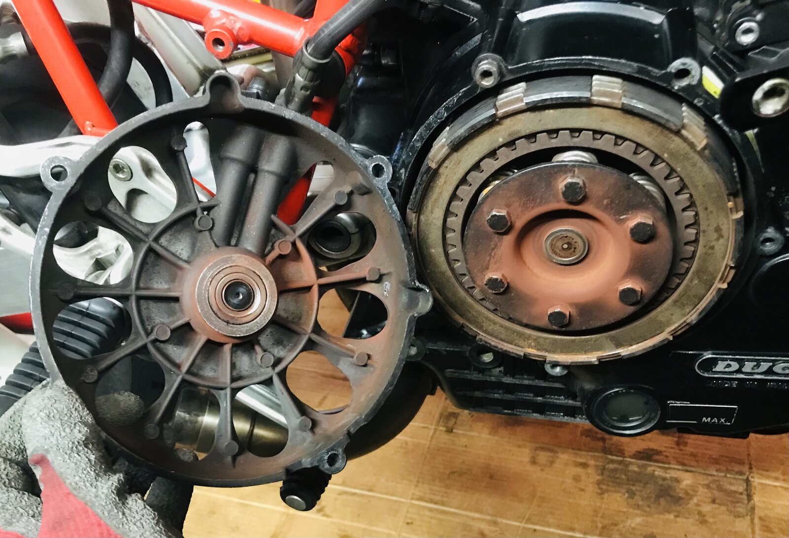

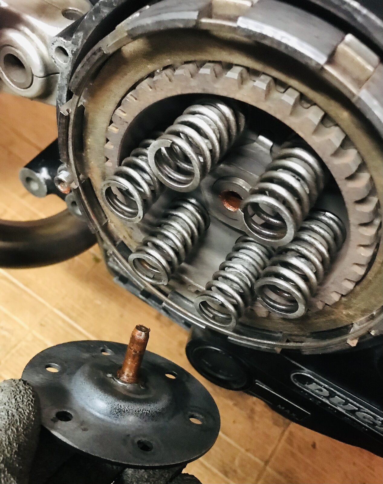

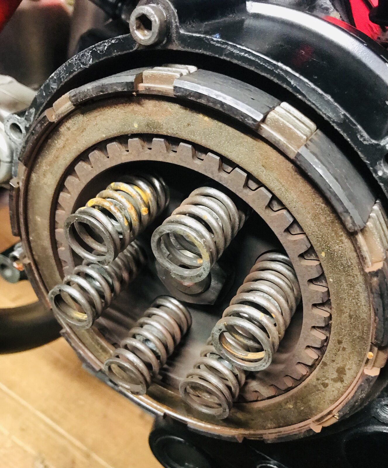

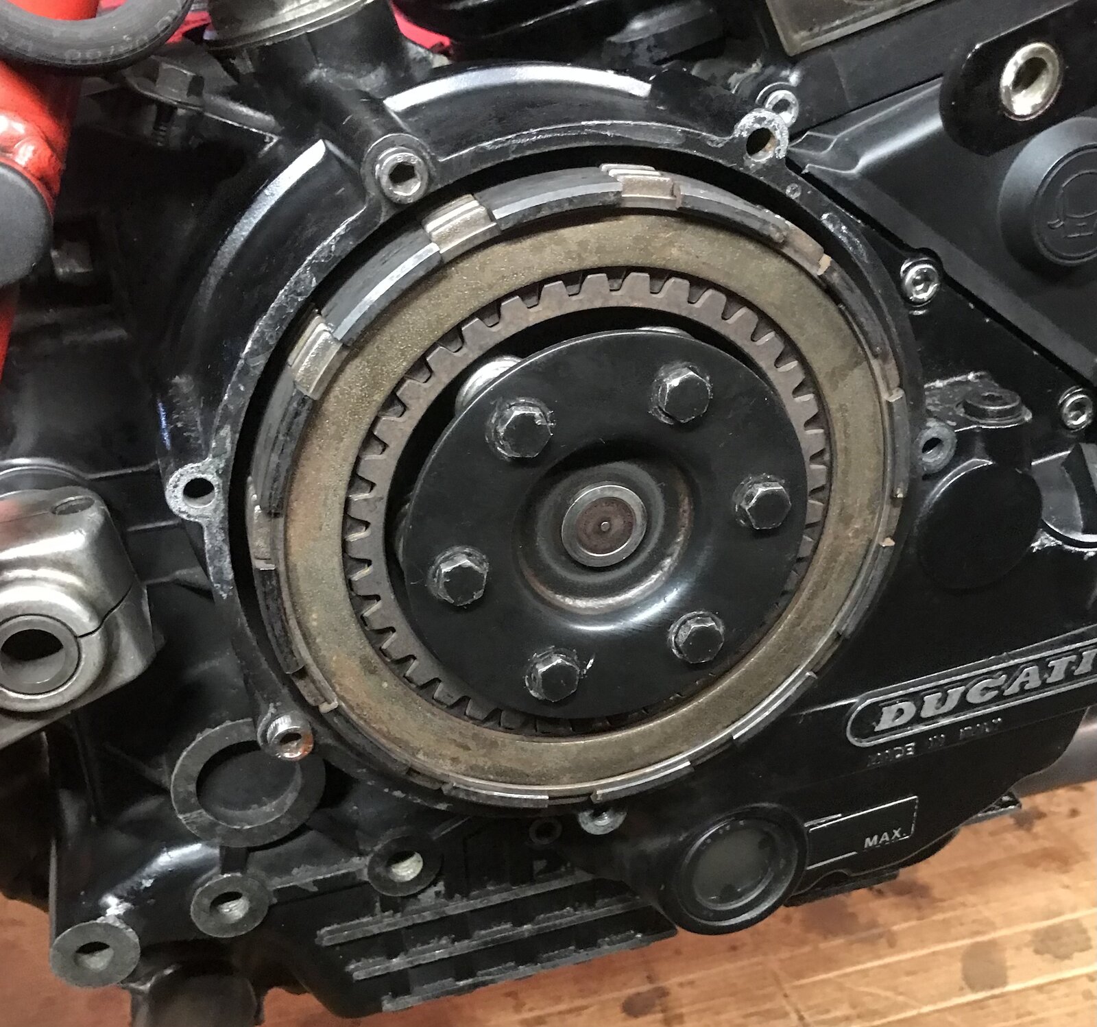

  6. This morning, it was a deep clean/check up for this lady. During our recent trip, there was a bit of rain involved. Not so much as we were riding (30 minutes total on Friday), but heavy rains all night Friday to Saturday. With bikes parked outside in the open. That, and after over 5000km without any checking, the clutch was one of my priorities today. Everything was still working perfectly, easy to find neutral, no groaning, etc. But for how long?
    Loads of friction dust and some light surface rust appearing on the springs.
    F94092B7-2E98-45F3-AB4E-045F74F96289.jpeg 5B805858-A000-4874-B3DD-BF2C587CF083.jpeg C2D94C2A-4730-47D3-82DB-53E92DEACCBA.jpeg
    45 minutes to get the discs out, blow the dust out of everything, clean, grease where needed and it looks like new again. 41ED292E-5DC8-45DE-B90A-85D349051D45.jpeg 05B0B9D4-3FD3-4FED-9499-62E3466B822A.jpeg
    Take care of your dry clutches and you will have many happy miles!

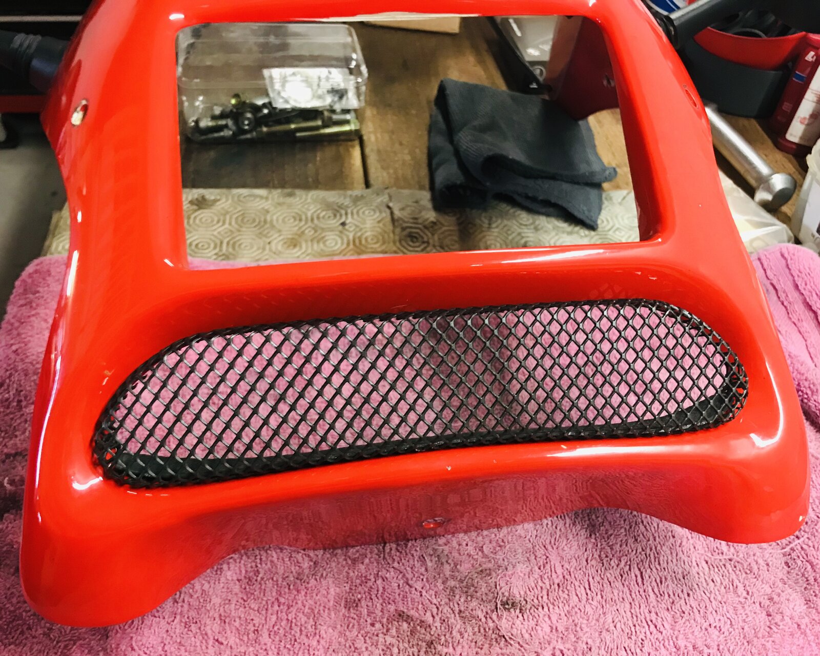

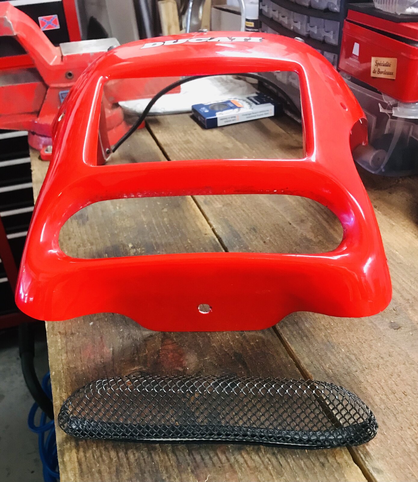

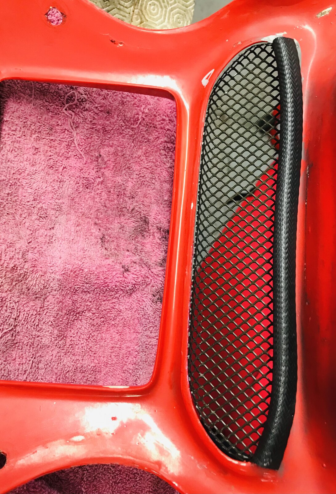

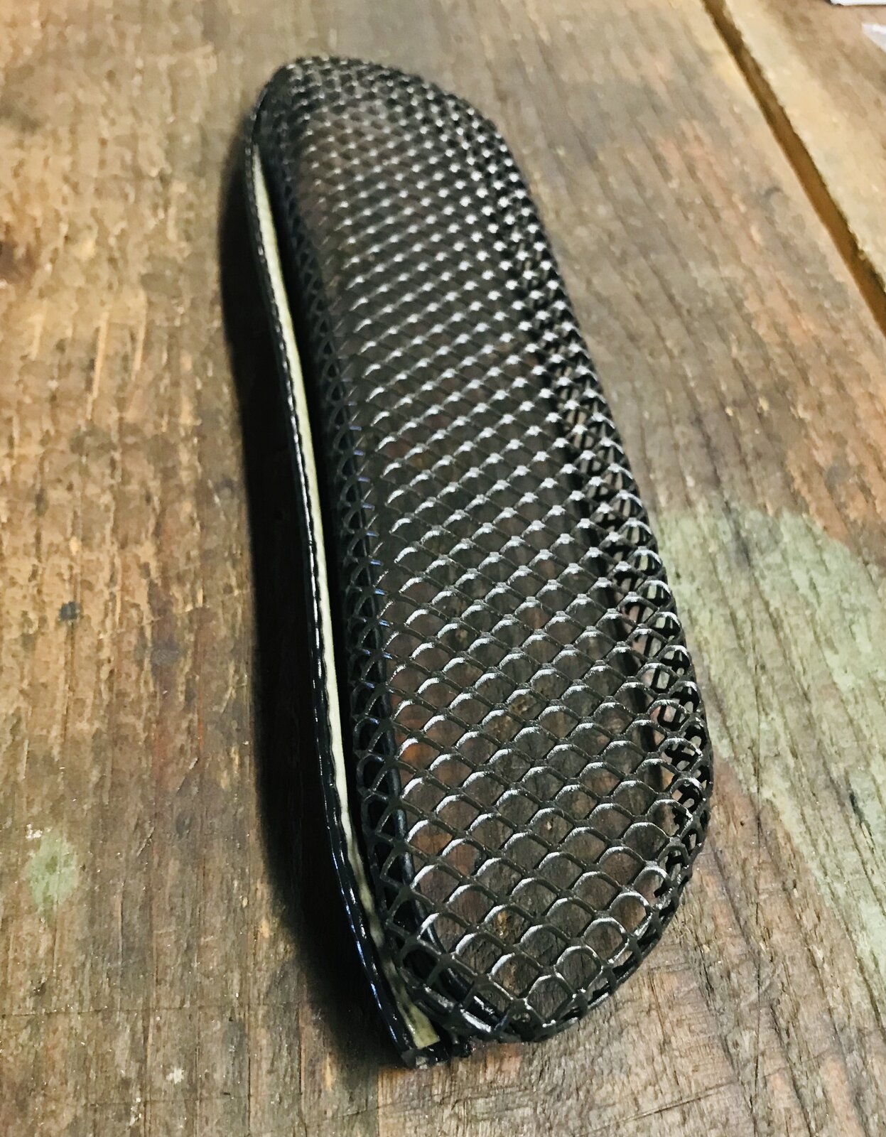

  7. I am so happy today as I finally found (and received from Japan) a part that I have been searching for a while for this bike: a vintage radiator guard. It came with a spare nose fairing, which ain’t too bad either, really.
    Happy times! :)
    9AE92E9B-C72E-4EC1-BDA1-70D039D761FB.jpeg C2613D56-01BB-4C15-8BD6-00FCD54AF8A9.jpeg

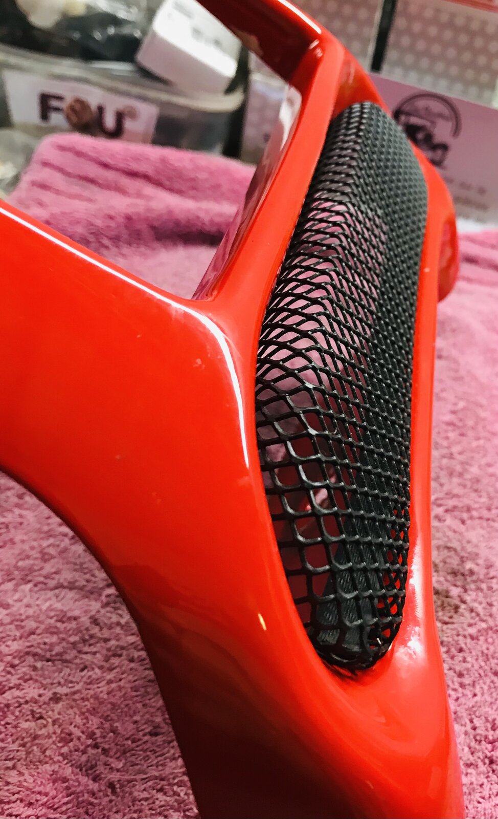

  8. And there it is on the nose cone. It’s perfectly adjusted, looks really clean and even OEM. I find this really cool. :)
    39E4442D-8A8F-4829-AFFA-715B4FFD99D2.jpeg 8D1ECB36-CDAC-4C05-B6D7-221D5141BA75.jpeg 8BFDB350-029F-4386-A5DA-7506FFA1D139.jpeg

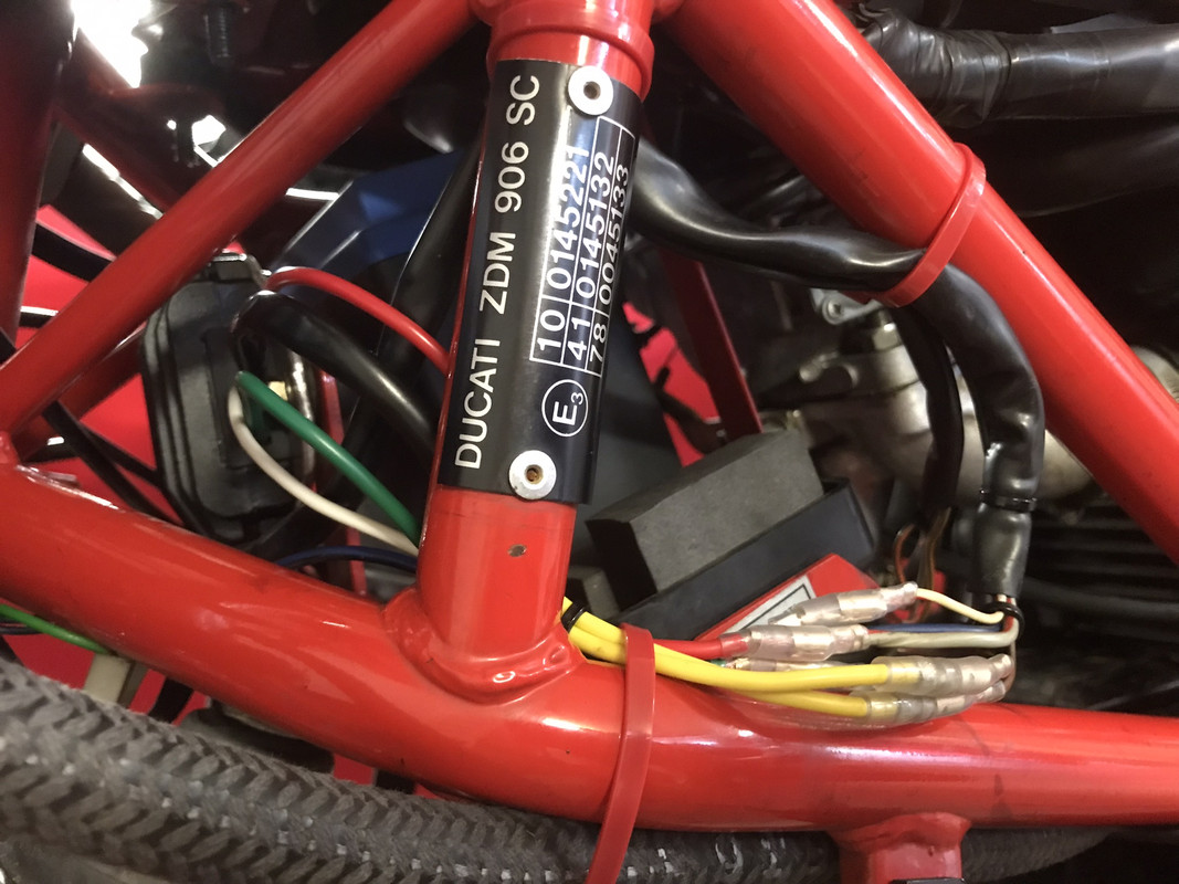

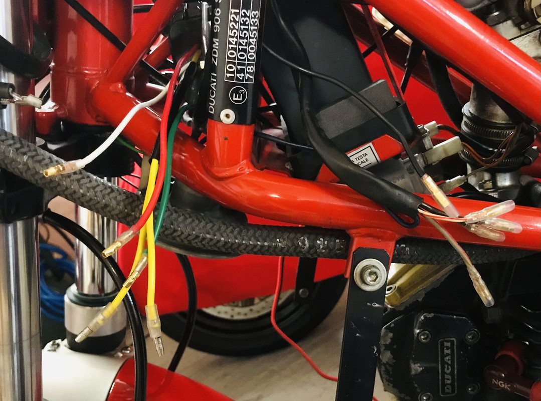

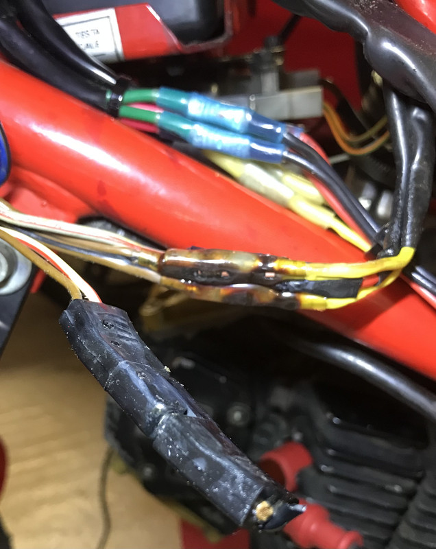

    The first was a very annoying intermittent ignition cut off, with a loud bang each time. I first re-checked the harness. Interestingly enough, I did find some (r/r) melted wires hidden under a very clean looking piece of heat shrink isolation. IMG_0840.jpeg
    But unfortunately, this did not fix the issue. I then checked the (iridium) spark plugs and found out one of them had a very dirty electrode, with a build up of crusty dirt of some sort. I understand some bikes don’t like iridium plugs. I swapped them with standard plugs and since then, the gremlin is… gone! IMG_0843.gif

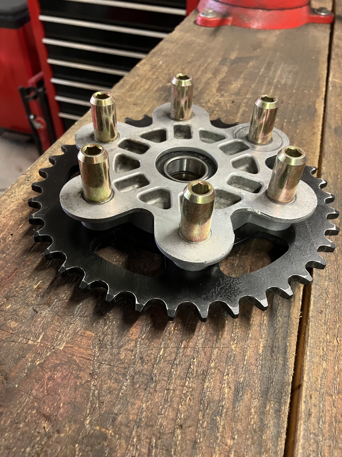

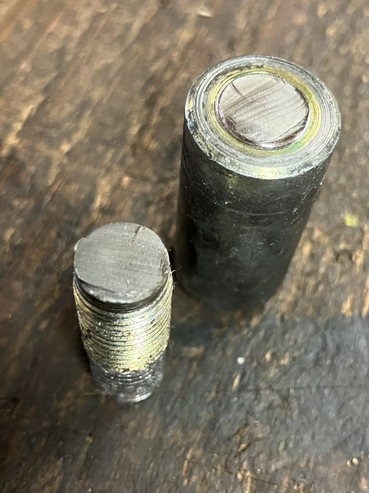

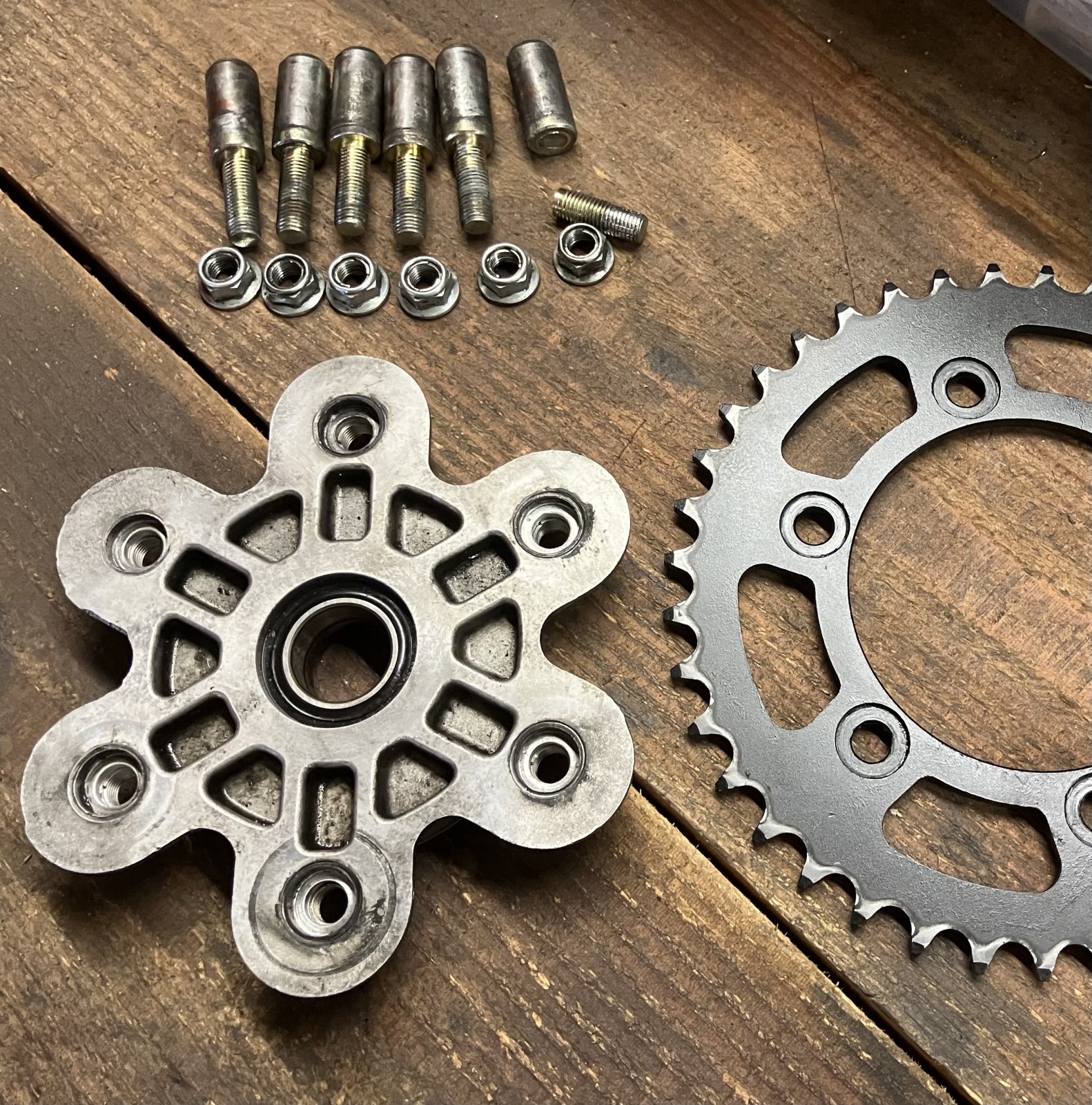

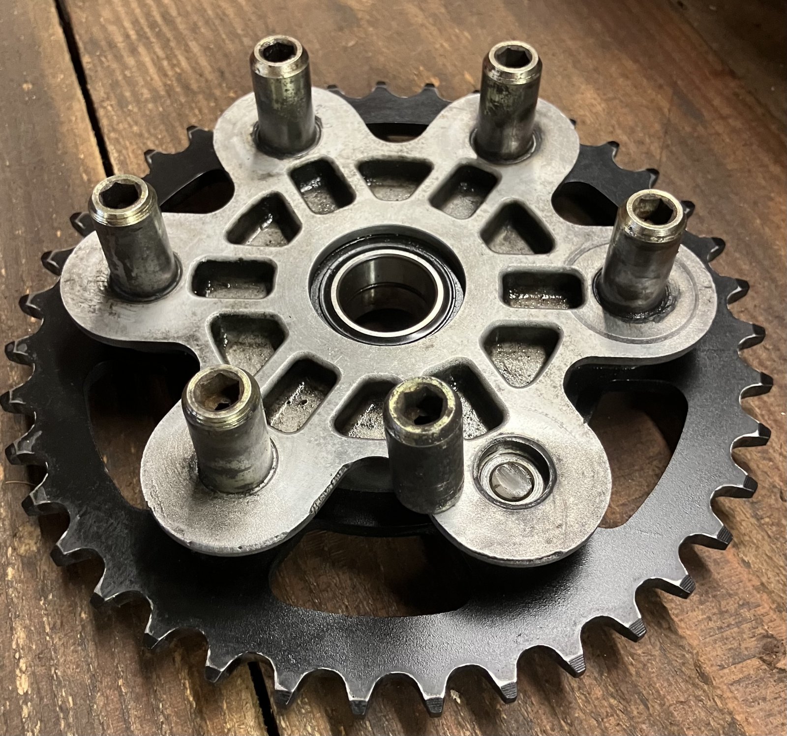

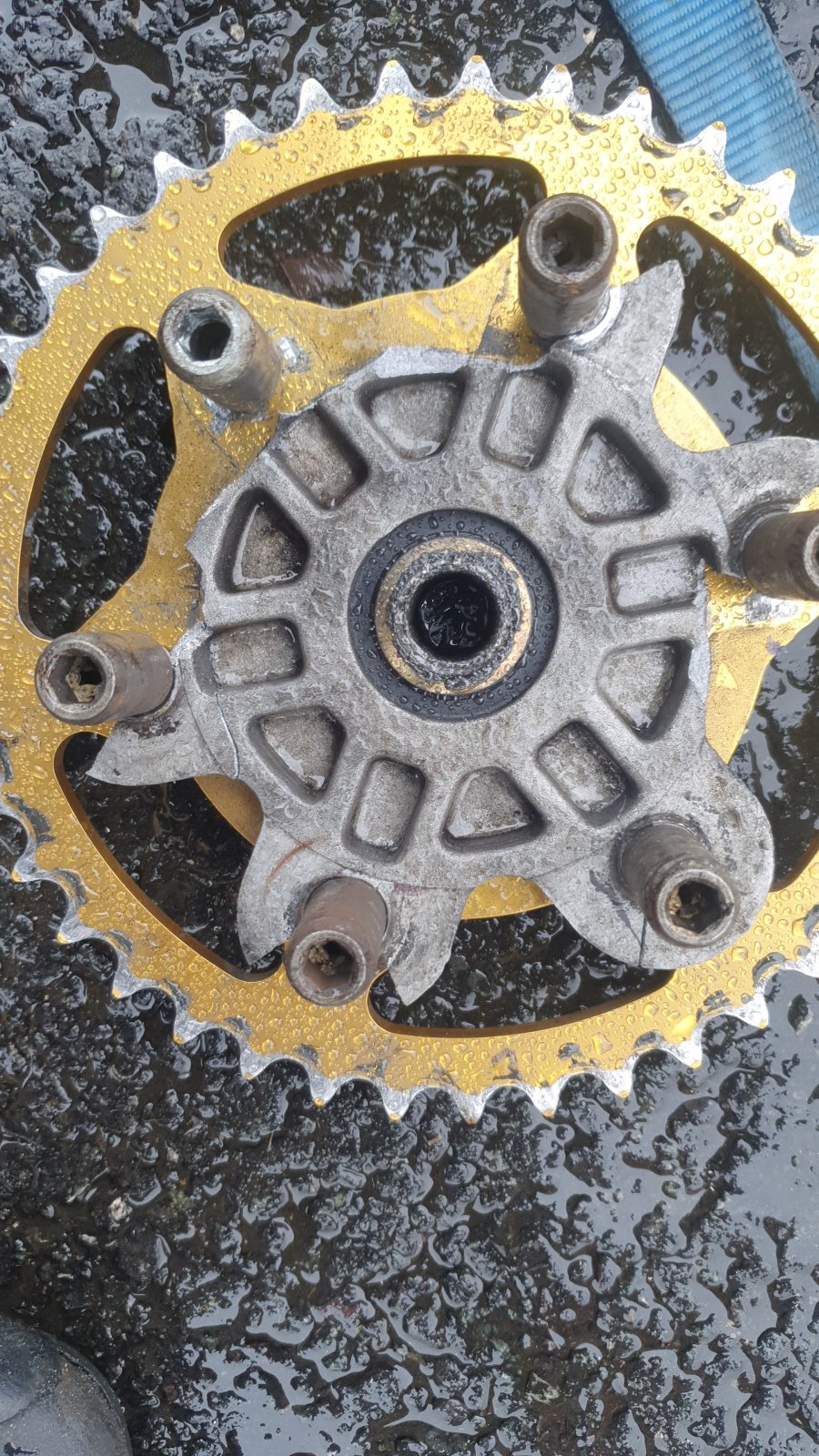

    Then last weekend, first spring ride, all was well and when I got back, moving the bike in the garage, I heard a weird « clonk clonk clonk » noise coming from the rear wheel. Looking closer, and inside the wheel hub, I noticed something amiss with the rear sprocket carrier. One of the bolts had snapped. IMG_0830.jpeg IMG_0833.jpeg IMG_0832.jpeg
    I still do not know what may have caused this. I checked this when I recommissioned the bike, and torqued the 6 sprockets bolts carefully at 48 Nm. I also aligned the wheel with a laser tool. Well, these are almost 40 years old, so I decided to replace them all with new ones. Looking clean and tight now. IMG_0835.jpeg IMG_0836.jpeg

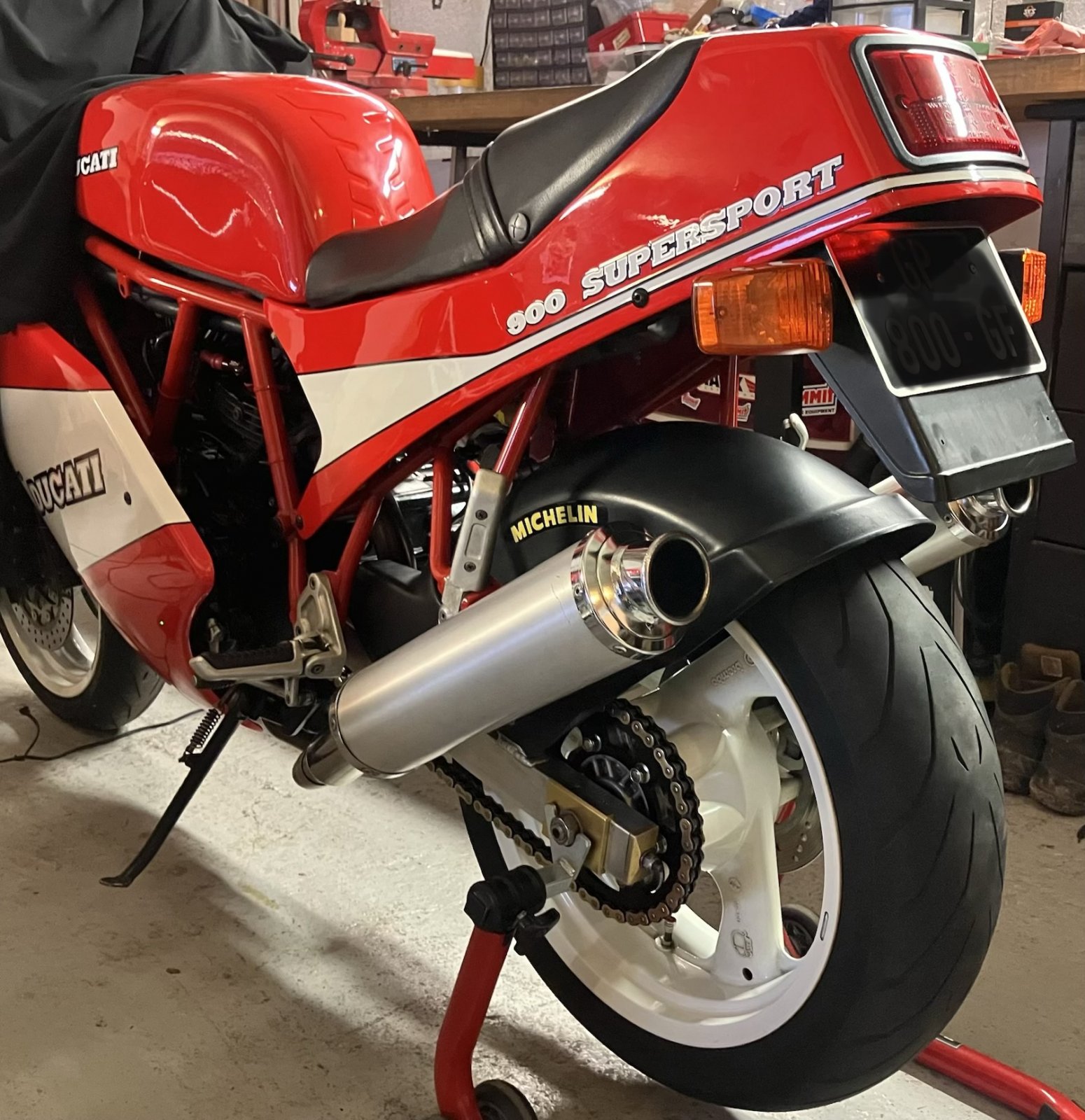

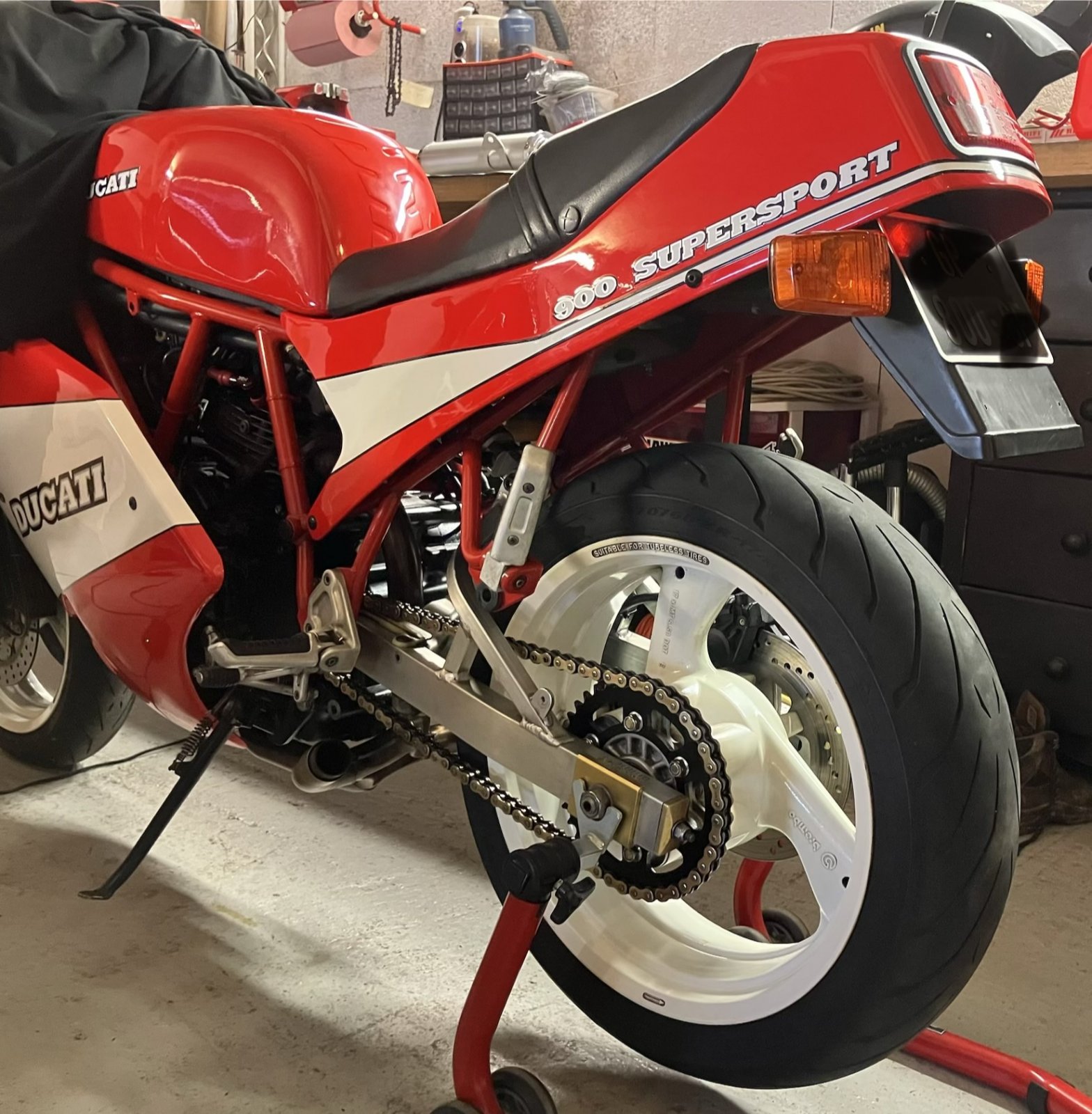

    Took a quick snapshot of the rear of the bike before mounting the rear hugger and the exhaust silencers. Bike looks very racy like that. IMG_0837.jpeg
    Street legal means a heavier rear. Still looks lovely to me though.:heart_eyes: IMG_0838.jpeg

  10. Good Lord! Did you have any more idea as to what may have caused this?
    I'm not familiar with the model but I'm assuming there is some form of cush drive, so perhaps the rubbers have gone hard and/or worn which allows a little too much movement.
  11. @Andy Bee
    There are indeed independent rubber dampers that are inserted in the wheel hub itself (same wheels as 1989-1990 851s). They were all replaced by new ones when I recommissioned the bike 3 years ago. IMG_0869.jpeg
    The bike had very low miles when I bought it (12.000km). May be one of the bolts snapped due to some defect in the metal after I reached the 20.000km mark?
    Also, I ride this bike in a pretty « spirited » way (as it should be, imho), with WOT action every now and then when exiting nice opened corners and all, so maybe I am sometimes asking too much?
    Unlike the 851 and 916, I can handle WOT without shitting my pants, on this one… :D
    #191 Guillaume69, Mar 17, 2026
  12. So it seems the engineering of rear cush drives didn't improve much after the Bevels... : unamused:
  13. Honestly, I wouldn’t judge the whole concept just on this particular mishap. I never experienced this issue before on any of my other 90’s Ducatis in many happy miles.
