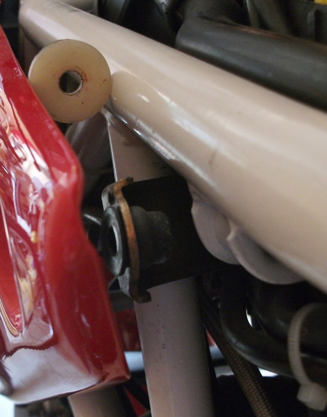

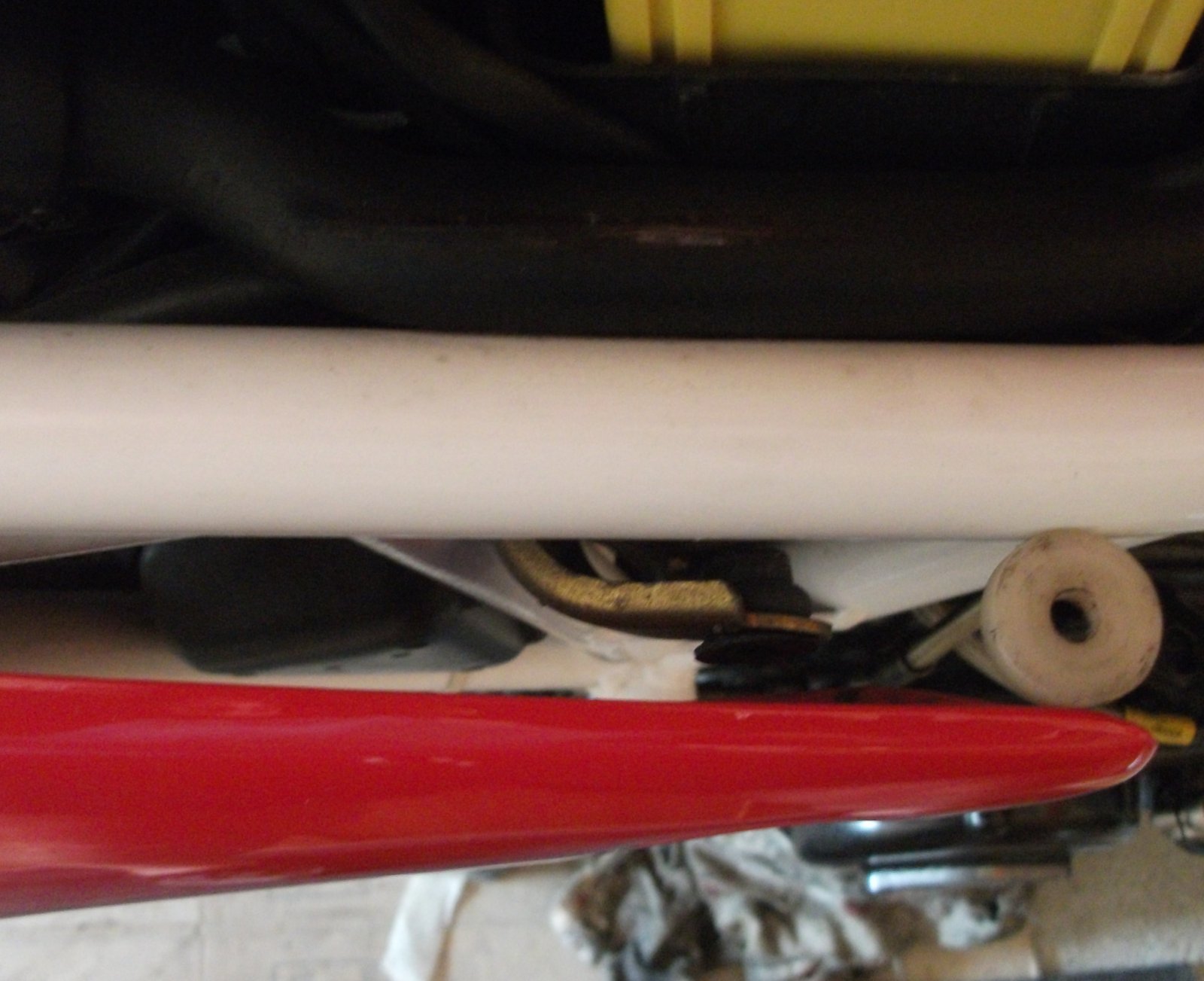

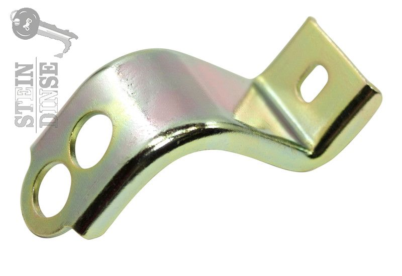

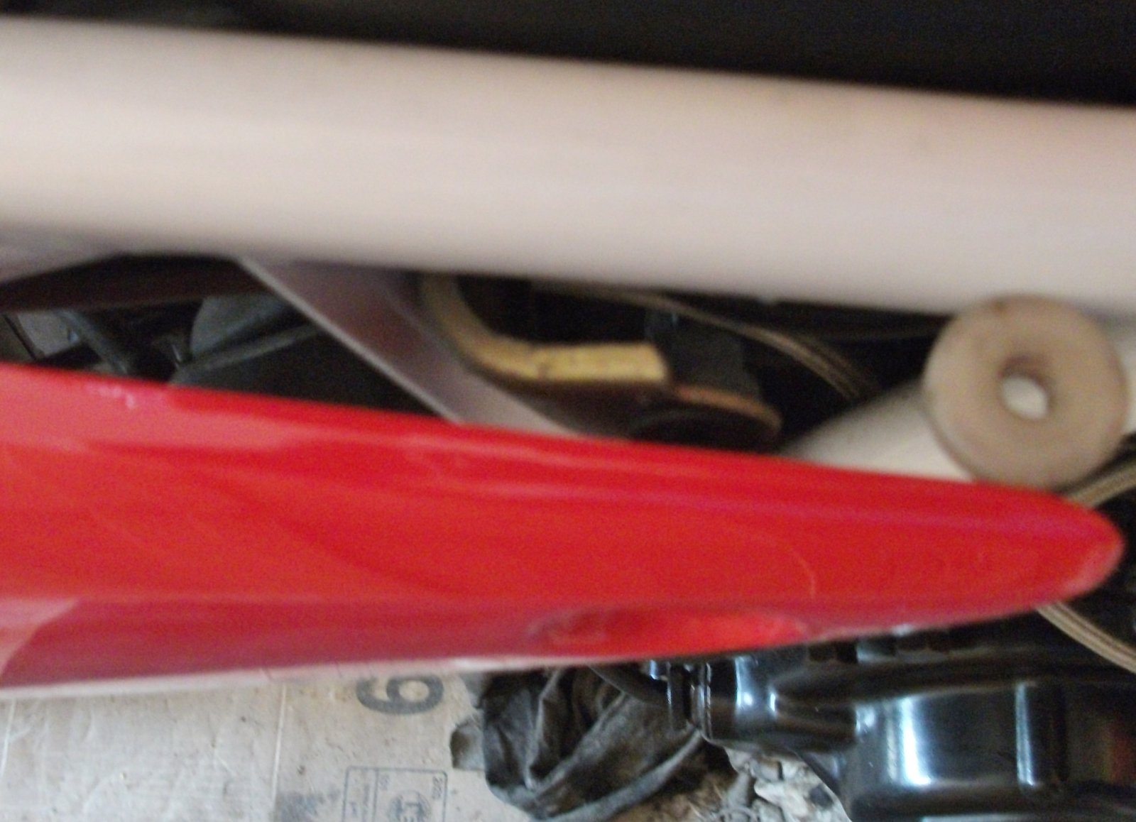

  5. I have these - arrived in the post today. I'm perhaps a bit thick as I still cant quite visualize where in the frame they connect. Pictures?
    Also - does anyone know if the brackets were painted frame colour originally?
  6. no paint, just plated from factory, they affix inside the top of the frame facing to the rear, I'll get a picture!
    that was harder than I thought, note the nylon washer propping open the gap twixt frame and fairing, this goes between the inside of the fairing and the wellnut face, hope this helps some, camera not great.

  7. Great! i was thinking they came down vertically (not sure why). Helpful, you have been!
