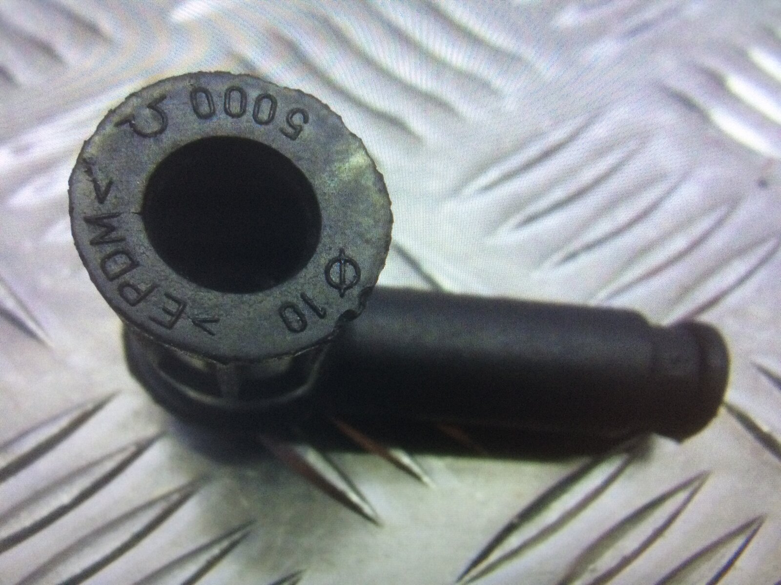

  13. Would it possibly be the oem metal plug caps ? metal- damp ?
  14. I would definitely get rid of them asap. They caused no end of trouble to my Guzzi and that was in the 80s.
    But I'm not even sure if they were OEM on the SS.....The ones on mine were crap black rubber.
  15. ^^ agree, black plastic on mine and on my earlier one.
  16. I seem to recall that the metal caps on the plug leads were to shield the waves that interfered with car radios and nothing else. A common cause of miss fires on 70 & 80’s bikes and always removed.

  19. I have ordered DCPR8E 's for it , the metal clad caps i would say are original, the bike has only 17k on the clock.
  20. can we have a pic of the metal plug caps?
