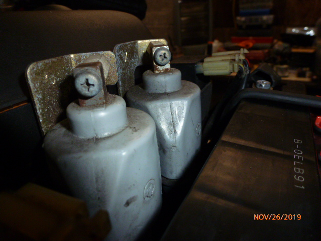

  8. Here is me caps and coils.....
  9. :upyeah:they could be standard - no idea. Same resistance as std (5K ohms). Whatever you do, don't try unscrewing the leads from the coils as it will wreck them - they are not the screw in type - coils are original by the looks.
  10. They are the OEM type that were fitted to mine. Junked straight away for NGK caps.
  11. Even the later black coils were better than the light grey ones.
    If not screw-in HT lead type, then the leads are most likely carbon ones which can break down when new, let alone when old.
  12. they were just ordinary wire Al, and not always copper from memory.
  13. When I got it, my SS was so prone to fouling that it came with a spare plug under the seat.
    I got some California Cycleworks coils and it was completely cured. It idled and picked up better too.
  14. The caps are Bosch 5 ohms rated, unscrewed the caps and revealed wire HT leads the front pot cap showed corrosion on the self tapped screw, the wire contact in the lead also signs of corrosion, which won't help . Fitted the new plugs no different no sign of firing, just wetted the new plugs (resistor type). Next step ordinary plug caps to be ordered.

  17. Re: cap resistor - there's a 'K' in there Tony :upyeah: haven't read whole thread - have you got any sign of a spark on either cylinder?
  18. Hi Chris, yes both are sparking outside the pots.
  19. Thanks Chris.....the ones I removed from mine were in fact a bodge of up the rubber caps with the carbon leads.....it was no wonder they wouldn't stay on the screws.
    Plugs, caps and leads were the first things I dealt with when I got the bike.
    Interestingly I did also have some brand new Champion plugs of the right OEM reference number but the sparks they produced were tiny compared with the correct NGK ones.
    AL
    #59 Arquebus, Nov 26, 2019
  20. It is odd IMO that both spark outside but possibly break down inside.
    Even a poor spark should get some sort of bang unless the coils etc are so weak.
    It might be a good idea to see if they are sparking at the right time if not already checked.
    Also check the pickup wiring.....are they sending to the wrong coil and HT lead?
