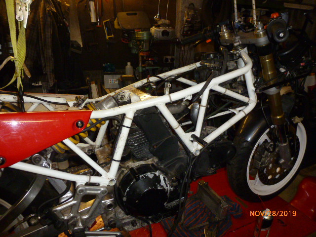

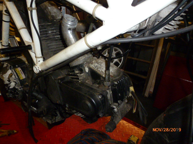

  9. Managed a couple of hours again today, great being retired. Nearly ready to attempt dropping the motor out . Loads of cable ties snipped , airbox, and carbs off, drained the oil and bunged up the orifices.
    • Like Like x 7

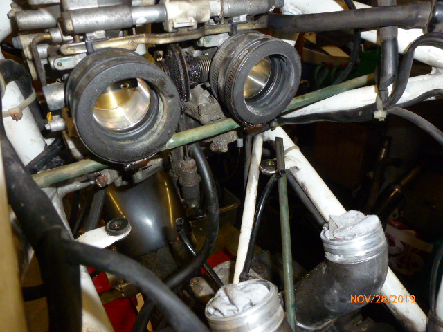

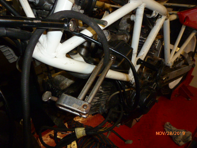

  10. What's the reason for the hose clamp? Stopping fuel from the carbs?
    If you are going to strip the carbs, don't forget the tiny filter in the T piece between the carbs.

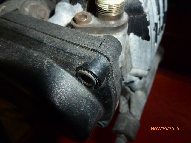

    Looks like you need some new rubber manifold connectors.
  11. Clamping hydraulic fluid for clutch slave, carbs are going to be left alone it runs fine, carb connectors are fine no signs of being perished.

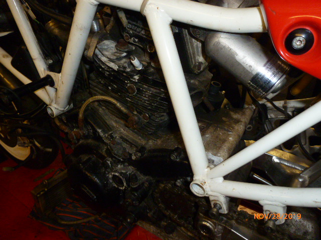

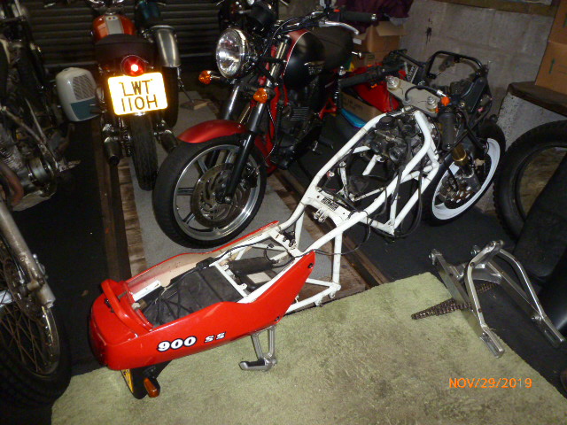

  12. Have you got a broken frame PB or is it meant to be like that? First pic, far side, where it extends under where the seat would be.

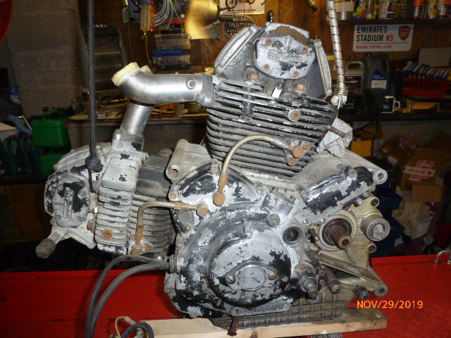

    Also, where’s it been that the engine is that corroded?
  13. Well spotted hawk eye.
  14. In the photo the right hand carb rubber appears to either have an internal split or there is a chunk missing from the sealing ring.
  15. None of that would put me off though, I'd love to do a resto on that, I'm a little envious @portboy

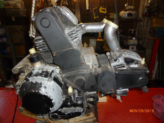

  16. The engine is out and about an hour with wire brushes and scrapers is looking much better already. You hawk-eyes must have wank-eyes frame and carb rubbers are fine, leave the tadger alone. Seriously though thanks for the input at nearly 70 i am bound miss something one day.

  19. Must be one of those Optical illusions!
  20. You and me both, so if I can see something in what would be the left hand carb rubber (right one in the photo) with my bad eyes..........
