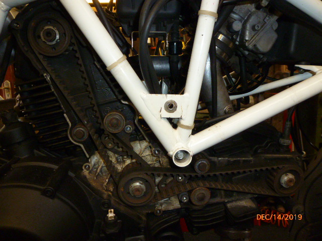

  8. Pulled the timing belt covers off lined up the dots , took the tensioner off for easy action. I cant remove the horizontal belt it's hampered by shields on the crank and cam wheels, the idler roller i think needs to come off but is fvcking not playing ball two flats for a 10mm open end spanner, adjustable wrench, molegrips and can get about a 1/4 turn then locks up. I concerned that i am going fvck the thread it's in the base of the front cylinder.
  9. Those idlers are a pain in the butt. If it moves then great, I would use some heat and work it backwards and forwards. Mine had loads of thread lock on them. If you need to replace them, you can get them for about 40 quid each. Ducati want 70!
    Do you have to remove them though?
  10. Someone....can't recall who.....made up new ones using a pair of bearings.
  11. It seems the only way even when the idler is good, the belt will not clear the side plates for removal and there is a bit of deflection caused by the small idler. I could cut the belt off but i am going to face the same problem when trying to re-fit new belts ?
  12. I must say I've never had to remove the idler to remove or install belts on my Dukes.
  13. me neither, so we all learnt "the knack" but (so far) no-one's managed to describe this on here and I can't remember - someone needs to pass this on to Tony/portboy. :upyeah: I might have a look at a few YouTube guides.

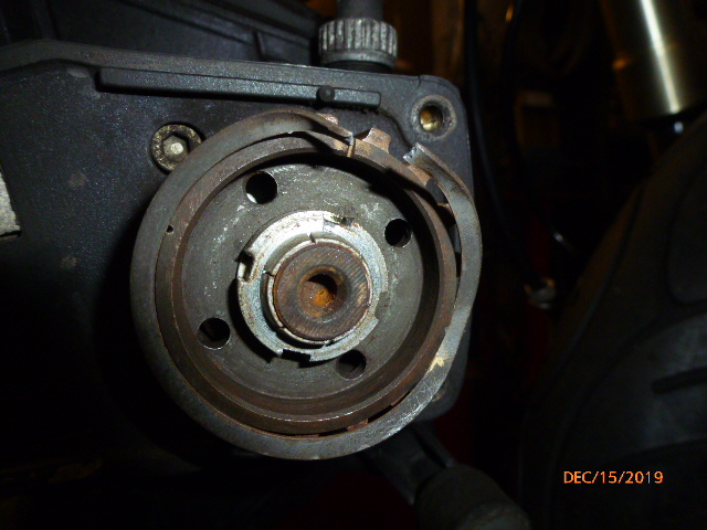

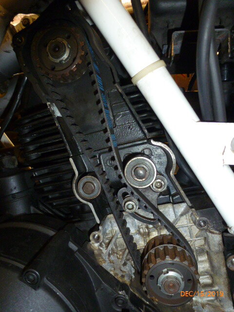

  15. The workshop manual states remove the 'movable stretcher' and it is recommended to remove the 'steady stretcher' as well with a suitable wrench, to make the belt removable easier.
  16. One belt fitted, IMO there is no way of removing the belts without removing both idlers for each belt. As i i wasn't going to unnecessarily create more problems so i removed the outer shields from both cam wheels and the crankshaft wheel, they are thin and just pressed onto a spigot end. Belt slips on a treat.
