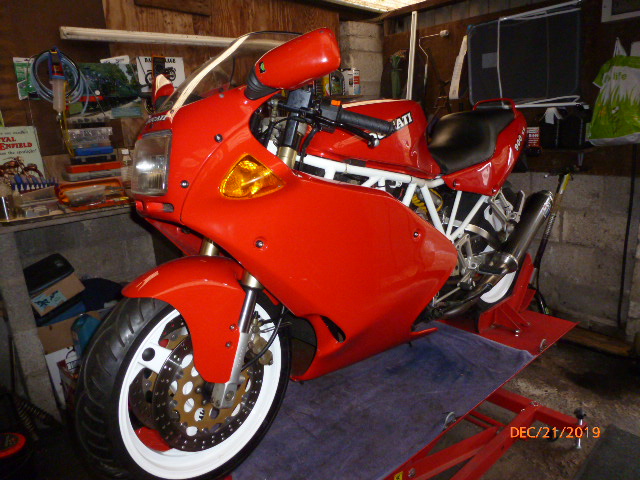

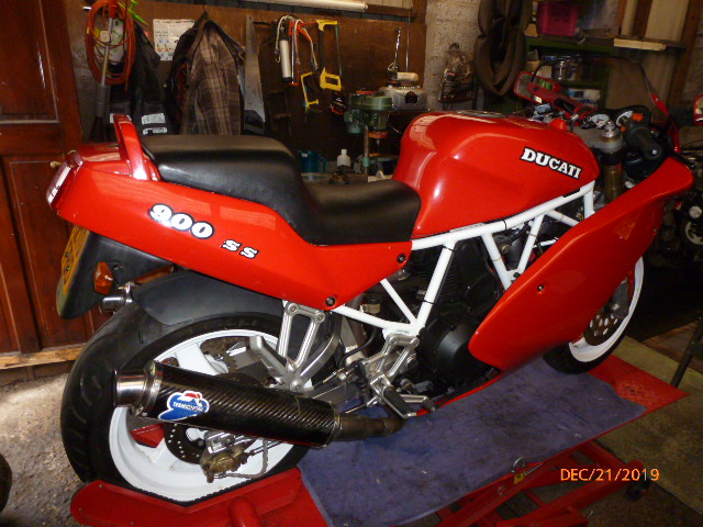

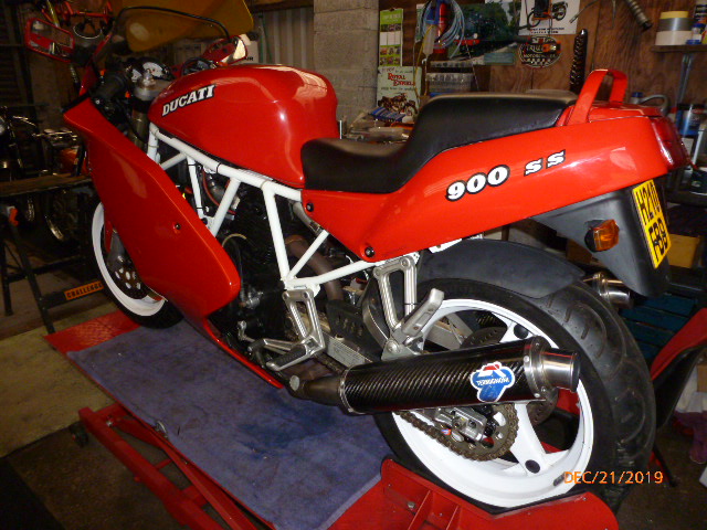

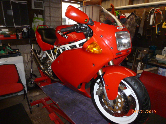

  5. All done, very pleased with this little gem, light refurb costing about £300 all in, servicing, hydraulics, paint work.

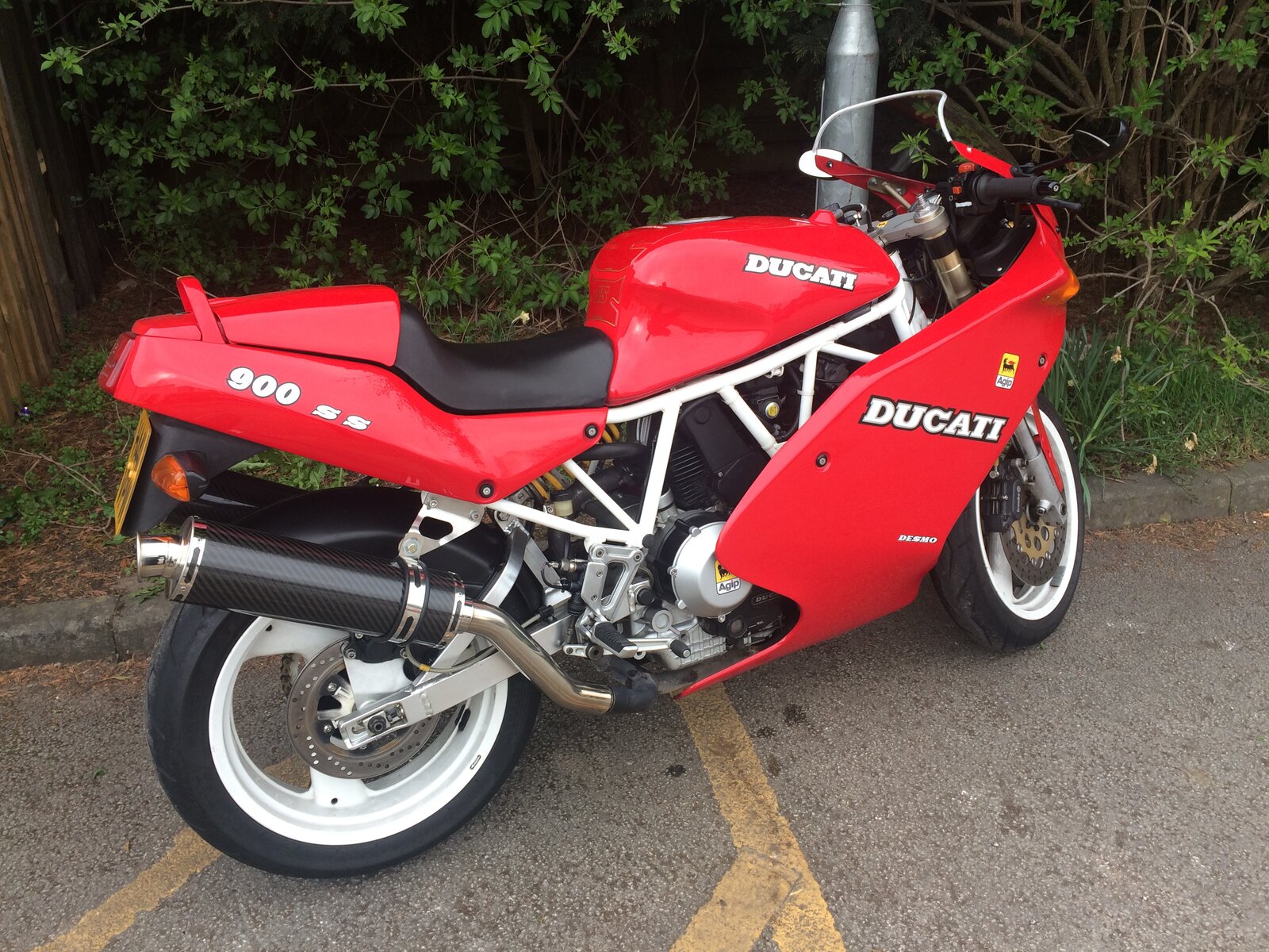

  13. looking good! i owned this bike from 1999 to 2012, PM if you want some history filled in.
