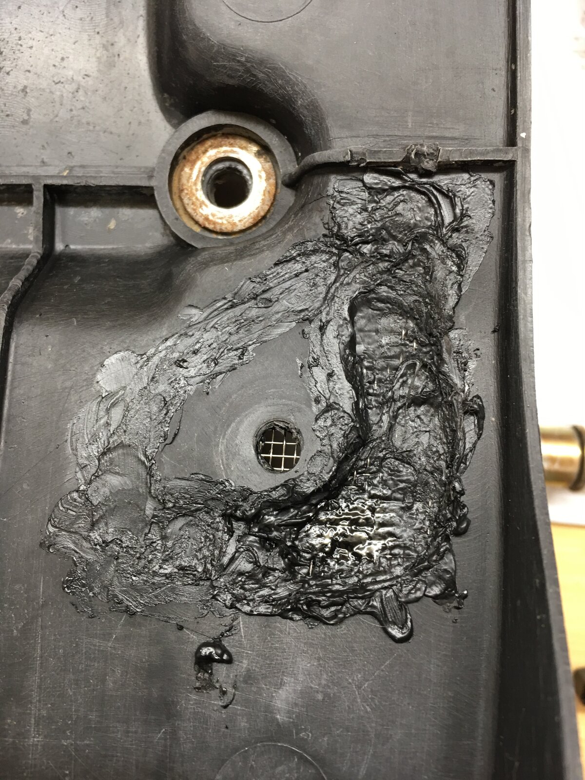

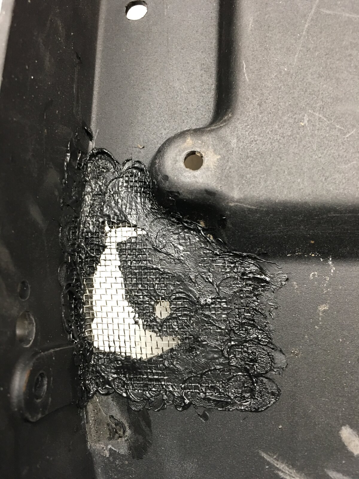

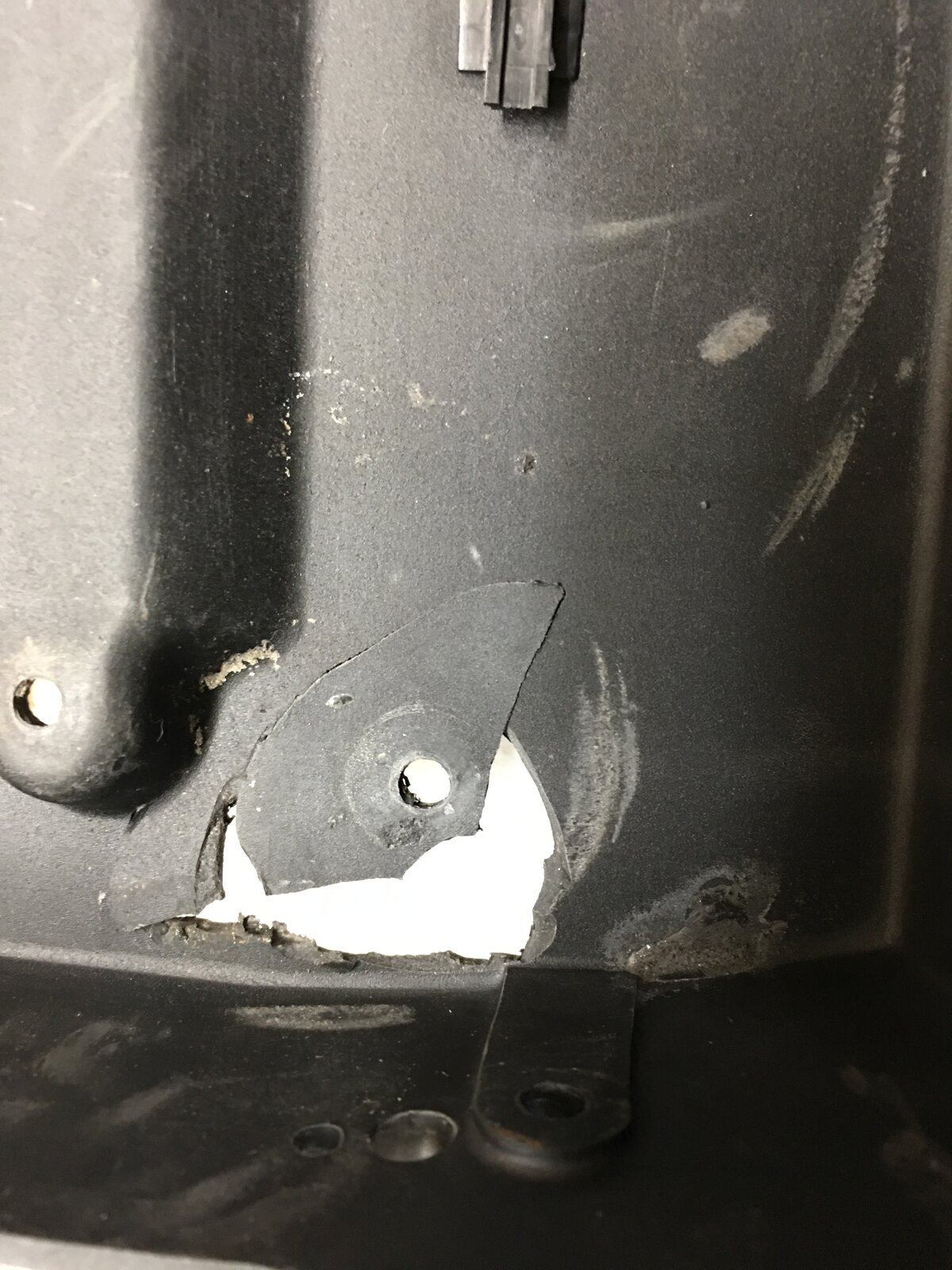

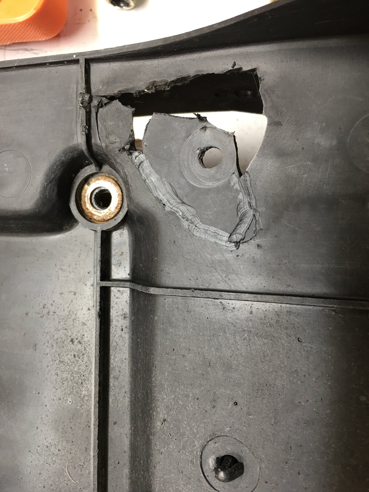

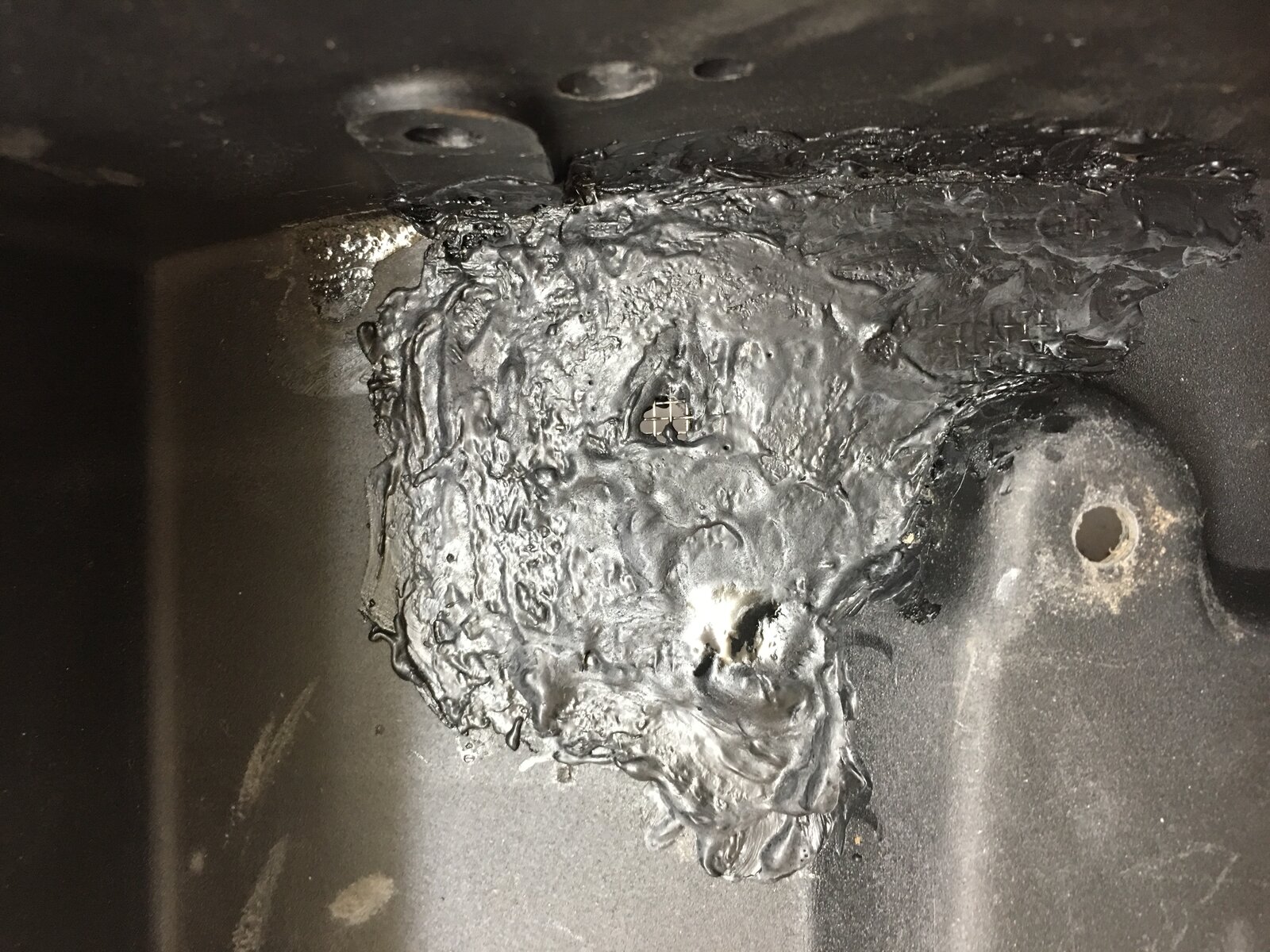

  15. Have you tried plastic welding? My rear tray took a major hit from something before I bought the bike.
    You can get a kit from Amazon (I am sure they do one similar in Aus). Takes a little bit of practice, but the results are pretty decent (just takes a little while to smooth out and sand flat). Here are some photos of before and during the process (final version was good). You may be able to find someone to do it as a service.

  16. Thanks for the heads up bud.
    May have to resort to this process if im unable to find one.
    Hopefully i can get in contact with the guy on the 851/888 facebook page.
    A mate is trying to contact him on my behalf.
