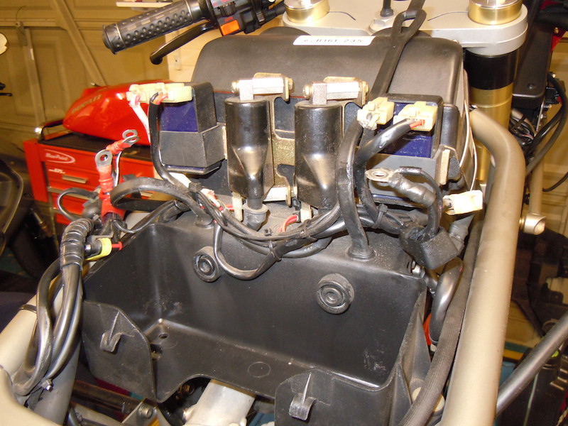

  7. These are said coils fitted to my bike, just had to change the two smaller spade terminals to 90 degree items for clearance & looks.
  8. This is the "before" picture, you can see the original connections on the bottom of the coils, whereas they are on the top of the replacement coils.

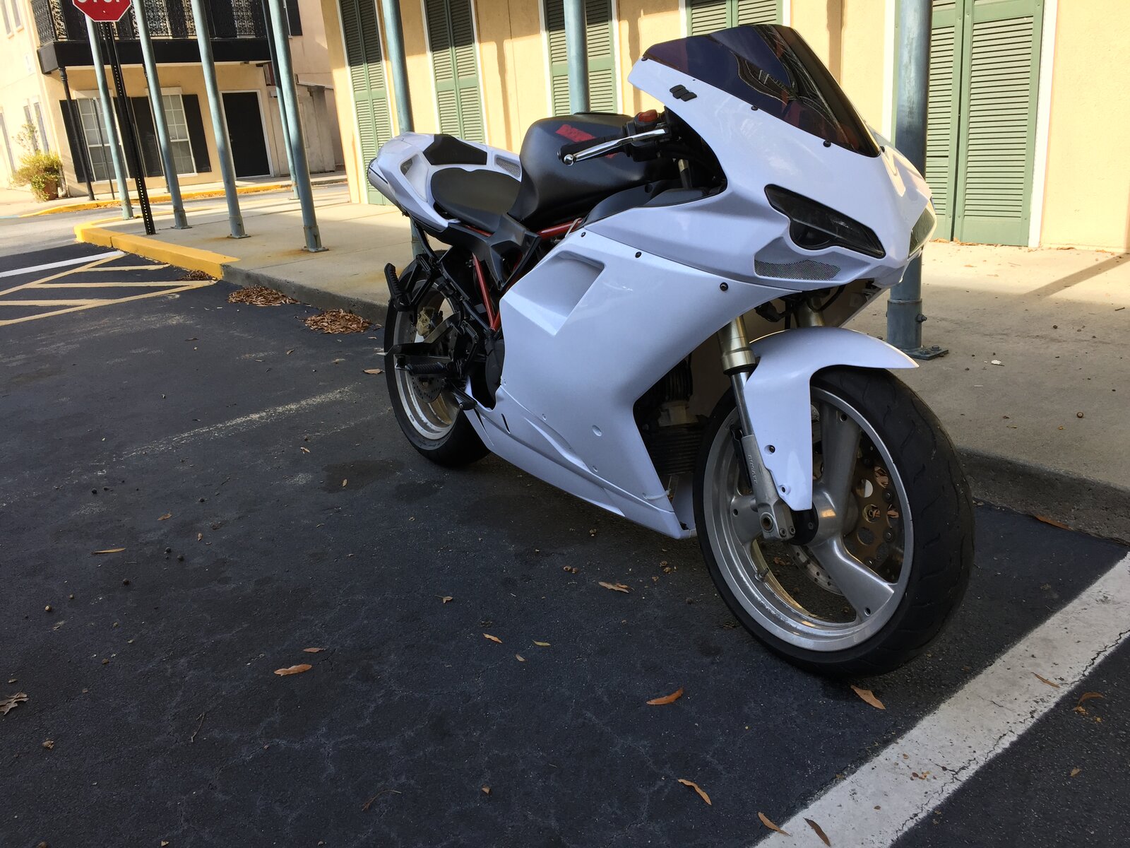

  11. CE58DB06-B4CC-49B4-B9C5-39D89F928CA6.jpeg 434DE76D-1E5F-4DAB-8184-67572B437BF2.jpeg CC9176AA-B73D-4B77-AEF3-F7B74D7CDAEB.jpeg Waiting for coils will give me time to sand and paint the tank white. Also you might understand why I’m Dr. Frankinstien. She’s 27 but she wanted to feel young again. I expect backlash but she’s my creation and I love her.

  13. Well, that certainly doesn't look like a 1993 750SS.
    I think it looks very promising.
    Shit hot, in fact.
