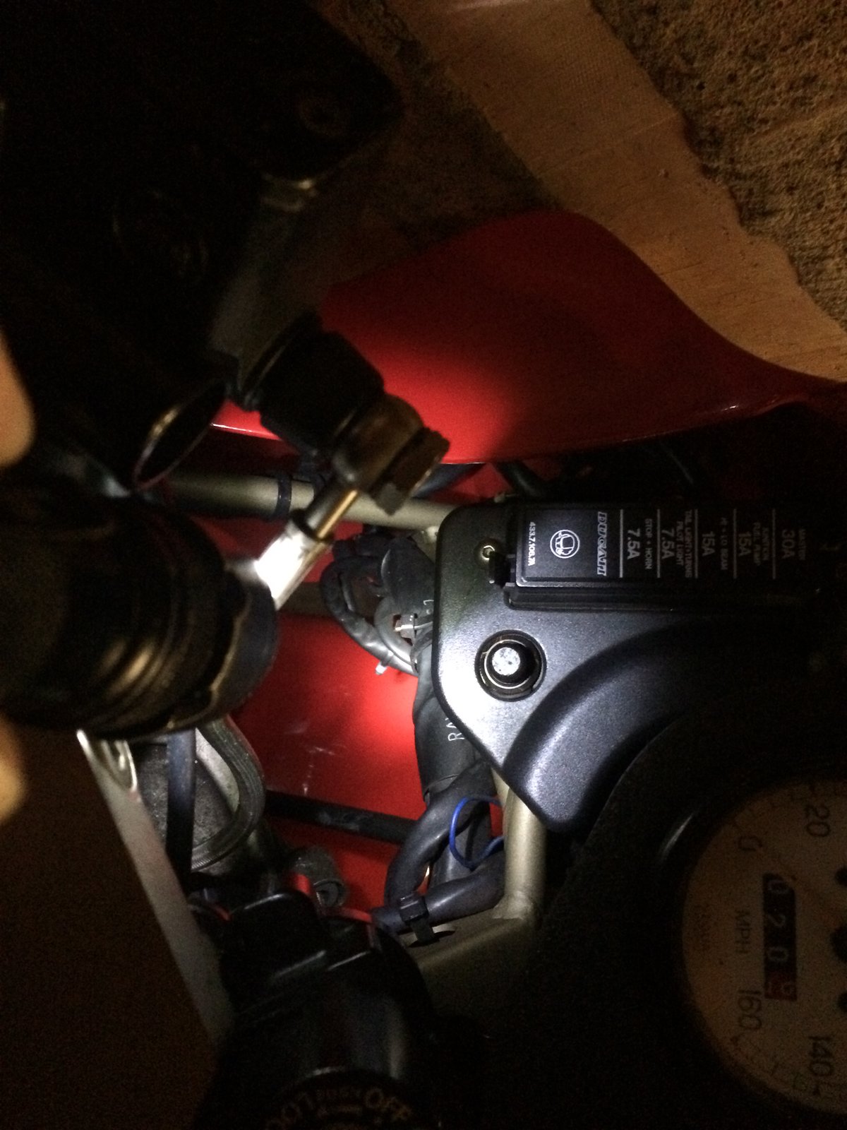

    Down to the left of the clocks next to the fuse box, just rotate the knob, it only turns one way.

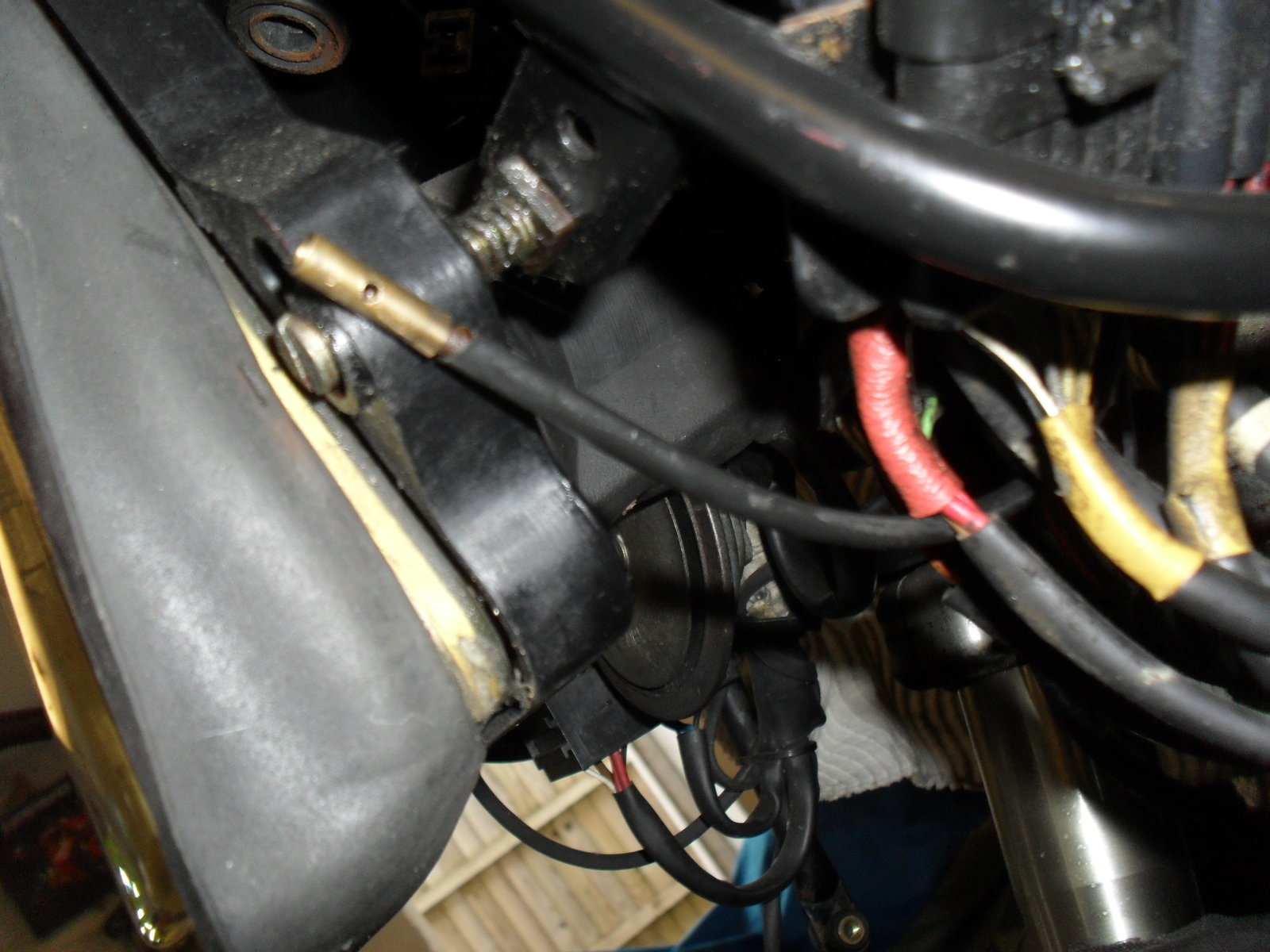

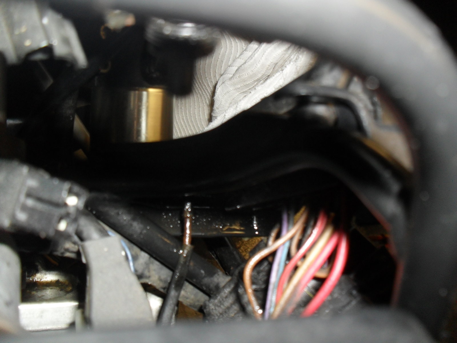

  18. Cable is soaking nicely at the mo - here are a couple of photos, the free end is the trip meter SAM_3104.JPG SAM_3105.JPG SAM_3105.JPG
  19. Can you nut undo the nut holding the whole thing on the dash? It is the serrated / milled thing around the knob seen from the top. On the underside of the dash, it is just plain (like a washer) but part of the threaded body which the nut thingy screws onto.
  20. ok will try, probably at the weekend. I have managed to get hold of some OEM bulb holders from StarTwin in Holland
