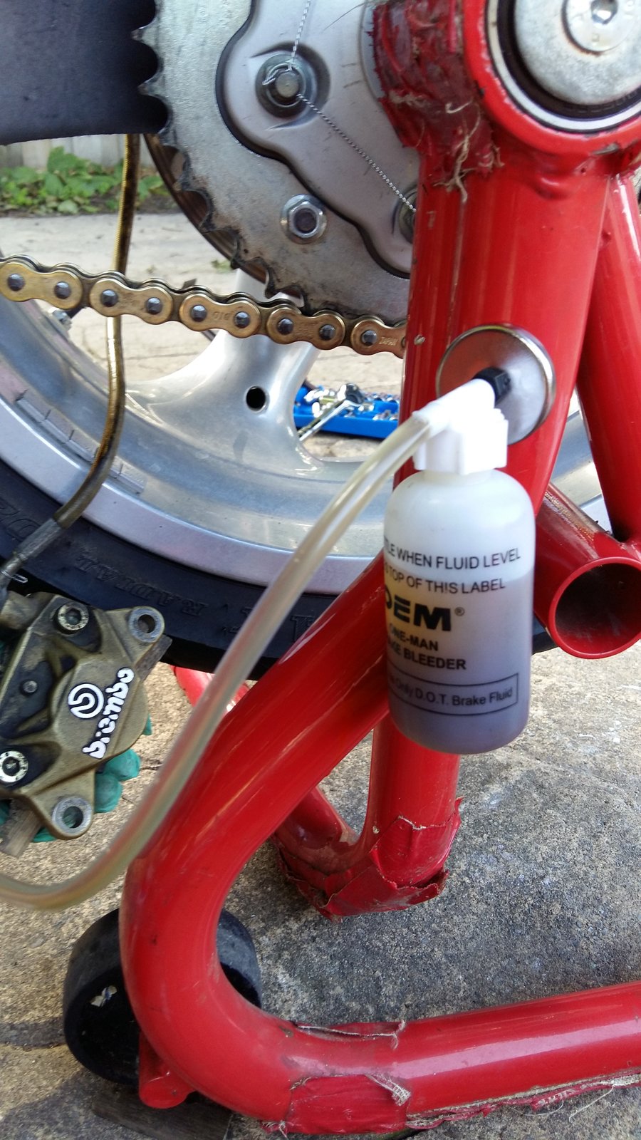

    Brake & clutch fluids replaced today. Fluid clear in the master cylinders, but dark in the lines after 10+ years. I tip my hat to whoever thought up including a magnet with brake-bleeder kits...

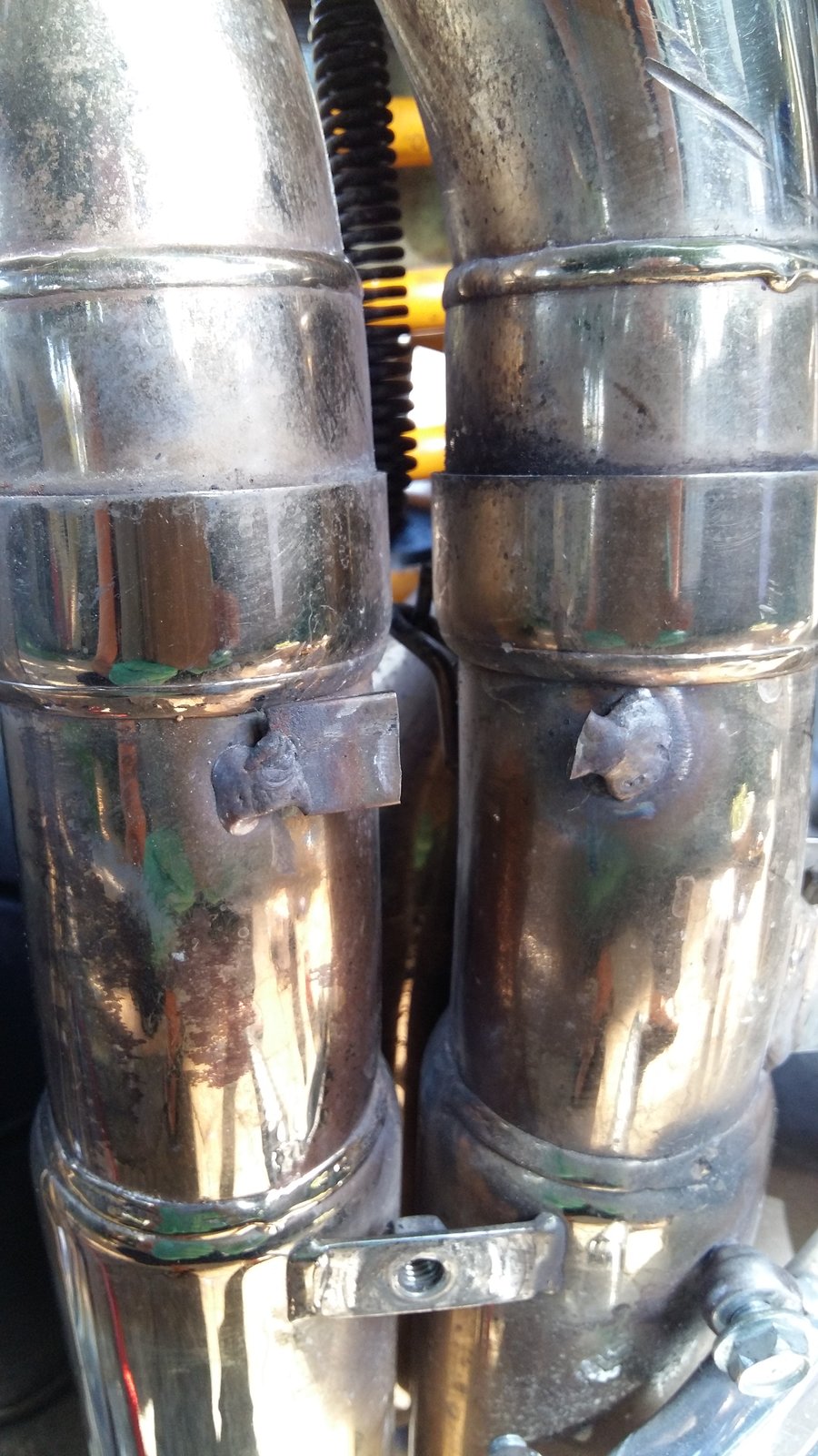

    On the other side, the heat shield didn't seem to be sitting right. Unscrewed to find a snapped plate for the upper bolt. Recovered the plate from behind the heel guard. What's the best way to reattach apart from welding?

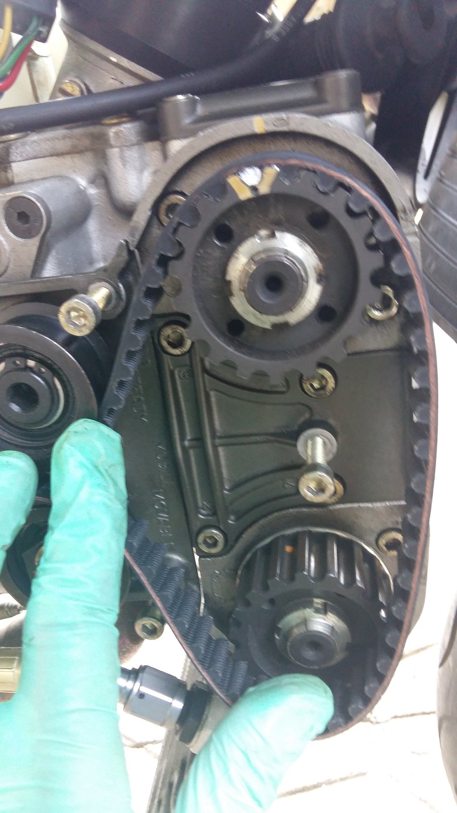

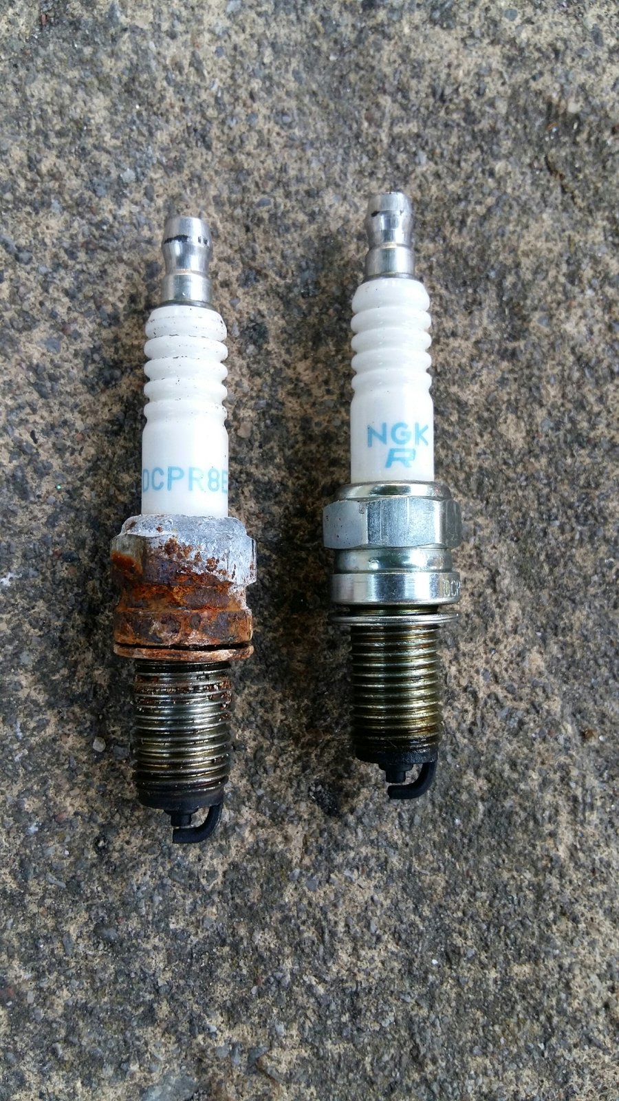

    With the bike stripped and belt covers off, first step was removing the spark plugs. Pretty sure the NGK spec for 4V motors is DCPR9E, old ones were one step colder (8E). Vertical plug was looking the worse for wear...

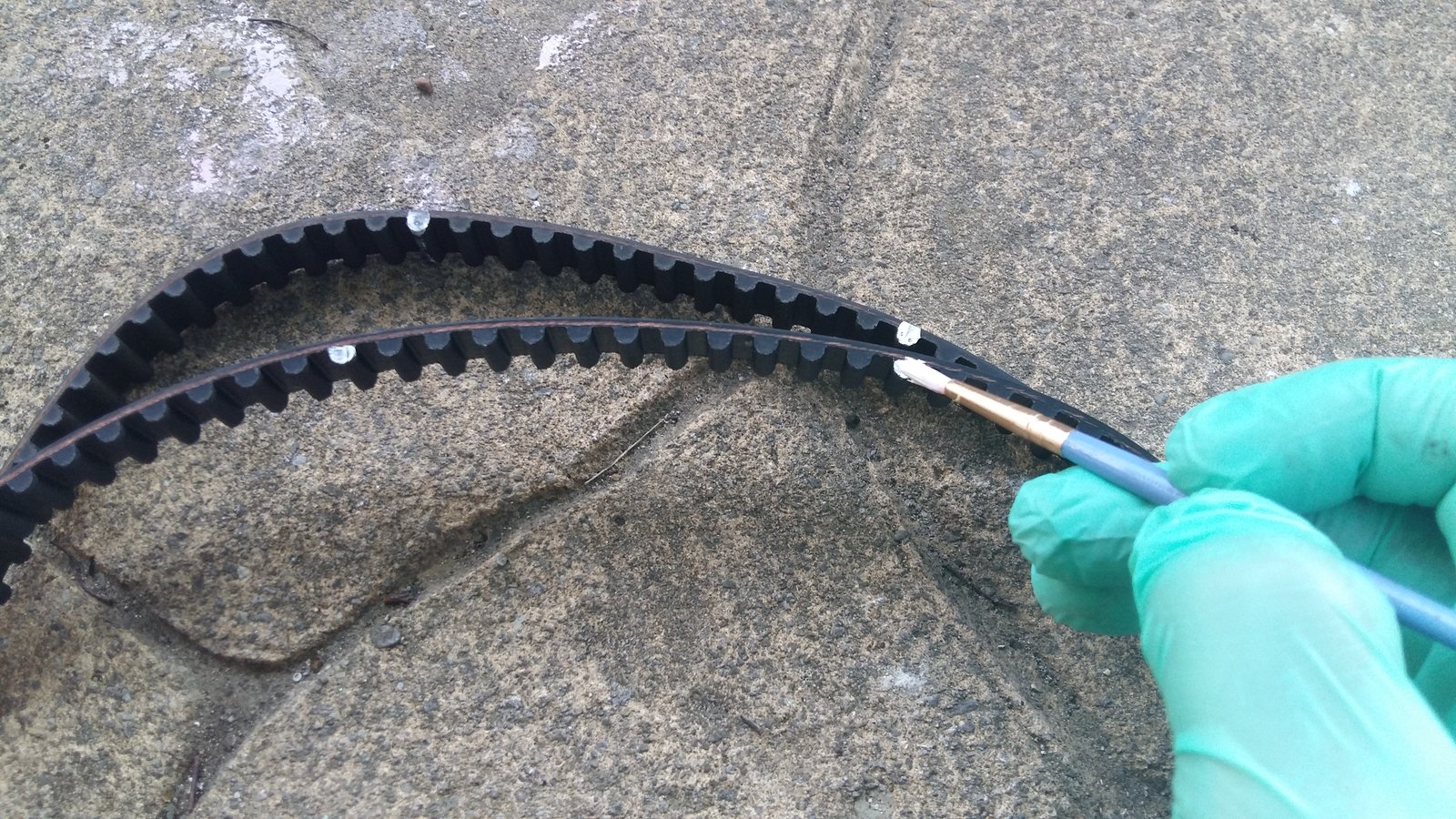

    With all the marks lined up, it was time to paint the belts. With white dots on the crank, intake & exhaust cams, I now removed the belt by easing off the locknut and tensioner pulley. Did the same to the vertical cylinder and removed that belt, too.

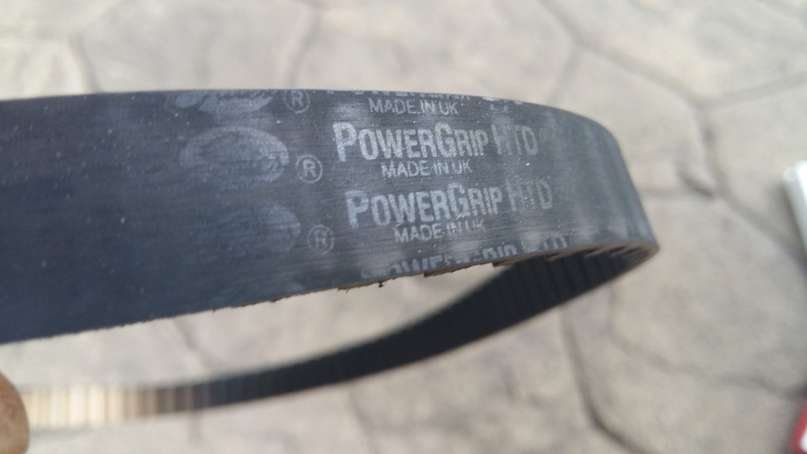

    Officially, the old belts were OEM, with ducati part# 737.4011.1B printed on them..... but what was that faded writing next to the ducati branding...?

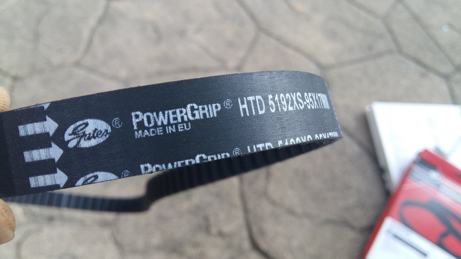

    I compared with the new $30 Gates belts I picked up on amazon...
    Apart from being made in France, not England, they appear to be identical. I can't say how much they would have been if I went to a dealer, but I'm gonna take a wild stab in the dark and say significantly more than the $60 I paid for the pair online.

    Time to count teeth and transfer the marks to the new belts. The key things I needed to remember was a) The O cyl has 21T between marks, the V cyl has 12 and b) to count back 3 teeth for the correct crank mark on the V cyl.
    With the brushwork done, I now installed the vertical belt. No cam holder, but with a bit of patience it went on fine.
    Put on the horizontal belt now and although this was supposed to be easier due to no compression on the exhaust cam, it gave me a bit more trouble but it, too, went on after pushing hard up from underneath on the intake side.

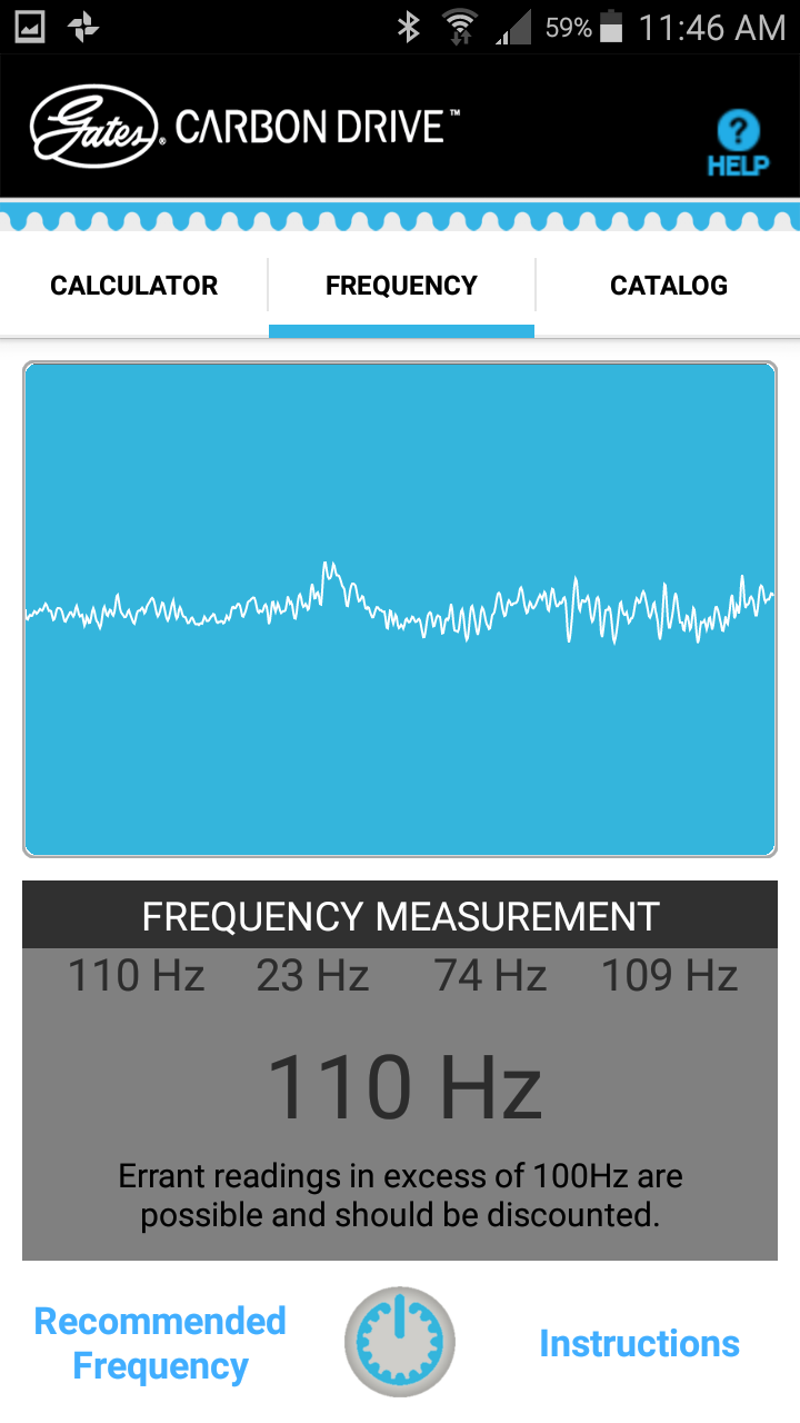

    I was intrigued with the Gates 'Carbon Drive' app so gave it a try. How accurate it is I don't know, but it gave nice consistent readings compared to the guitar tuner apps I use. Managed to get the O belt to 108hz and then rotated crank backwards to TDC on V cylinder. Tensioned that and nailed it bang-on at 110hz:
    Torqued new locknuts to around 20ft/lbs, then rotated crank several times to make sure nothing was hitting. DONE :]

  7. Very pleasing when you do the belts for the first time, I've never bothered marking the belts, so long as all the timing marks are lined up you won't have a problem. Your plugs look to be running rich from what I can see.

  9. Probably right re: putting marks on. Made it feel easier, I guess.
    Yep, I agree bike appears to be running rich. Service history indicates OEM chip... but aftermarket Termignoni slip-ons without a remap would mean bike should run lean? Not sure what's going on there... new EPROM might be a winter project.

  14. Welding... ;)
  15. The discount is an EU based discount from me (the CCW importer www.ducati.tech ) inclusive of import fees, import tax, delivery and vat. :)
  16. See, I knew someone was going to say that...
  17. You could get a thin strip of metal sheet long enough to touch the back of the welds, mark and drill the hole for the exhaust guard then lock wire the new piece on to the rest of the remaining bracket on either side.
  18. Good thinking. Will get creative.

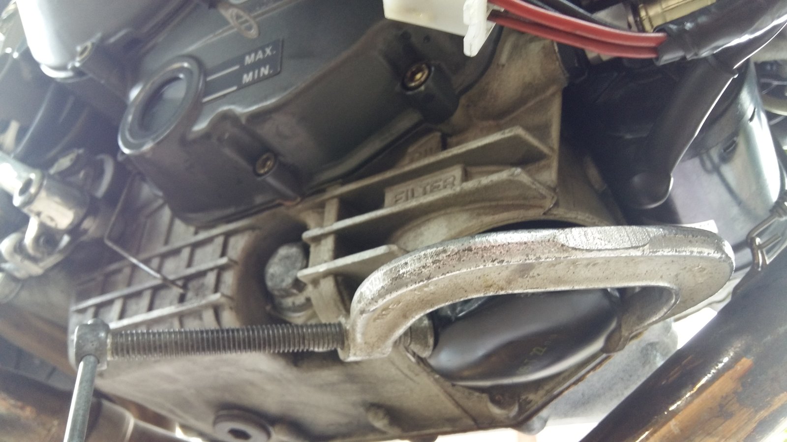

  19. Coolant drained, rad flushed, and new coolant added today, along with an oil & filter change.
    Old oil filter was an absolute bitch to get off. My wrench didn't fit so improvised thusly with a G-clamp...
    Mobil 1, 15W-50 went in along with a new Fram PH6019 filter. Only about 2.5 litres came out of the bike (was at a good level in sight glass before draining), so I'm guessing the 4 litres as specified in the manual is incorrect(?)
