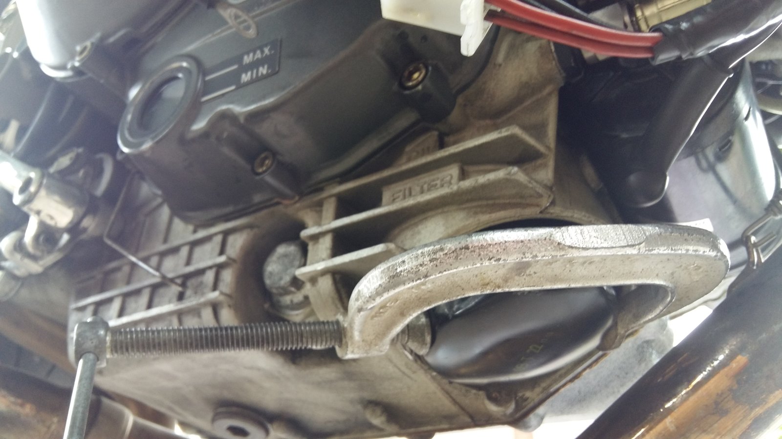

  2. Yep, filter elements were toast. Will discuss further when I put bike back together.
    Tyres are from 2004 and are hard as rock. Sticky Pirellis going on next week...
  3. Did you run the engine to get the oil hot and thin before draining?
  4. Hey old rider, the bike's not running as yet, unfortunately.
    Would indeed normally get up to operating temp before doing an oil change.
  5. Might need to do another oil change when you get it running then as it’s probably the nastiest, sludgiest stuff still left in there.
    I think I might have been tempted to try and warm up the sump somehow with a hot air gun or even a hairdryer to try and thin it a bit.
  6. Was 30°C here yesterday, ambient temp is warm enough!
    But yep, will see if we can get it started and will check condition of new oil. Old stuff was clean, all things considered. Had only done 500 miles since last change in 2005 :D

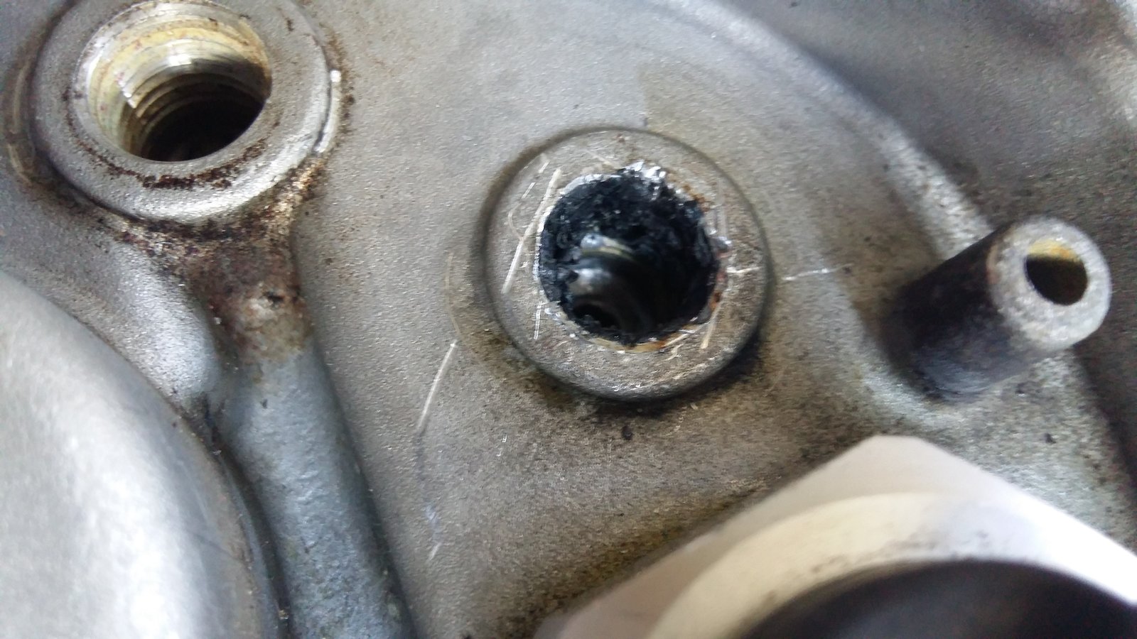

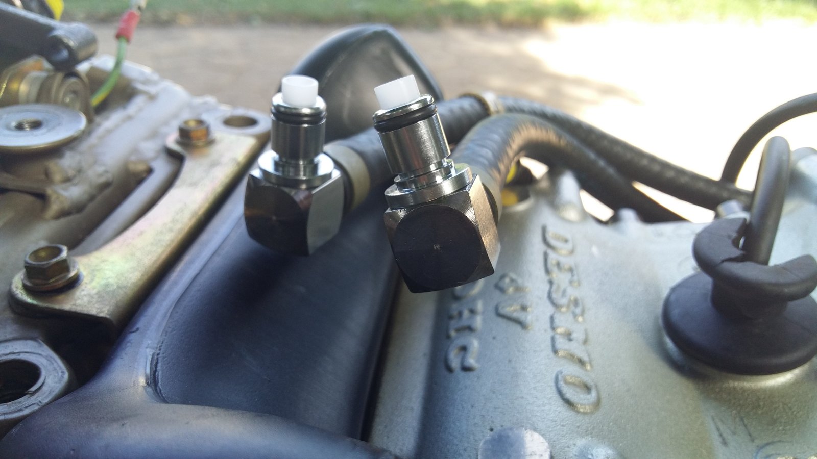

    When I took the tank off, like many of you out there I cursed the plastic quick-disconnects. When trying to take the black QD from the fuel plate, it broke off. 20+ years of heat and age is not the best for plastic.
    Tried a range of options to get the remainder out: 1) Screw extractor, 2) Pick, 3) two small screwdrivers banged I'm 180° from each other with a third one torquing horizontally. 4) Take it to the local garage to see if buddy can help.
    Nothing was working.
    Contemplated burning it out but came to the conclusion fire + fuel filter assembly = creating bigger problems.
    The answer lay in a sharp 6mm chisel. Carved in, but tried not to damage the soft aluminium threads. Success.

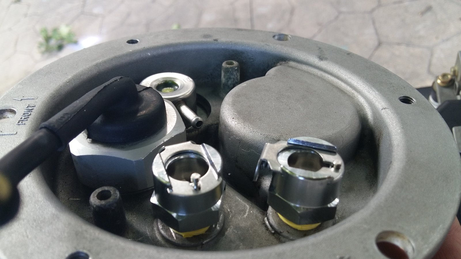

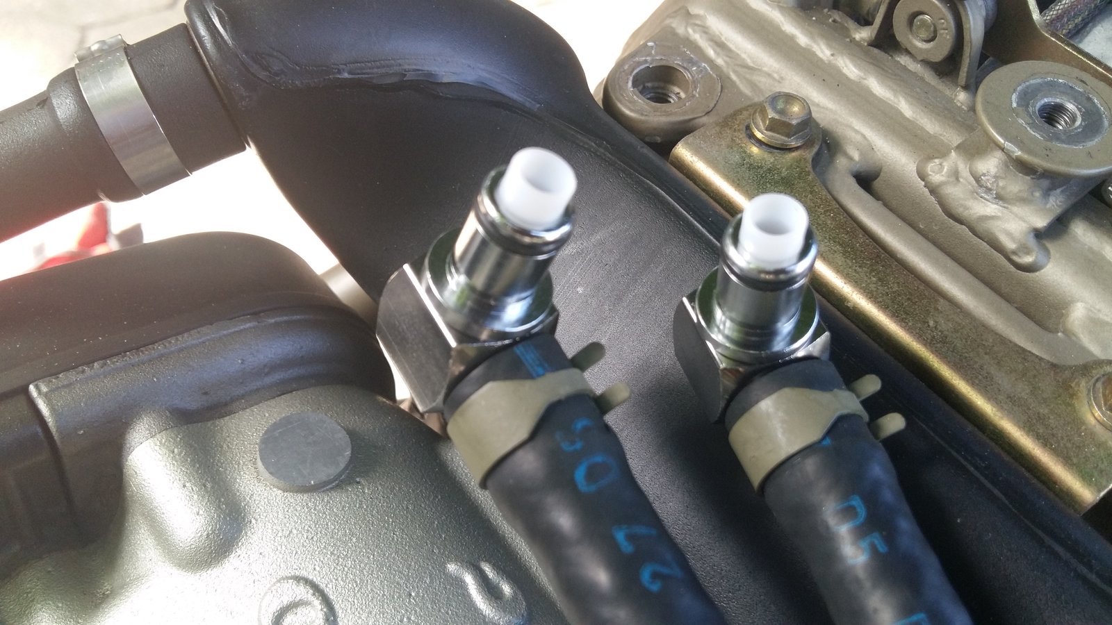

    Pulled out my shiny new metal QDs (w/ viton o-rings) from CPC. Here they are compared with the old ones...
    Only replacing lines in the tank, so slotted male ends into existing external lines, which were in good condition. No oetiker clamps available, so went with the basic options that came in the filter box. Fingers crossed they hold the 100 psi pressure!
    Moved straight on to the tank fittings. Wrapped some plumber's tape on the threads and then got the female QDs in a well.

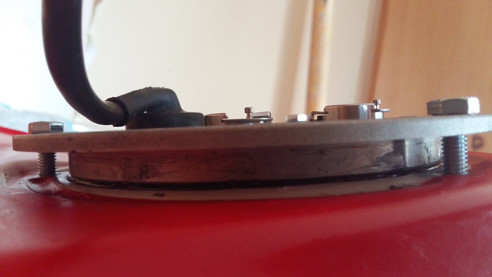

    Kept going and fitted new lines onto the actual fuel pump. I had tested the pump by hooking my car battery up to it for a few seconds. It worked, so no need to replace as yet. Feeling good and on a roll, I gave the tricky task of re-installing the fuel pump assembly a go. Put a layer of synthetic grease on both the plate and new o-ring. Had bought M6 x 16 bolts to evenly push in the o-ring without damage....but should have gone with M6 x 20 as I couldn't quite get all three bolts biting.

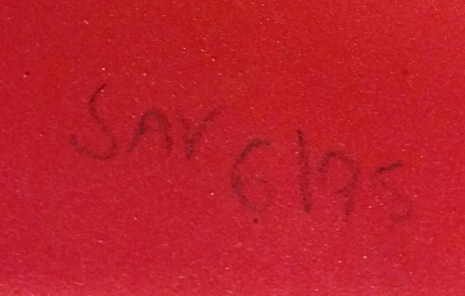

  9. One day in June, 1995, someone named Sav walked into work and painted my 916 fuel tank. I know this because after he or she was done, they engraved their name and the date on the bottom of the tank.
    It's these small, personal touches that I'm finding really cool with this machine.
    Anyway, back into it this morning. Got the correct size bolts for the fuel plate (M6 x 20), and slowly tightened each bolt sequentially. Glad I bought the grease. Definitely helped the all important O-ring to seal properly.

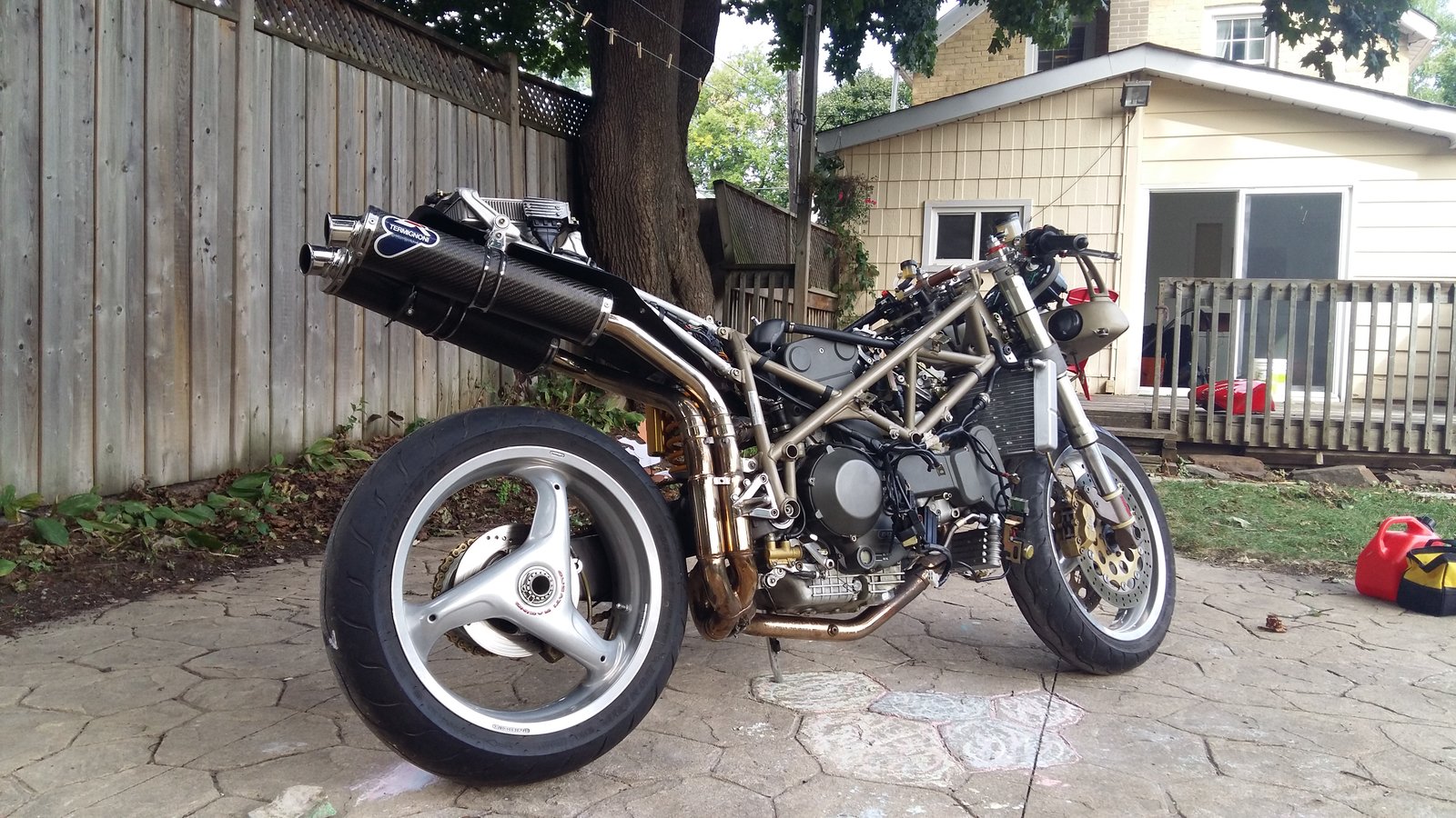

    Pulled the bike out of the shed and took this shot as it hopefully won't be this stripped down again until winter.

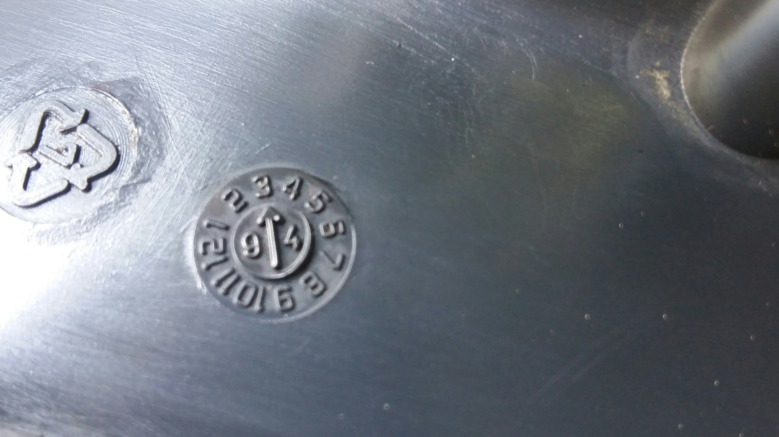

    Installed the airbox and then the intake runners. They're the earliest produced items I've found on the bike so far- March of '94.

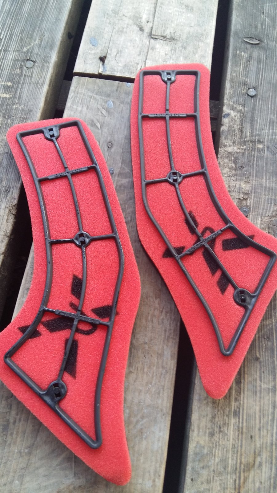

    Went with the Pipercross MPX038 for the new filters. Cleaned and re-used the original frames.

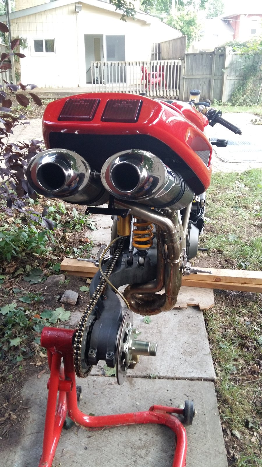

    The rear end looked superb with the wheel off... that pipework!

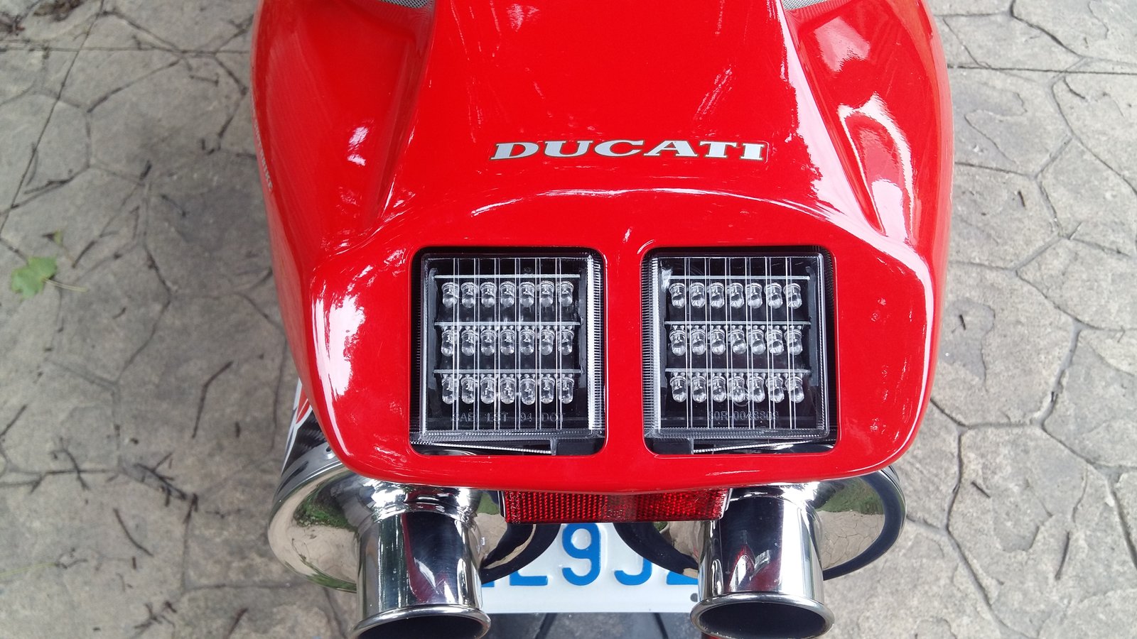

    One other issue popped up - brake lights too dull. The bike had integrated lights from evoluzione installed in 2002, but 16 years on, an LED upgrade was necessary. Went with motodynamic's clear unit that included sequential signals and a 3 flash brake light to keep those cagers on their toes...

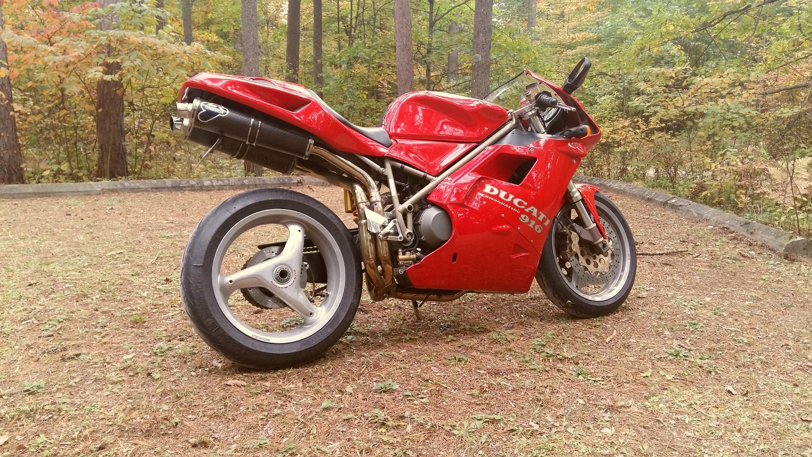

    Getting chilly here in the north, but with Thanksgiving on Monday, still riding every chance I get. Here she is at Petroglyphs Provincial Park today:
