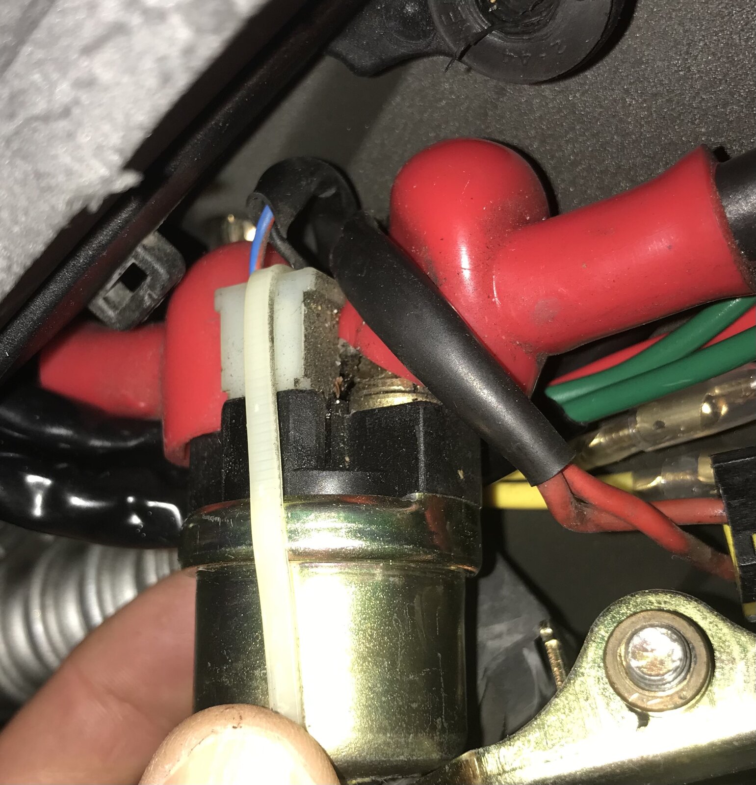

    I personally believe there is no « cheap » way to correctly and durably upgrade your starter cables to bigger gauge and better overall connection and crimping quality. Unless you have the right tools and equipment to do it yourself. The Exact Start kits come for a little over 100 quids, which, in comparison to the price of a 916, doesn’t seem much for such a great upgrade.
    Here are pics of the starter boot (upgraded boot from upgraded starter cables kit ;)): 4F9F02DE-A718-44FF-B7CC-667D9620464F.jpeg
    …and starter solenoid dodgy connector zip secured:
