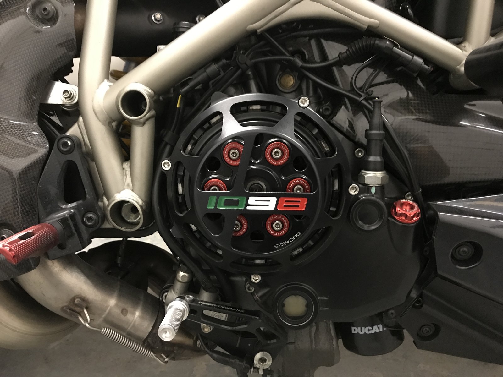

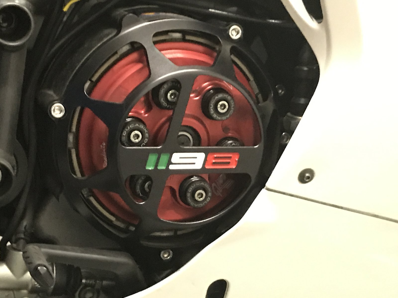

  2. You've picked a worthwhile bike. Just looked at the pics you supplied on your link, dont think much of the carbon clutch cover.
    I got these for my Streetfighter and 1198
  3. Me too... :p
    Yes, the carbon one is a bit of a mess - like most of the bike at the moment. I'll see if I can find something better... :)

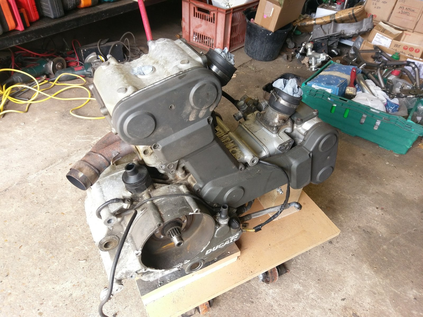

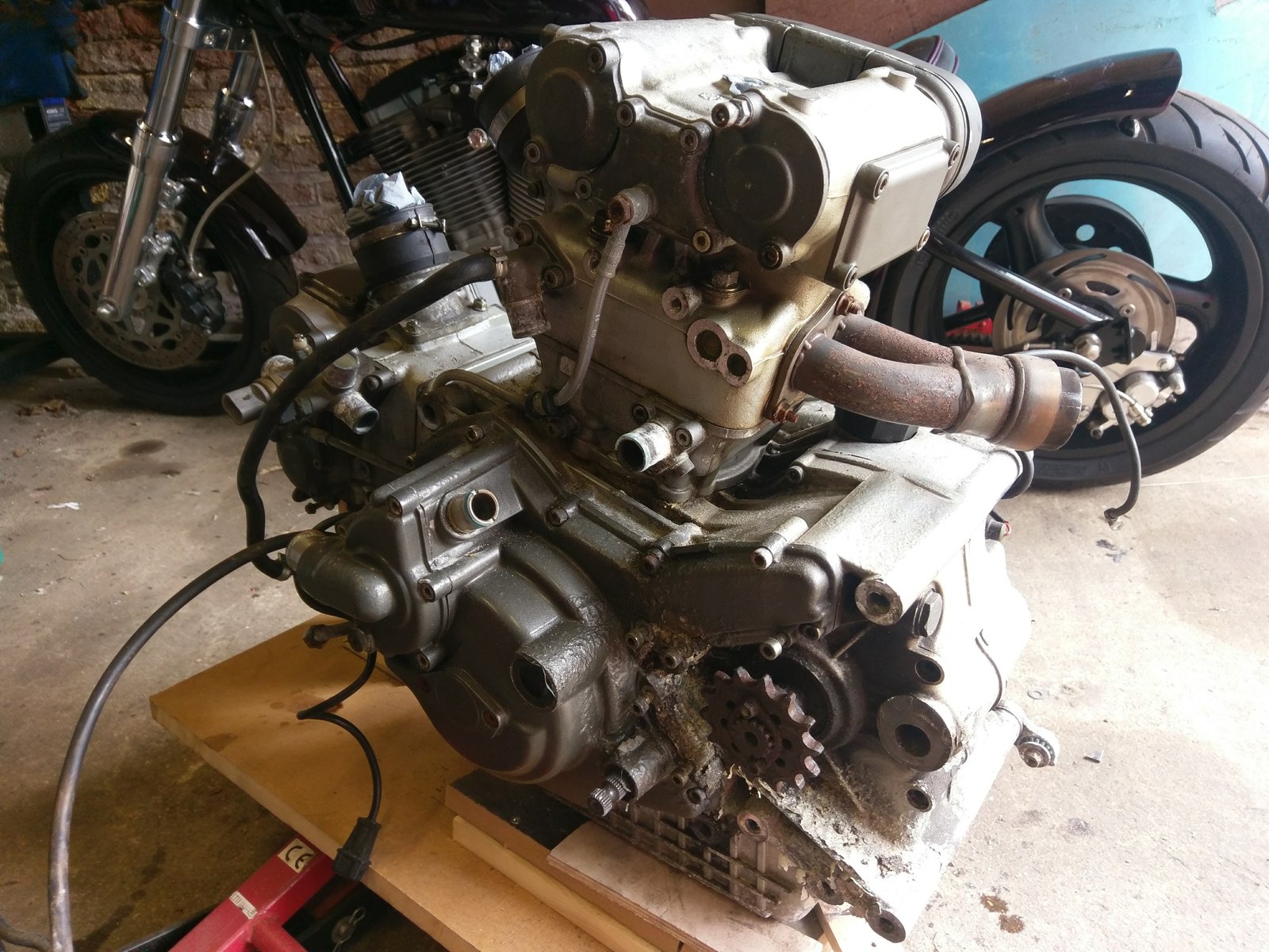

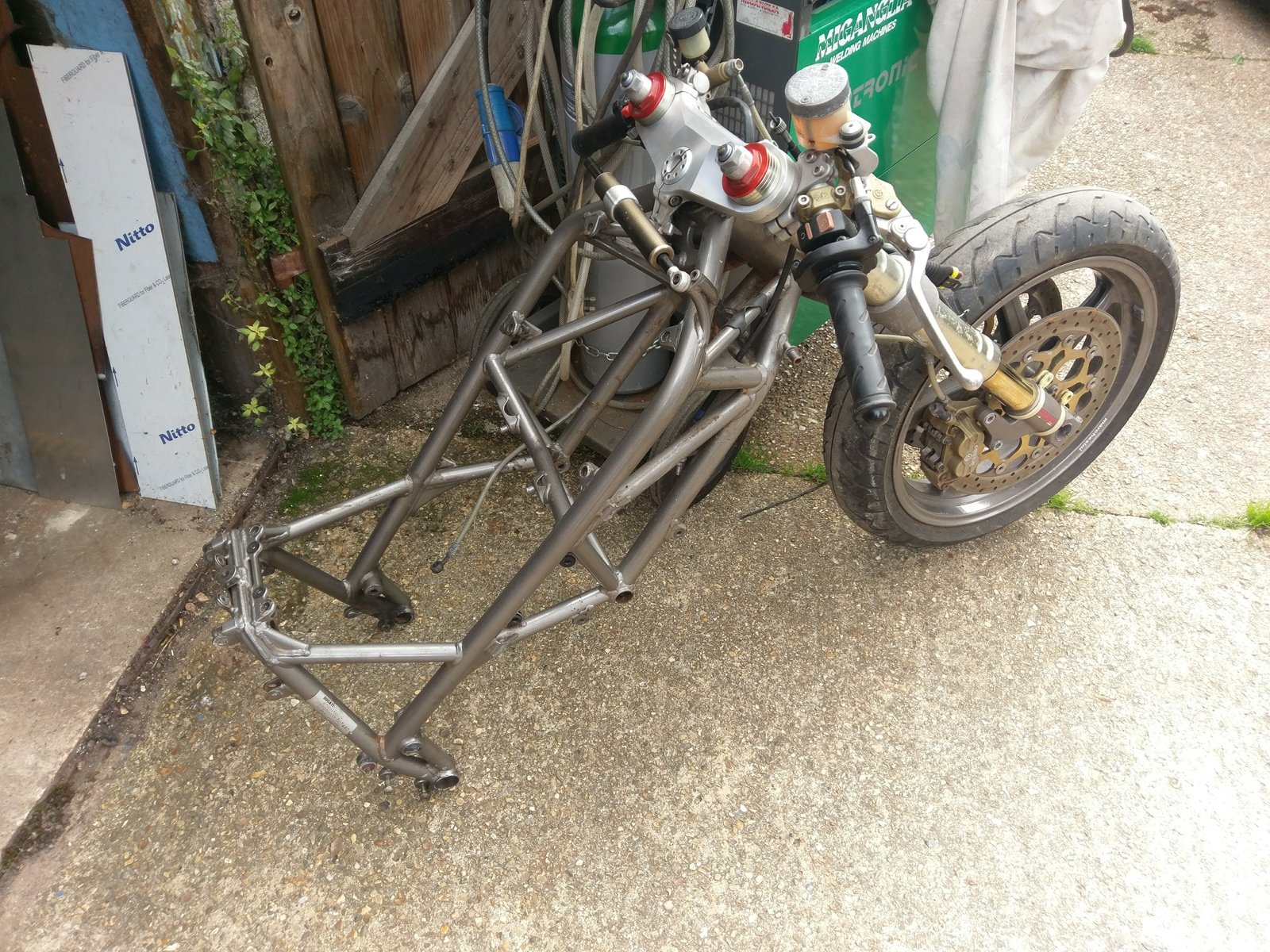

  13. I've been a bit slow on this for a number of reasons. However the engine has now parted ways with the frame. I've since removed the forks and yokes, and just have the last few bits to remove from the frame and wheels before I drop them off for blasting.
    In the end I had all of the necessary colours matched at my local paint place as I couldn't find the correct codes.
    While the bits are being blasted I'll get the engine cleaned up and painted.

  14. My problem with carbon clutch covers is that one spill on rhs risks damage to clutch. My 916 fell over on rhs and the DP carbon cover wasnt good enough to prevent damage to my outer basket. Ever since then Ive retained the OEM steel clutch covers or a decent cnc one.
  15. Yep, that's why the carbon one is going in the bin and a CNC one going on in it's place :)
  16. How difficult was it to get the rear swing arm pivot pin out?
  17. What plans have you got for the engine? Clean up and rattle cans or a full strip down and repaint of the heads/cases etc? I've not found a paint yet that can overcome the inevitable corrosion unless you can properly etch the aluminium surface first after stripping off all the old crappy OEM paint on the crankcases. It's a lot more work but lasts much longer. Stripped down the wife's Monster 620 engine and the only way to really clean it up was to media blast it. If you can have some blanking plates made up and remove the barrels and heads, I have known people to do this, without risking any particles entering the engine but the prep work is quite a lengthy process if you are not splitting the engine. Chances are if it has been standing that long some of the oil seals may also have hardened, so it's 50 of one and half a dozen of the the other as to which is the best route to take. Good luck with the rest of the build.
  18. Even after soaking for days in penetrating fluid it took a lot of effort, a 2lb hammer and a custom made drift... just as well I have a lathe....
  19. I spray a lot of stuff - but I'm not going to strip the engine, it only has 4,600 miles on it and it seems pointless to tear it down and rebuild it at this stage. But time will tell. It's been stood a long time, but it has been running recently and regularly when in storage (or so I'm lead to believe)
    I'll be stripping all of the factory paint off, spraying with 2k epoxy primer before base and clear coating in 2k. It won't be a short or easy process, but it should do the job.
