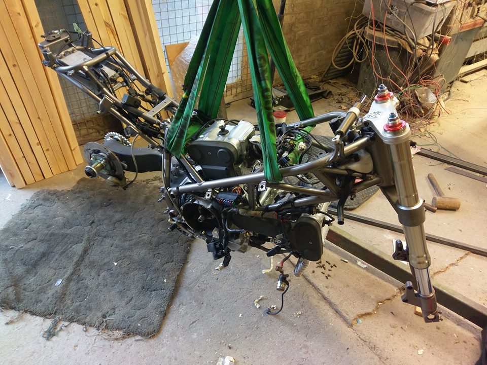

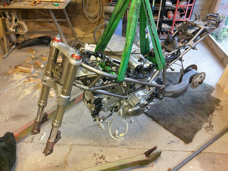

  3. I realise I've been quite lax in keeping this up to date!

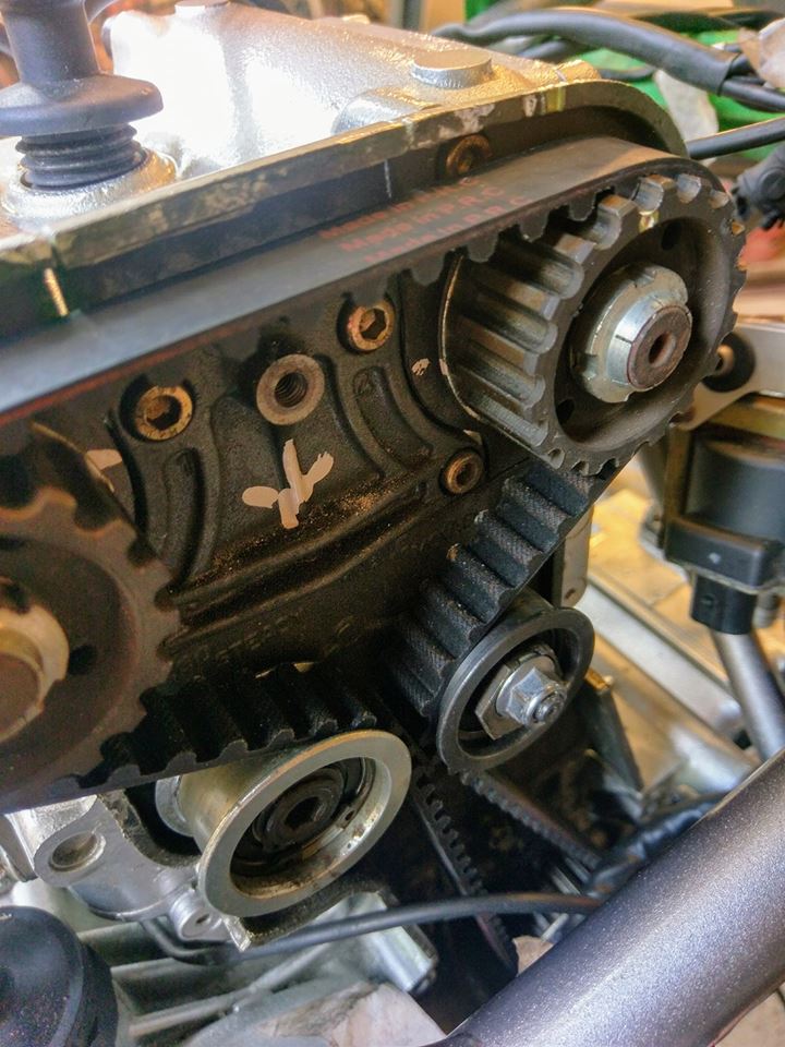

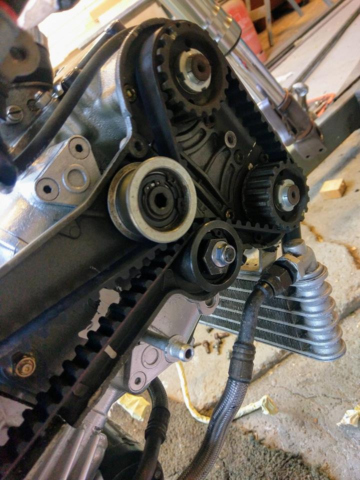

    The strip down went well and most of the parts went off to the blasters and were re-sprayed. Engine cleaned up and sprayed too. Just have the clutch and alternator/waterpump covers to paint, which I will do when the bike is back on it's wheels - number of reasons for doing that!
    Anyway, it's going back together quite nicely. Still cleaning bits up as I go, and a lot of new parts going on too including new timing belts, chain and sprockets, braided hoses, silicone coolant hoses, new fluids, plugs, filters. Tyres are going on the rims this week and then it will be back on it's wheels again.

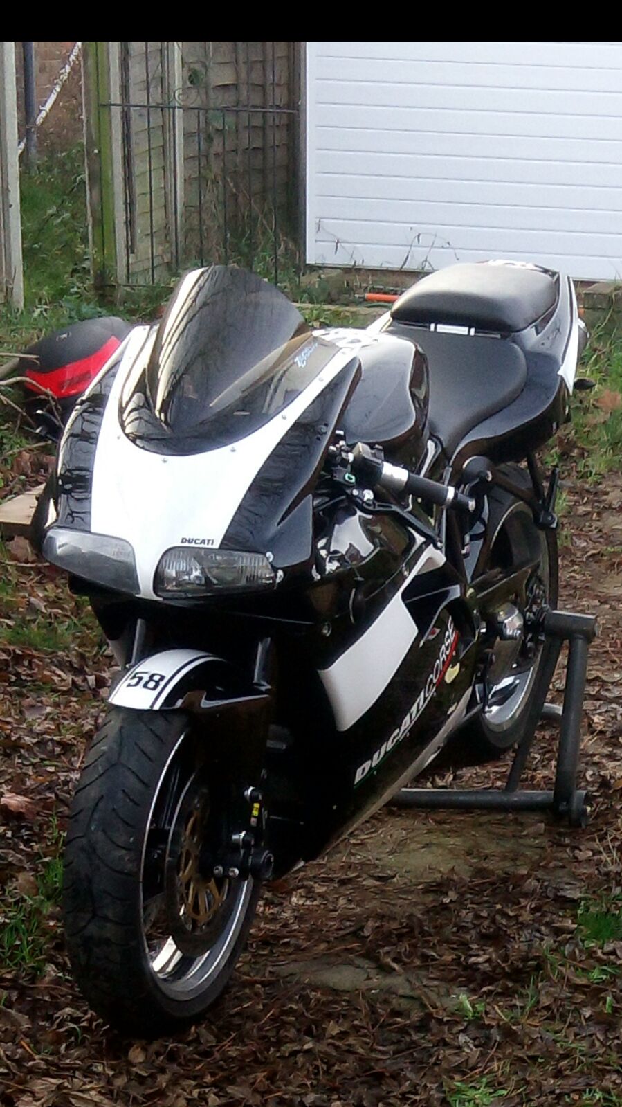

  8. a pic of mine after it's rebuild...
    just cos I love posting pics of my bike! Tbh this was after a lil off last year but still a good pic!
  9. Op where did you buy those belts from? great job on the rebuild!
  10. Thanks
    They are California Cycle Works ones, there's several UK sellers of them. Also changed the bearings in the tensioner and idler pulleys while I was in there :)
  11. Surprised that they seem to be made in china? you changed the bearings only and not the complete assemblies?
  12. Yes, apparently so. But then so are most of the Gates belts these days...
    And yes, I just changed the bearings. New SKF ones.
