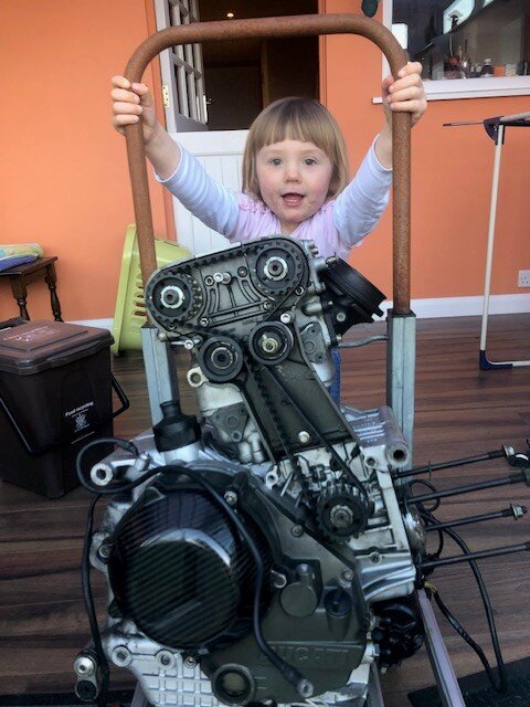

  8. So, the engine is out and now sitting on the bench with the head at BBS Motorcycles on the recommendation of Andy @final_edition
    It's being pulled apart to assess the damage this week, then come the prices!
    I had a bit of a flap last week and on the verge of splitting it/selling as a broken bike, but saw sense and thought what it will be like when it's all back in one piece. The whole bike going wrong actually done me a favour, as i've found a number of worn parts that are now on order and being replaced.

  11. She loves helping out with it and loves the bike itself. I'm sure she'll be after the bike one day :)
    Thanks John! I'm hoping I won't have to take TOO much of a hit, but we will see.

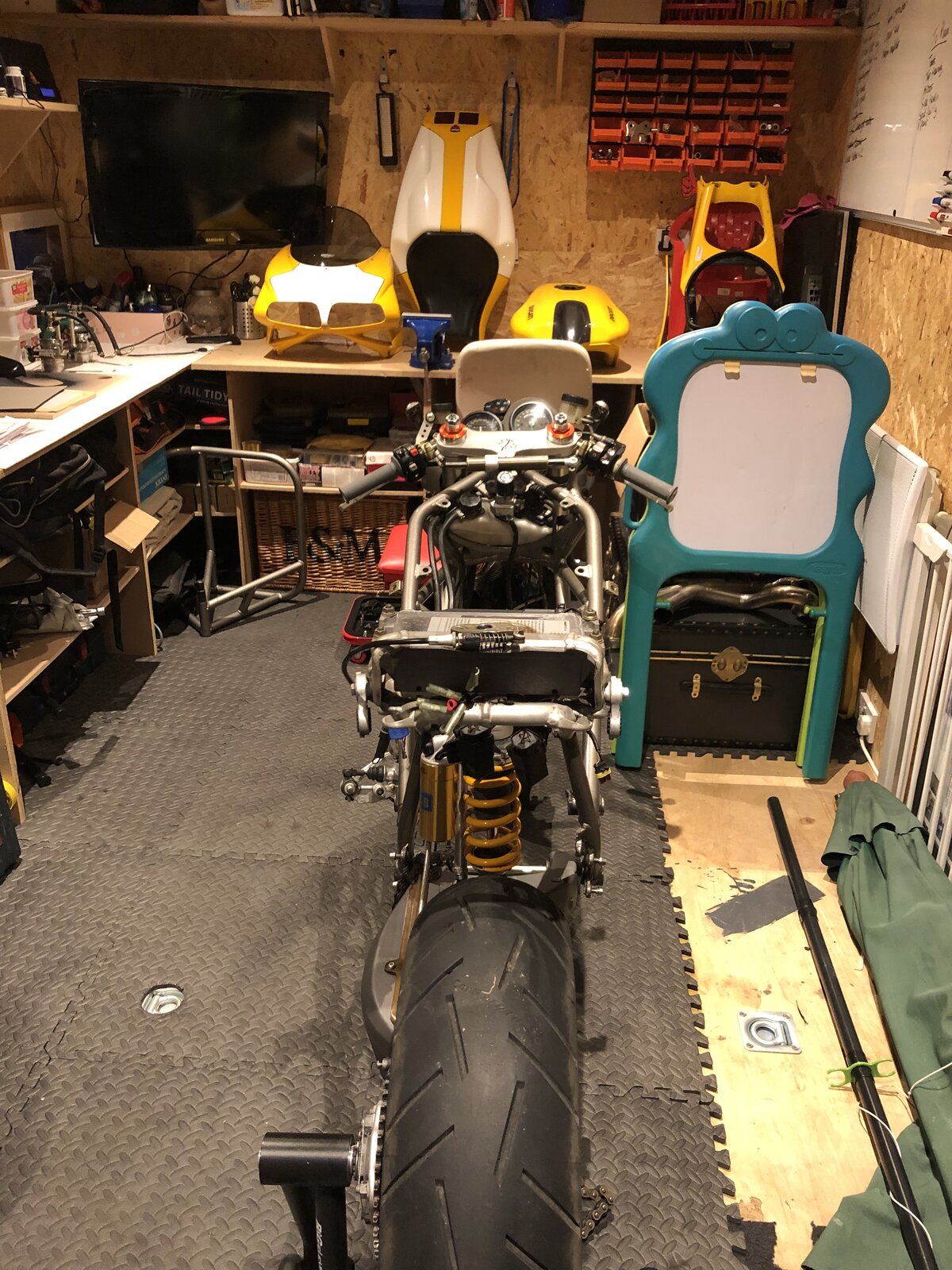

  13. So, the engine is away and the head (apart from the 2 chipped valves) have been given a full clean bill of health. After having more of a look, Mike at BBS had some queries about what looks like the rods may have some stress marks, but I’m waiting on the outcome on them at the moment.

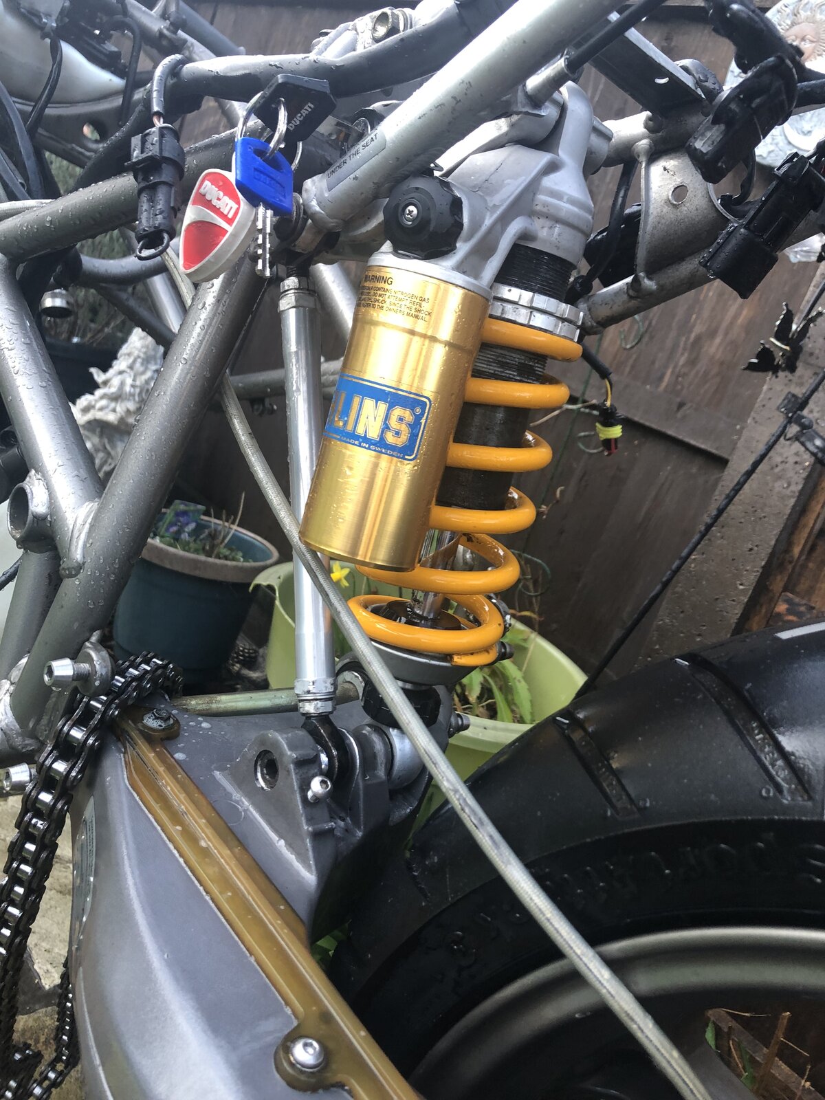

    With the bike being apart and having a few spare evenings, I’ve gone to town on the cleaning and refreshing of parts and fixings, so it will be a lot healthier when an engine is back in!

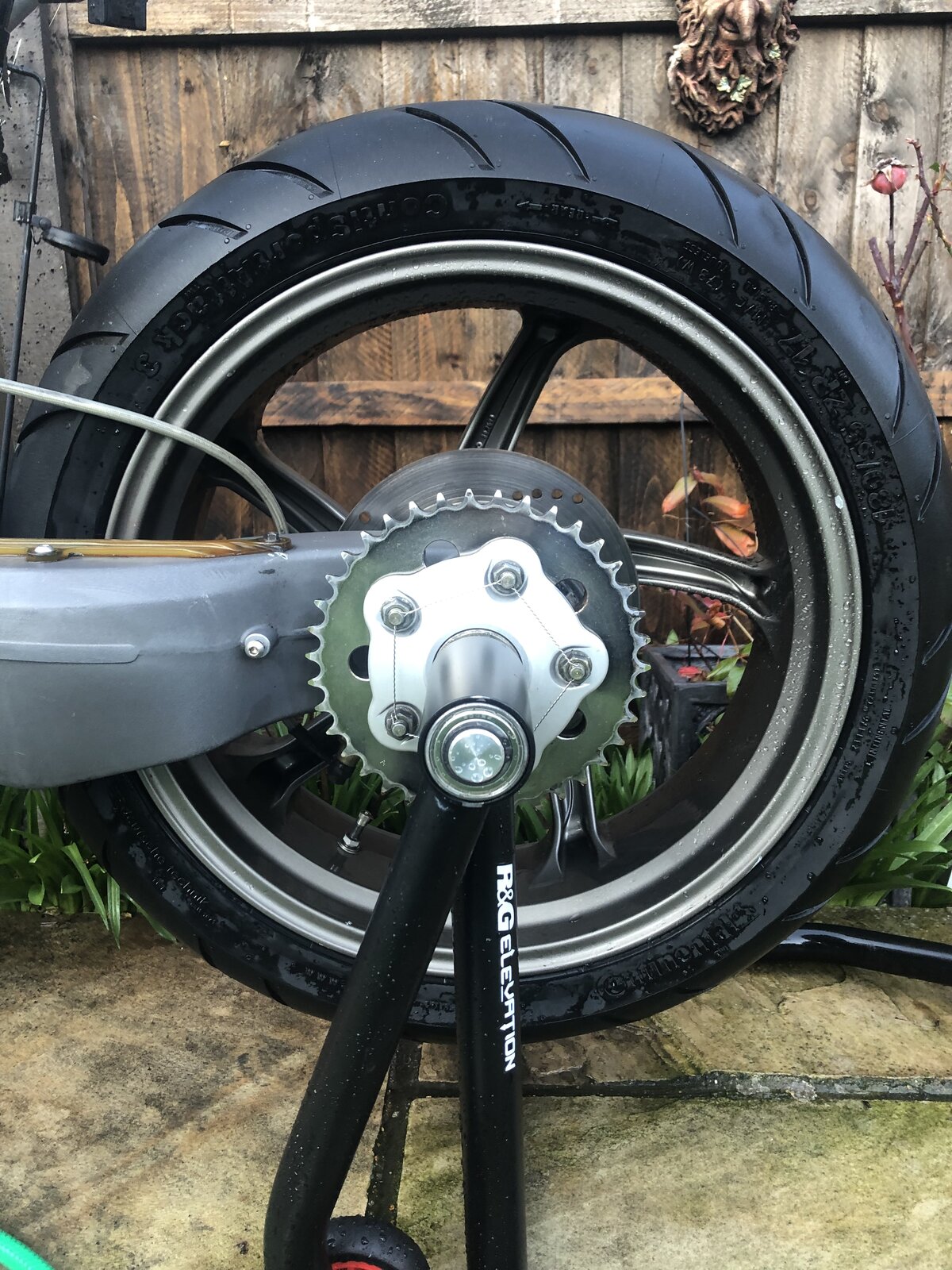

    19 years of muck and crap have definitely taken their toll. Found that the front sprocket was knackered, so a new one is waiting on the bench to be fitted.
    I also managed to get a set of belt covers to replace the ones demolished by the tensioner pulley. Guessing they’re early ones as they’ve got the Cagiva stamps inside.

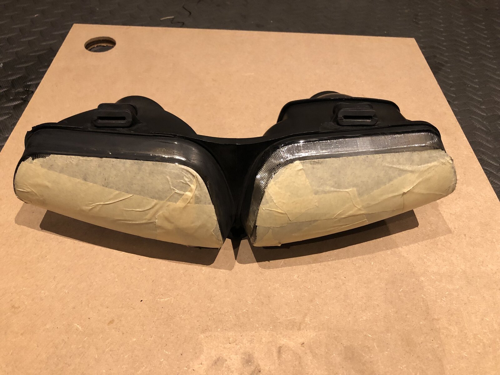

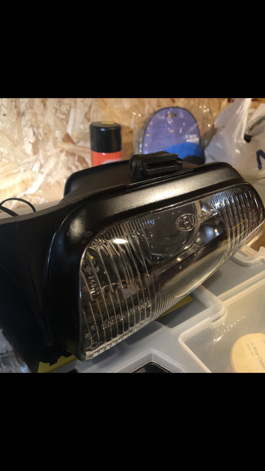

    Stripped the headlights down and cleaned the insides, what a difference! Also redone the satin black border whilst they’re apart.
    Anyway, some random pics of it’s current state
