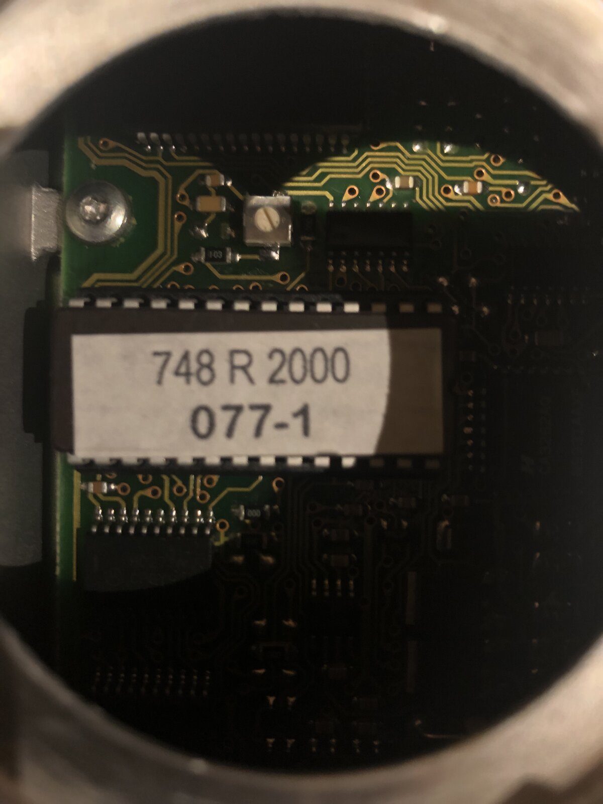

  8. So, just getting in to more cleaning on the bike and took the ECU off, turned it over and the label on the bottom says ‘DUCATI 916 BIPOSTO EU’. Considering it’s a 748R, is this unusual to be using a 916 ECU? Any reasons for it being used over the ‘R’ ECU?
  9. The 1.6M ‘ECU’ was used across a number of models. The EPROM inside the 1.6M ECU is what makes it unique to the 748R. Andy
  10. Aha! Makes sense! Cheers Andy (again)
  11. Could’ve answered my own question if I’d have looked :p
  12. We all have to start somewhere :upyeah: Andy
