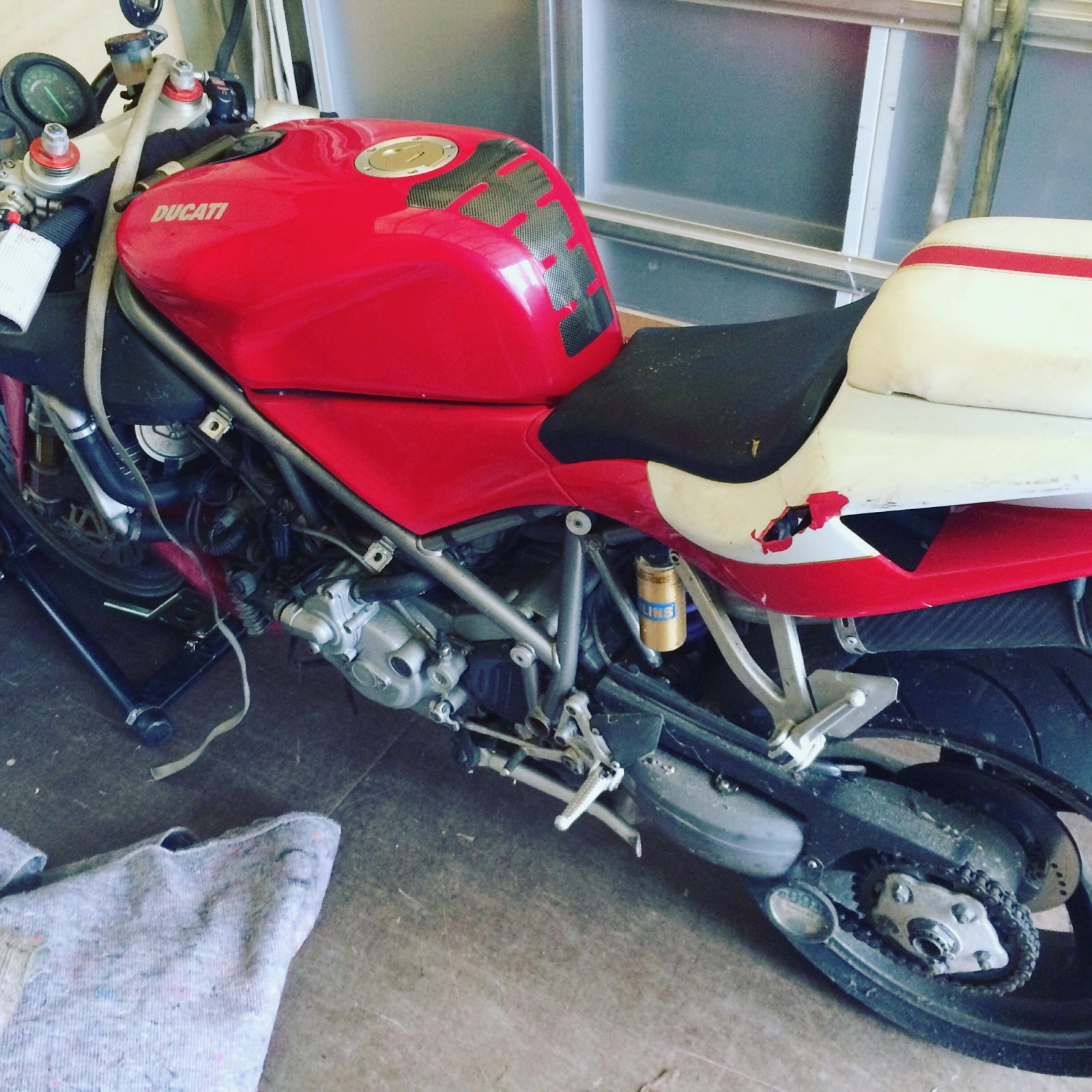

    My 996S suffered (by my hand I hate to say) from years of neglect. It sat outside quietly corroding through 4 UK winters. In 2016 I thought she deserved better and decided to give her a clean. That's when it happened.
    A wash and polish has turned into a full strip down of the bike and engine. What was a few hours work is now entering year 2.
    First picture is of what she looked like pre-neglect. 2nd picture is after a hit and run and then 4 years of sitting outside under cover completely unloved.

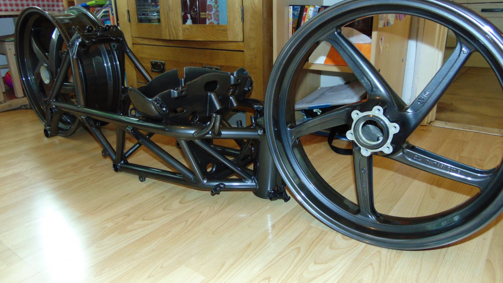

  2. Frame and wheels powder coated
  3. nice colour is that gun metal grey??

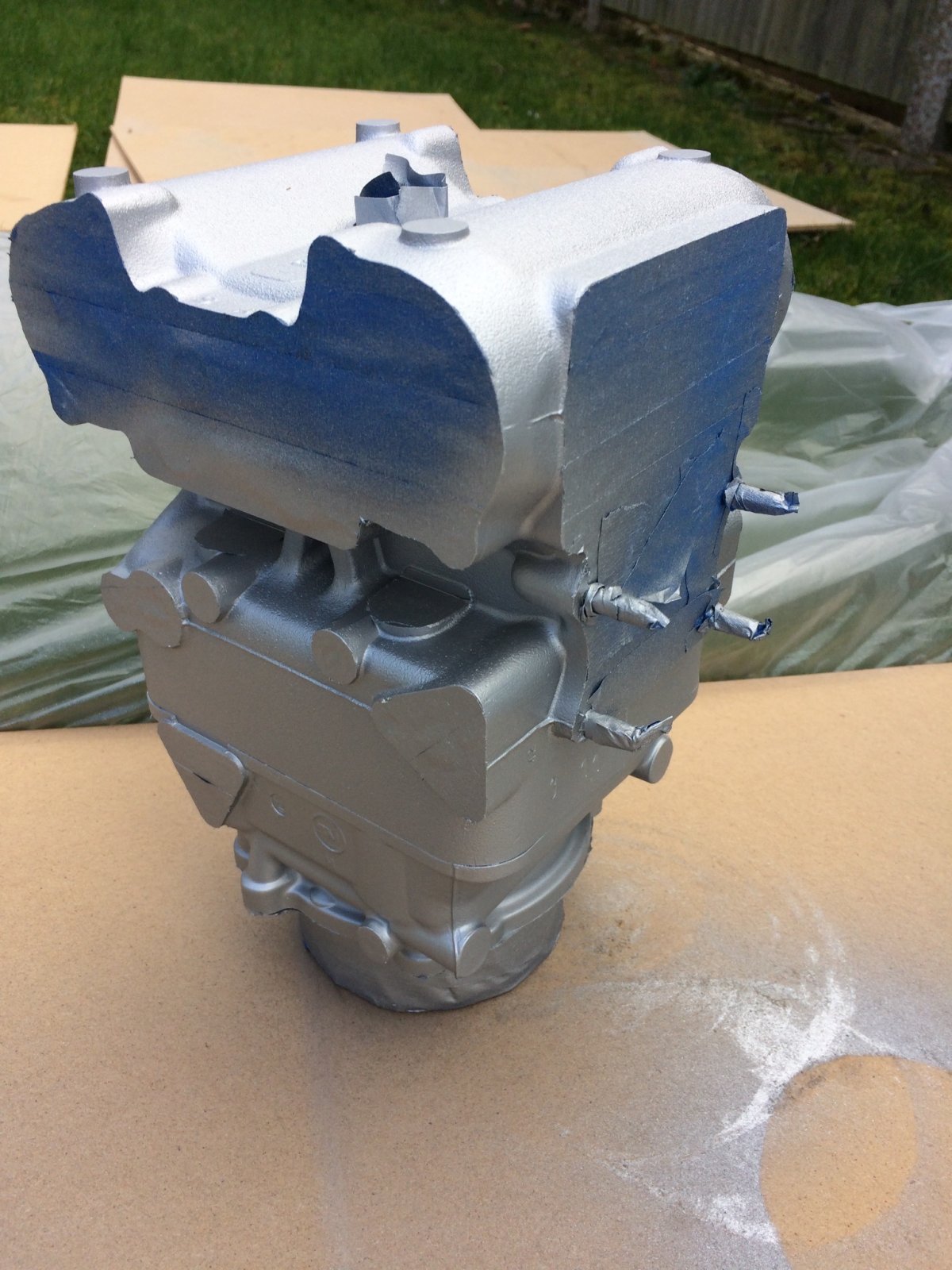

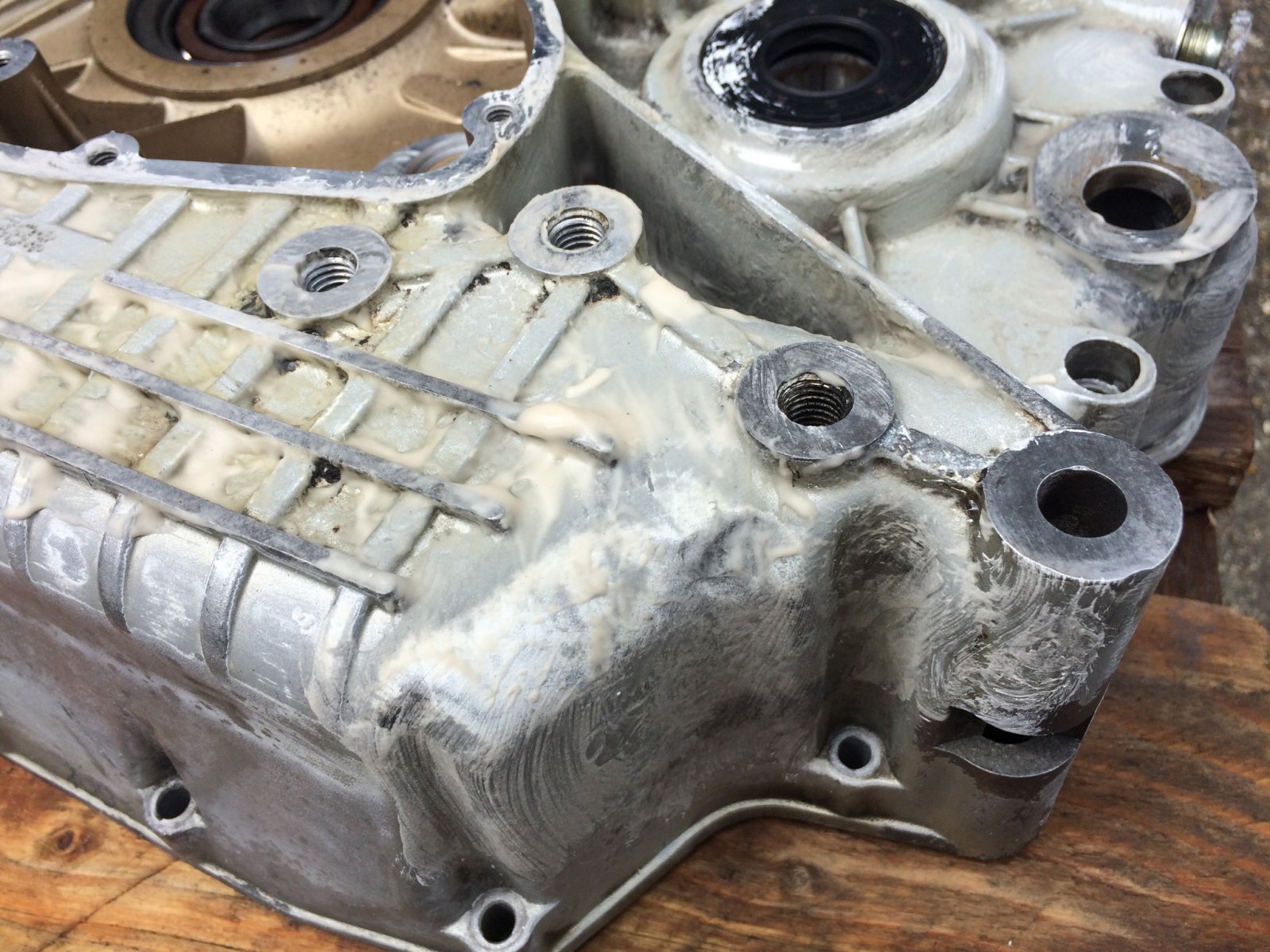

  4. Engine was in a state. Now in the process of stripping and painting.
  5. Work was done by Steve Turner (TPCS Magnesium and Alloy Refurbishing and he calls that colour metallic grey. I wanted to stay factory, but quite happy with this result.
  6. yeah ive had work done by them before nice colour that mate looking forward to seeing it back together.

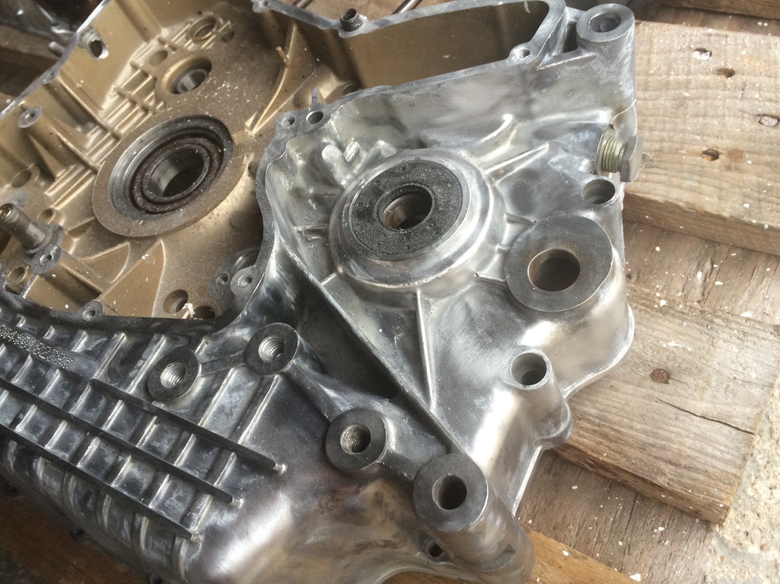

  7. Painted the engine casings, heads and various bolt on parts today. Used Por 15 engine enamel in Aluminium. Oh and about 80 hours of wire bushing, paint stripping, masking and prepping the metal for paint. IMG_0123.jpg IMG_0124.jpg IMG_0127.jpg IMG_0128.jpg

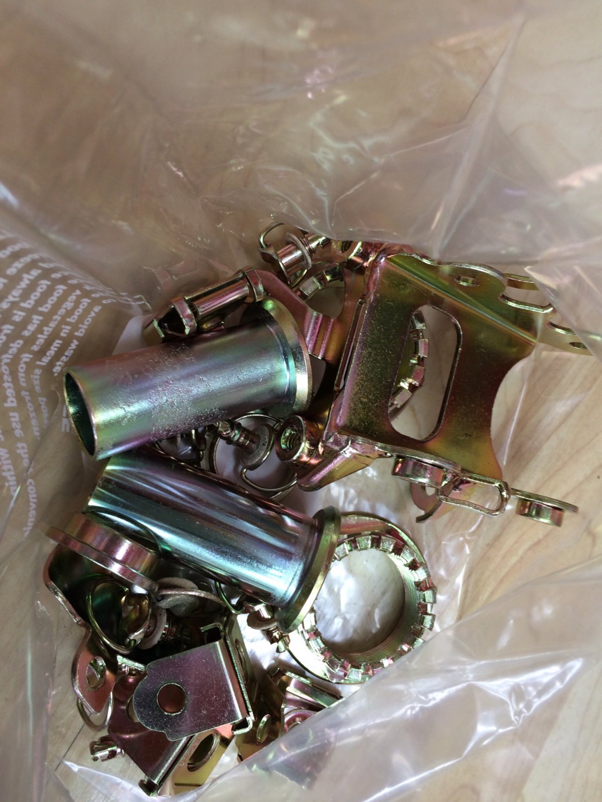

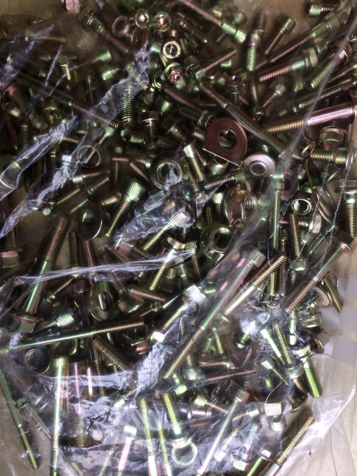

    1. Had all bolts and fixings refreshed.
