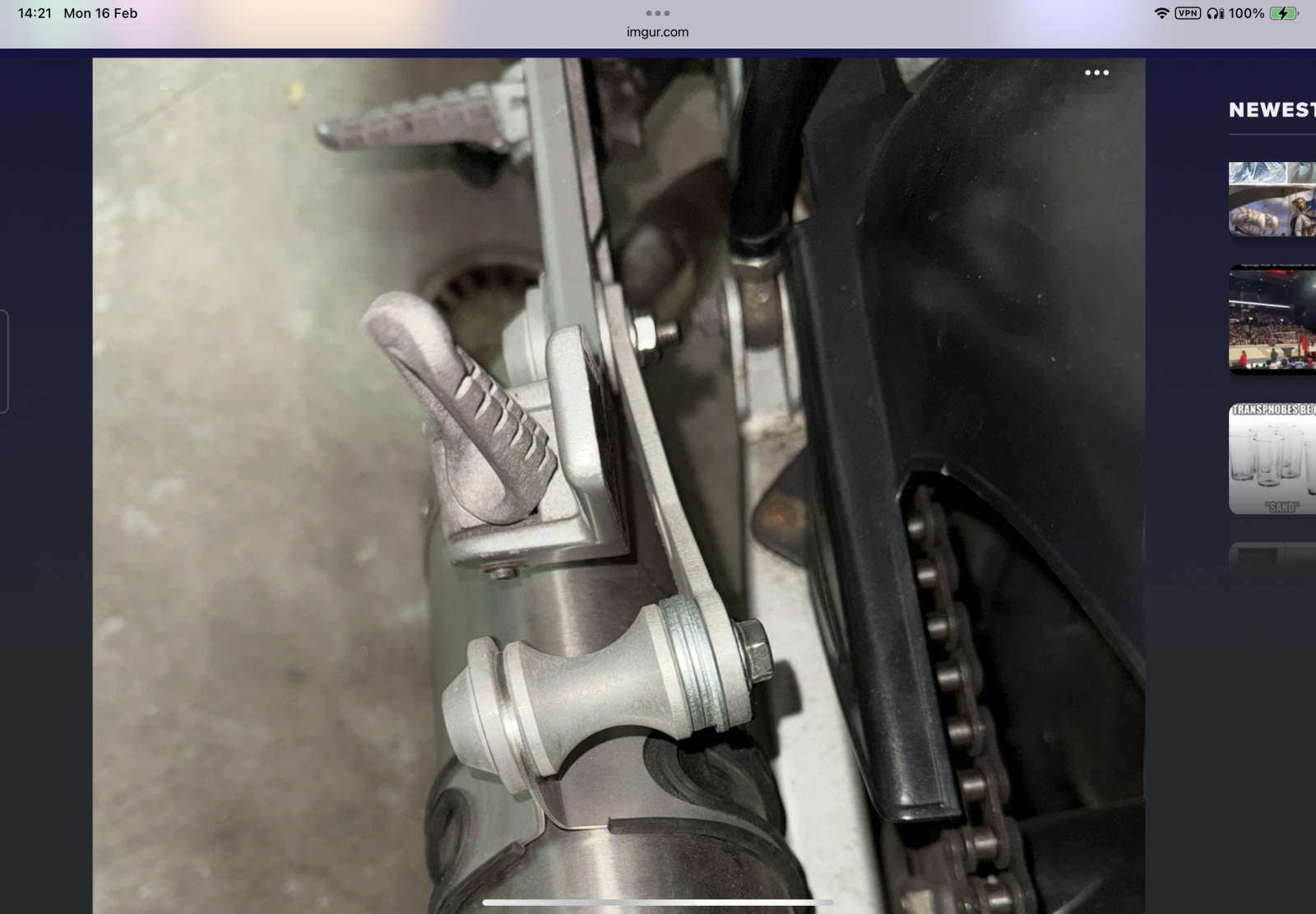

    I have a 750 Dark and installed MIVV exhaust with the factory header pipes.
    Problem I am having is getting the units to point in a normal direction. If you look at the photos you can see each points inward. I have had to put shim washers to try to get the mufflers to point outward and align with swing arms. Mufflers have and will strike axle nuts because of this inward alignment.

    It appears to me if the head pipe sliced into to allow a spread to align the mufflers and remove the spacers , maybe the adjusted position and spread could be welded up.
    Has anyone run up against a situation like this and possible advise on what type of tradesman could handle this?

  3. IMG_4195.png Brackets look bent to me.
  4. They are not brand new.. a couple years now..
  5. Brackets are bent ignorer to push in to not much avail

  7. That's helps a lot - i'm guessing that it is a "pipework" problem (as O.P. suggested) looking at picture, and so when you tighten the tube clamps (header to muffler) it overpowers the thin aluminium trailing arms that are waaay out on a limb anyway.
  8. Looking at picture of L/H silencer, if you swivel this "clockwise" it ought to bring silencer parallel with bike centreline but possibly fouls somewhere* or brkt doesn't reach without tweaking*? Ditto for R/H except swivel would be anti-clockwise.
    You've obviously tried this - what happens?*
  9. I tried everything.. remember I have those washers on the bracket and there is enough pressure that it is bending the brackets
  10. Sorry to labour the point. but what happens when you swivel Left Hand Silencer clockwise until it is no longer pointing inward? - if this means you have to come up with different brackets then it might be a solution. If it fouls something else then obviously not a solution.
    Only other option is to modify output pipes from the cruxiform/"header" assy using heat. They are a low-grade stainless steel so not straightforward.
