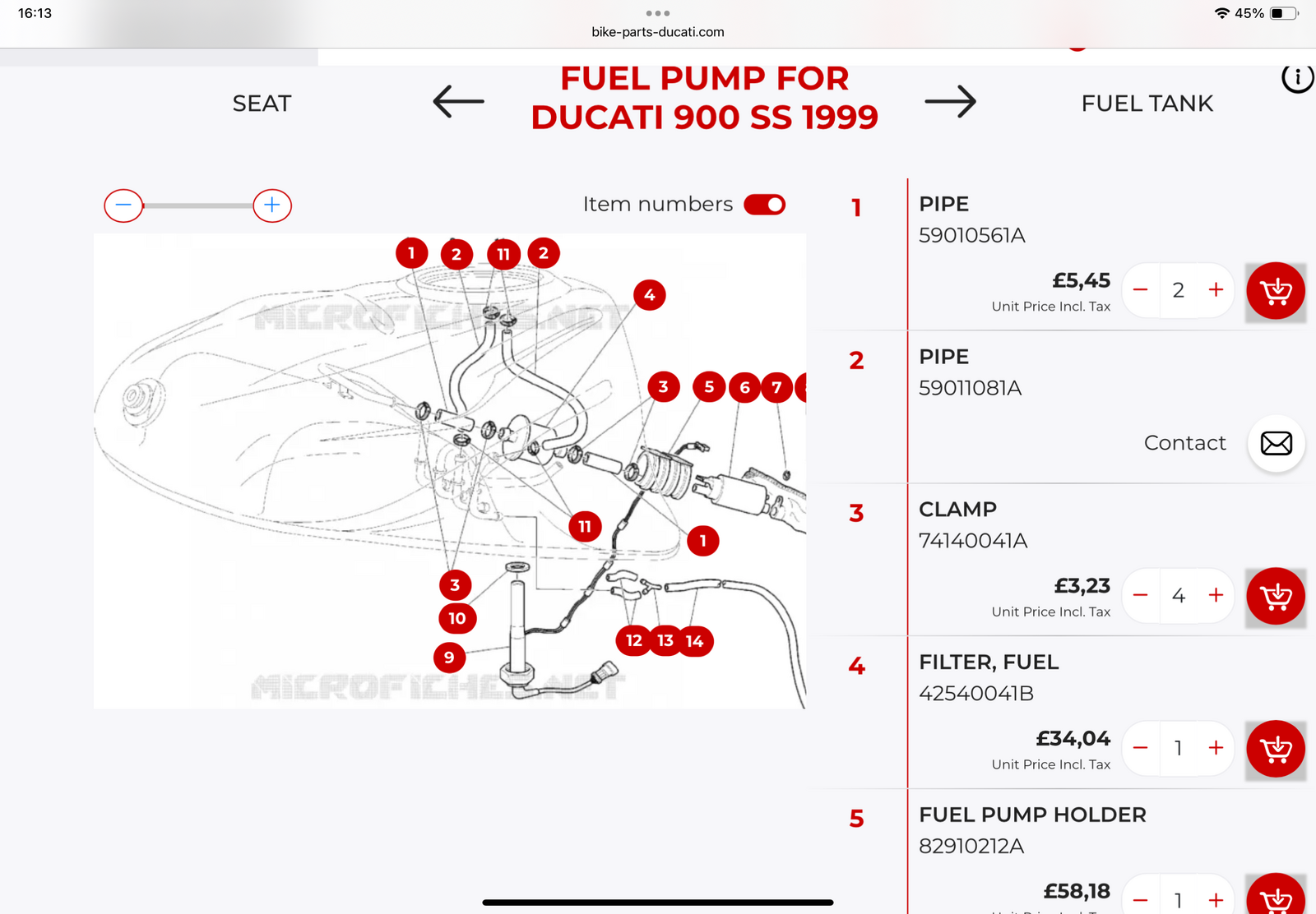

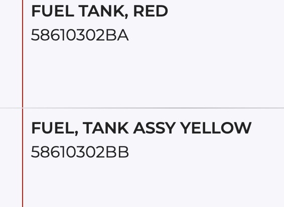

  7. Part numbers often alter the letters at the end as modified/uprated parts are developed over the lifetime of the production of the part. They can also denote colour in parts such as in primer or painted in whatever colour. If the numbers of the part are the same and the last two letters different then it is very likely going to fit. If you're unsure still, why not google image search each of the part numbers? This is an example........ 2003 100SSie

  8. I have done that my tank ends DA but the tank I’m buying he does not know part number but looks identical also anyone any idea wheee I can find a video how to fit fuel pump etc inside the tank as mine has previously been taken out

    Yes, to the best of my knowledge, any of the SSie tanks from 99 to 07 that look like yours will fit.
    If the tank is “bare” without pump or filler cap, they should have the chance to take decent pictures of the inside, I would try and get as much idea of how good or bad it is before buying as you will probably get stung for postage from NL so unlikely to return it.
  10. Not sure of a video but I would say it is more or less “only one way to fit it” when you have it all in front of you. “Tea bag” strainer at the back of the tank, fuel pump clipped in, cannister filter clipped in, pipe to the feed to the outlet.
    The other two pipes are drains from the filler.

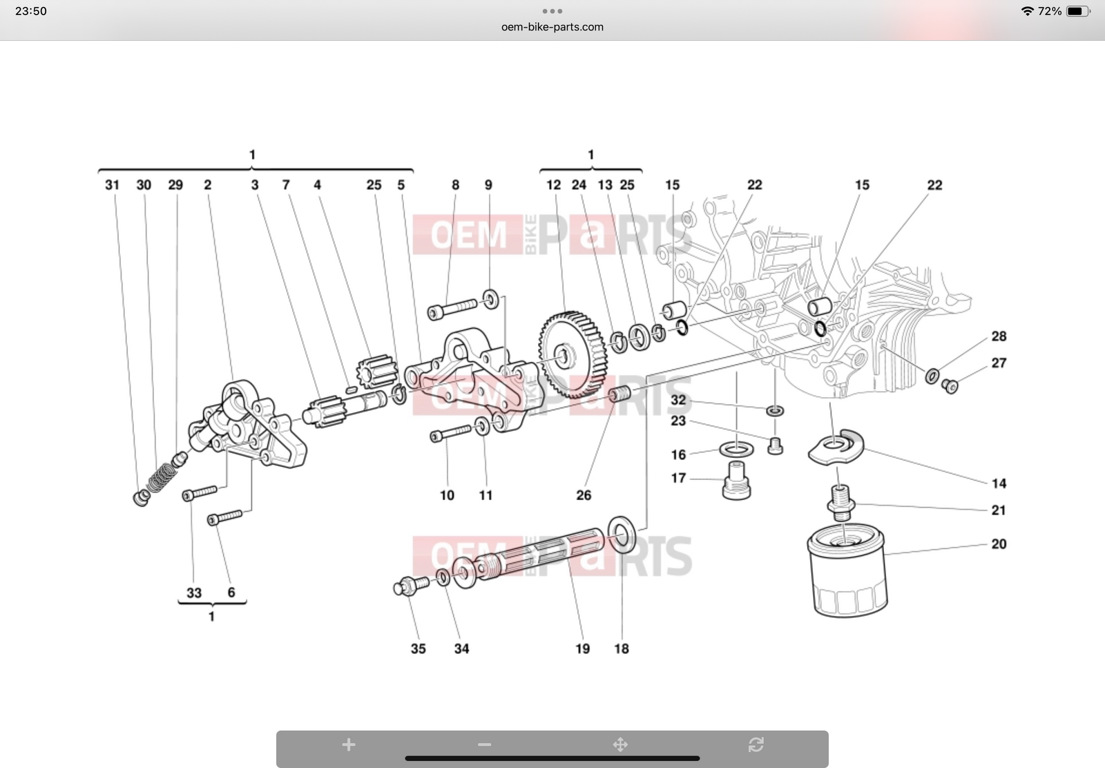

  19. Does the 2001 ss ie have the course filter?
  20. Yes. Item 19
