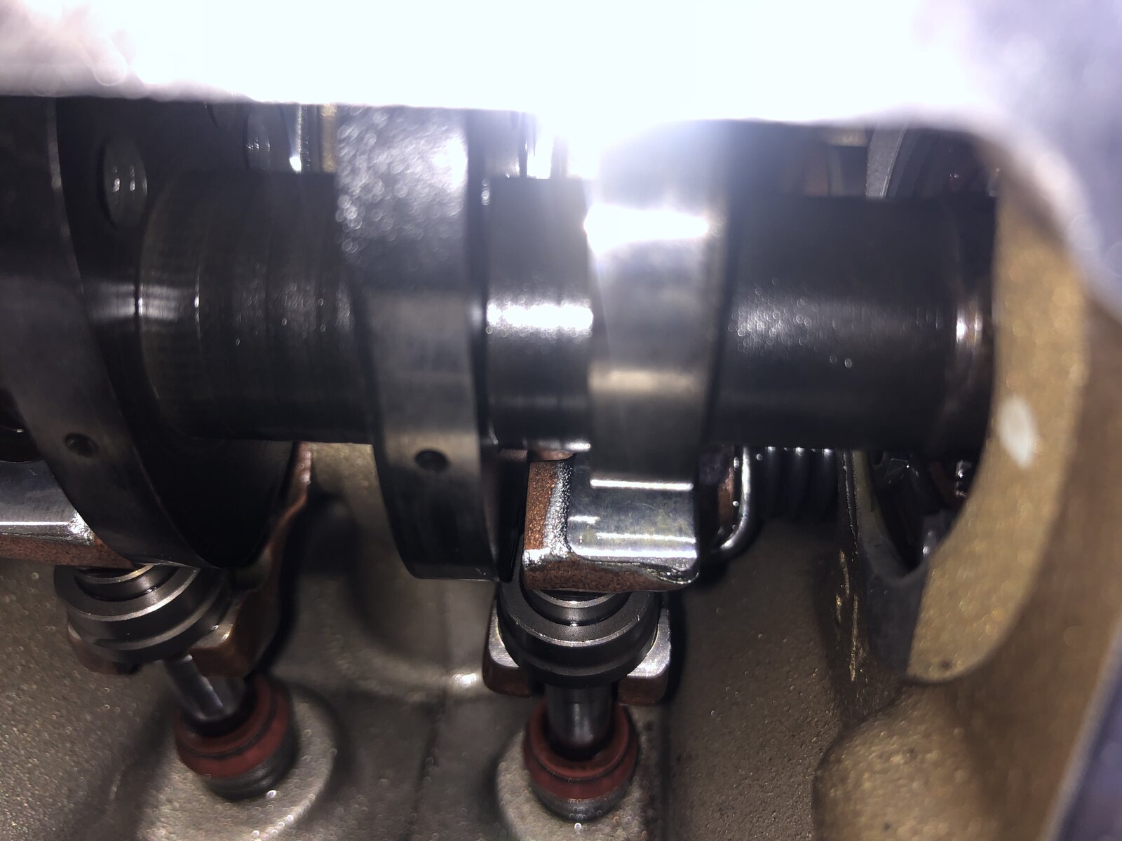

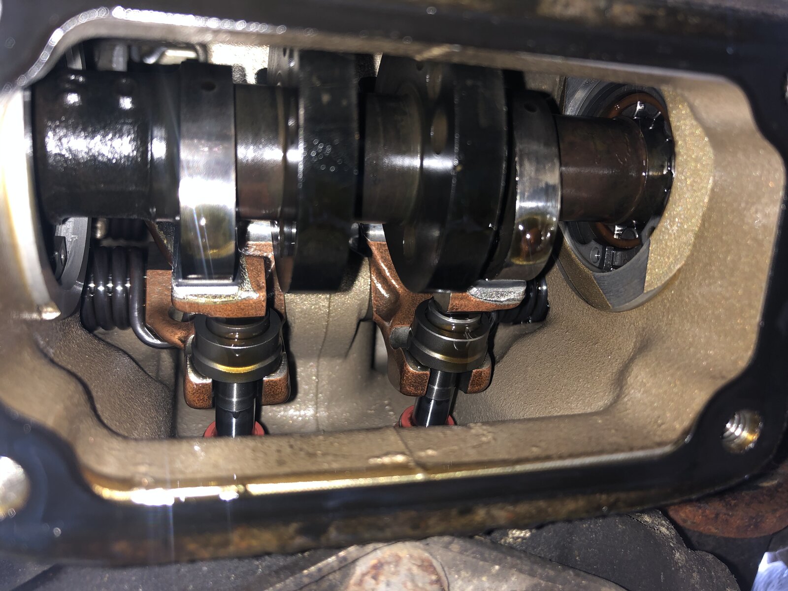

  3. So far I’ve taken both sets of belts off both sets of top pulleys move quite a lot but not rotate all the way around The middle double pulley rocksolid
  4. Also ordered a 30 mm deep socket for the flywheel not
  5. Also is it worth me making a pulley socket to turn them ?
  6. Seems as valves ok.
    Seized up on the crank/pistons
  7. If the cam doesn't fully turn the piston may well be at the top causing the valve to strike, don't force it.

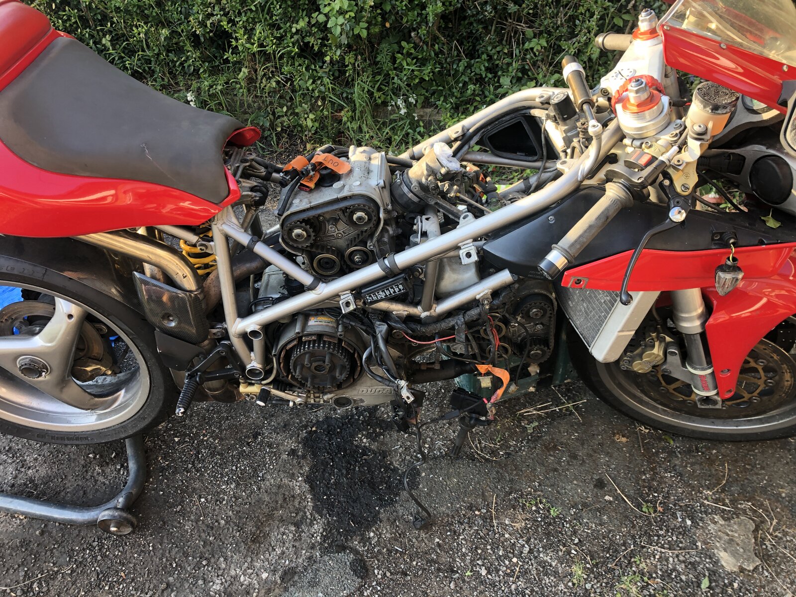

  8. dragged her out the garage today to get some sun and started to get carried away
  9. Thanks for the tip. too Scared to force anything Apart from me on the missus
  10. You've come this far...take the heads off.
    Only 8 nuts..
  11. Yeah I’ll have a go tomorrow Are they hard buggers to get off access isn’t great
  12. Exh and tbodies off
    Rad off
  13. Spray the exh nuts now with plusgas. Will help you tomorrow
