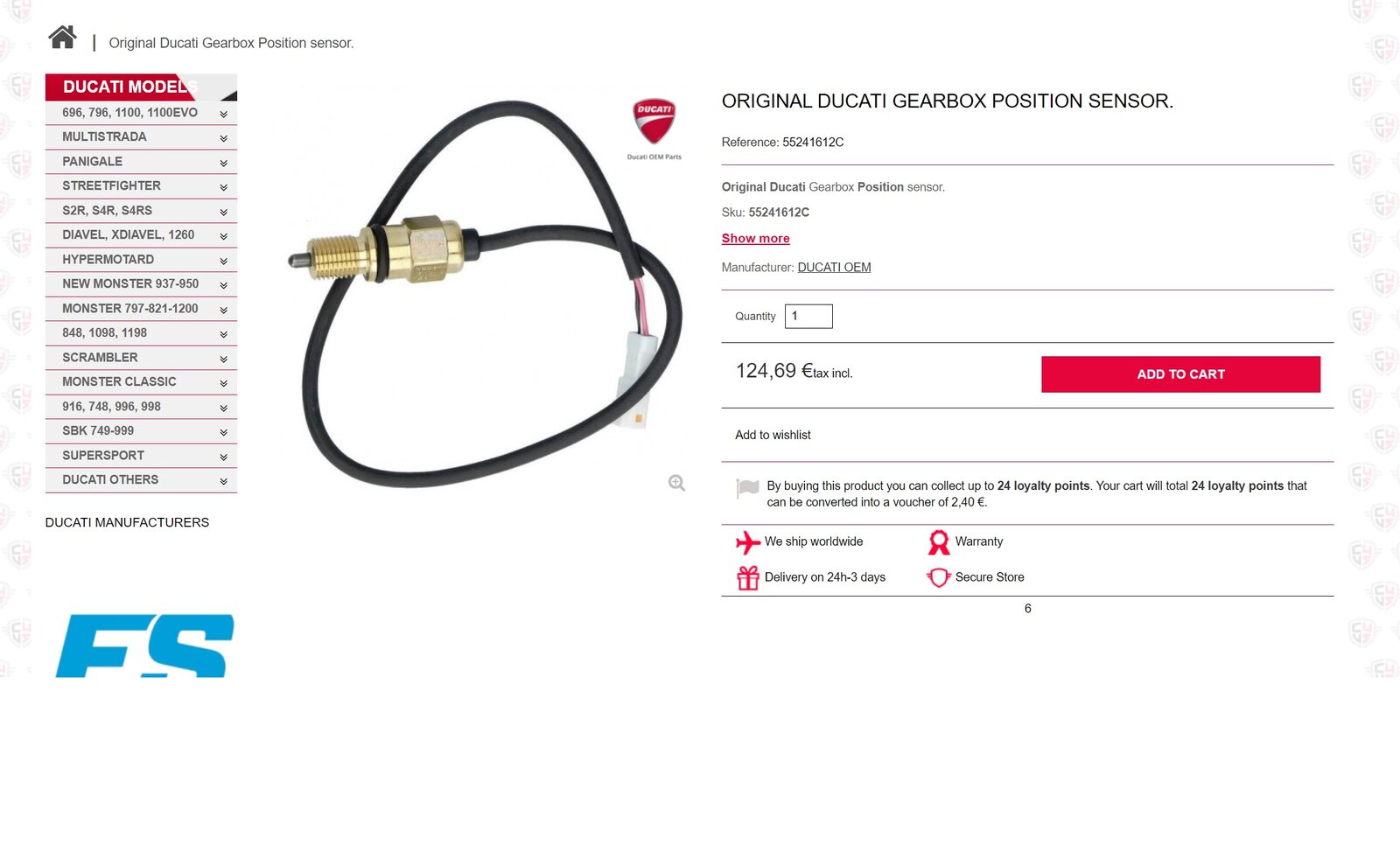

  8. Hi, it's the gear position sensor, there are 3 versions of it, I just changed it now with my mechanic, it's about 140 ish odd, and get the 3rd version, the 1st two are faulty, I had them both, 3rd one is a charm... it was also a recall for that
    hope this helps,
    Paul
  9. Paul - can you tell me the part number?
  10. hi Keith,
    I can but i'm at work now, I can let you know when I get home, I still got the faulty part
    this is how it looks like but if i'm not mistaken when he looked for the part at ducati parts he bought the 3rd latest version
  11. Thanks - that's the same part number as the Hyper one. I'd really appreciate it if you could measure the hex/spanner size so I can start making up a tool to undo it. Going to test it on the bike first to check whether it's just out of 'calibration' or actually faulty as it's going to be a pain to get out. Dealer says they need to plug in to their diagnostics to 'calibrate' a new one but they don't understand or can't explain why, and they don't understand the questions I'm asking about it :rolleyes:
    Slightly cheaper from Ducati Coventry I think - £101.86
    Cheers
