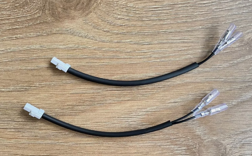

  6. Hi All.

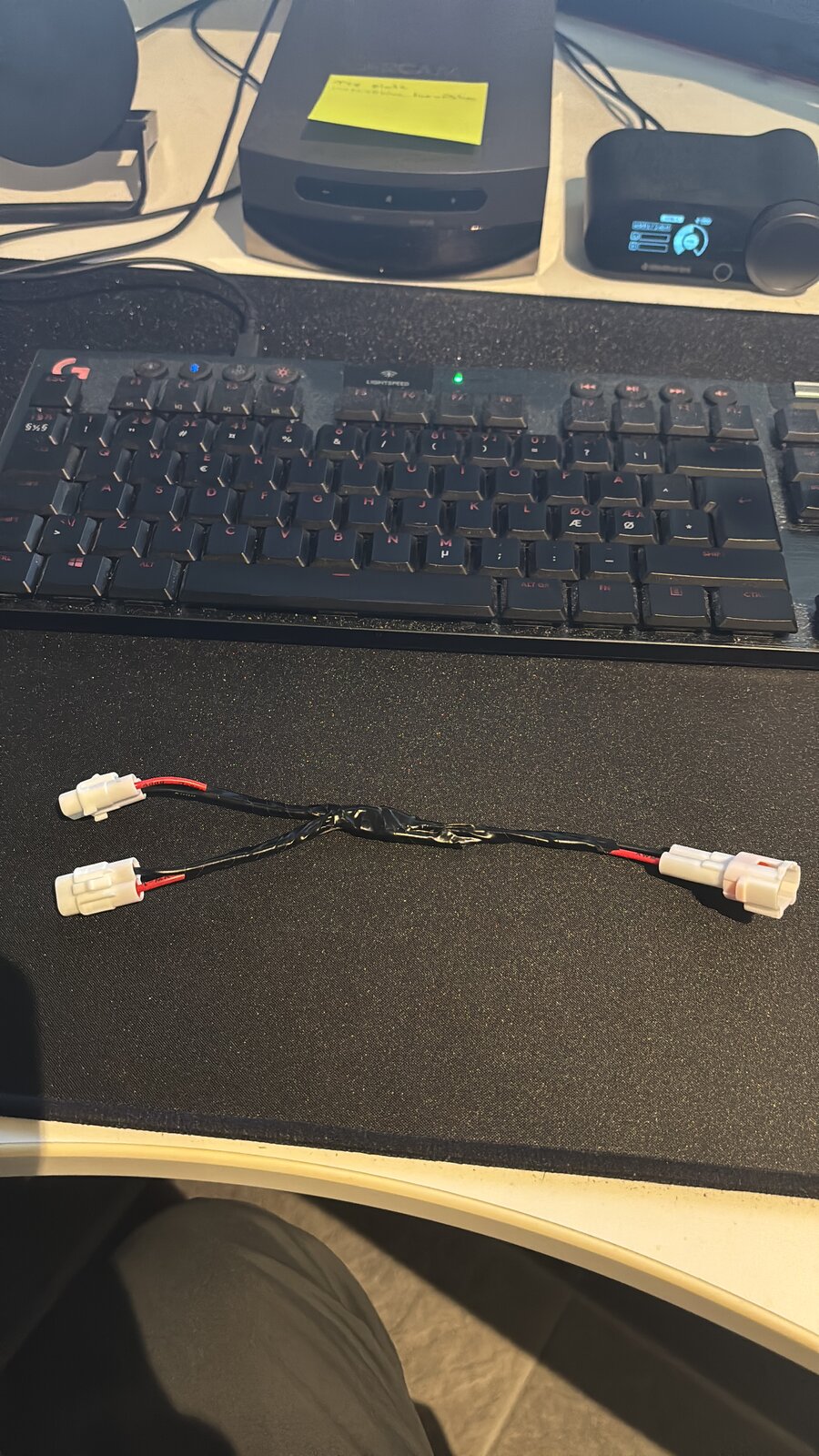

    Came to the same conclusion myself that there is no nav outlet to connect to..
    So Just built an y-cable myself from some scraped parts that had the same connector as the one providing power to the usb and waiting for deliver of usb outlet which should be delivered in a few days. (I wanted a second usb to power phone for quadlock mount)

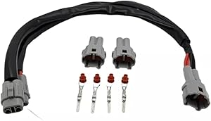

    The solution I used, as I have never used a USB connection on any of my bikes, was to unplug the USB power connector under the left hand side fairing panel and connect my Garmin XT to the power supply lead using one of these plugs purchased from Amazon 2 Pin Waterproof Connector Plug Set Sumitomo MT090 6187-2311 6180-2321 : Amazon.co.uk: Automotive. My Garmin XT now comes on and goes off with the ignition.

  9. Thats how I planned doing it, but to keep original usb connection I soldered together an split cable where i am planning to connect an other usb outlet I just ordered from amazon

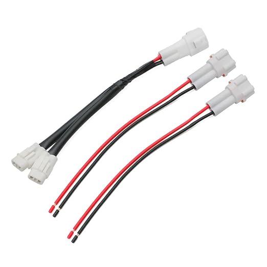

  12. This is the connector I used - that didn't work ...
    And this one arrived yesterday - I haven't tried it yet ...
    Both from Amazon.

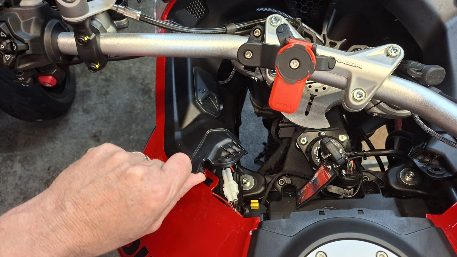

  16. Same Question here and found the solution,
    The photo shows where the connector is located for the USB charger from that connector the split cable should be inserted, but I made my own split cable (the black connector showing under the white one).
    On the white connector the colors are red and black where the red one is the positive.
    And yes it works just fine.

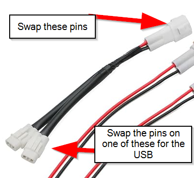

  19. An update on my efforts to have a switched power supply for my SatNav - success.
    It started with identifying a schoolboy error: the Y-cable I purchased - I did not check the polarity. So, the feed on the loom to the USB - I was connecting the red feed on the loom to the black on the Y-cable (doh). Simple task to remove the pins and swap them over. That gave power to the SatNav.
    However, the USB was then not providing a charge. Remembering a message earlier in this thread, the output on the Y-cable feeding the USB needs to have reversed polarity. Again, a simple matter of switching the pins.
    If I get the chance, I'll take it all apart again and take some photos (the ones I took at the time are useless).
    So, an update to the cable image from my earlier post:
    If anyone wants one made up, please let me know.
