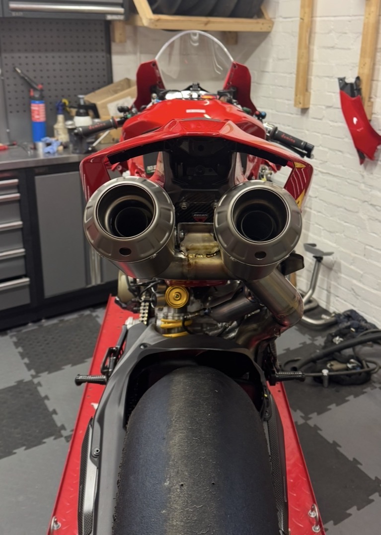

  1. On my 2025 v4 panigale I was lucky enough to pick up a new Akrapovic full system 3k cheaper than the obscene price for a slightly less obscene price. I fitted it had the software done at the dealer all is well.

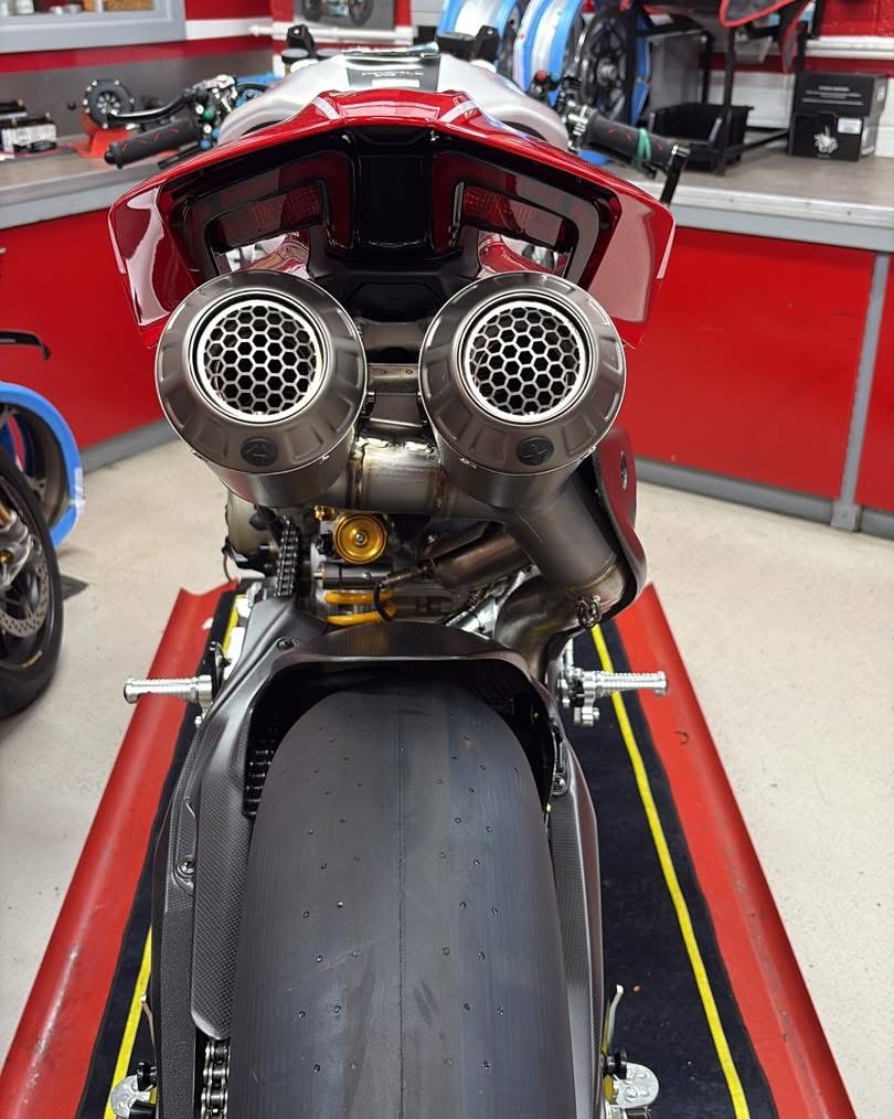

  2. IMG_5114.jpeg However this exhaust was clearly for enabling a number plate to be fitted and so the cans are quite wide apart.
    On pretty much all the promotional pictures the cans were closer together

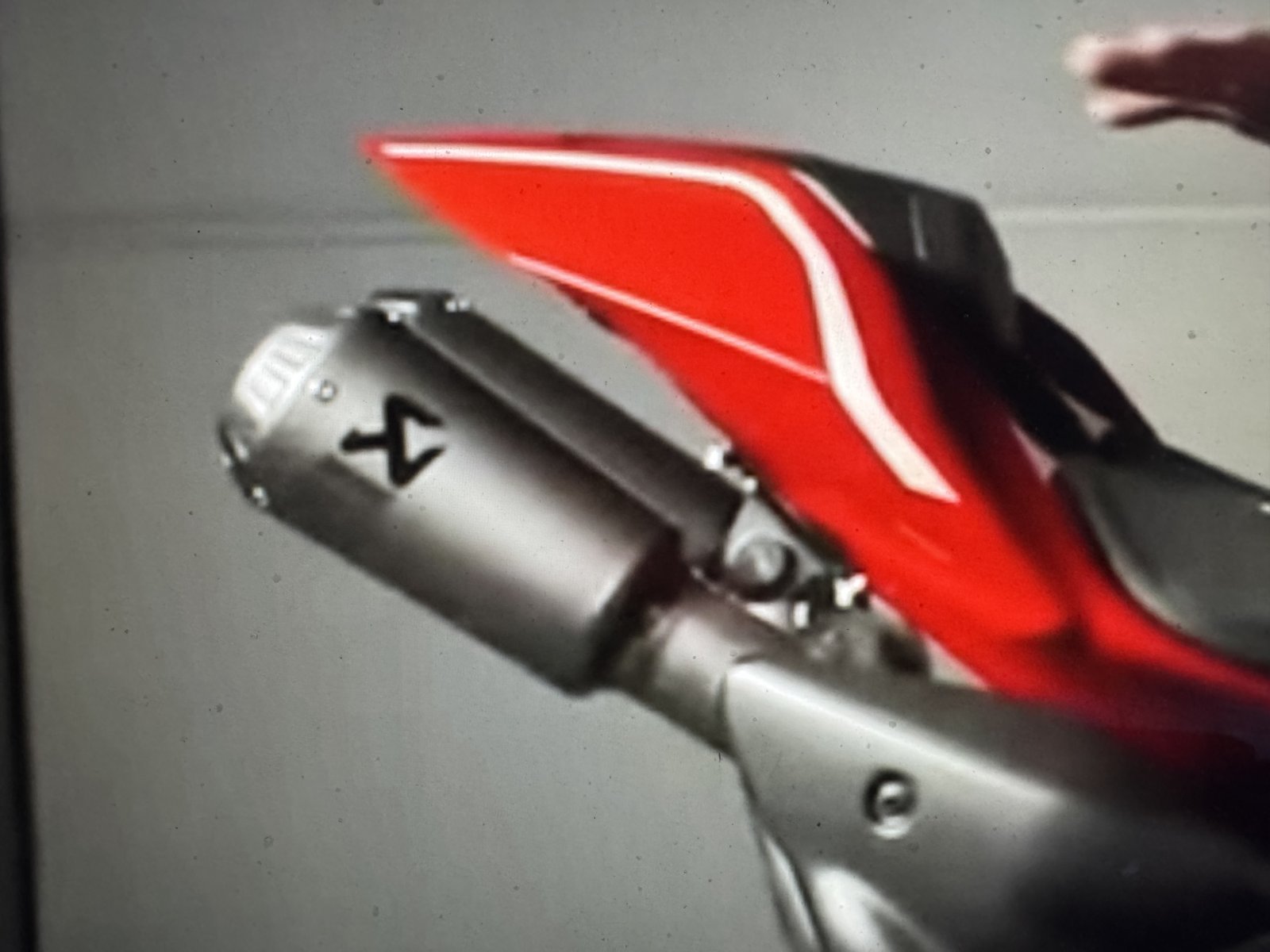

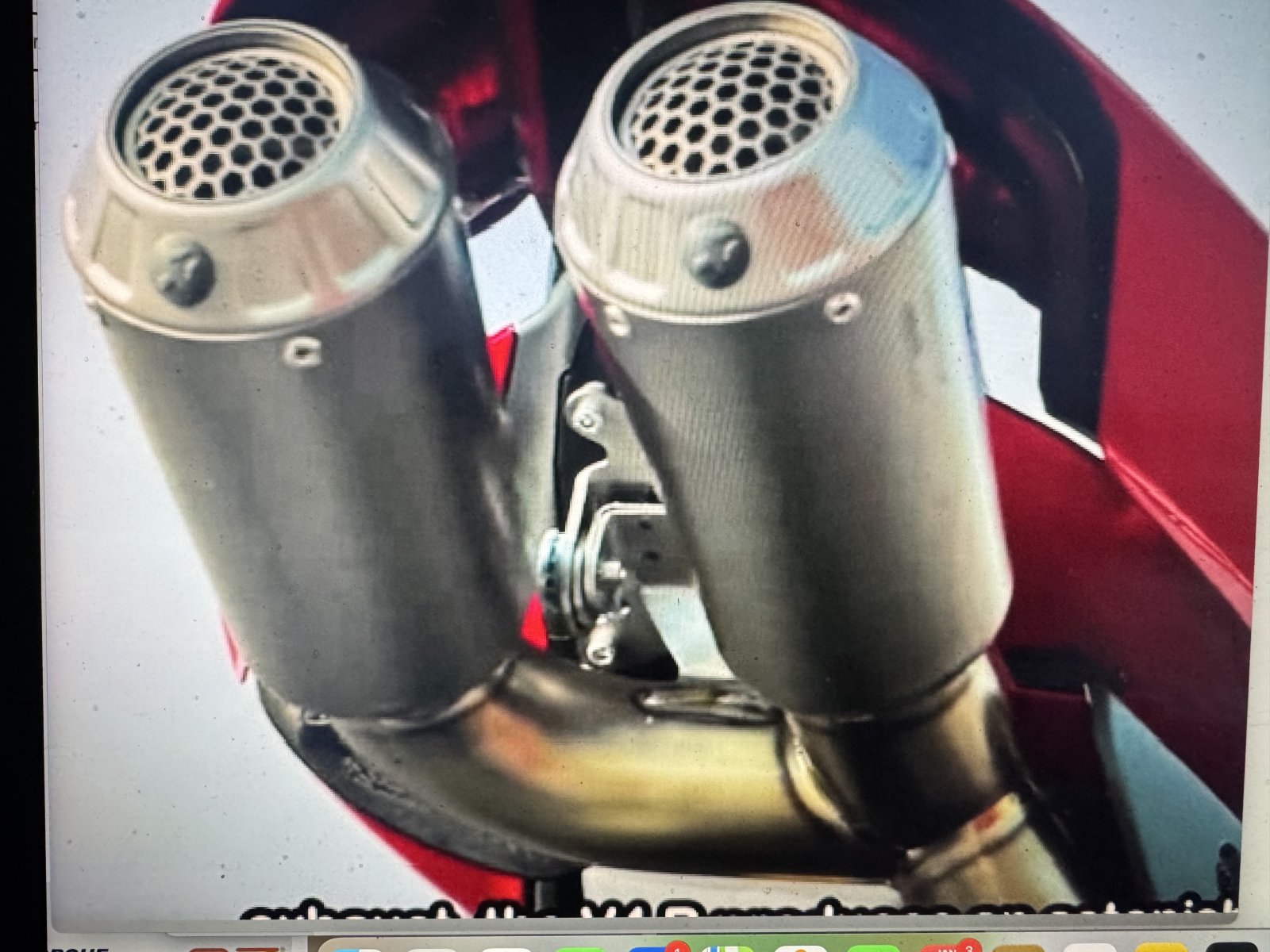

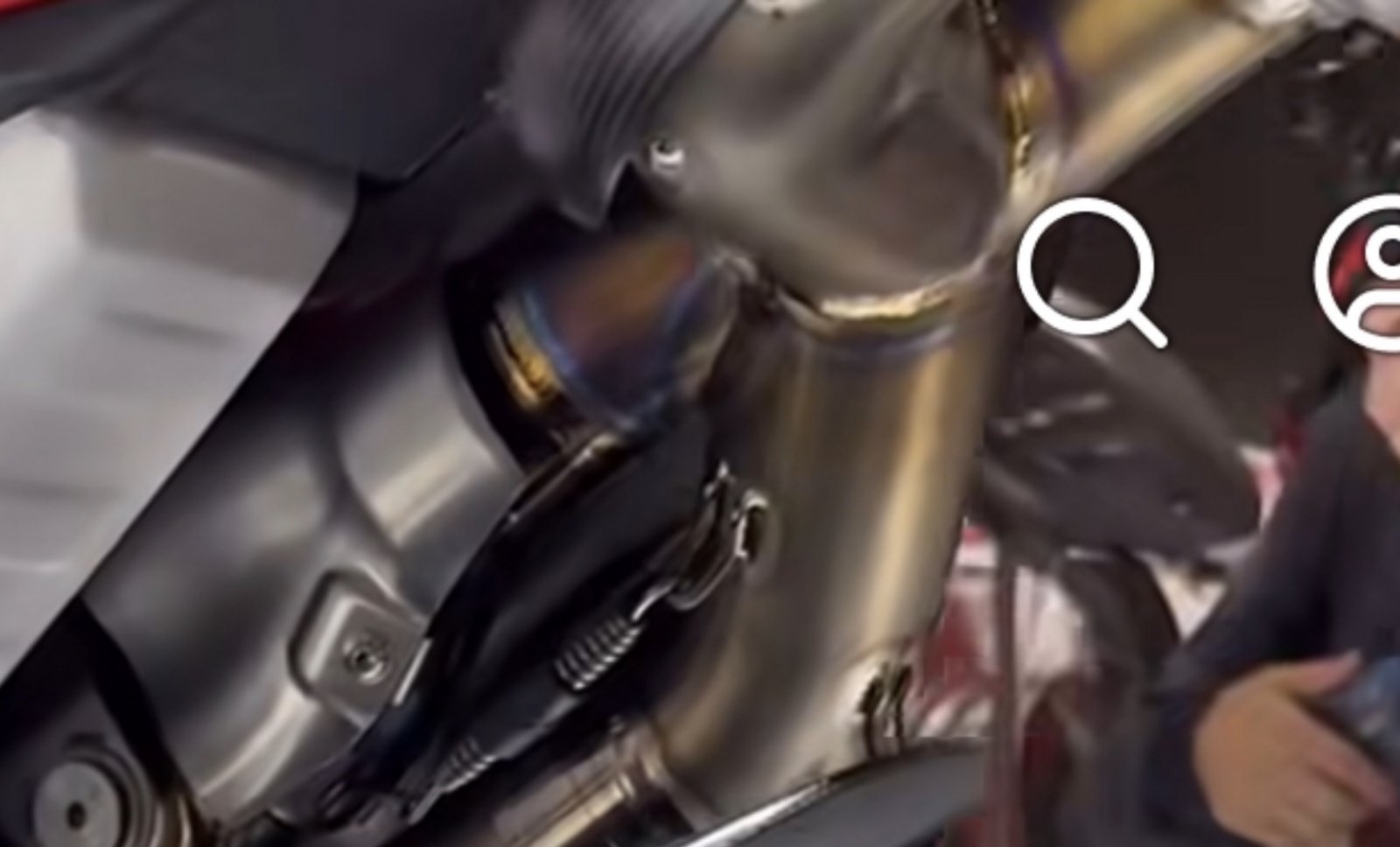

  3. IMG_5052.jpeg IMG_5051.jpeg IMG_5043.jpeg This is now available from the dealers it’s called a pro system, although there was a delay in delivery
    so I thought I’d preserve my original Akra rear section and make a new one copying pics of the pro system. I could see the shape of the pipes and the angles for cutting. Incidentally tge pro system is another 500 quid on the std Akra‍♂️

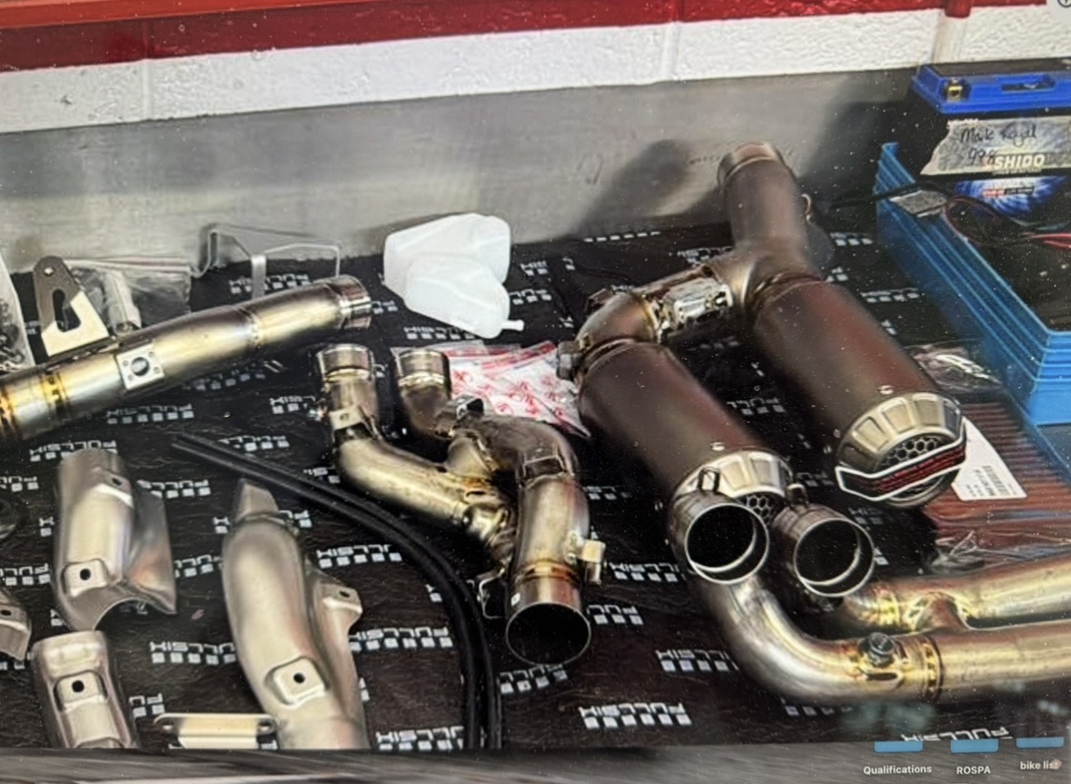

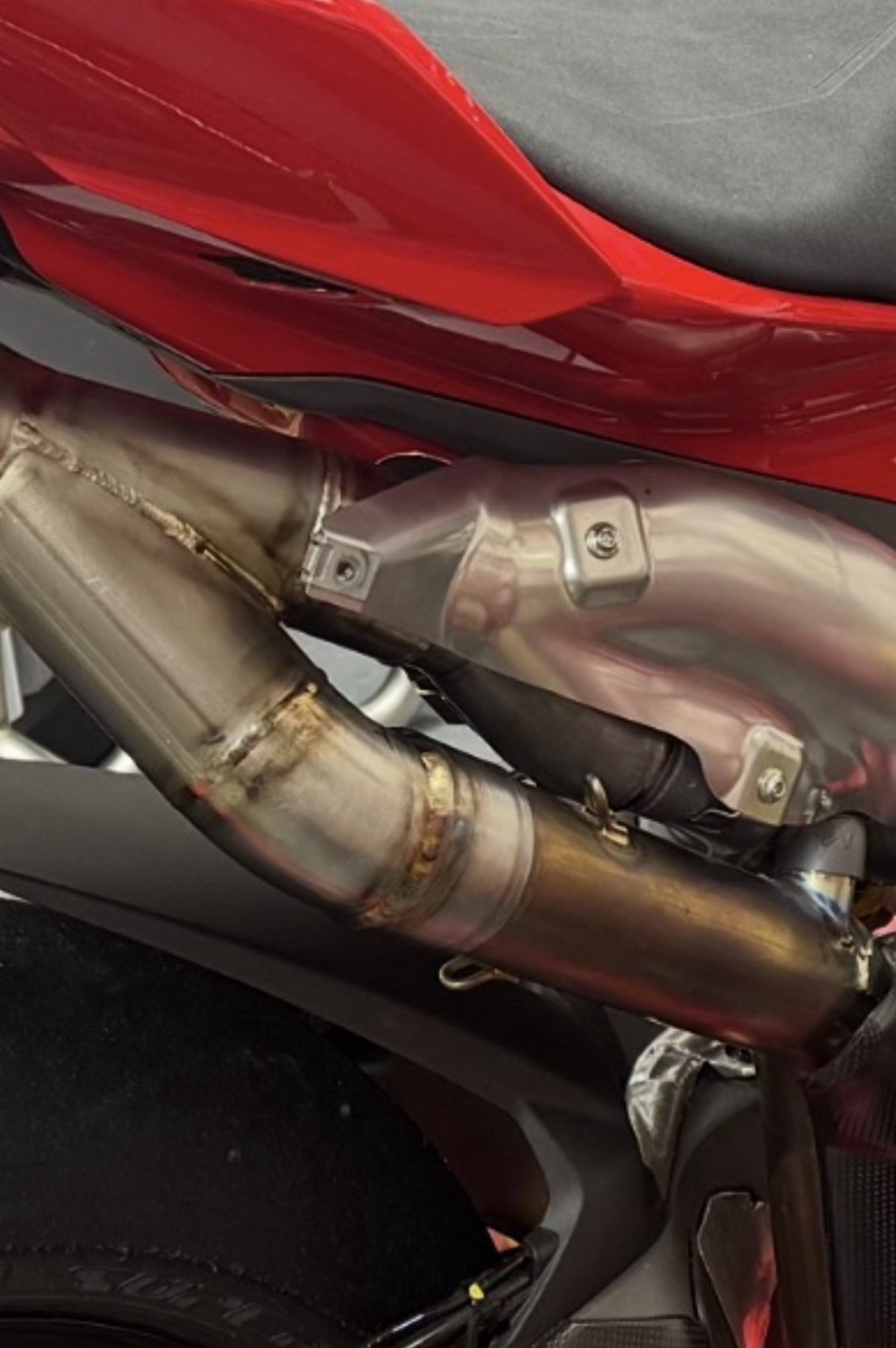

  5. I had a pair of Akra cans already added some 57mm titanium tube and bends then the hard fun of aligning the shapes so tge rear section could be added and removed from the bike without too much grief getting the cans to sit in the correct place
  6. Finally getting it complete and then all the tacked joints fully welded
    changed the ends on the cans and made some different baffles fully open to mildly muted
  8. All in all I think it looks far better than the original wide cans
    interesting to see some of the established dealers are just starting to get the pro system delivered…also that the complex x joint is now metal printed

  11. This is exactly why I continue to read this forum.
    Lovely stuff.

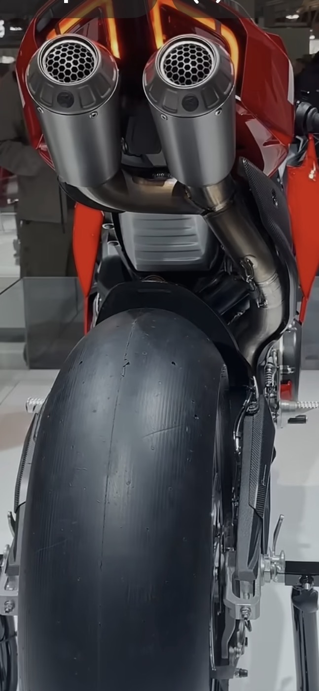

  17. They are all at it now tge new exhaust must be available
  19. That looks amazing and so much cleaner than the wheel barrow handles on the "standard" system. Great work!
