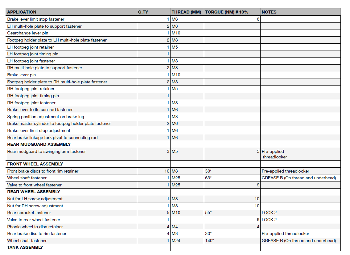

    Chucked in my SFV4S for the new one and am running the miles to get to the 600 mile service. I need to adjust the chain tension and the manual tells me to take it to a dealer (like all modern Ducati's).
    Clearly that is nonsense.
    Does anyone know the torque values for the rear wheel nut? For the 2021 I had it was 230Nm (and my 1098SF before that), but can't find anything for the new model.
    Searching/AI pulls the SSA torque figures, but not for the newer dual sided swinger.
    Anyone know?
    Cheers.
  2. This is from a torque sheet for the 2025 Panigale V4 thats been posted on the forums previously, since the streefighters 2025+ are more or less the same as a panigale less fairings, the torque should be the same :)
