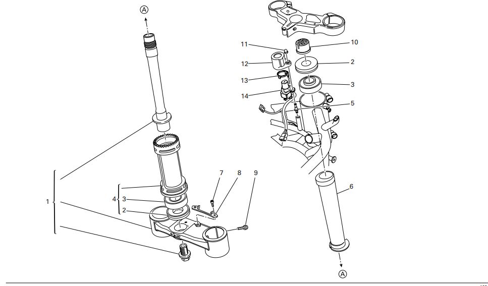

  2. This pic ducati dad put up shows the setup with 'minimum' offset - distance between fork clamp centres and 'steering bearing' centre - if you turn either of the eccentrics round 180 degrees it will increase that distance therefore increasing offset
  3. @Tobytyke
    At the risk of laboring the point.
    The opposite (180 degrees around) of how part 6 is shown below?
    The lobe pointing away from the bike?
  4. Yes
  5. What Airduc said :upyeah:

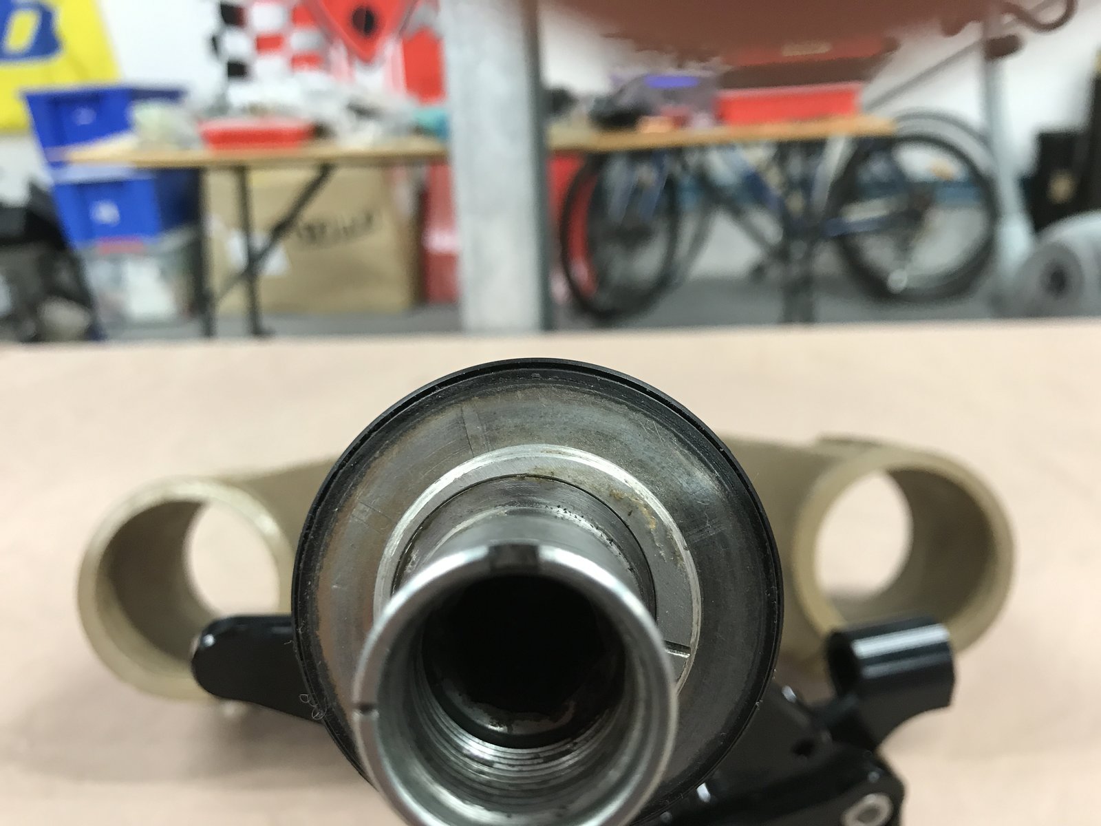

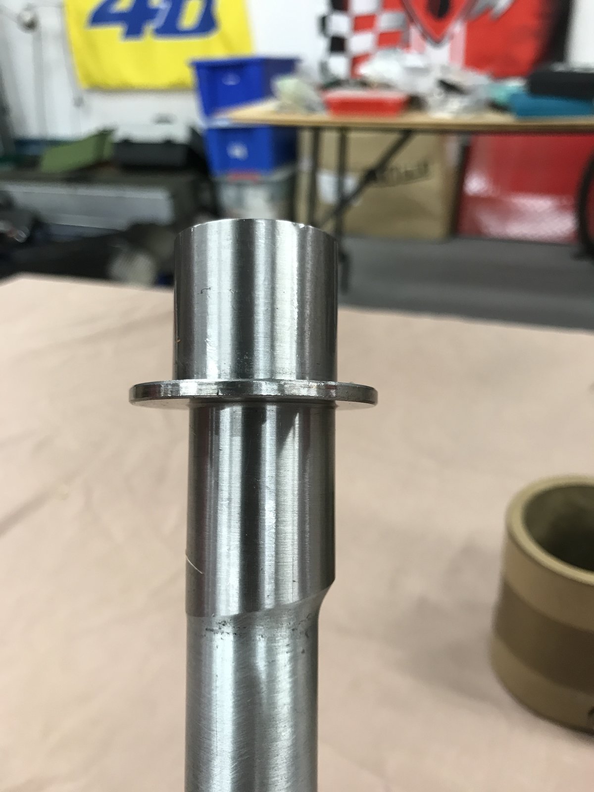

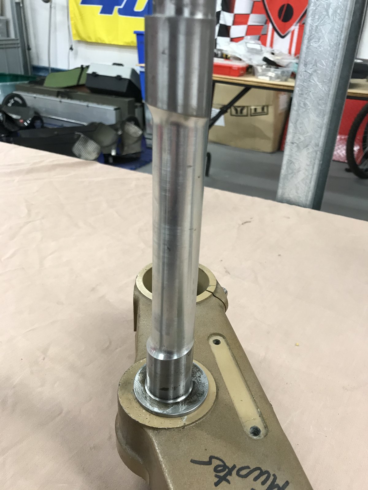

  8. photo is worth a thousand words? hope this
    30mm Off Set Triples.
    helps IMG_0994.JPG Exccentric spindle IMG_0997.JPG IMG_0997.JPG IMG_0997.JPG
    IMG_0999.JPG alloy part and steel inner stem turn together, you can now see how the inner and outer spindles can be set to shift offset
