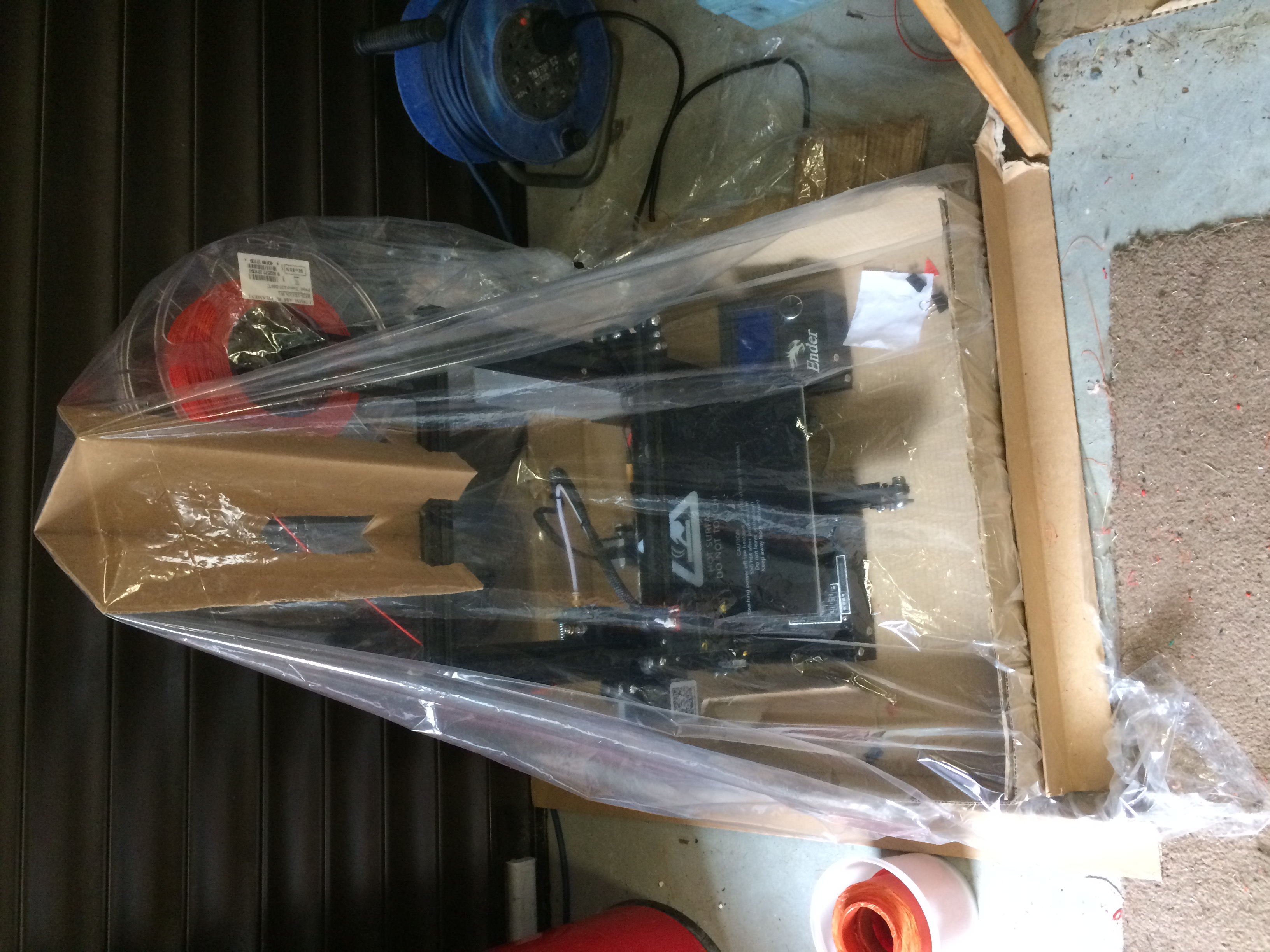

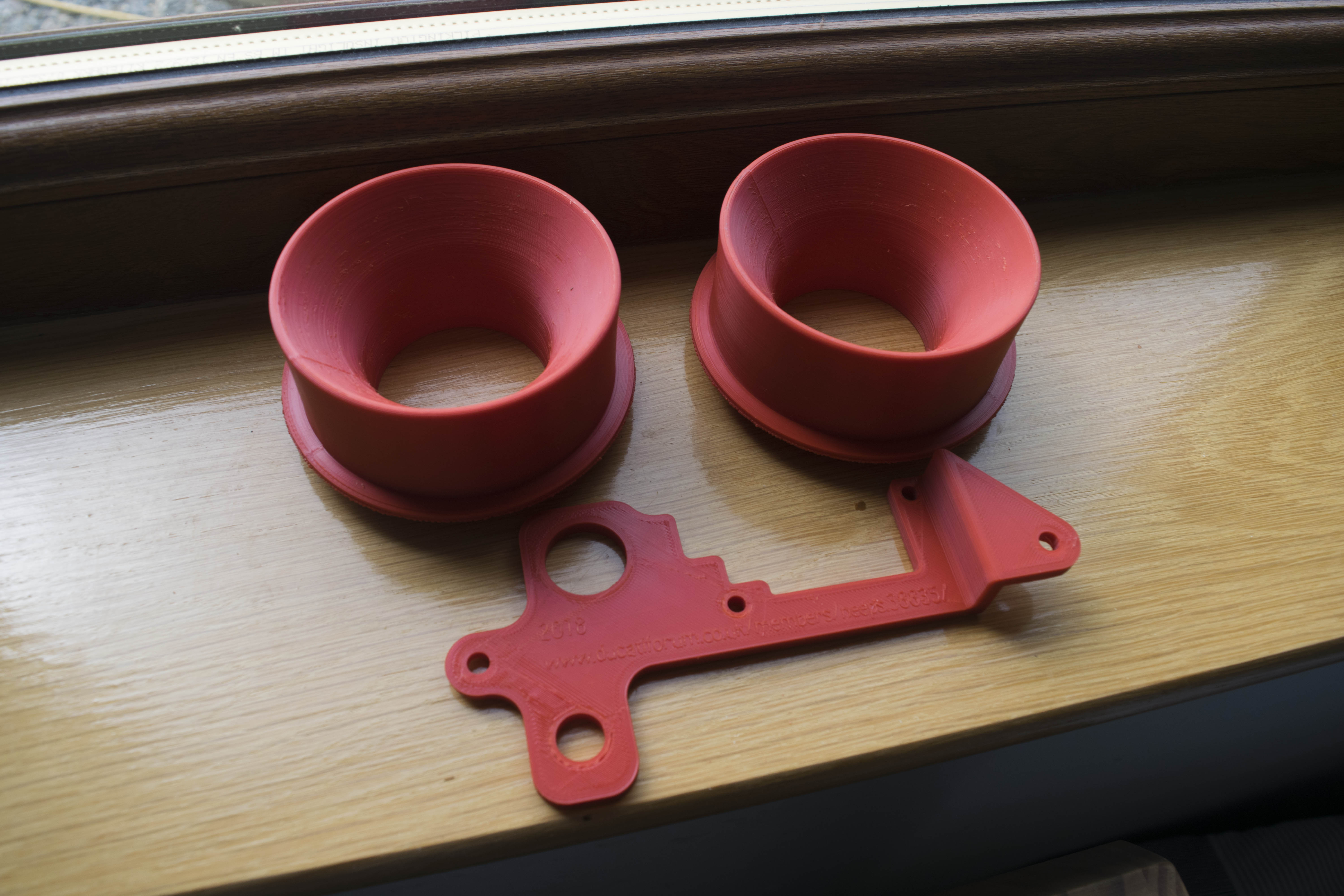

  10. Yea I've been printing a load of ABS (ESUN brand) the past couple weeks, it works great providing you get your settings correct (see picture below, the cylinders are 100mm in diameter and 50mm high with a massive overhang). The Only thing you need to do is cover the printer with something to prevent drafts from cooling the print unevenly, I just use a polythene sheet.
    I accidentally set my bed temperature too high (limit is stated as 100C but I done 120C) this caused the original print surface to peel off so I replaced it with a sheet of mirror glass (£5 for 4 sheets from ikea) with a piece of print surface stuck on top (the same material as the original bed surface, so the stock printer should work fine providing you're not a numpty like me).

  13. Those parts look very smooth, a good finish.
    Just how durable are rendered parts like that? Difficult to say I guess but durability was my first thought when someone mentioned mirror extenders.
    Out of curiosity what is the bracket you've rendered?

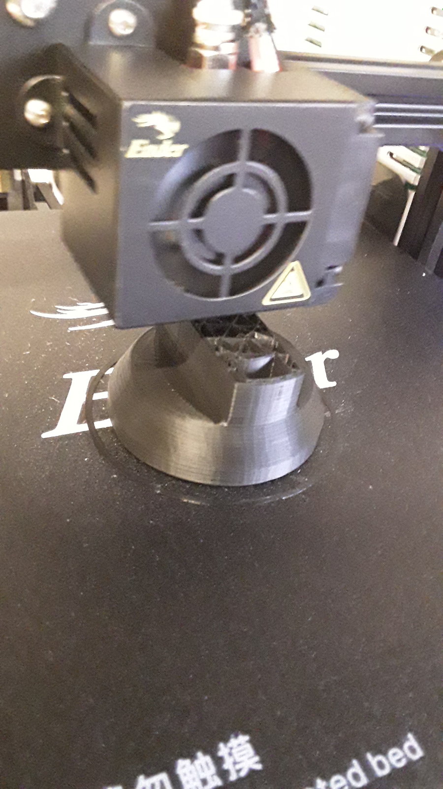

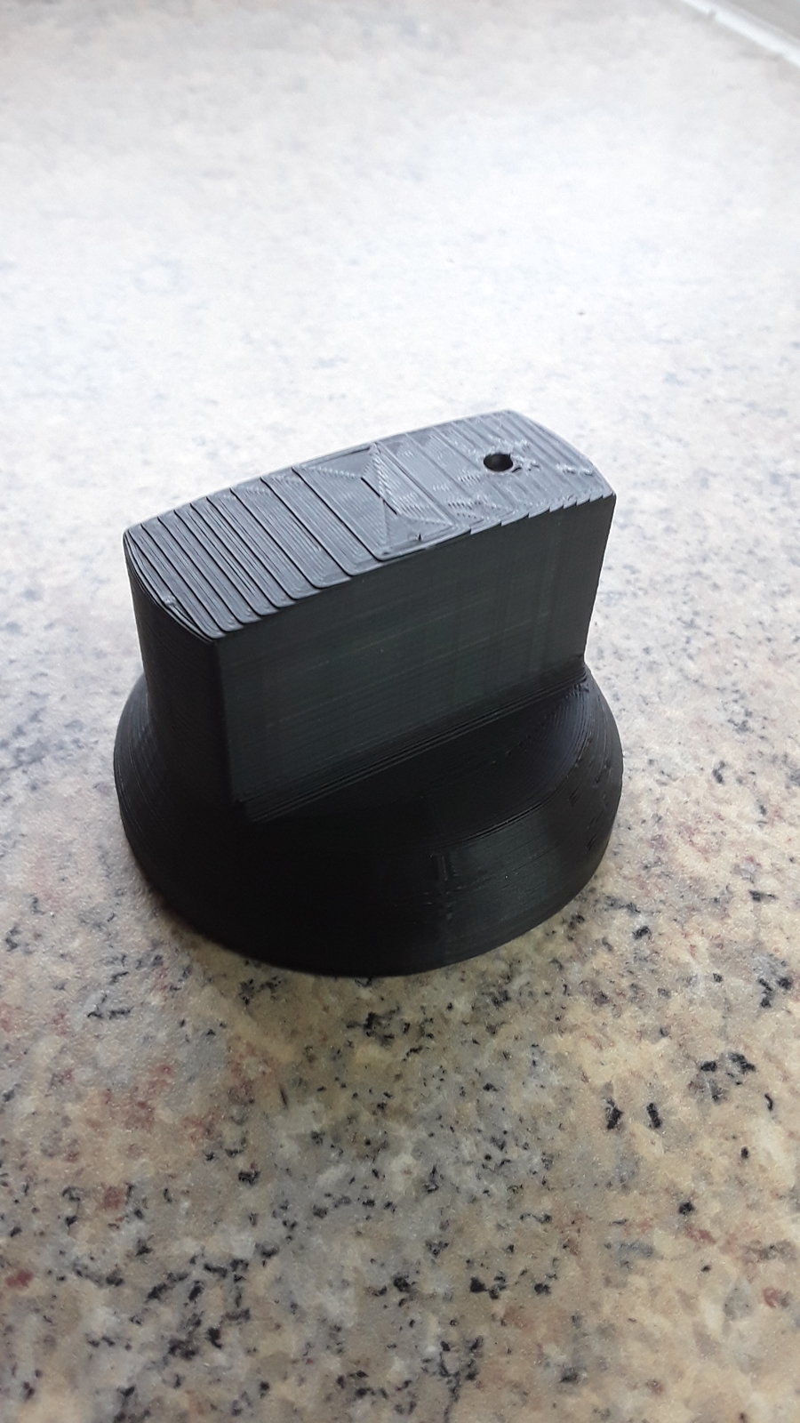

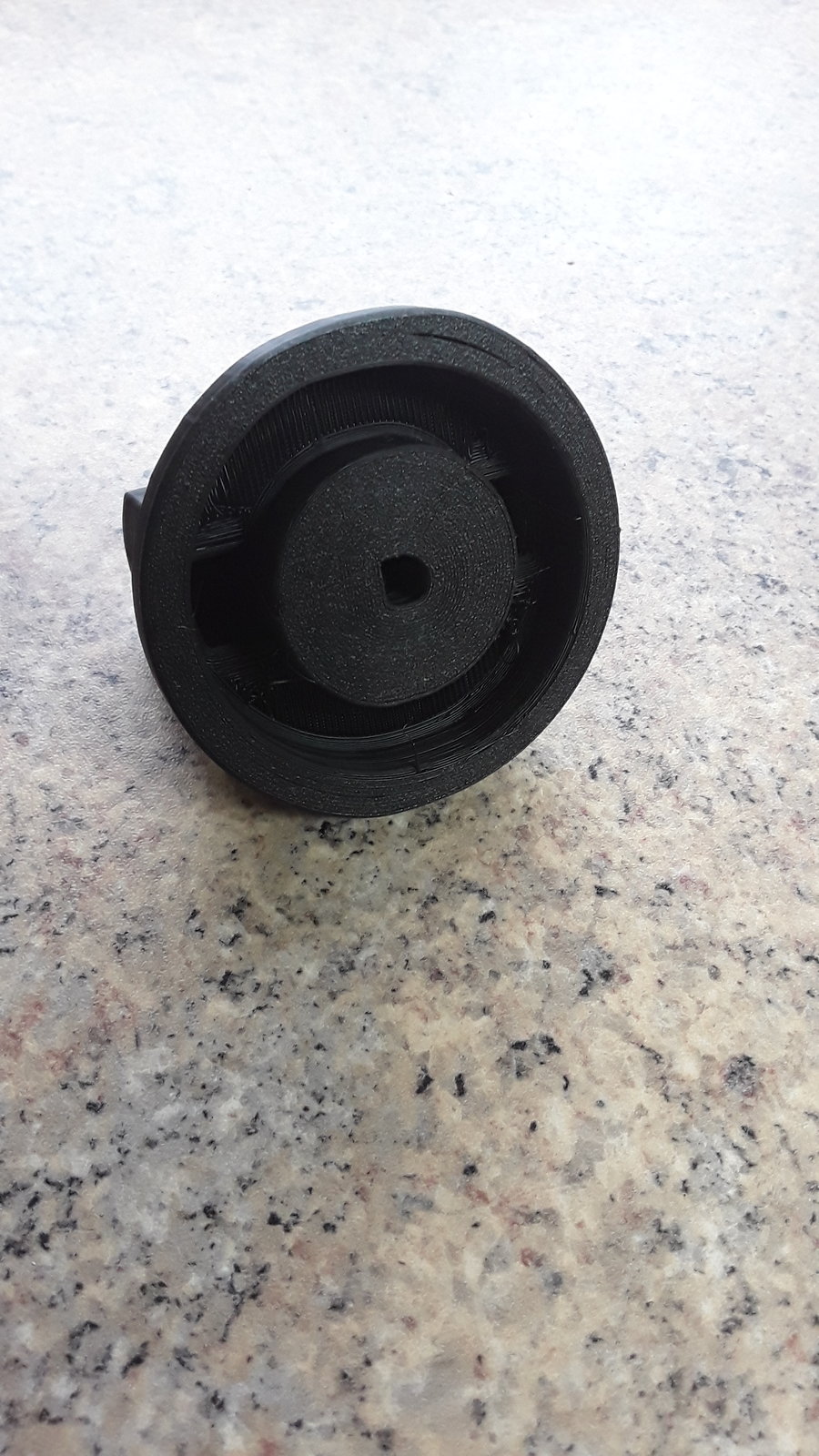

    Hey Neeps,what a piece of kit this is for the money,I'm well impressed. Made the demo Dog,and her indoors has been asking me to sort some new,control knobs for the bbq. Got a file from thingiverse and printed it off,draught quality but results are great. Will start to get more serious now and learn best results with Abs. Thanks once more, Neil.
  18. Good to hear that you're enjoying it! What material did you print the knob in?
  19. Pla,I bought it from Ender at the same time as the printer.Had no problems with it so far.Just made a toothbrush holder,can't stop playing,lol.
