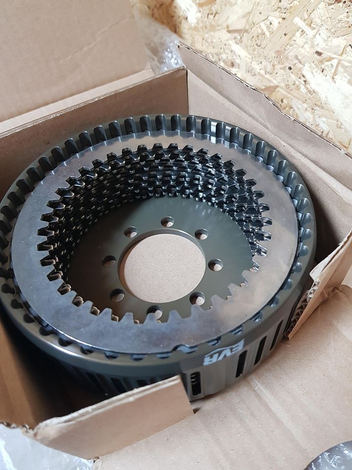

  6. I just fitted the EVR 48 tooth basket and plates to my 888(didn't want slipper) 888 doesn't need it on road, nicely made stuff, I only fitted it to quieting it down which it done massively, Like you I didn't want a slipper but on my SFS ive the full Dp slipper(not 48 tooth) which I think is a cracking mod,

  14. This is the kit I fitted 32457514_10213145375408311_8667424769911554048_n.jpg
