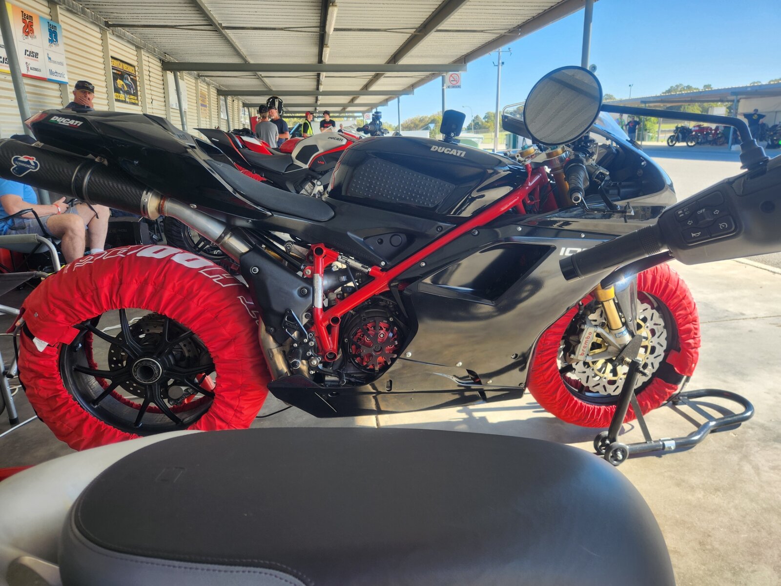

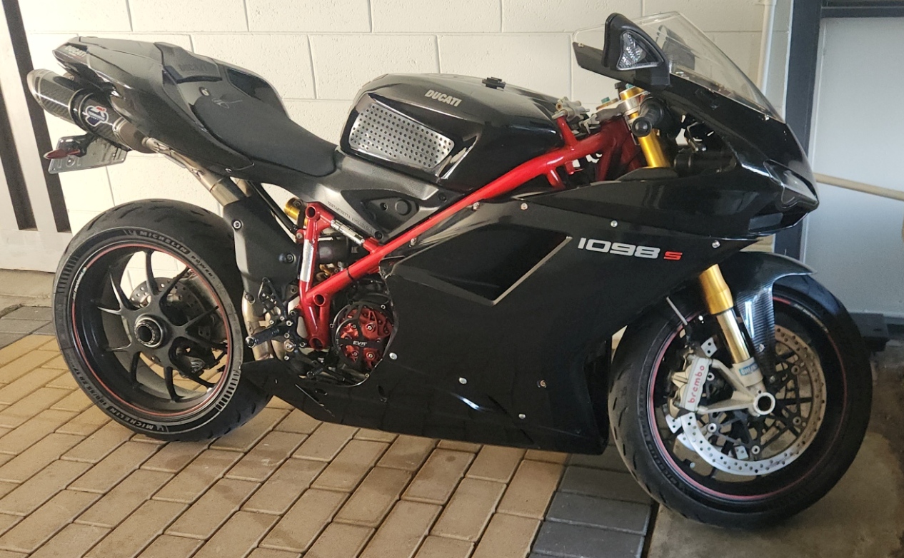

    I have a Quck Change sprocket carrier and a selection of 520 rear sprockets for the big hub/6 cush drives. It's for my 1098S with racing ECU, Power Commander and short Termis. So I'm guessing max power a bit above the standard 160HP.
    Is a good quality DID 520 up to the task. I realise that the sporkets won't last as long and therefore the chain is also going to need changing sooner. That's no problem. My only concern is catastrophic failure and resultant carnage to bike and rider.
    Is it up to the job or should I stick with 525? The bike will visit the track a few times a year, experience WOT at close to redline and reach speeds up to 240 km/h.

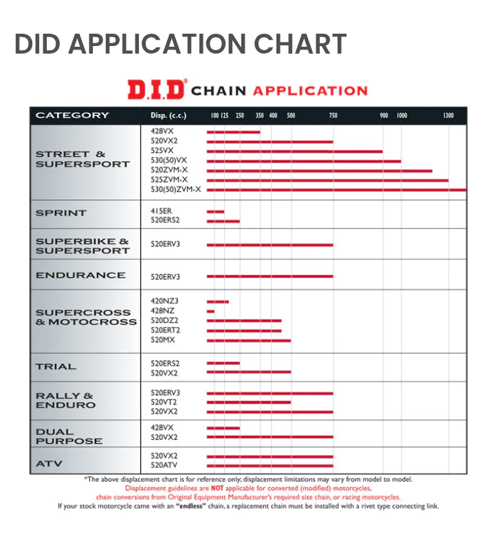

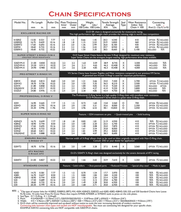

  3. Here are are couple of pictures with DID's specs and applications. The tensile strength of a 520 is approximately 75% of a 525. I'd say a 520 on that bike is ar your own risk.
