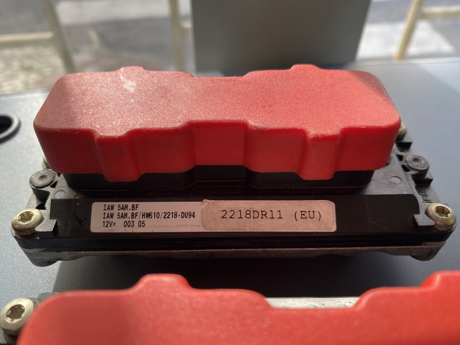

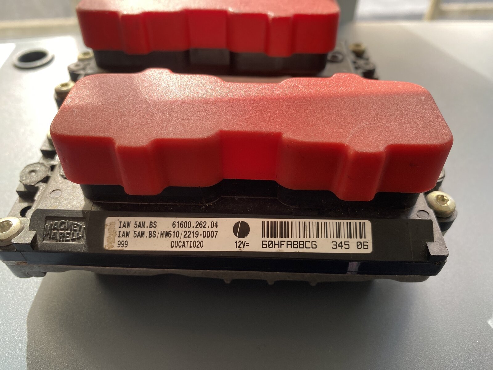

  12. I have two 5AM options, one pulled from a 999R and another from a 1098.
    999R 5AM:
    1098 5AM (looks like it was used for Superstock so not sure what its like):
    @chrisw Assuming the 1098 is virgin, would the 999R ECU be coded?
  13. The 999R ECU ref number is for a stock map in the family 28640831* (where * is a letter H through L). As a stock map it is likely to be coded.
  14. So guess I'll have to take my chances with the 1098 5AM :)
