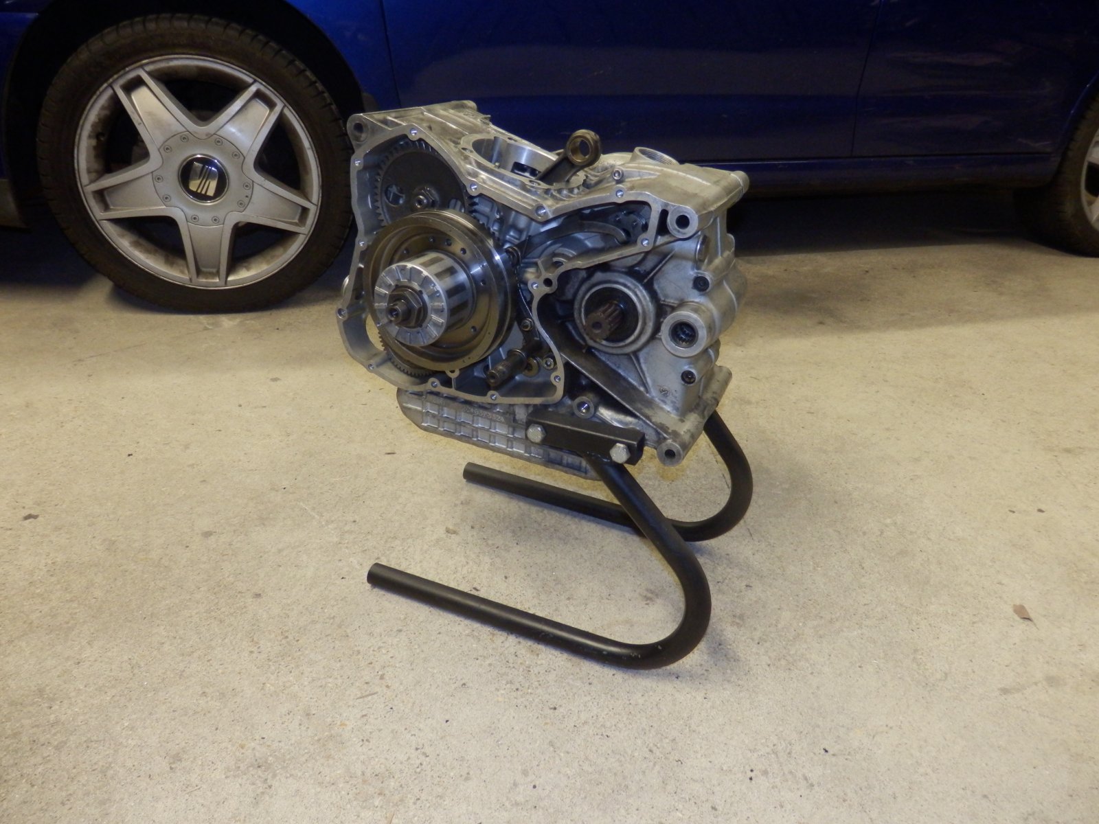

  3. Thought I'd post a couple of images of where we'd got to.
    Nasher.
  4. Great thread as I also have 2 half engines from different sources to glue together!
    Did you make the stand yourself?

  6. I was going to, basically a couple of flat plates, but I had a quick look on Ebay and picked these up for £15.

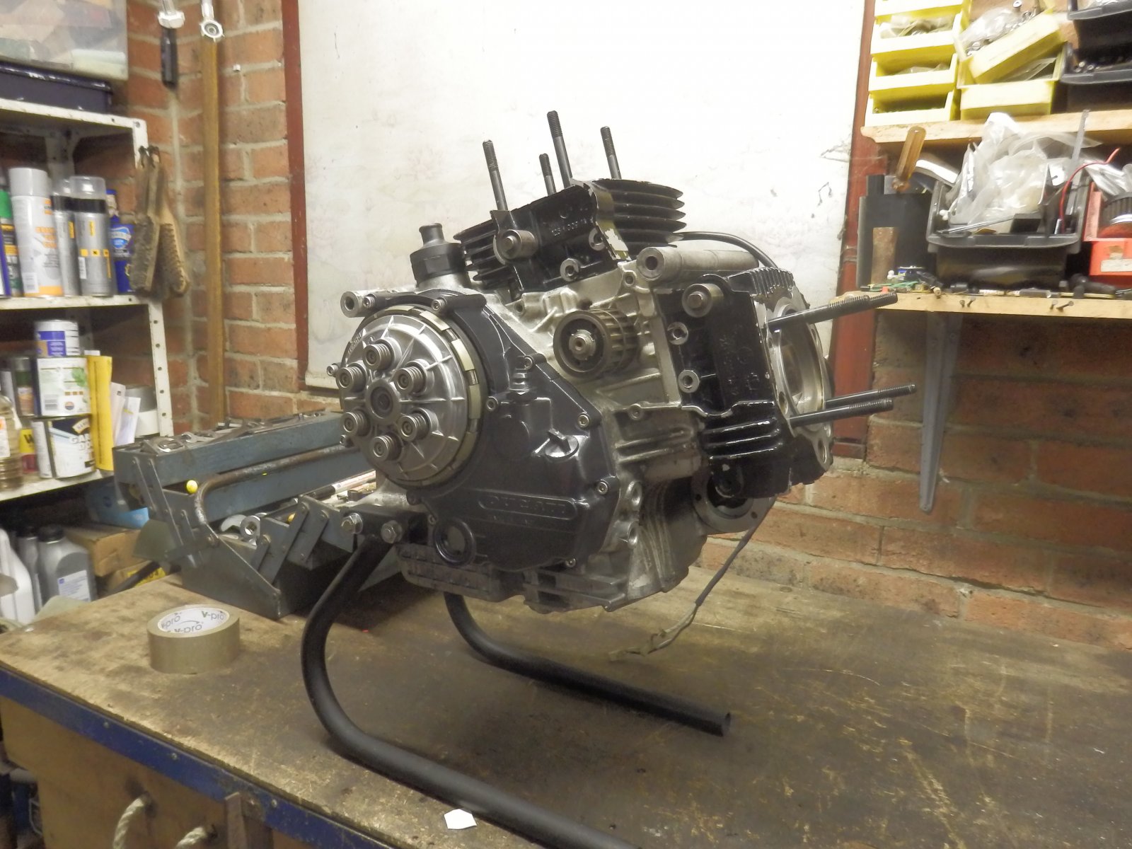

  11. Latest progress.
  12. Great thread
    Love those stands - please let me know if you spot another set..!
  13. stands are funky
    they look like office chair legs (or something like )
    welded to pieces of box section that's drilled for mounting bolts
    shame I don't have access to loads of office chairs anymore I could have knocked some up
  14. They are useful, although before I use them again I'll weld a brace between the top and bottom to stop them flexing as the engine does get a 'bit of a bounce on' at times.
    Ideally I'd also weld a couple of braces from side to side, but then they'd be harder to store.
    Nasher
  15. drill hole in each one the weld a nut above hole then you have a bolt on brace removable for storage

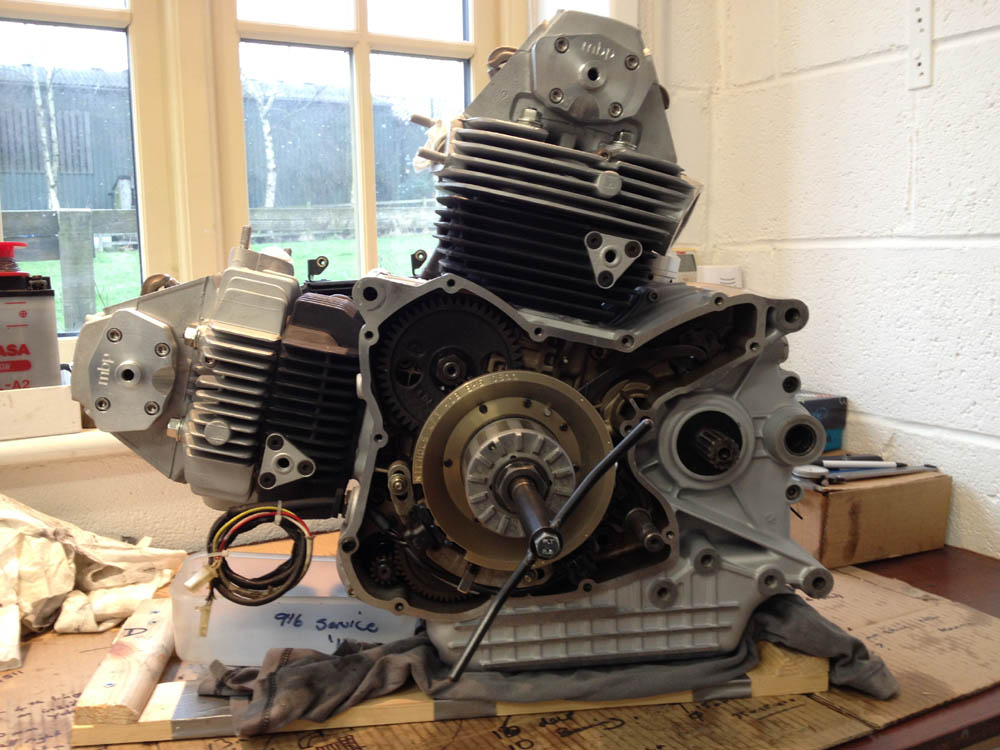

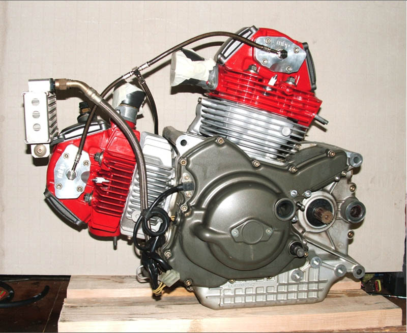

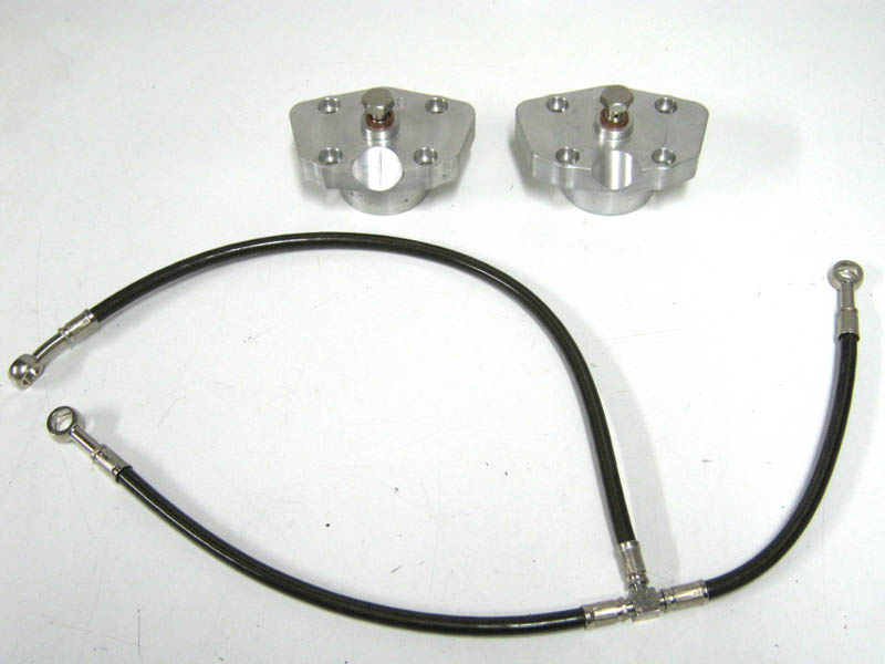

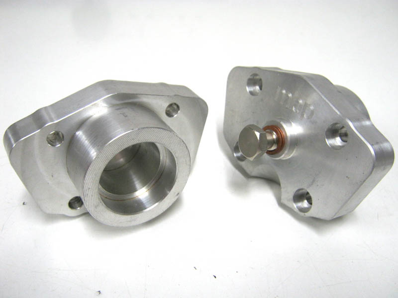

  16. I have external oil feeds on my Monster's heads, made by MBP and fed from a line fitted to where the oil pressure gauge normally fits.
    Basically the oil gets to the heads quicker, I also fitted a higher flow pump (from DS1000) to get more oil circulating for better lubing/cooling.
    Oil still goes to the jackets in the barrels but all of it then returns through the return lines instead of some going to up the heads, whilst the heads are fed externally (as per 916 models).
    I blocked the oilways with a grubscrew to stop the oil flowing up and then used a solid dowel as a locating pin rather than the restrictor tubes.
    Whether there is a really good reason to convert, I don't know? but I liked the way it works as it seems more positive and with an uprated oil pump I get more oil, quicker to the cams/rockers which can't be a bad thing.
    MBP, California Cycleworks and others use them on tuned engines.
    Mine;
    MBP pics;
  17. Dukedesmo
    Many thanks indeed for that explanation, it's certainly something I will now consider.
    I've ordered standard restrictors from Stein Dinse, so will get the engine built up with them and think about your mod whilst I dry build the bike around it, then possibly do the mod whilst the bike is stripped down again for paint etc.
    What Barrels are on the engine in the last pic?
    Nasher.
