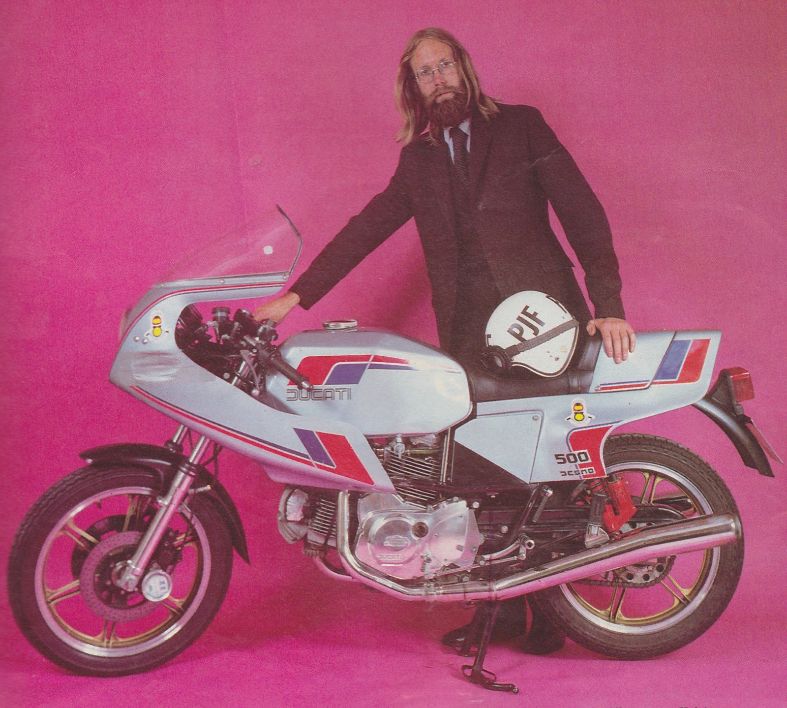

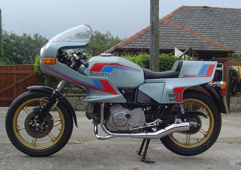

  14. The red and green colour scheme is the one most people like. Personally I like the more subtle metallic ice blue paint with red and blue decals best.
  15. I like both colour schemes :)
  17. Neither are red :Finger: :p
