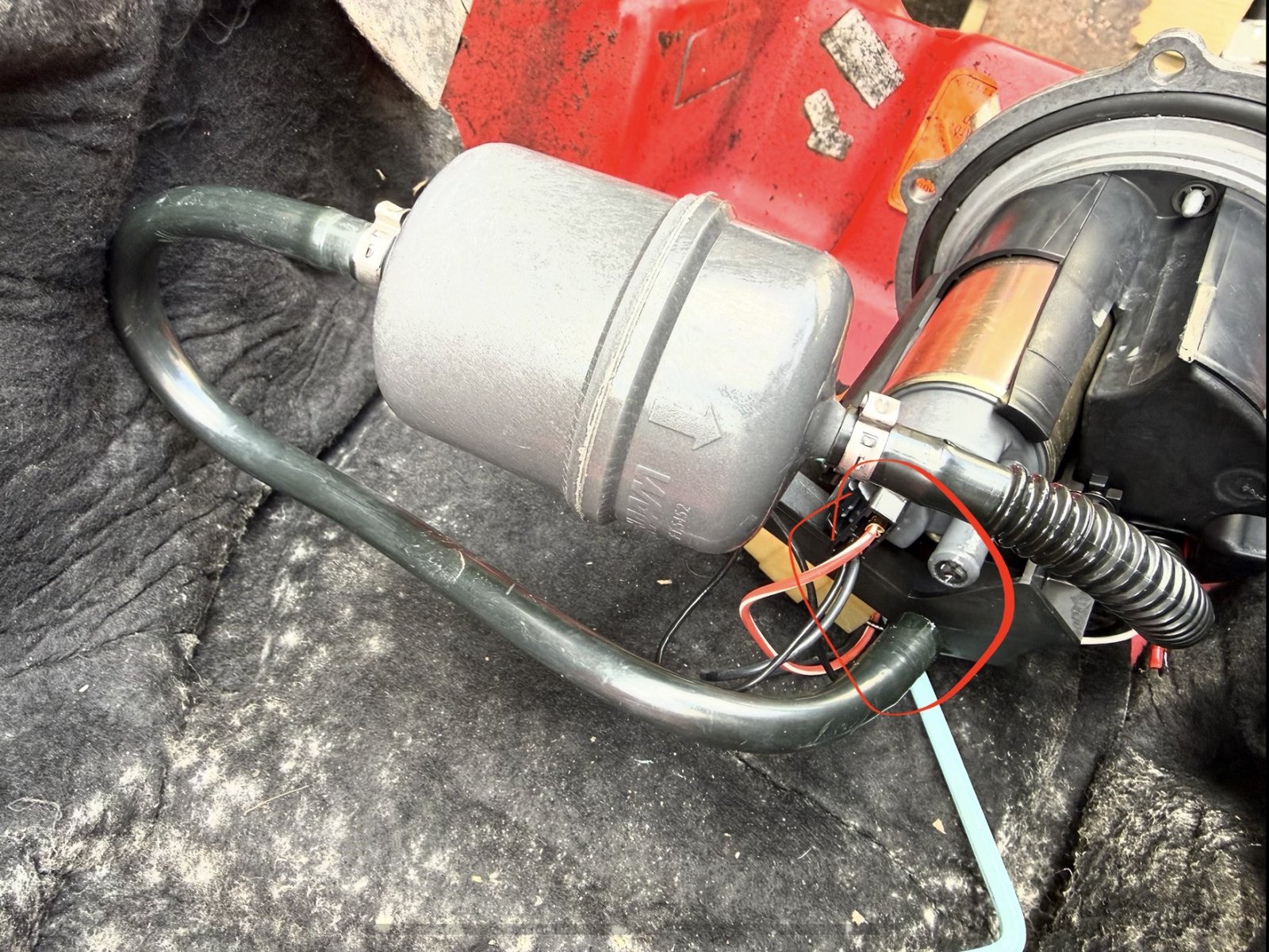

  10. Apologies I was sent off to scotland to work. IMG_3625.jpg Well it turns out it was an easy fix after all, looks like I'll need to keep an eye on this bike, the previous owner wasn't so fastidious with the maintenence, no clip on the hose and no shim on the crank sensor.

  17. Yeah I checked/cleaned the crank sensor, checked for spark then syphoned the tank, well most of it, the rest went on the drive and my shoes when I removed the tank. As soon as I pulled the pump out I could see the pipe was off so I spent an age looking for my box of clips, chucked one of put it all back and it fired up.
