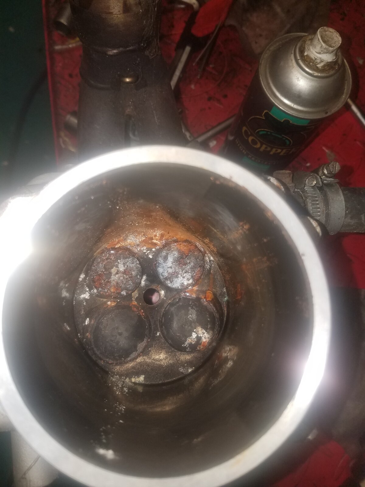

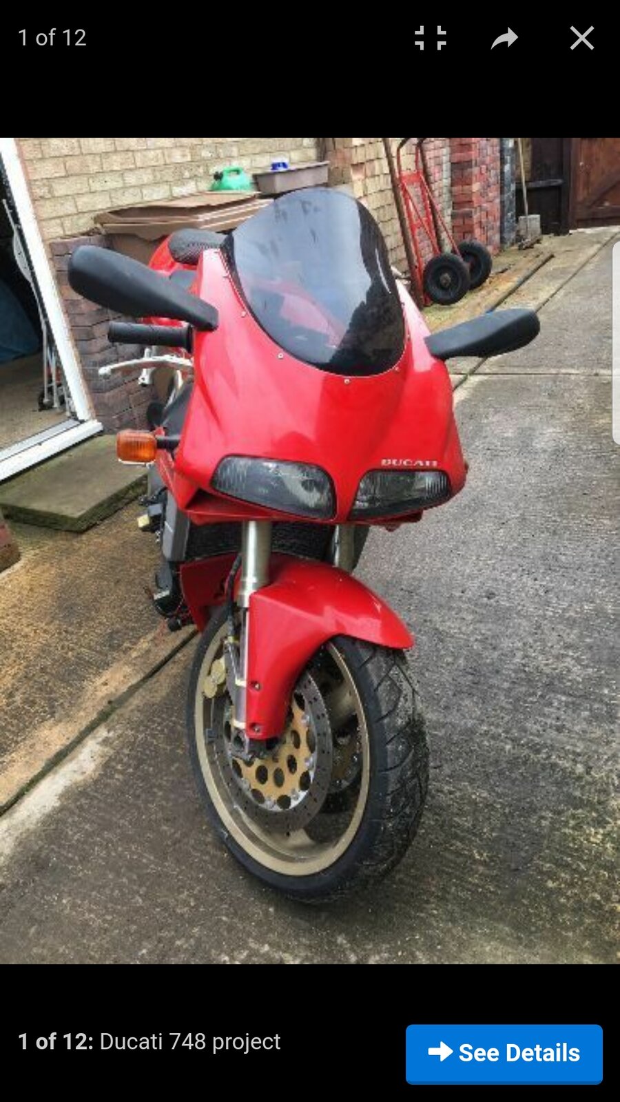

  1. I purchased a very poorly 748 a couple of weeks back. It had been left outside under a non waterproof cover for a year and then put in a garage for 10 years, having not turned a wheel since.
    I've stripped every nut and bolt off it, cut the swingarm off with an angle grinder, stripped the engine down and the front cylinder has that much rust, the valves are seized solid.
    I've since started putting it back together with 999 ohlins forks with 748r shoes and p4 34/34 calipers. I've got another swingarm and greased up the spindle and spacers.
    New bearings EVERYWHERE!
    Cleaned it all and touched bits up.
    I'll machine the bottom of the barrels down by 2.3mm on a lathe to get the squish correct and i have bought a gasket set to replace every gasket and seal along the way.
    It should be a nice job when done.

  2. Pics mate

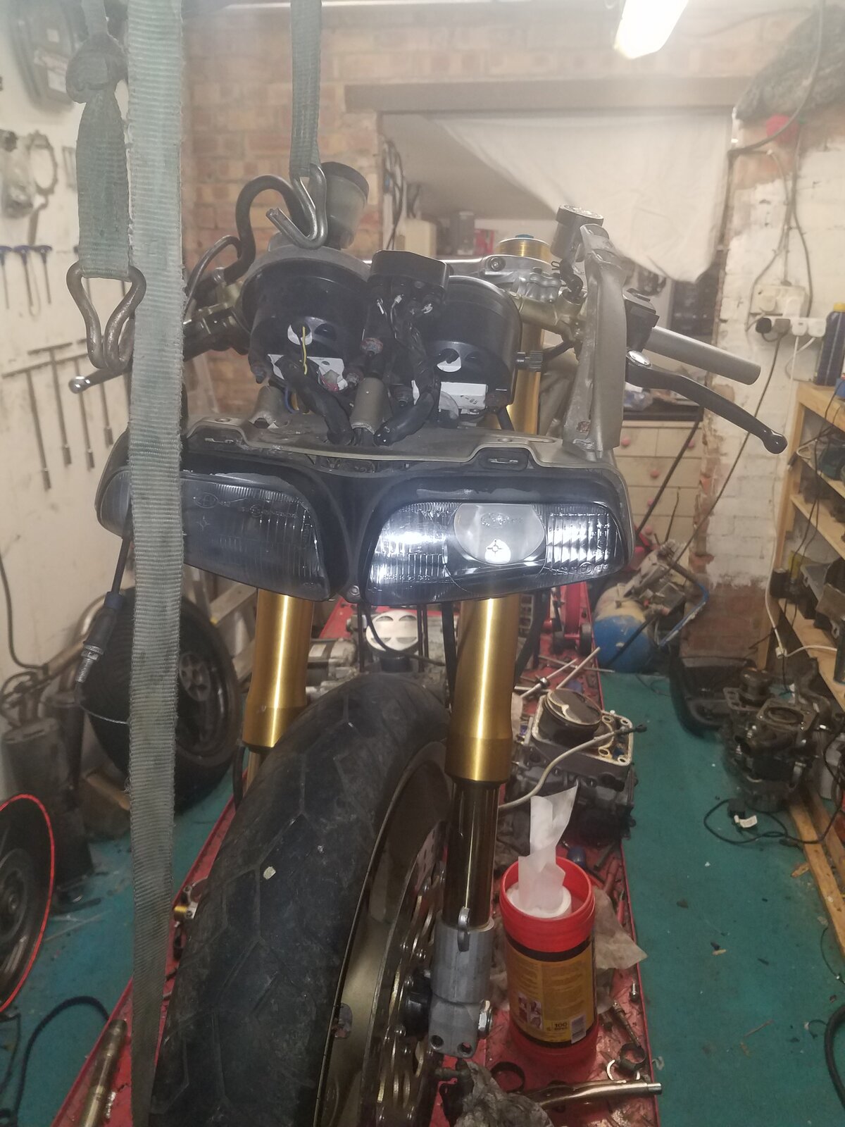

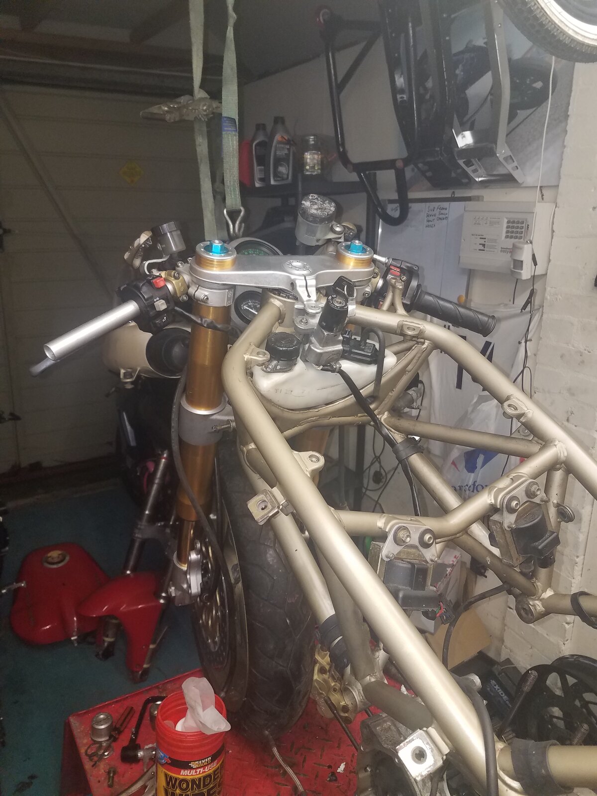

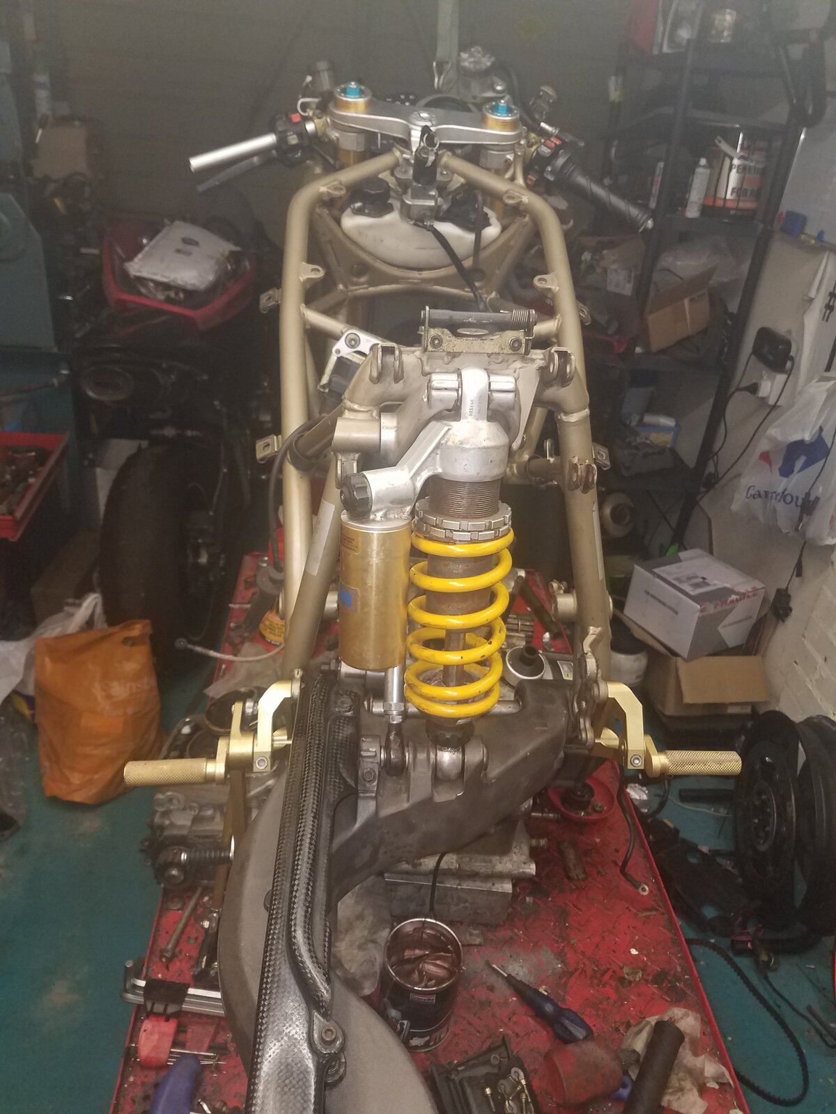

  14. before pictures

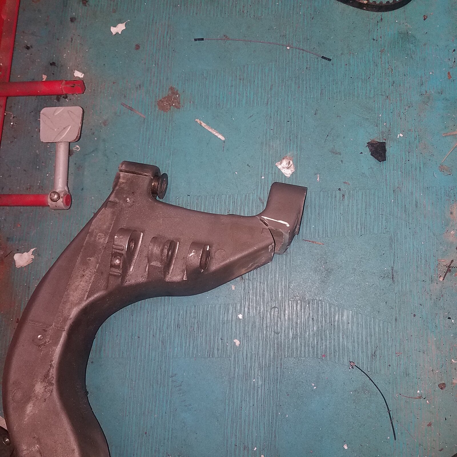

    i had to cut the notch out to get the grinder nut in.
    i really couldn't believe how solid this had gone!!
    • Nuke Post Nuke Post x 1
  17. Others have had to do similar in the past, that's why I remove my pivot bolt every service and re-grease, it's a two minute job.
    Steve
  18. A very good shout there, Steve. It will become part of my maintenance routine also.
    I've smothered everything in copper grease or lithium grease as I'm putting it back together.
