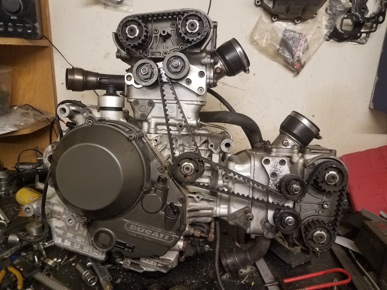

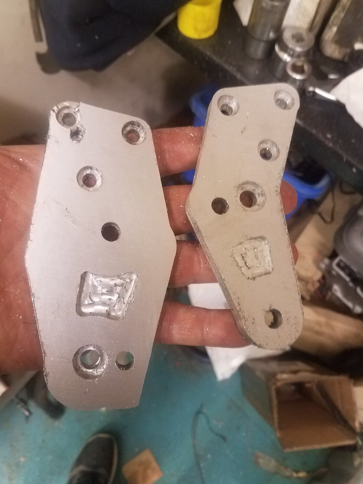

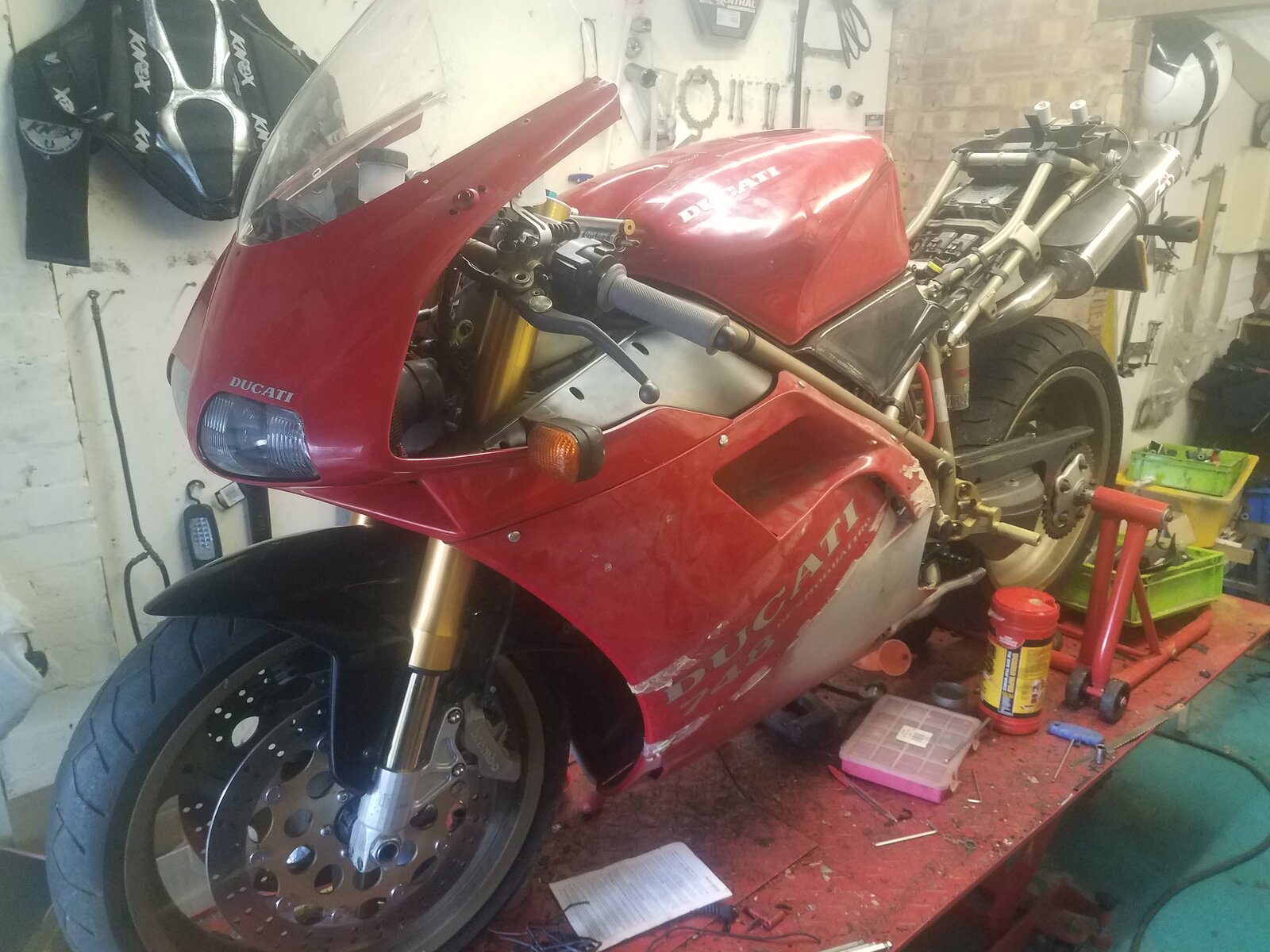

    I had to go a completely different way on the set up of the idlers and tensioners.
    I had to get busy on my little CNC.
    20190316_182849.jpg the ones here were the first ones, but you get the idea.
    We are all tensioned up and ready to go
  4. Four adjuster pulleys
  5. With 4 adjusters, you can tighten or slacken the normally idle one to bring the timing marks bang on, as these move when altering things, and then tension the belts as normal.
  6. its coming on quite well.

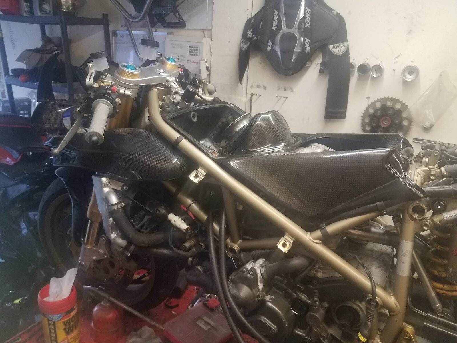

    engine turns over nice and all looking good.
    20190322_165925[1].jpg 20190324_125912[1].jpg 20190324_125919[1].jpg 20190324_125924[1].jpg 20190322_165914[1].jpg

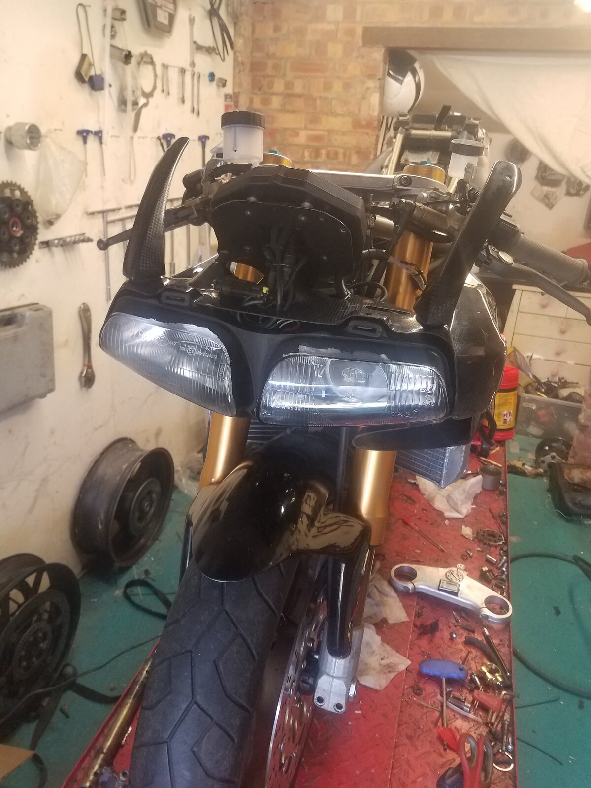

  7. Nice front hugger :upyeah:

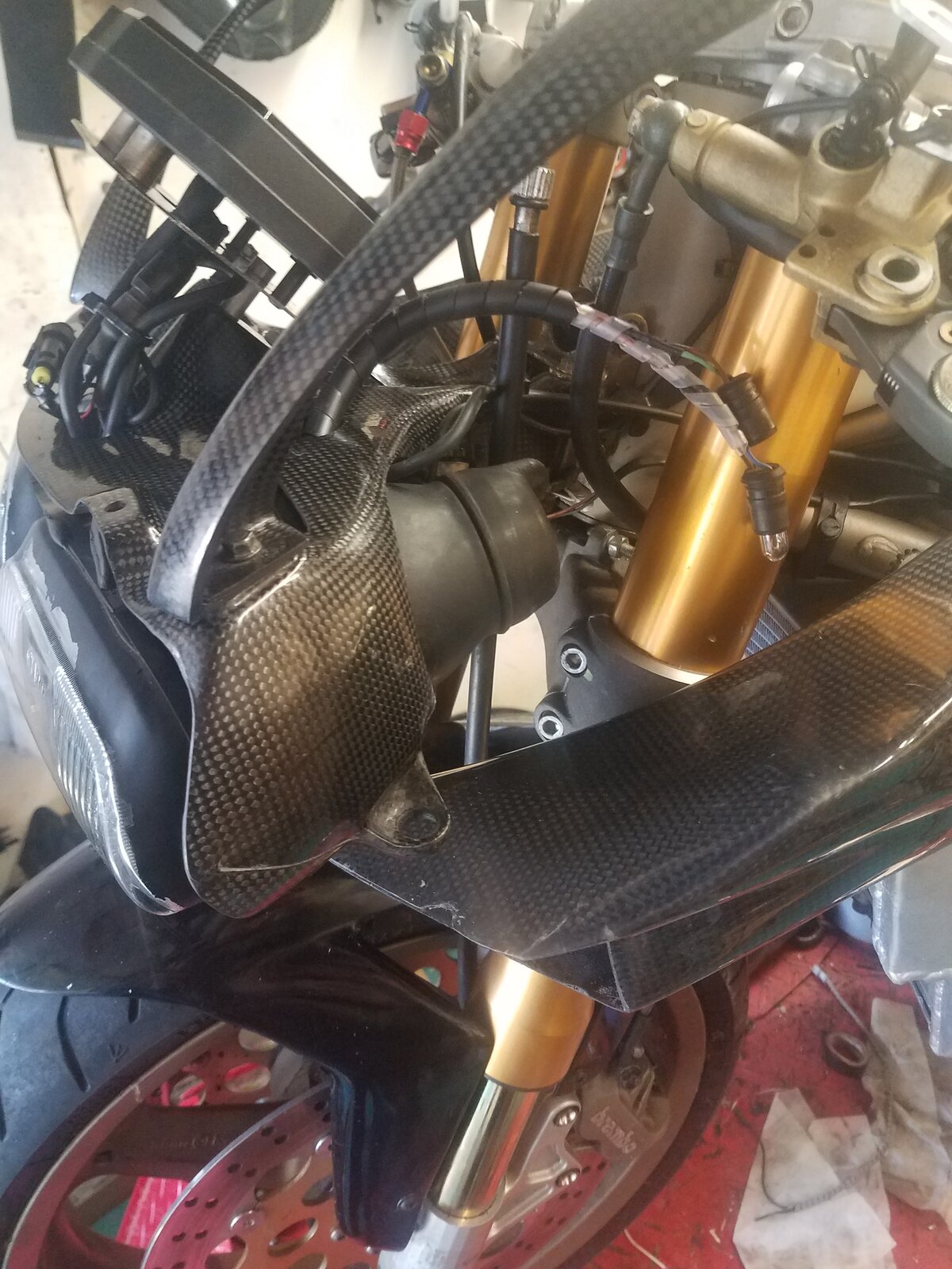

  8. That radiator looks a bit RS...
  9. It has some really nice bits on, which I'd like to thank @Tim K for.
    Full 50mm termi system
    Ms carbon airbox
    Rs rad
    It goes on.
    I'm building what I think will be an awesome spec bike. I've got a bit carried away here and there, especially as I intend to sell it when I'm happy the engine mods work, but don't we all.

  12. pre paint stage

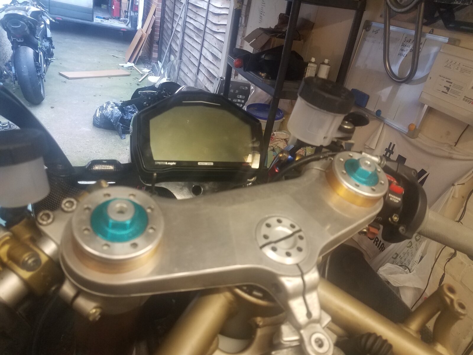

  13. Everything is now fitted up to the bike
    All fluids and filters are brand new
    New braided lines fitted throughout
    New banjo bolt and copper rings throughout
    New bearings everywhere
    Every bolt and spindle copper greased
    All new reservoirs
    The Ohlins shock I got is off being fully serviced
    New chain and sprockets
    New tyres will be fitted
    I'm very proud of my work on this bike :bucktooth:
