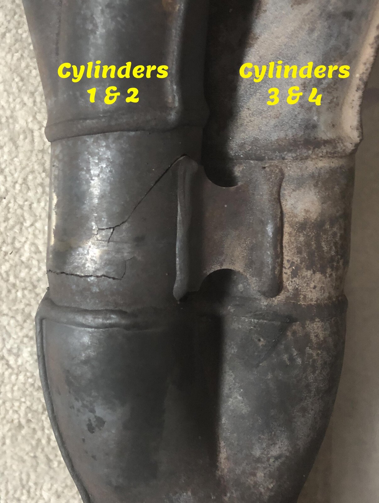

  11. Here is a picture of a MV Agusta F4 exhaust that was wrapped to keep the heat away from the belly pan etc. The retained heat completely destroyed it.
    It's always preferable to protect other components from the generated heat.
    Perhaps wrap your legs and balls :D Crack1.JPG
