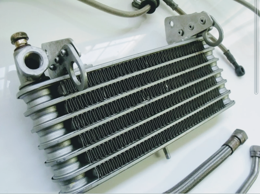

    From what I gather I need
    Oil cooler 54840121A
    Main oil cooler lines
    Ducati Steel Cylinder Head Oil Line
    Ducati Oil Cooler Lines Fittings
    Ducati Oil Bypass Spring
    Some sort of banjo bolts?
    What is the Cylinder Head Oil Line needed for?
  4. Supplying oil to the cylinder head i reckon.
  5. @CarloL What Sev said ^^^ supplying oil direct to the valve train
  6. Thanks
    996R oil cooler 54840361A appears different again , does not have provision for the Cylinder Head Oil Line , mounting brackets are different , uses quick release oil lines
  7. Don't forget 996r is testastreta engine
  8. 748rs cooler fit a stock 748s bike, I presume not
    Location pin and brackets
  9. I’m pretty sure (90%) that won’t fit without making up some adapters for the brackets but I’m sure someone with 100% knowledge will be along shortly.
