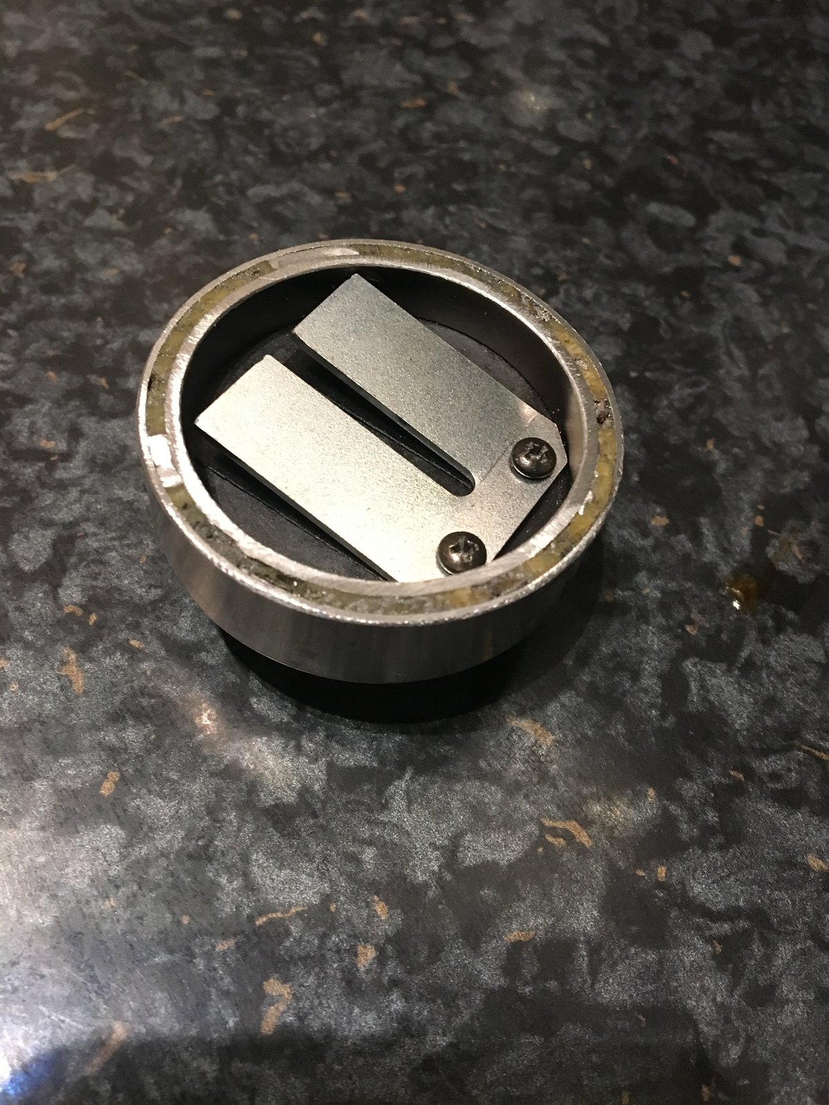

  2. Cheers pal. Already got the carbon sorted. It’s an M40 but no idea about the pitch without measuring.

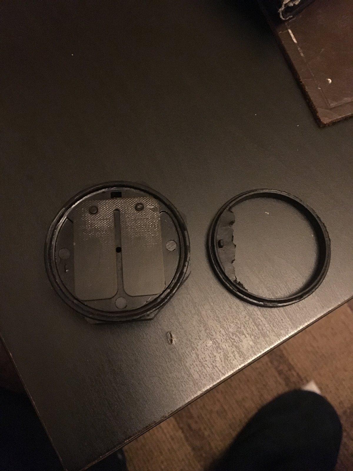

    Just started gutting a std breather right down to the reeds.
  3. i think you have cut that too deep..unless its the angle of photo..
  4. Why’s that, Andy? Didn’t know how far to go down as there was a block of plastic pushing down on the reeds. I used a dremel to slit it and the heat must have broken the bond between the main body and the funnel bit. Going to make a stopper plate for the reeds and screw it down so it traps them in place. Can you see any problems doing it that way?
    Cheers, Ian
  5. i think its the angle of the picture..
  6. Nearly there..
  7. Wow! Looks mint mate! Thanks a lot.
    Ian

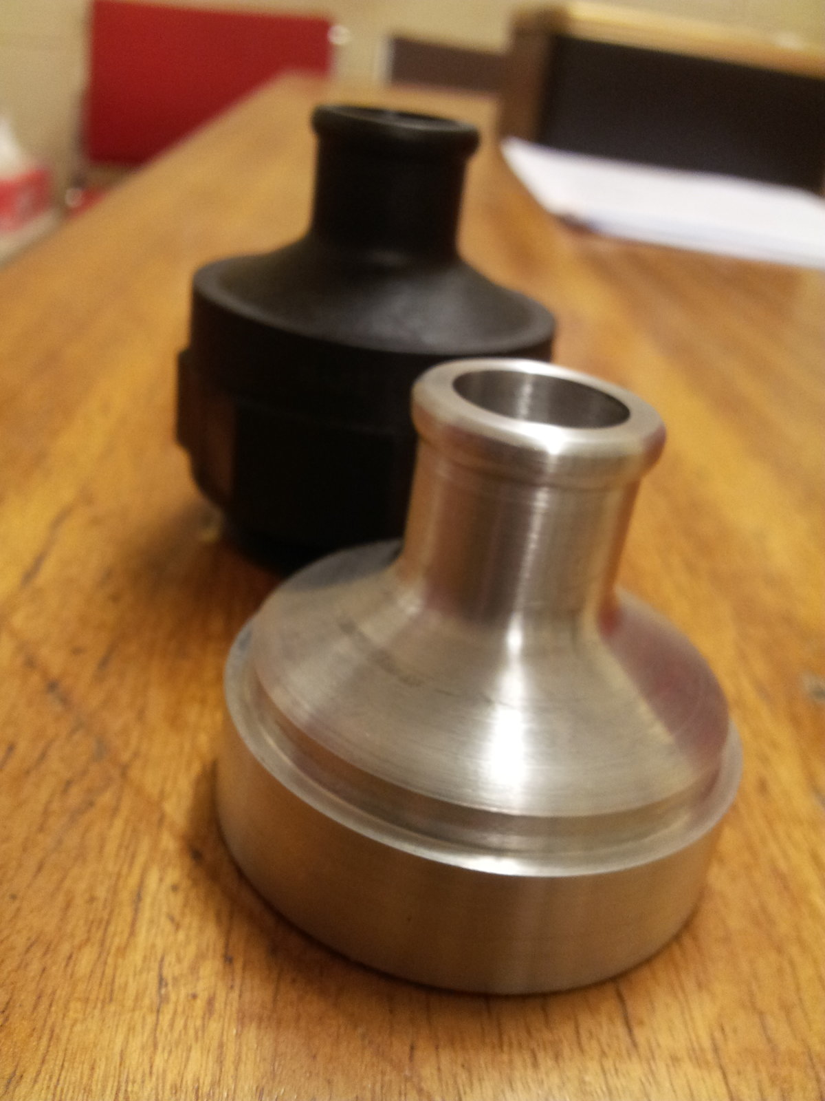

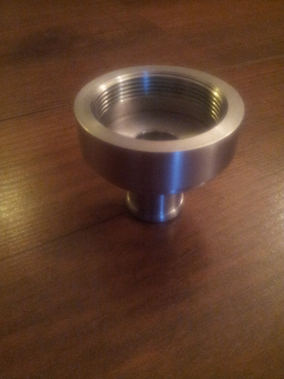

  8. I have an underseat breather box on my 916 with the large corse outlet on the casings and corse reed/breather in the airbox, however the corse breathers are no longer available. I wanted another and so made one from an old style crankcase breather - the alloy type as they are easy to open/cut/flip and reseal and are almost identical to the Corse model.
    This;
    To this;
    And for another bike, an inline version;
    These are also NLA new but more likely to be found used.
  9. Went a different route and chopped up the DP breather I had for sale.
    2CCFCFF2-9952-498C-A639-C90692CF0044.jpeg 30D5D664-26AB-4FE3-A403-FEACE089C030.jpeg
    Means I won’t have to dick about making and fitting the stopper plate.

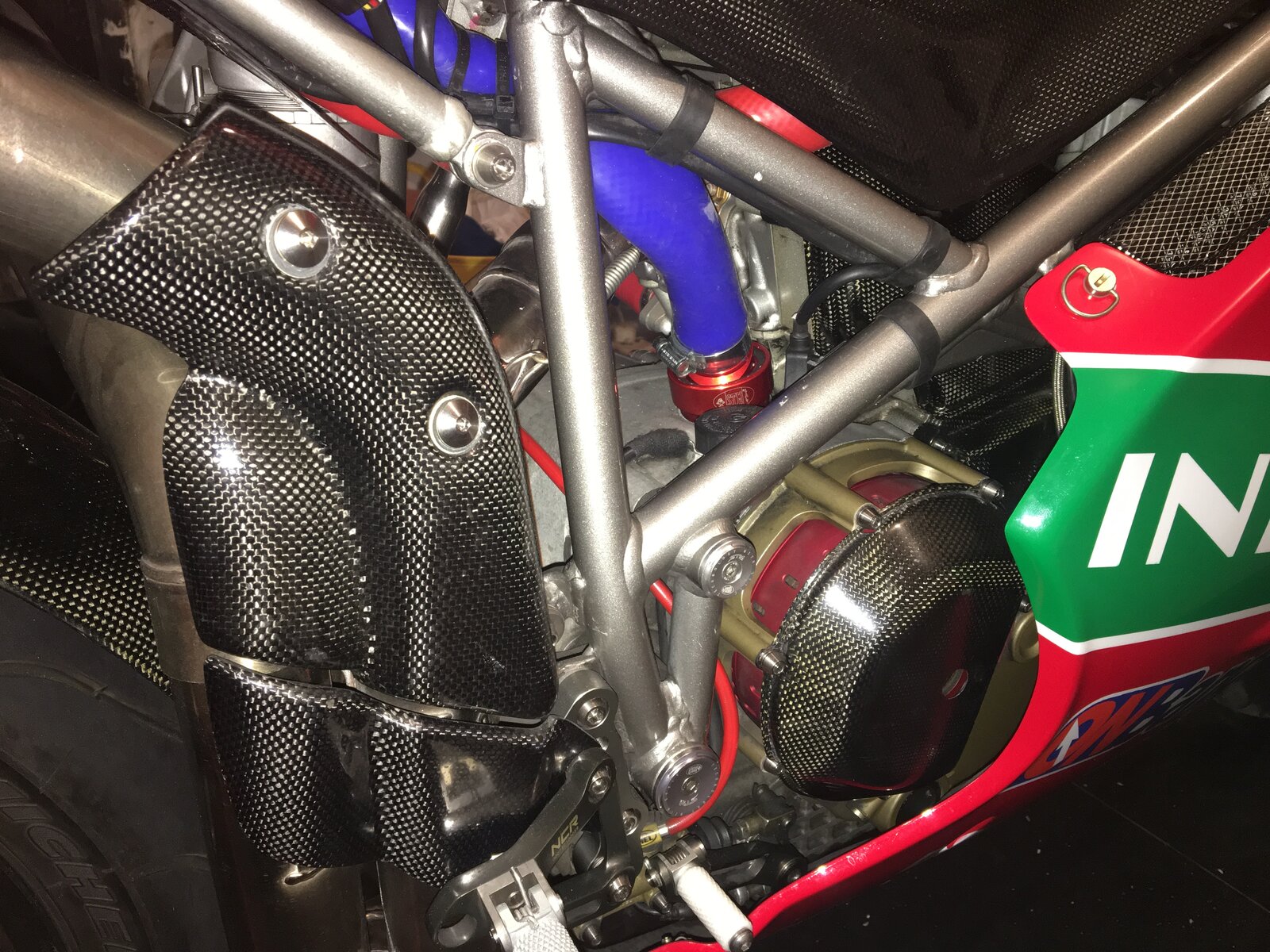

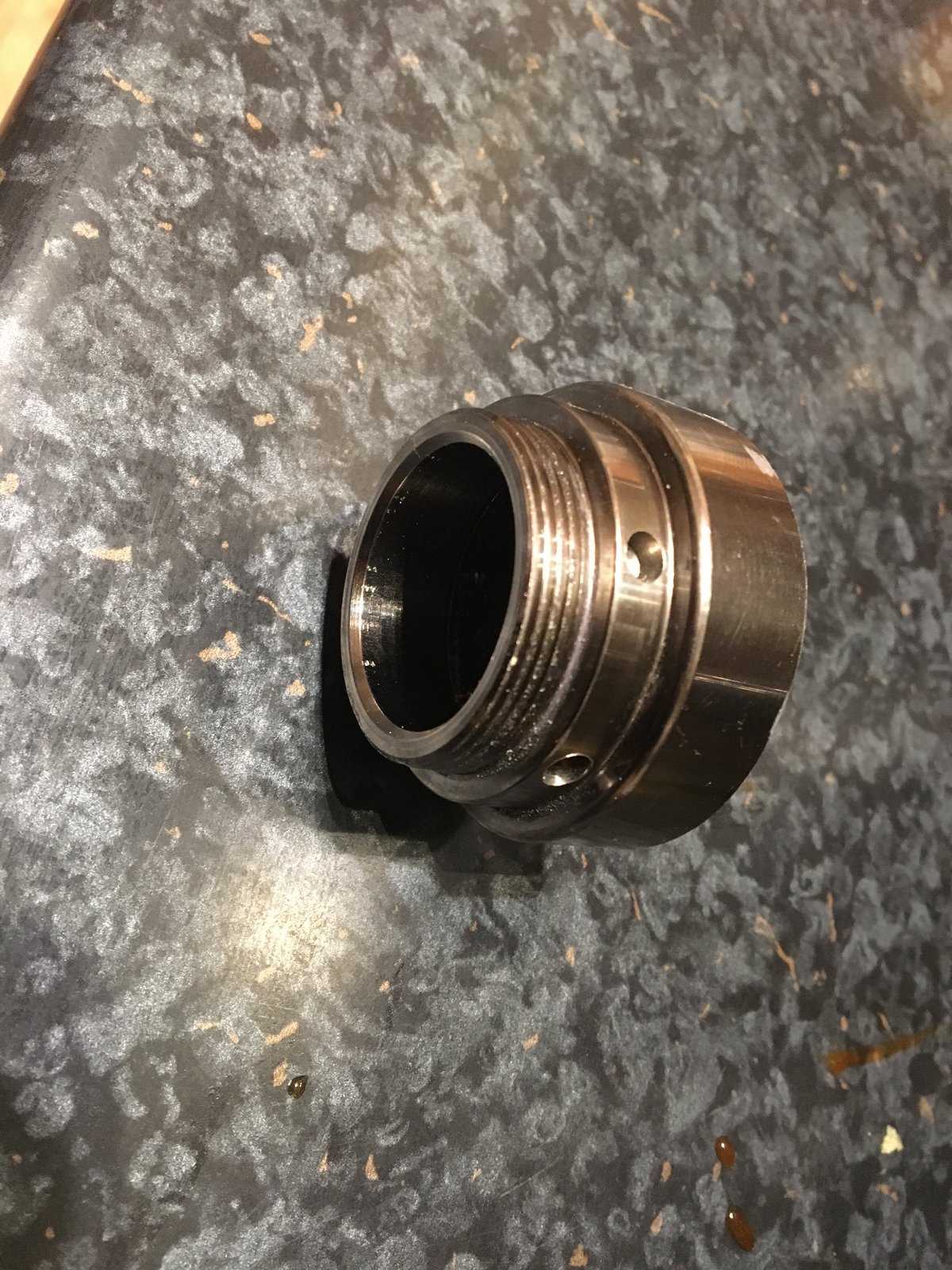

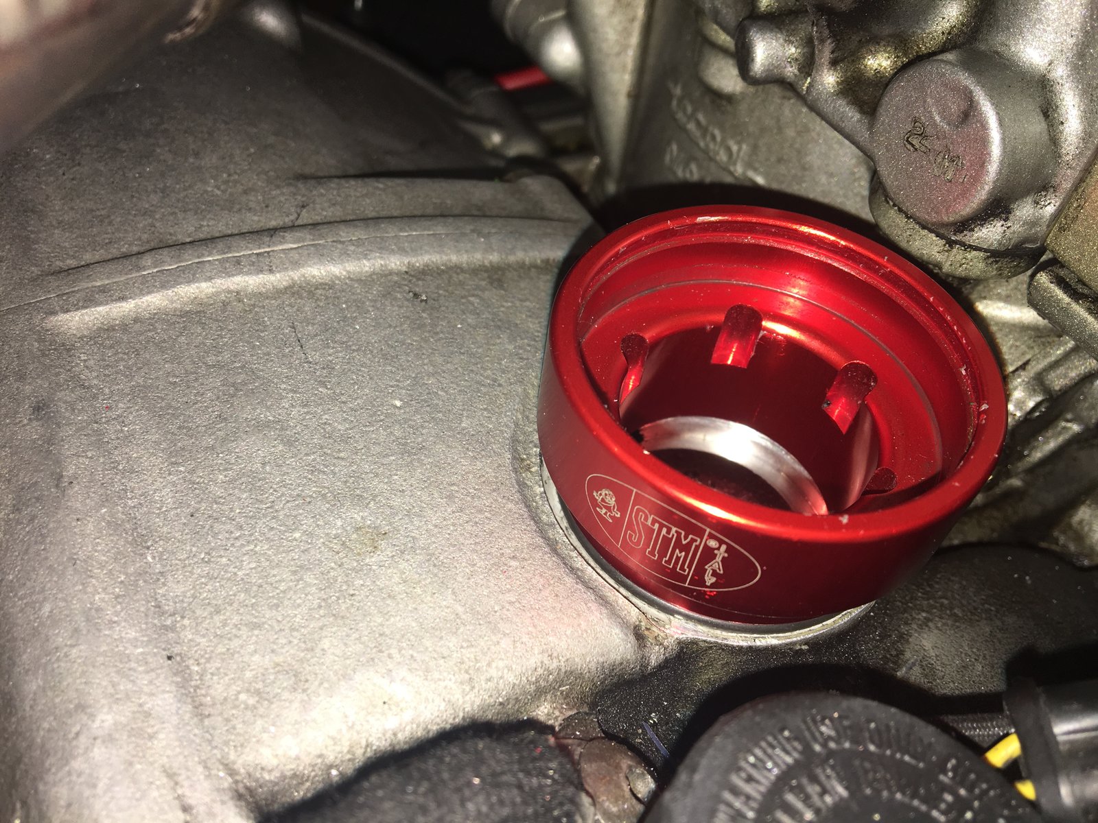

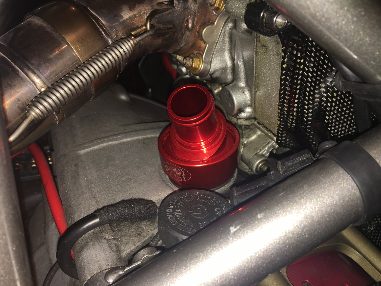

  10. Does the STM angled crankcase breather use a rubber O ring like the Std one or an alloy washer?
    Looks like I have to fab a tool up to tighten the body down. No biggy!
    57E70147-DA02-4EDA-8B21-8EC2A6A46F96.jpeg 84A5597E-A2D9-4698-B02B-11265A0FACE9.jpeg
    Couldn’t wait to dump the bastard ugly black oil catch / breather box!

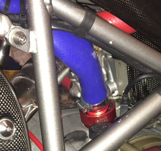

  13. Thanks for the help, job jobbed! :cool:
    9C567EC5-AAD3-4129-AA10-48A579B333FD.jpeg 1DFE2ABC-13D4-40C5-B8BB-E81011C44DF2.jpeg 339BB640-5561-4B90-B963-A473CE759C3C.jpeg

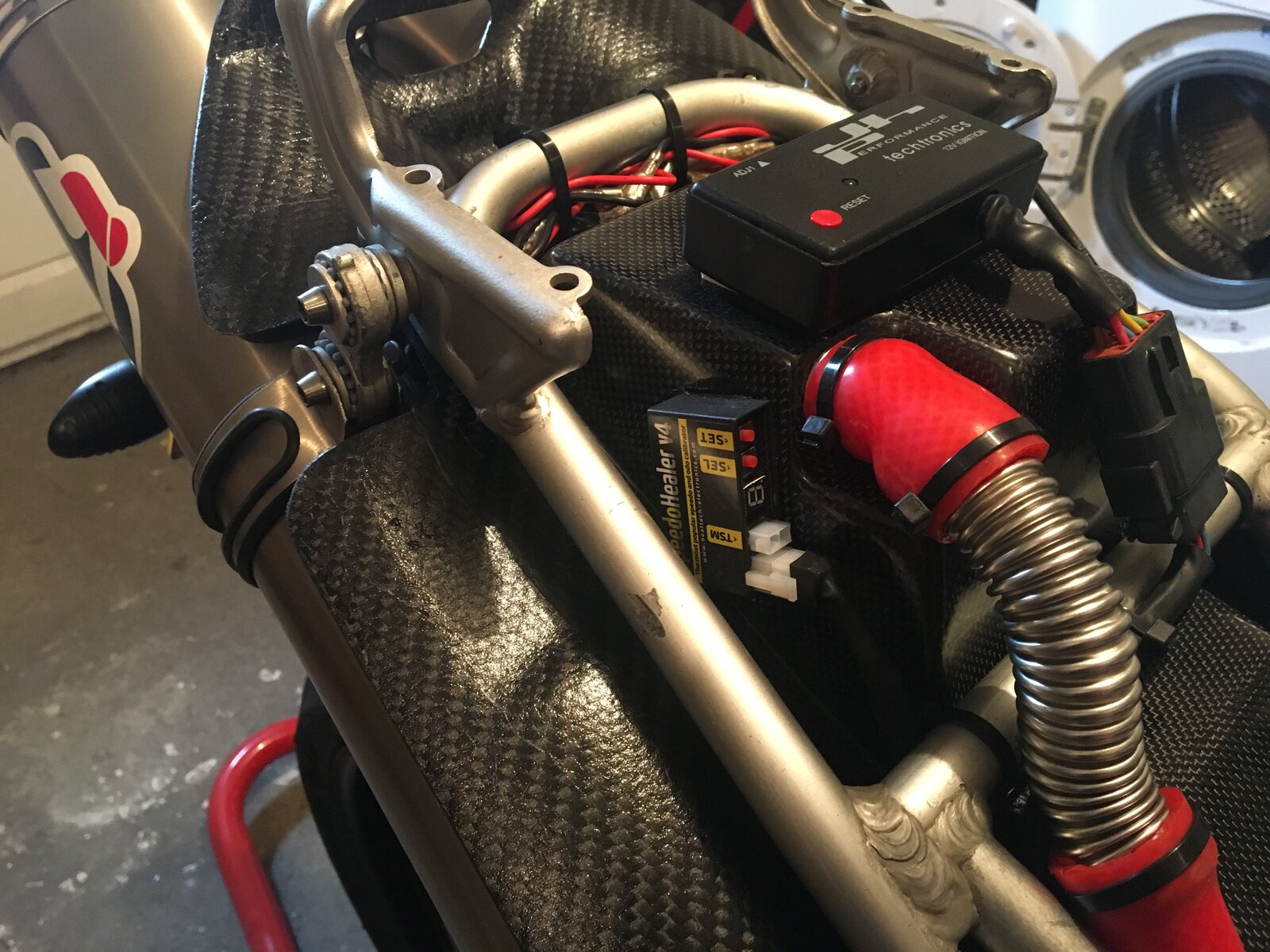

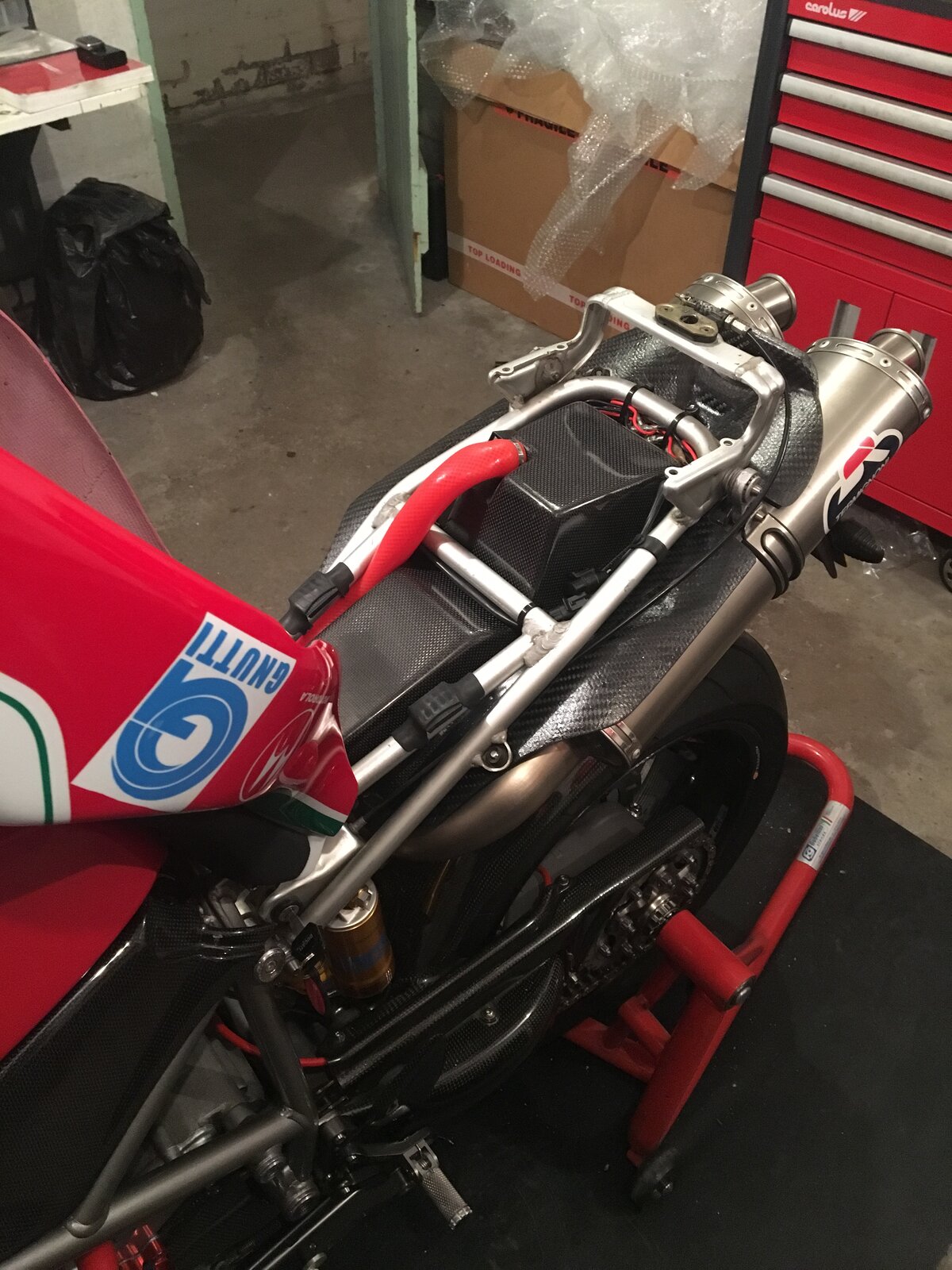

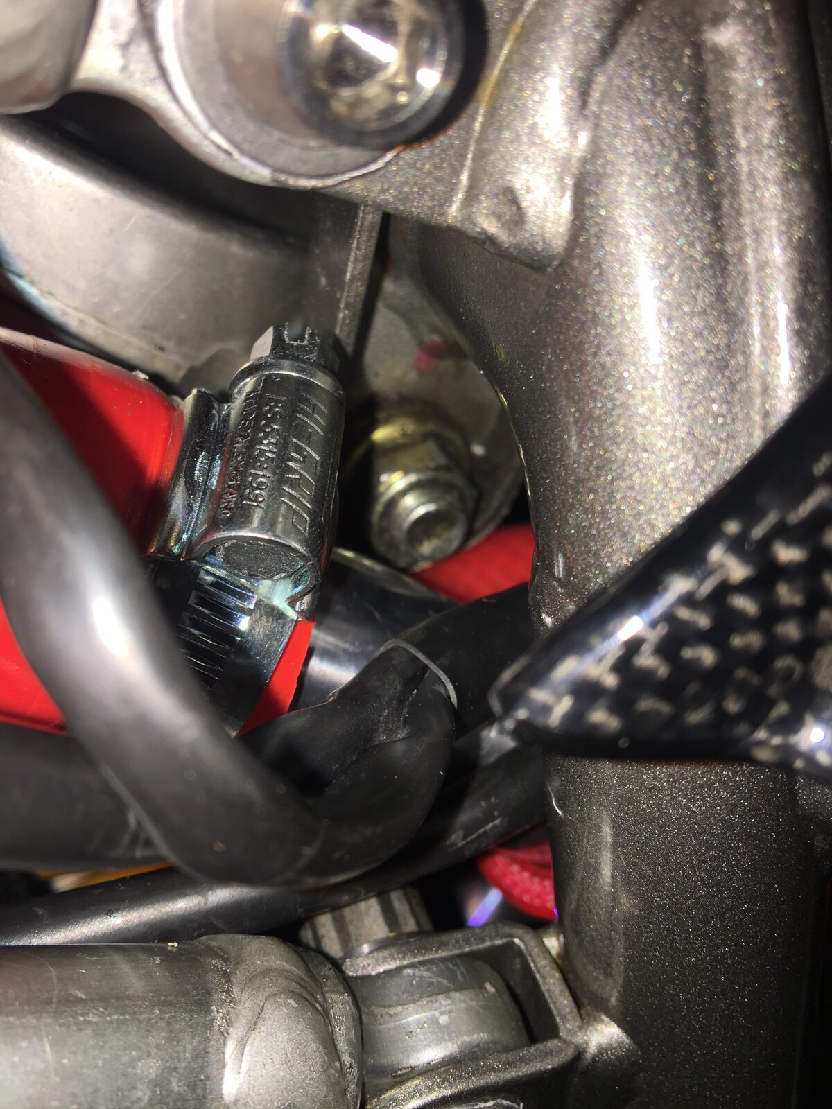

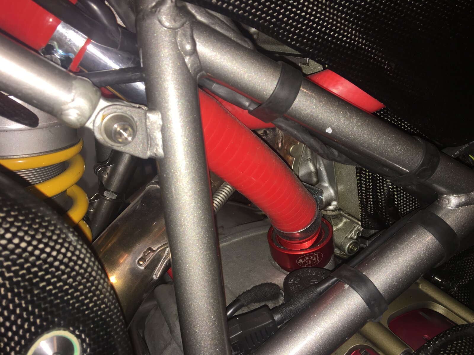

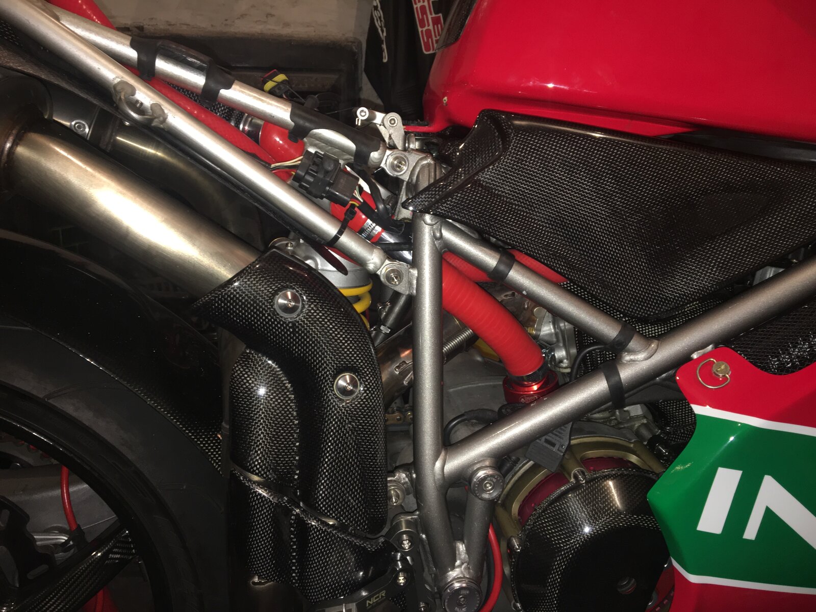

  16. Couldn’t get enough distance between the thicker 1” tube and the top rocker bolt so cut the silicone tube and used a length of alloy tube to get clearance.
    FCEAA70A-8822-4E06-8C29-01E5EC8404CE.jpeg 33BF7382-40F7-4475-A659-B63B0AE95652.jpeg

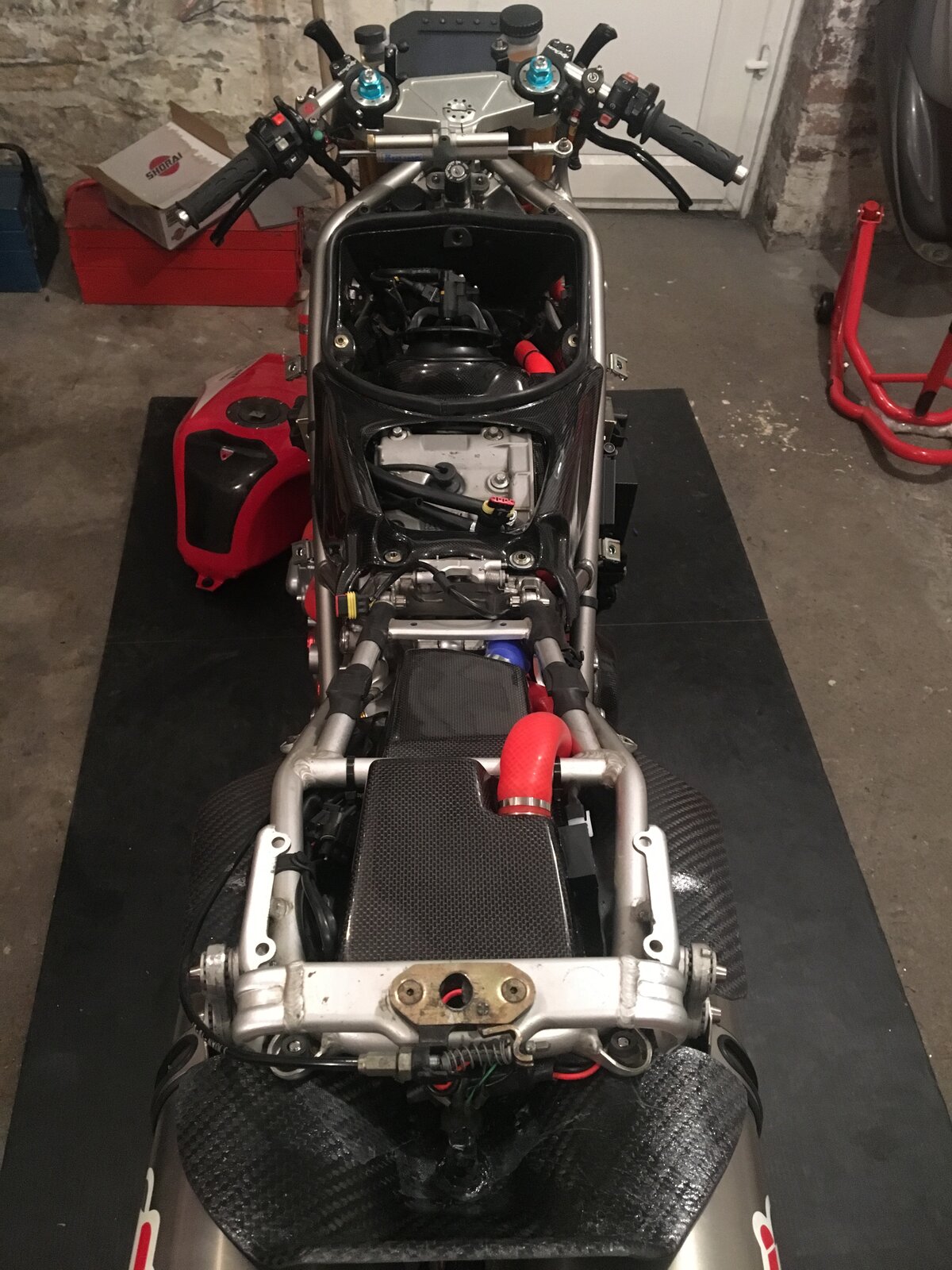

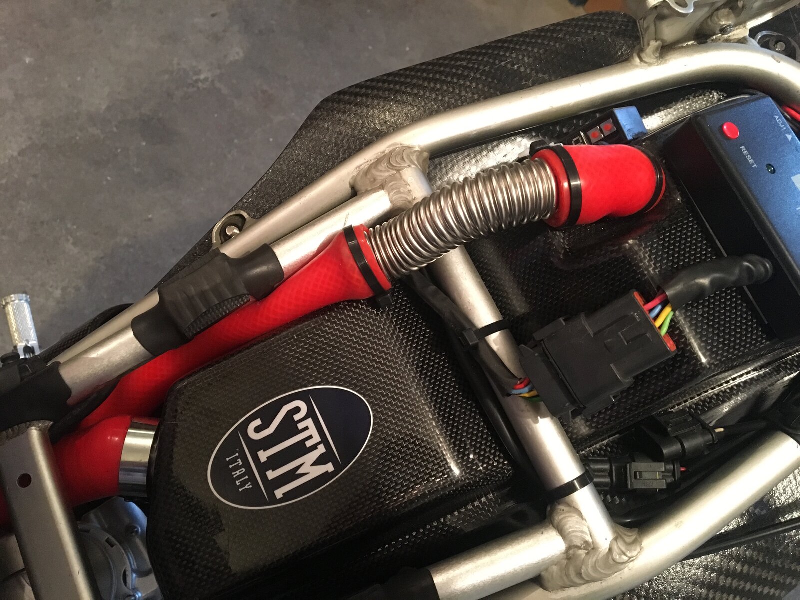

  17. And to finish it off...
    Using the silicone hose under the seat to the breather box will rub on the the seat cowl when down.
    As it happens, I was having a new boiler fitted in the cellar and the gas engineer had a spare piece of 3/4” flexi gas pipe kicking about so I used that. Still got enough left over for another 2 so if anybody needs some, let me know.
    9DCA282A-41E8-4ACC-B60A-D848025AF2F7.jpeg C172FD67-7CD8-4110-B51B-1C490A3D19B1.jpeg
  18. you watch that battery box first picture doesn't explode.....you know what they are saying..:rolleyes:
  19. is it blocking the hose there where its mis shaped?
  20. No Andy. It was nearly closed that way before but just mocking up. I went a different route in the end. I used a length of alloy tubing in the end off the crankcase breather tube to help keep the tube open while protecting it from the rocker pivot bolt.
