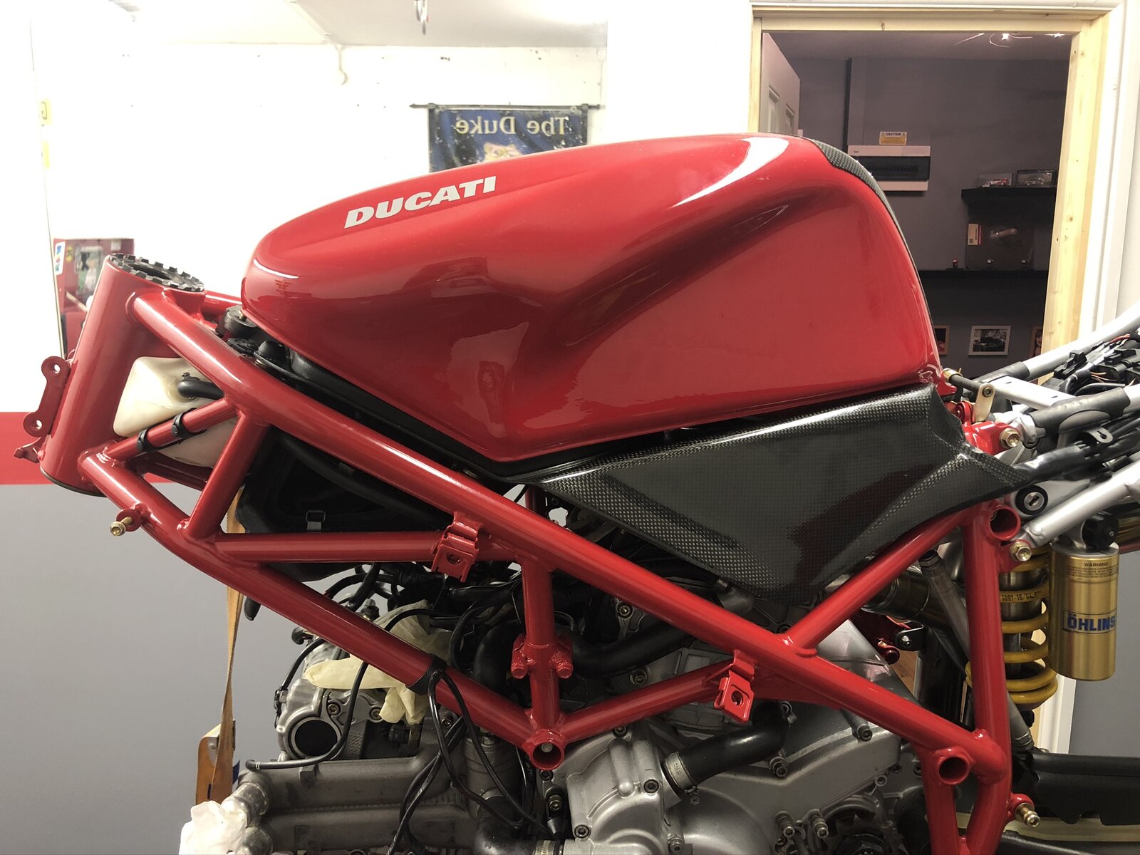

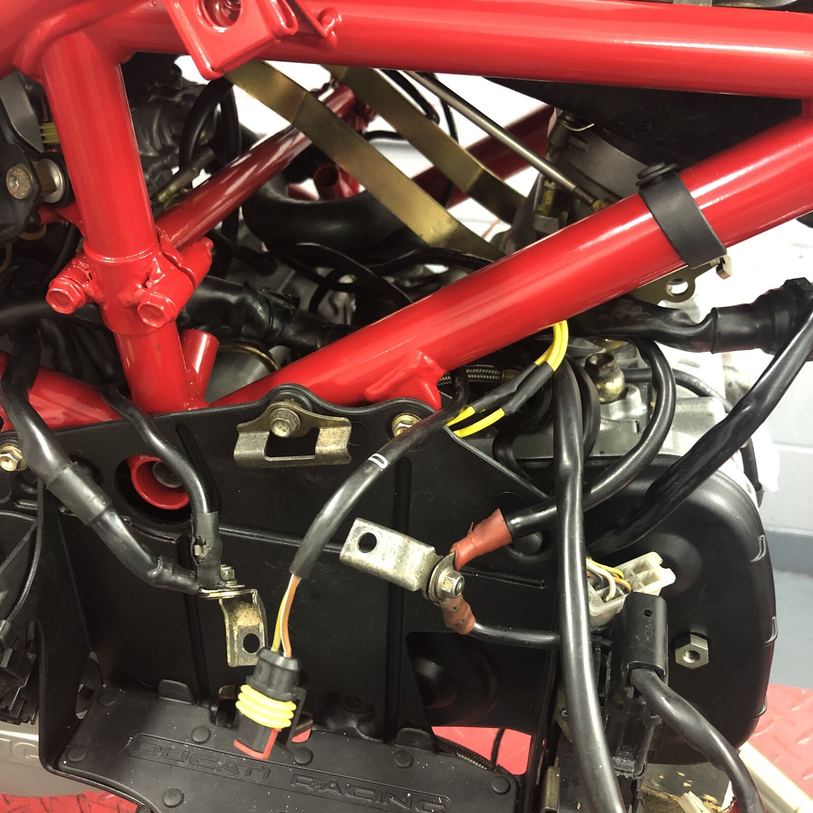

  4. Received 998 carbon airbox and throttle boddies yesterday from Tom Irvine. Really happy with all the bits received. Fitted the throttle bodies and new airbox and started to re-run the loom and get everything connected. Just waiting on the lower fork clamps and the wheels to come

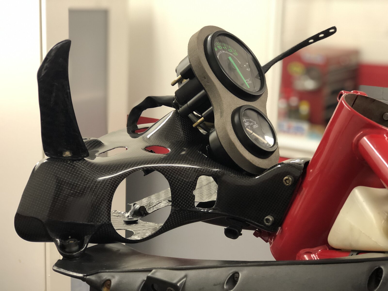

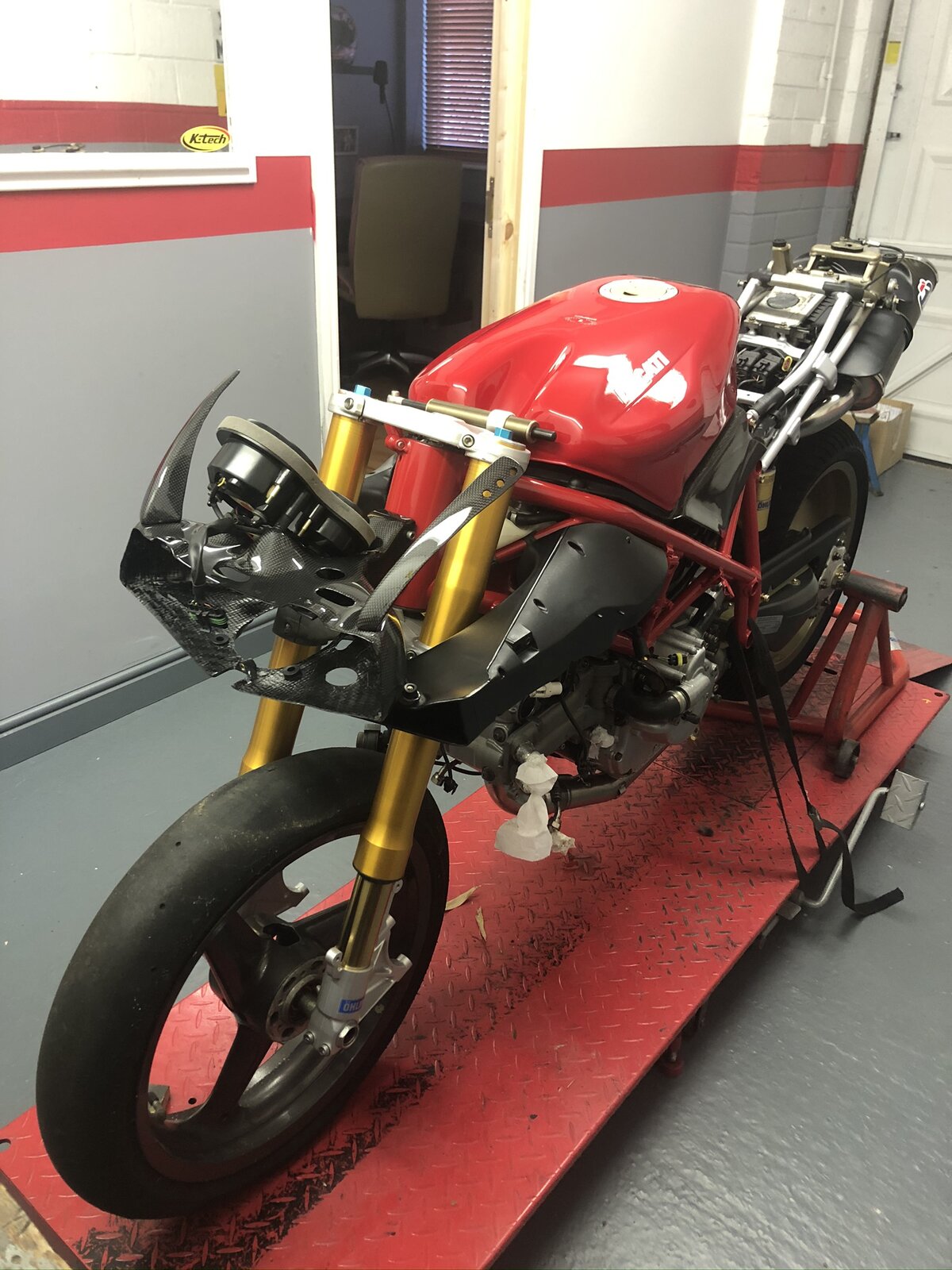

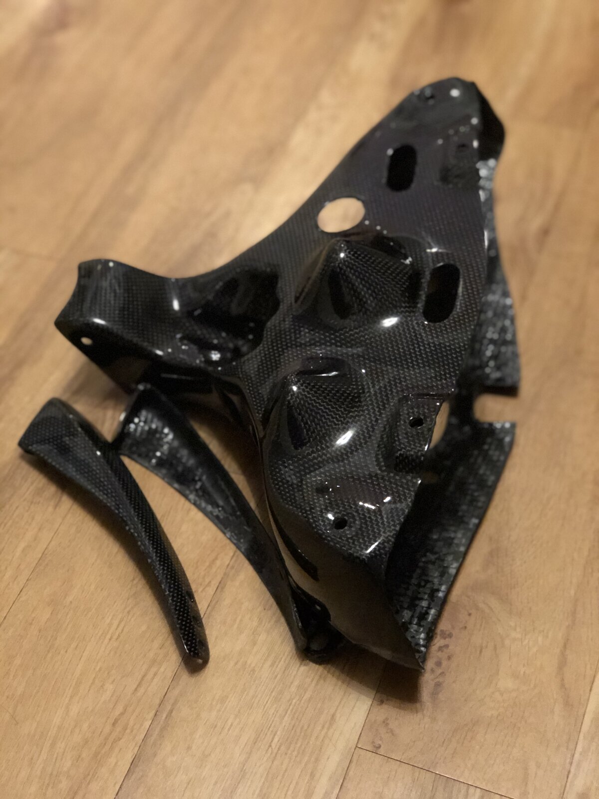

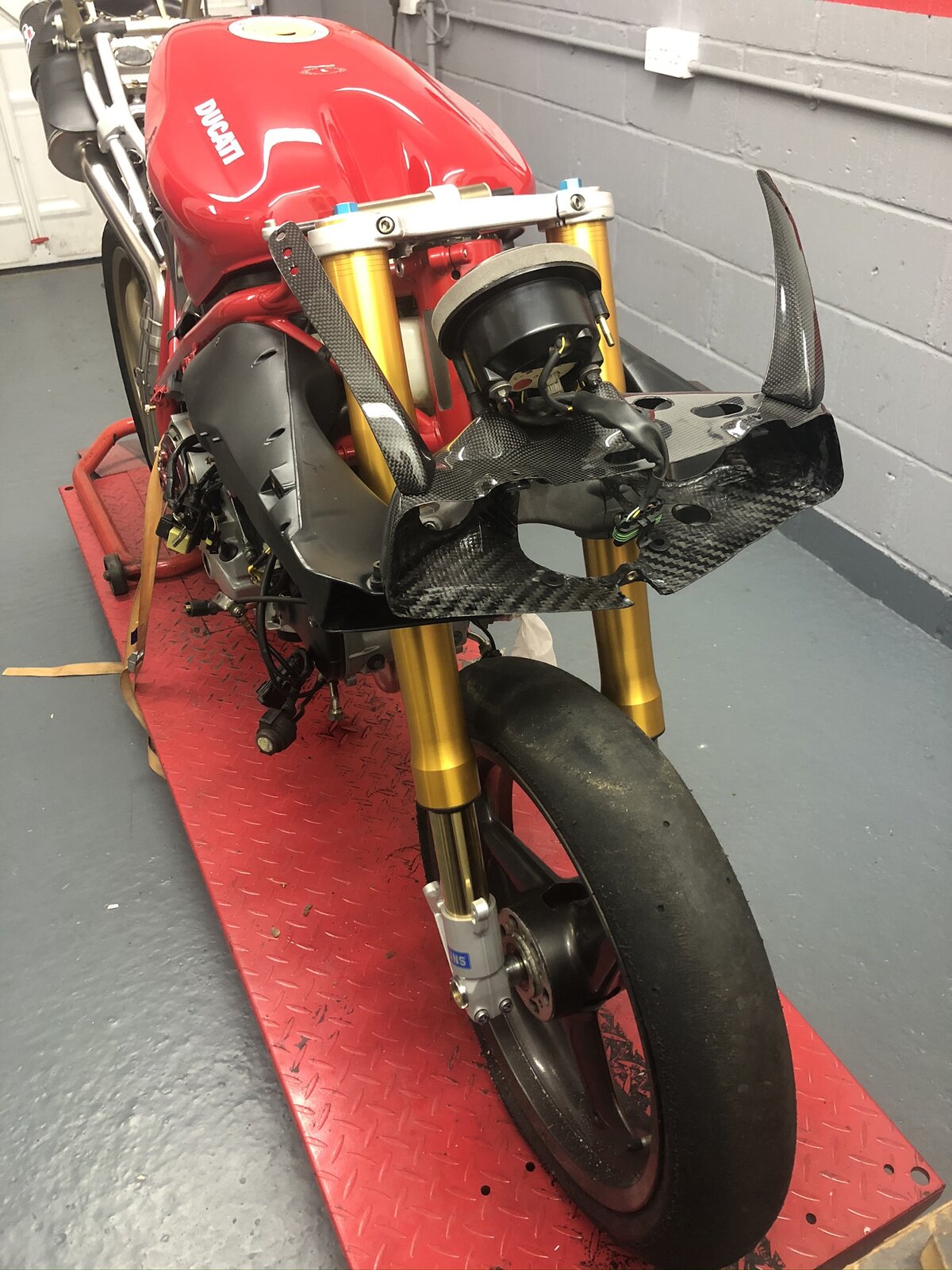

  10. Came across this carbon headlight bucket for a reasonable price whilst looking for parts online. Was cheap enough to take a punt, so I did. Structurally it’s pretty good, but some holes needed drilling for the clocks and mounting points. Actually lines up really nicely with the air tubes, so pleased about that. 2E138836-B9B4-4E81-A704-9A9B85DFB965.jpeg
    My lower clamps arw ready for collection tomorrow, which is great. Can finally get the new forks in and have a rolling chassis.
    #190 Russell, Dec 19, 2019
  11. Those carbon buckets can be a nightmare to get all the road gubbins in.
  12. huge weight saving though... lol, i have no idea! they look cool as fuck though even if ya cant see a great deal of em..
  13. Bit like gold leaf on ice cream
  14. Was thinking exactly that :confounded:

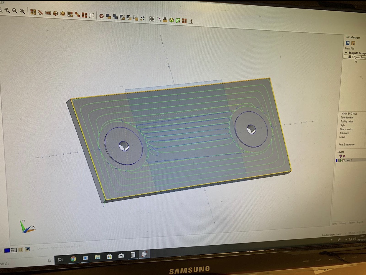

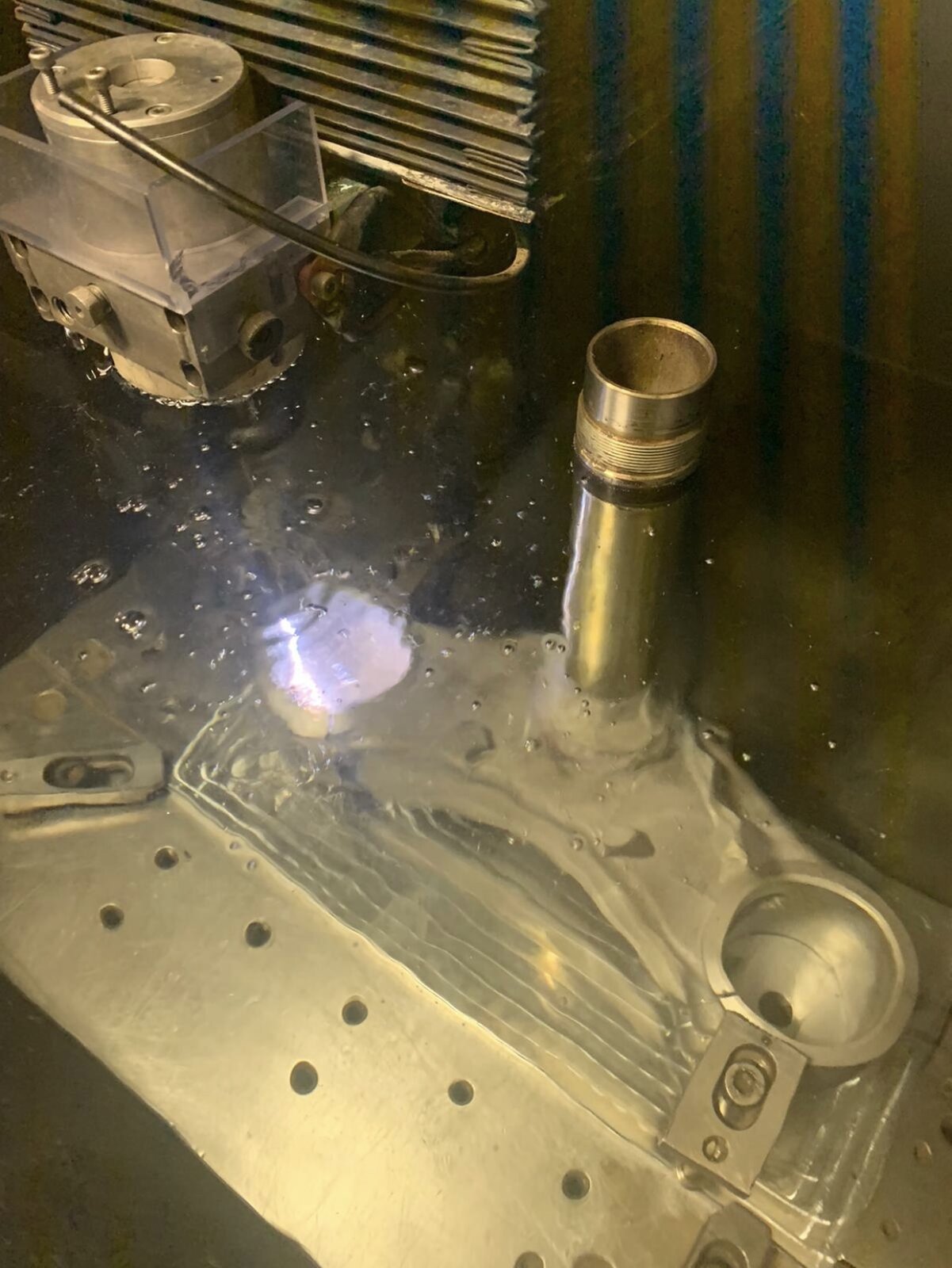

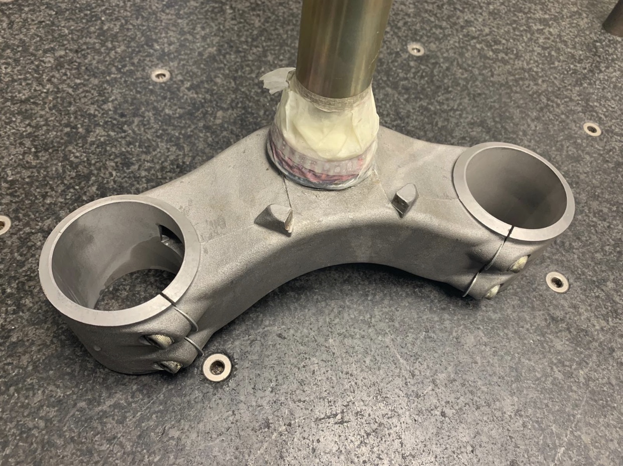

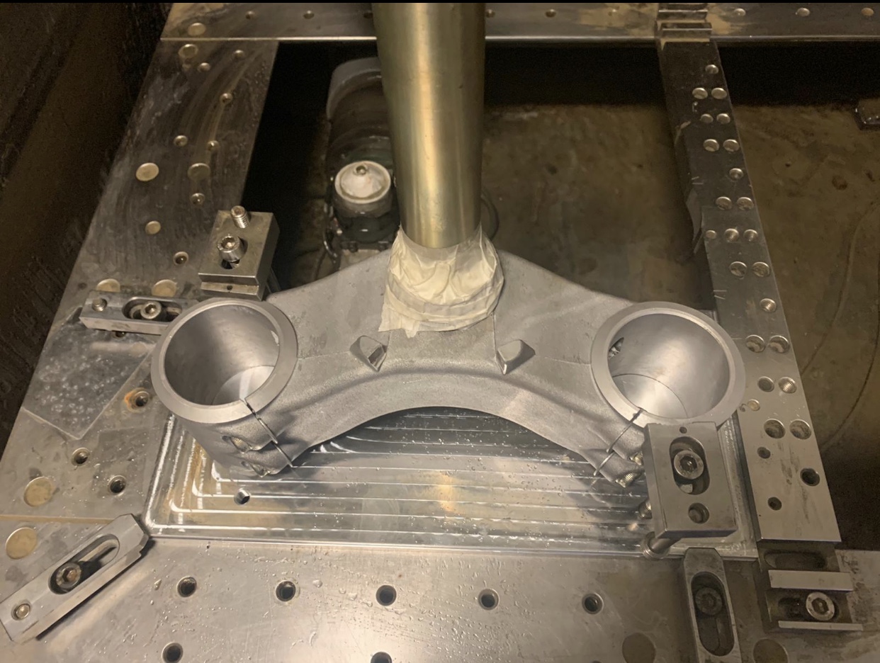

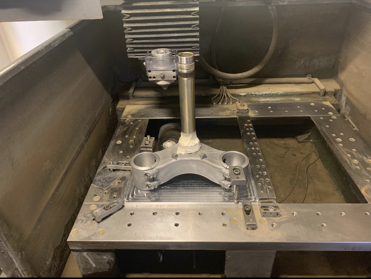

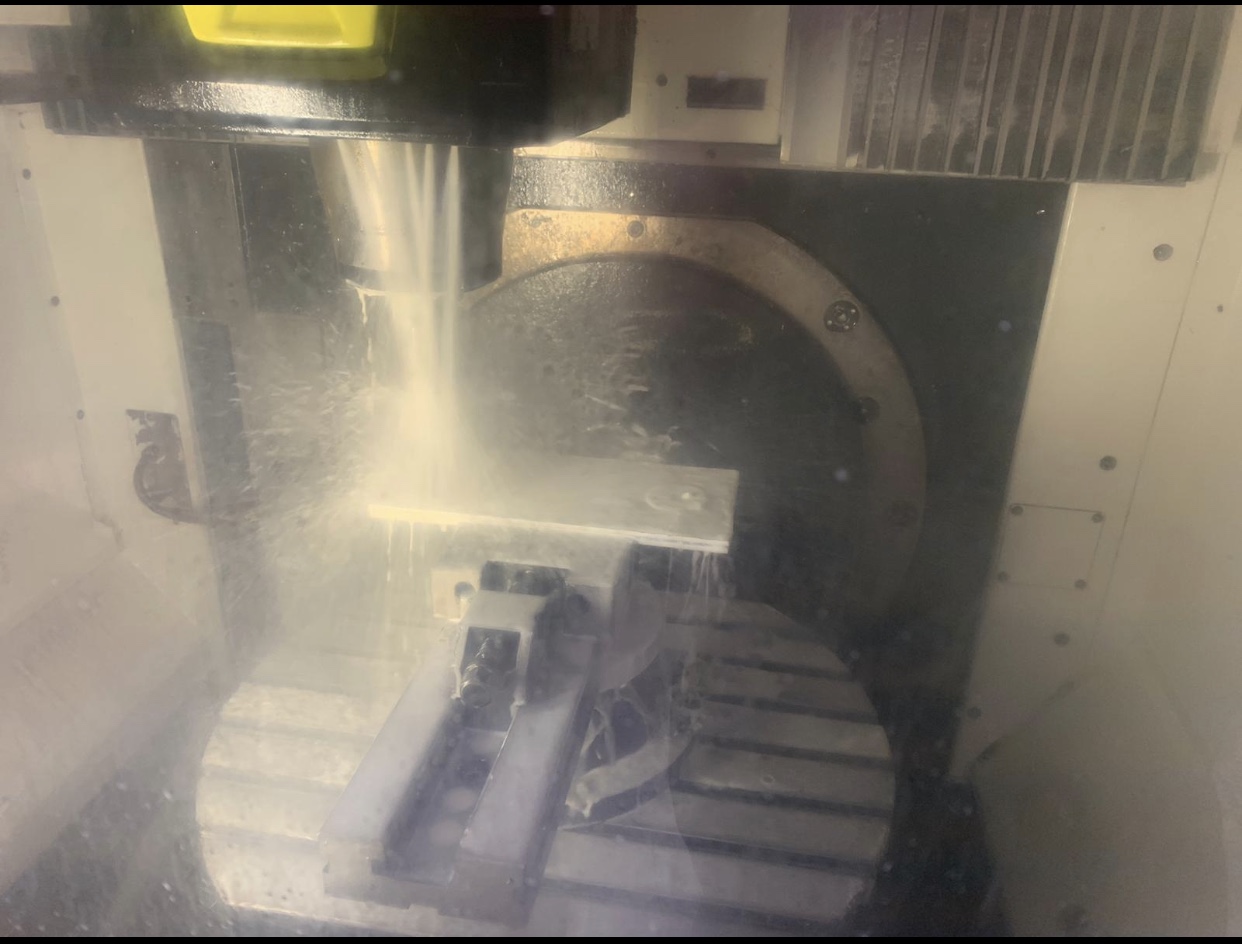

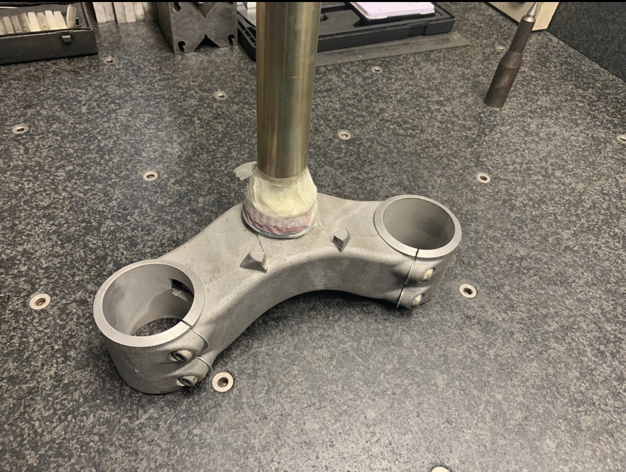

  15. Had some great pics sent over from the engineer. He’s currently milling out the lower clamps for the Duke. The clamps needed milling out by 2.54 mm to 56mm In order the take the new Ohlins forks. Bike SHOULD be rolling by the end of the weekend.
    73D8B6ED-F368-4512-843F-345406782017.jpeg 0B1C866C-BF89-4505-8180-F987EC62DE7D.jpeg 92C4F7CA-3D86-4F9C-AD42-58004BDB2CCB.jpeg 466B9DCB-2372-4124-ADB5-B876C12B5816.jpeg FCDD4EAE-BAE5-457E-8D6F-1B6AED6F480E.jpeg 78C73BE4-E900-4E33-AF9C-83242D1CB4D5.jpeg
    I’m currently on the lookout for a 996R/998 wiring loom. If anyone knows of one for sale, please let me know
  16. Have one of the carbon headlight buckets on the 748 also. I found that the supplied supports for it weren't strong enough and at a certain speed the fairing section past where they are mounted would vibrate at a certain speed and make a really annoying sound so swapped them out for the standard cast item and problem solved.

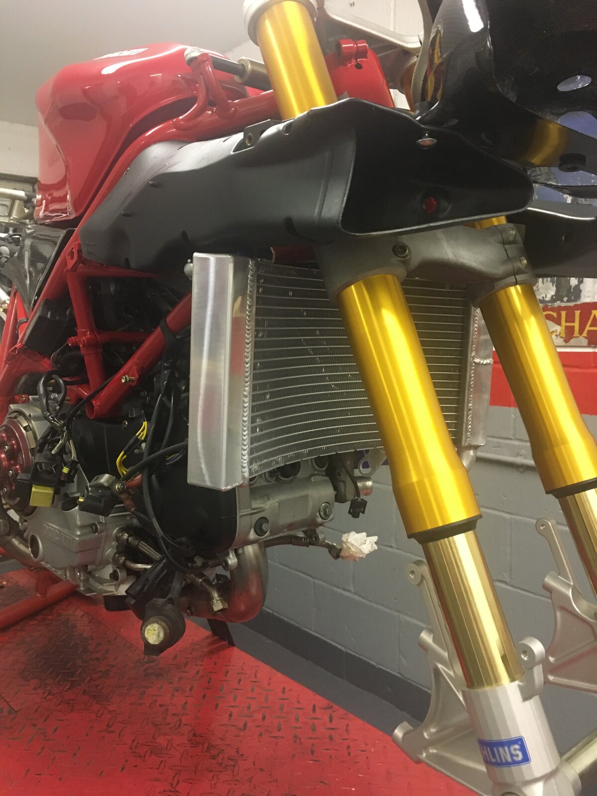

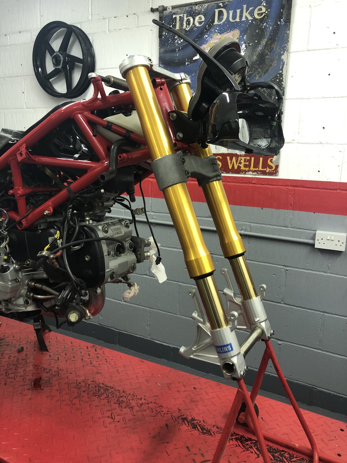

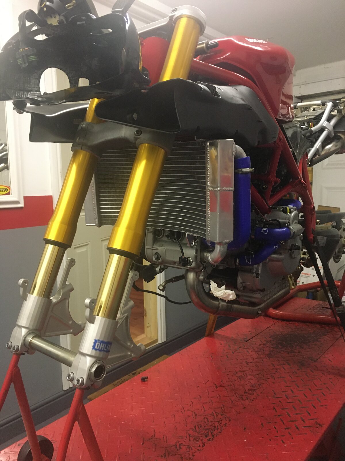

  17. Clamps are back from the engineers. Forks fit perfectly. Now waiting for the new year to start on the next few bits. I’m on the lookout for a 998 loom. If anyone knows of one available, please let me me know.

  19. Interested to know why you had the lower clamps enlarged by wire-EDM, not milling. I know the advantages - just interested in your choice.
    Interested to know why you had the lower clamps enlarged by wire-EDM, not milling. I know the advantages - just interested in your choice (££££?)
  20. It’s on the cards. Trying to find one is a little difficult. Not sure if I’m able to run a race subframe or not. If I can, then great :grinning:
